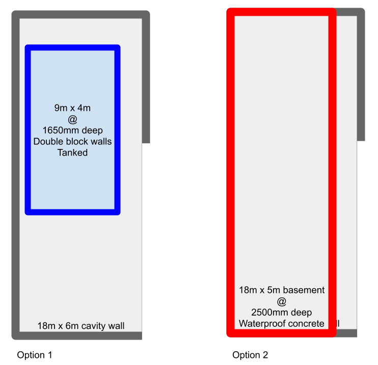

SBMS Posted February 17, 2025 Author Posted February 17, 2025 1 hour ago, Nickfromwales said: If you can afford it, then ask yourself the question, not us lot!!! If you want a cinema / TV room and you will use it, then I’d defo go for it without a second thought. Has the builder discussed tanking / waterproofing / any need for a sump pump+ pumped discharge? Ask all the questions before proceeding, so costs don’t spiral and you don’t end up with regrets. Thanks @Nickfromwales. I was looking to see if anyone came back with "never use a cinema room, waste of money" - having never had one I worry about not using it, but it costing ££s to build it into a basement. I think I need to price up the difference tbh and then understand if its worth doing or not. This is the rough structural difference:

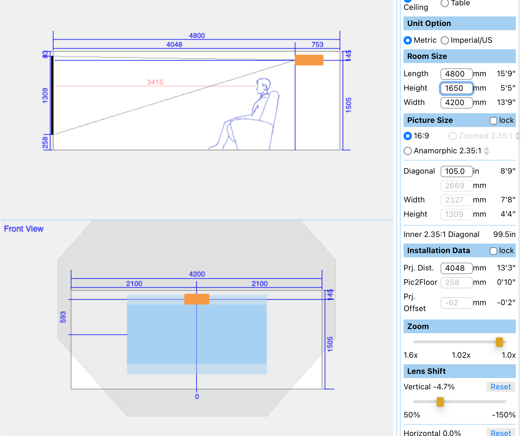

Nick Laslett Posted February 17, 2025 Posted February 17, 2025 16 minutes ago, SBMS said: Thanks @Nickfromwales. I was looking to see if anyone came back with "never use a cinema room, waste of money" In the past there were more challenges. A modern laser projector is instant on and off, no need to replace the bulb every 1000hrs, no need to keep recalibrating as the bulb ages. With an ALR screen even ambient light is not such a big issue. Home cinema is such a large topic, so many different ways to approach it. There are very good 120” short throw laser projectors that are easy to install. Or you can get 97” OLED TV screen. Of go down the long throw route and have the largest screen the room can take. Ultimately the room height will dictate how large a screen you can have, if you basically fill a whole wall you need an acoustical transparent screen with the speakers in a false wall behind the screen. After 140” inches you need serious projector power to light that size of a screen.
saveasteading Posted February 17, 2025 Posted February 17, 2025 24 minutes ago, SBMS said: need to price up the difference tbh Top of head..... £60,000 extra, as 'self-build', more if by a main contractor. For the structure, not any other works. Add for risk if the ground is a challenge, liable to flood, or near other buildings. Don't forget the area that a stair takes up when working out the usefulness of the smaller size.
Nick Laslett Posted February 17, 2025 Posted February 17, 2025 I like this Projector Screen calculator. http://www.reviewtranslations.com/projection_calculator_en.html There are lots of other ones. I feel that 1650mm room height will not give you that big of a screen.

SBMS Posted February 17, 2025 Author Posted February 17, 2025 28 minutes ago, Nick Laslett said: I like this Projector Screen calculator. http://www.reviewtranslations.com/projection_calculator_en.html There are lots of other ones. I feel that 1650mm room height will not give you that big of a screen. Thanks Nick - the 1650mm would be the height just for the sunken area for the pool! I would have to crawl into a room if it only had 1650mm ceilings. Option 2 would have ceiling heights of 2300mm for a cinema room. 1
SBMS Posted March 9, 2025 Author Posted March 9, 2025 For anyone interested, I can now answer my own question and the answer is no, in my instance it’s not worth it! Had costs from our contractor to incorporate a basement (we are doing a swim spa pool so much of this space would be taken up by that anyway.). Difference between just sinking the indoor swim spa and making the full extension a basement is circa £50k. Considering only 7m x 4m of that is useable space we are going to go back to plan A to sink the pool and keep the rest at ground level.
