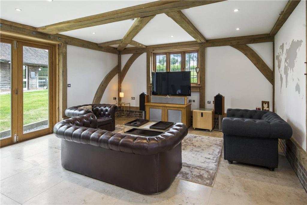

Mr Punter Posted February 4 Posted February 4 Someone on here did an oak frame with oak visible inside and out. I can't find the person, but here is the house: https://www.rightmove.co.uk/house-prices/details/england-65891074-69232953?s=09f1fd364ad88af843b86a954972dc9081ac27208edb81c15a43198f3100ab4f&v=media&id=media0&ref=photoCollage 2

SteamyTea Posted February 5 Posted February 5 19 hours ago, Mr Punter said: here is the house Is that how to cover up damp. 3
Iceverge Posted February 7 Posted February 7 On 04/02/2025 at 16:53, Mr Punter said: Someone on here did an oak frame with oak visible inside and out. I can't find the person, but here is the house: https://www.rightmove.co.uk/house-prices/details/england-65891074-69232953?s=09f1fd364ad88af843b86a954972dc9081ac27208edb81c15a43198f3100ab4f&v=media&id=media0&ref=photoCollage I know of a house like that. They even passed the airtighess test. Apparently all the gaps in the walls were just big enough to slip some £50 notes into the testers pocket..... 1

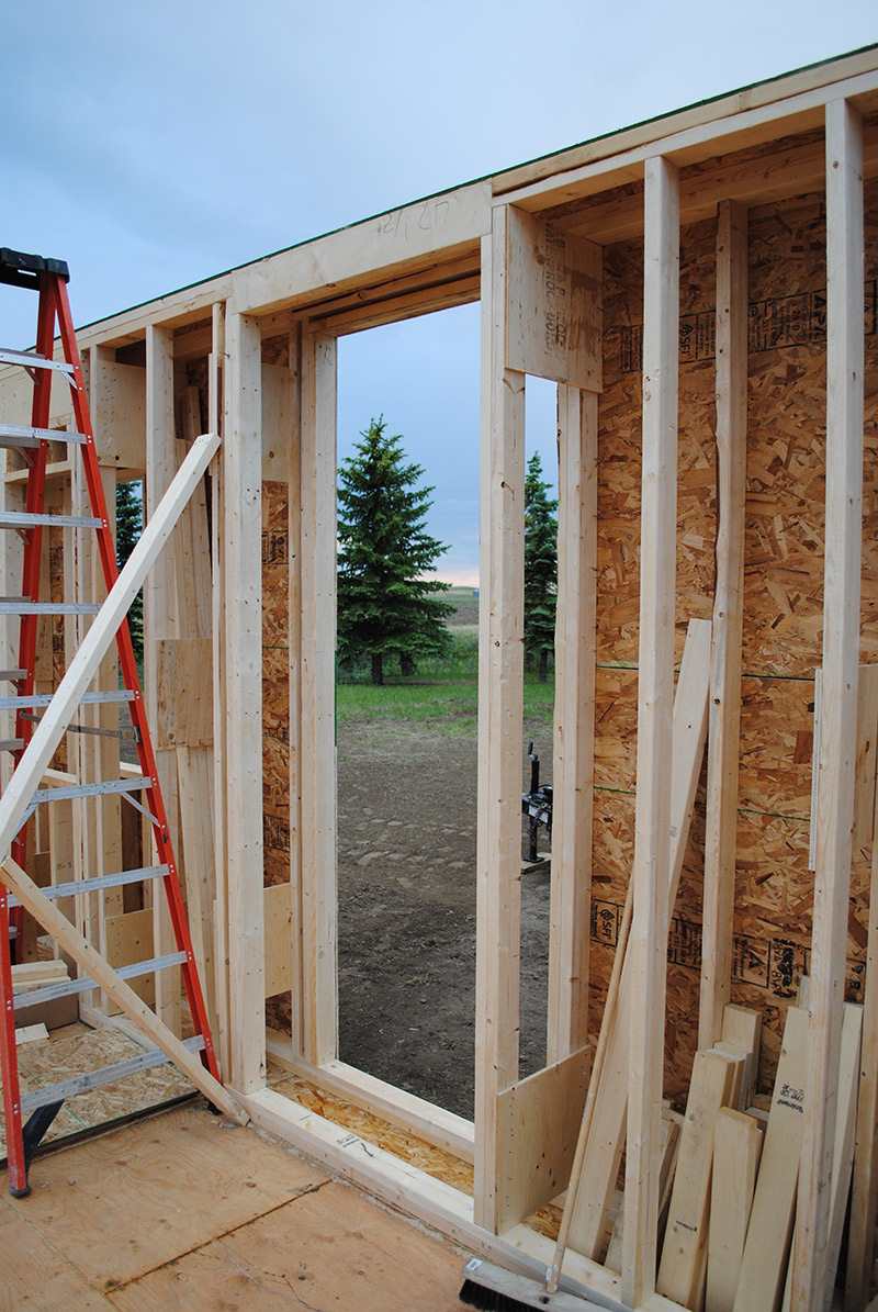

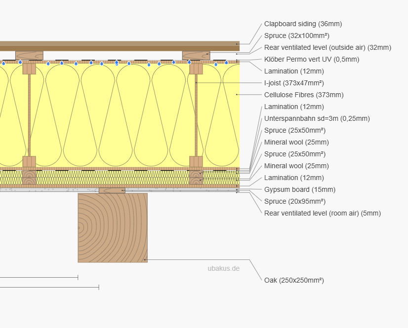

JohnMo Posted February 7 Posted February 7 Think I would be looking at a thermally broken stud wall and cellulose fill. If the oak is structural it would be a cheap structure to do. 1
