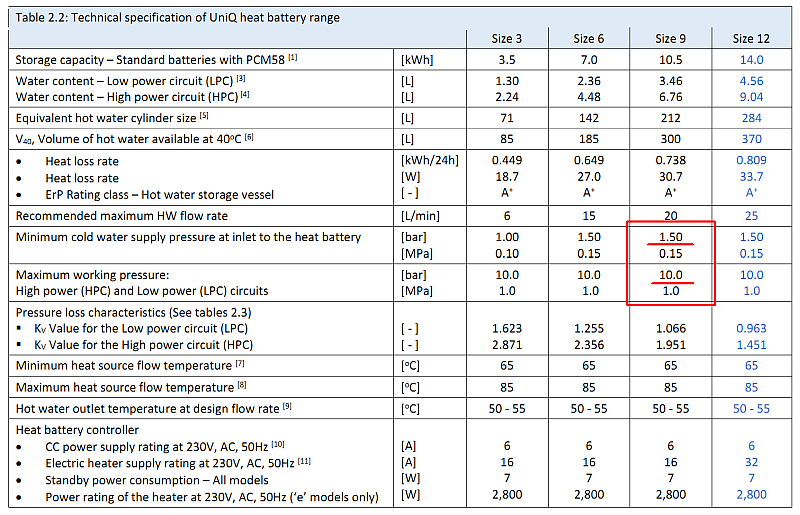

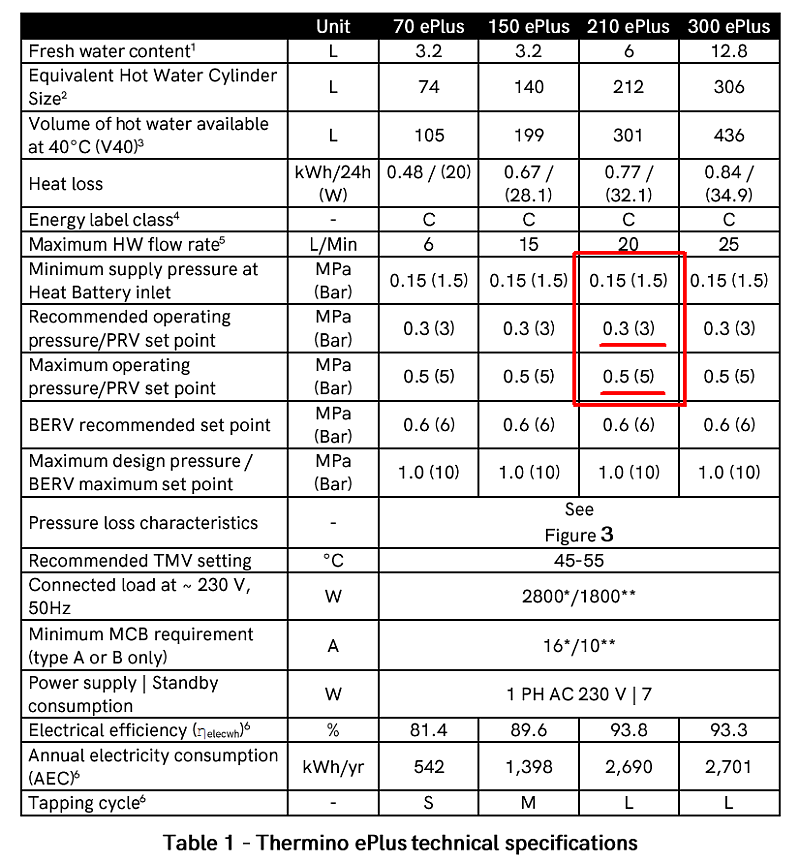

Jeremy Harris Posted January 14 Author Posted January 14 I've been trying to see if my theory about these issues being related to pressure might be born out, by comparing the specifications for the UniQ that we have and the newer Thermino (which seems to use essentially the same, or an extremely similar, core design). It's interesting that the pressure specs have changed. The UniQ has a minimum pressure of 1.5 bar and a max pressure of 10 bar, according to the last set of MIs I received, version 2.0, dated 17/06/2018: For the Thermino though these pressure specs have been very significantly reduced, to a minimum pressure of 1.5 bar but a maximum pressure of 5 bar, half that of the UniQ: Moot point for us, perhaps, as our well pump can only deliver 3.5 bar maximum and the pressure regulating valve has always been set to 3 bar, same as the pressure recommended for the Thermino, but it does suggest to me that there is a known pressure sensitivity issue. When combined with the emphasis in the new MIs that mandate the fitting of a pressure relief valve, set to 6 bar, together with the 0.5 litre pressure vessel I'm now more than ever convinced that the most likely cause of this failure is pressure, most probably some sort of repeated pressure shock from something like the shower turning off. Although we have a 100 litre pressure vessel only a metre or so away from the Sunamp, it seems possible, perhaps even probable, that this is too far away to mitigate some sort of fast pressure shock wave. This is all really just theory, but it does pretty closely fit with the known facts and details from Sunamp, and the experience of Jonathan Porterfield up in Orkney. Why else would Sunamp have reduced the maximum pressure permitted, and added these over-pressure mitigation devices, if it wasn't because over-pressure can cause issues like this? 3
Nick Laslett Posted January 14 Posted January 14 (edited) On 14/01/2025 at 17:02, Jeremy Harris said: For the Thermino though these pressure specs have been very significantly reduced, to a minimum pressure of 1.5 bar but a maximum pressure of 5 bar, half that of the This is all really just theory, but it does pretty closely fit with the known facts and details from Sunamp, and the experience of Jonathan Porterfield up in Orkney. Why else would Sunamp have reduced the maximum pressure permitted, and added these over-pressure mitigation devices, if it wasn't because over-pressure can cause issues like this? Expand Hello @Jeremy Harris, welcome back. I thought of Jonathan’s video as I was reading the first post. I have taken so long with my build that I think there have been two iterations of the Sunamp whilst I have been building. I now have a Sunamp Thermino 300 ePlus in my plant room waiting for me to plump it in. Edited January 14 by Nick Laslett 1
