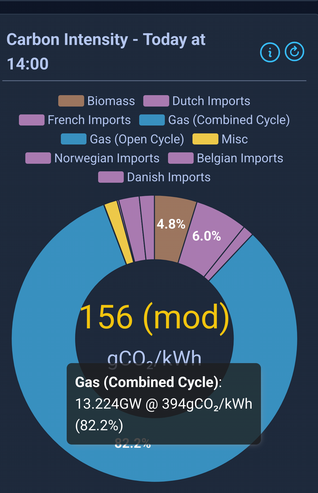

Beelbeebub Posted February 1, 2025 Posted February 1, 2025 On 12/01/2025 at 10:35, ProDave said: By the same token, installing an ASHP increases the electricity you use so that will increase fossil fuel generation at the moment so WILL result in increased CO2 emissions An efficient gas boiler emits around 220g of CO2 per kwh of heat. A gas power plant emitts just under 400g of CO2 per kwh delivered. So burning gas in a power plant then using an ASHP operating at a Cop of 2:1 would have lower co2/kwh than burning the gas in a domestic boiler. 2:1 CoP is achievable in all but the most ham fisted installation. So if we could snap out fingers and replace every gas boiler with an ASHP (and build some extra gas power stations etc) we would reduce our co2 emissions. 1
JohnMo Posted February 1, 2025 Posted February 1, 2025 48 minutes ago, Beelbeebub said: we could snap out fingers and replace every gas boiler with an ASHP Our government (past, present and future) are committed to a 4 to 5 year job application, so unlikely to happen. Short term planning wins the day, no-one cares about long term (or those in power, to change things anyway). No upsetting industry, or the voter likely to occur anytime soon. They can't even get energy pricing sorted, so don't hold your breath about bigger stuff happening. 1
marshian Posted February 1, 2025 Posted February 1, 2025 53 minutes ago, Beelbeebub said: An efficient gas boiler emits around 220g of CO2 per kwh of heat. A gas power plant emitts just under 400g of CO2 per kwh delivered. Either you have a unit of measure error or the gas power plant is bloody rubbish

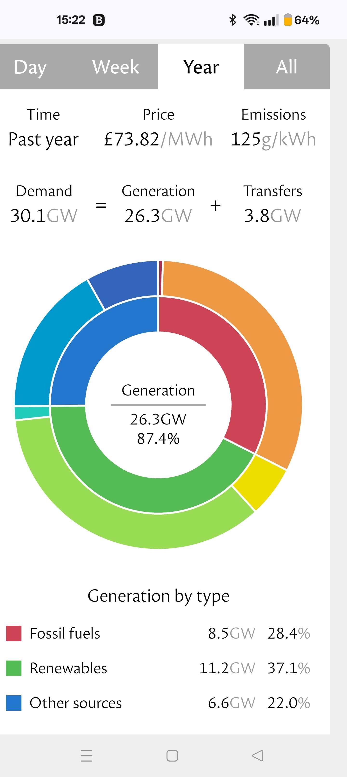

JohnMo Posted February 1, 2025 Posted February 1, 2025 Burning natural gas produces around 0.185 kilograms of CO2 per kWh. So emissions per kWh changes depending on flow temperature and therefore efficiency. Scotland currently UK Grid over the last 12 months
LnP Posted February 1, 2025 Posted February 1, 2025 (edited) 1 hour ago, marshian said: Either you have a unit of measure error or the gas power plant is bloody rubbish @Beelbeebub is right. If you're asking yourself why a CCGT looks less efficient than a domestic boiler, it's because in a CCGT the heat energy (gas) has to be converted into work energy (electricity). There's a thermodynamic limit to how efficiently that can be done. CCGT is about 50% efficient. In a gas boiler the gas heat energy is being used directly without being converted to a different form and in theory you could design a boiler which could do that with 100% efficiency. Second law of thermodynamics - there are two types of energy, heat and work. Work can be completely converted into heat, but heat cannot be converted completely into work. No matter how hard you try, you'll never design a device whose efficiency for converting heat into work exceeds the theoretical thermodynamic limit (Carnot cycle efficiency). His sums are also right that installing a heat pump will reduce CO2 emissions even if the electricity is coming from a CCGT power station providing the CoP is better than ~2. Edited February 1, 2025 by LnP 1
marshian Posted February 1, 2025 Posted February 1, 2025 11 minutes ago, LnP said: @Beelbeebub is right. If you're asking yourself why a CCGT looks less efficient than a domestic boiler, it's because in a CCGT the heat energy (gas) has to be converted into work energy (electricity). There's a thermodynamic limit to how efficiently that can be done. In a gas boiler the gas heat energy is being used directly without being converted to a different form and in theory you could design a boiler which could do that with 100% efficiency. Second law of thermodynamics - there are two types of energy, heat and work. Work can be completely converted into heat, but heat cannot be converted completely into work. No matter how hard you try, you'll never design a device whose efficiency for converting heat into work exceeds the theoretical thermodynamic limit (Carnot cycle efficiency). His sums are also right that installing a heat pump will reduce CO2 emissions even is the electricity is coming from a CCGT power station providing the CoP is better than ~2. When I worked for British Sugar we had boilers producing superheated steam to run a steam turbine to generate electricity - the “waste” steam was used to boil the sugar solution under vacuum until it crystalised and was spun off from the molasses It’s been a while since I was in that game but I guess the advantage was both the electric generated and the steam post turbine were fully used - even the condensate was recovered and put to use. Current work I was pretty sure our CHP unit (Combined Heat & Power) does better than that too (gas powered monster of an engine that runs a generator to produce electricity but again we use the engine exhaust heat to support our steam generators that also run on gas but have massive heat recovery systems on the flue gases. Still with a monthly gas bill the wrong side of £250,000 we need to minimise any waste in the system. When gas prices spiked as a result of the Ukraine situation our gas bill hit over half a million per month - that really screwed with our costs to manufacture products!!!!! I’m honestly surprised that a gas powered electricity generator that supplies the grid is as poor as 400g of CO2 per kWh generated - normally generation at scale is a lot more efficient
PhilT Posted February 1, 2025 Posted February 1, 2025 37 minutes ago, marshian said: I’m honestly surprised that a gas powered electricity generator that supplies the grid is as poor as 400g of CO2 per kWh generated - normally generation at scale is a lot more efficient Gas plant efficiency is far worse than theoretical because of renewables fluctuations
marshian Posted February 1, 2025 Posted February 1, 2025 34 minutes ago, PhilT said: Gas plant efficiency is far worse than theoretical because of renewables fluctuations Now that makes more sense turning them off and on again won’t be great for efficiency optimisation
