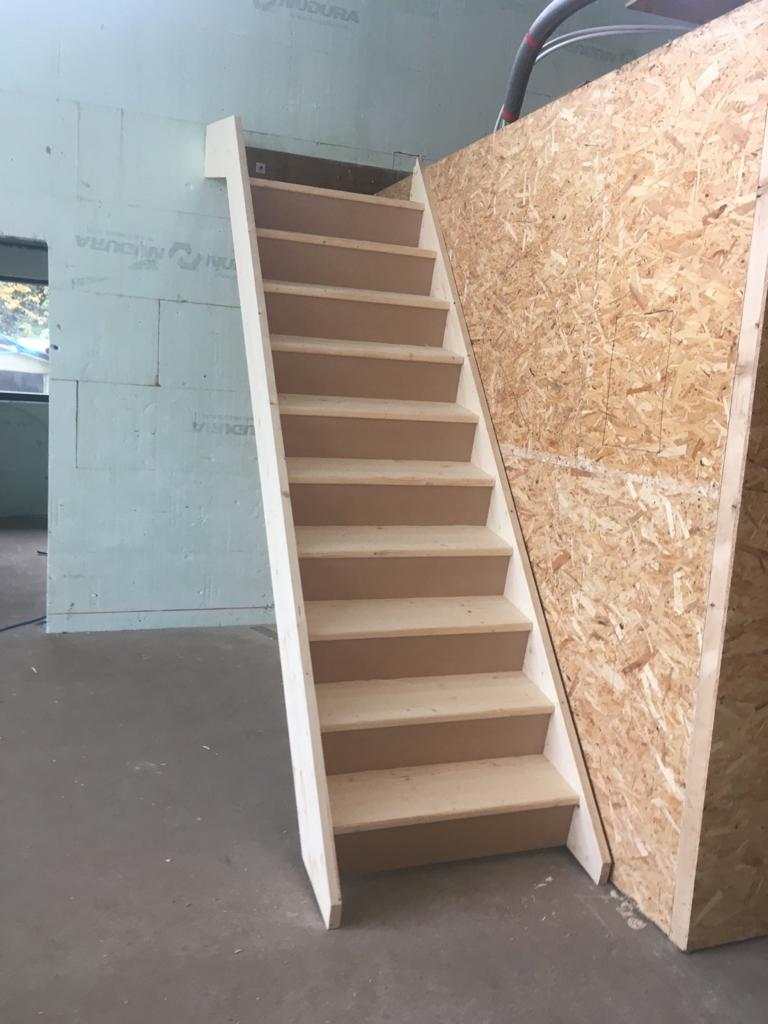

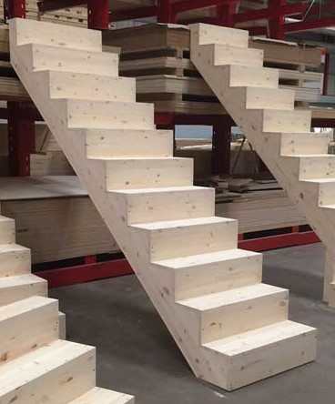

Tom Posted January 10 Posted January 10 Hi All - I need to install two staircases that go up to a mezzanine. Up until now I was just planning on getting something really basic from one of the online retailers (stairbox etc) and then possibly cladding it in ply myself to make it look a bit better. I've been getting quotes of about £500 for a single run, closed stringer with pine treads/risers. A simple staircase like this would be "OK" but now it's actually coming to decision time I'm wondering if there are better options. I would ideally like a cut stringer with a square-edged tread/riser detail - see pic. This looks quite simple (famous last words) and I'm now thinking perhaps I could make it myself out of beech ply. Perhaps I need to take a cold shower instead, but is this feasible? Has anyone on here made their own stairs before? Re balustrade etc, I was thinking along the lines of the scaffold pole stuff that is used for interiors.

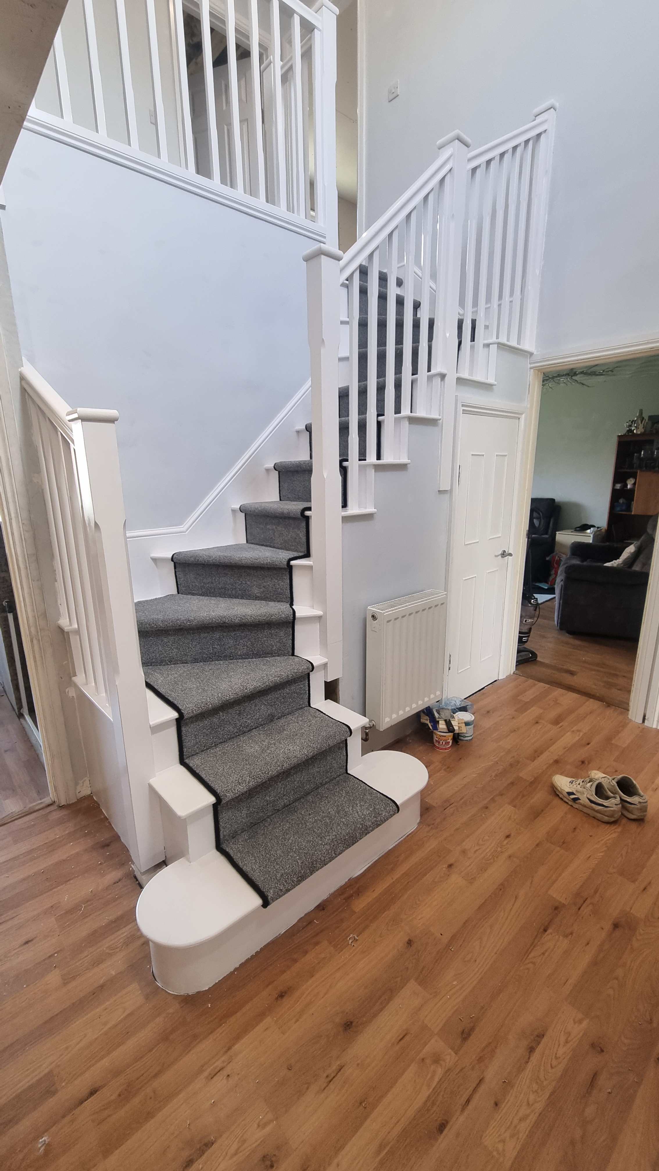

Russell griffiths Posted January 10 Posted January 10 Of course you can make it but is it worth 2weeks of your time to save £200. You will still need to buy the materials. and do you mean birch ply not beech. this very simple set was about £400. I can’t imagine the time it would have taken to make them.
crispy_wafer Posted January 10 Posted January 10 if it's two sets of identical staircases, I'd be tempted to give stairbox/tk or one of the others a call, might just get a discount on account of only a single setup of the cnc machines. Nice project to go at if you've got the skills and tools, but one wrong cut could consign material to the use that for something else pile!
Tom Posted January 10 Author Posted January 10 55 minutes ago, Russell griffiths said: Of course you can make it but is it worth 2weeks of your time to save £200. You will still need to buy the materials. and do you mean birch ply not beech. this very simple set was about £400. I can’t imagine the time it would have taken to make them. Ah yes, birch, not beech. The quote's I got from stairbox etc was about £500 for the sort of closed stringer/standard bullnose sort of stairs as per your pic. The cut stringer, box-profile stairs as per my pic were a shade over £2k! 48 minutes ago, crispy_wafer said: if it's two sets of identical staircases, I'd be tempted to give stairbox/tk or one of the others a call, might just get a discount on account of only a single setup of the cnc machines. Nice project to go at if you've got the skills and tools, but one wrong cut could consign material to the use that for something else pile! As above, the cut-stringer type stairs were £2k each from stairbox (and weren't in birch ply)
Mr Punter Posted January 10 Posted January 10 At least it is only a straight flight. I think these are best made in a factory or very well equipped joinery workshop, but if you feel you have the skills and kit I am sure it would be very satisfying. Post up pics if it looks decent. 1

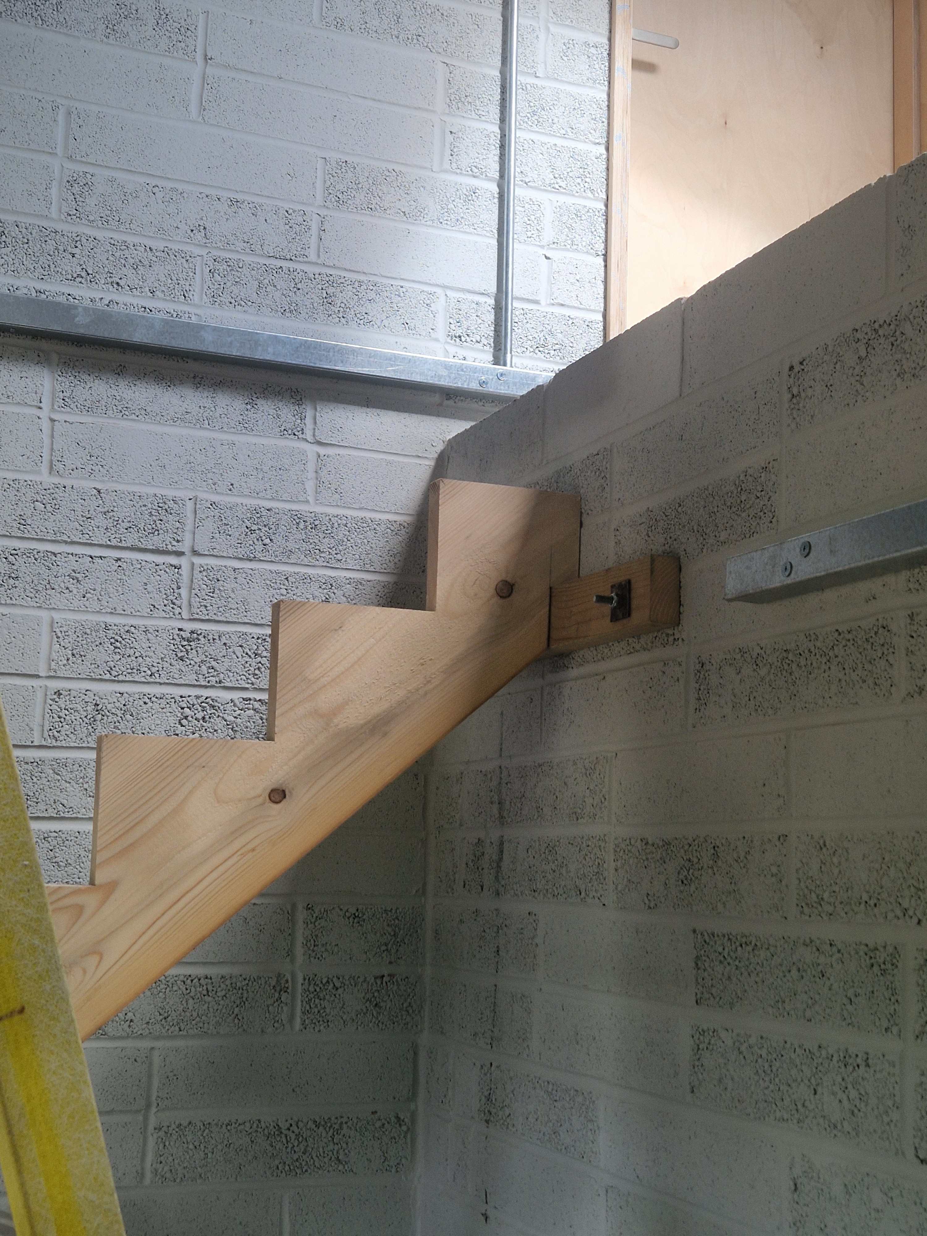

Tom Posted July 8 Author Posted July 8 Hi all, finally got started on my stairs and have cut the first stringer. I've supported the top of the first stringer on a ledger with a bird beak cut in the stringer. Does this look right? Worried it's taken too much meat out of the stringer. Thanks all.
FuerteStu Posted July 8 Posted July 8 Doesn't look too unnatural compared to some staircases I've seen.. I built my own because the quotes were coming out insane for mine. But they were an unusual shape and design 2

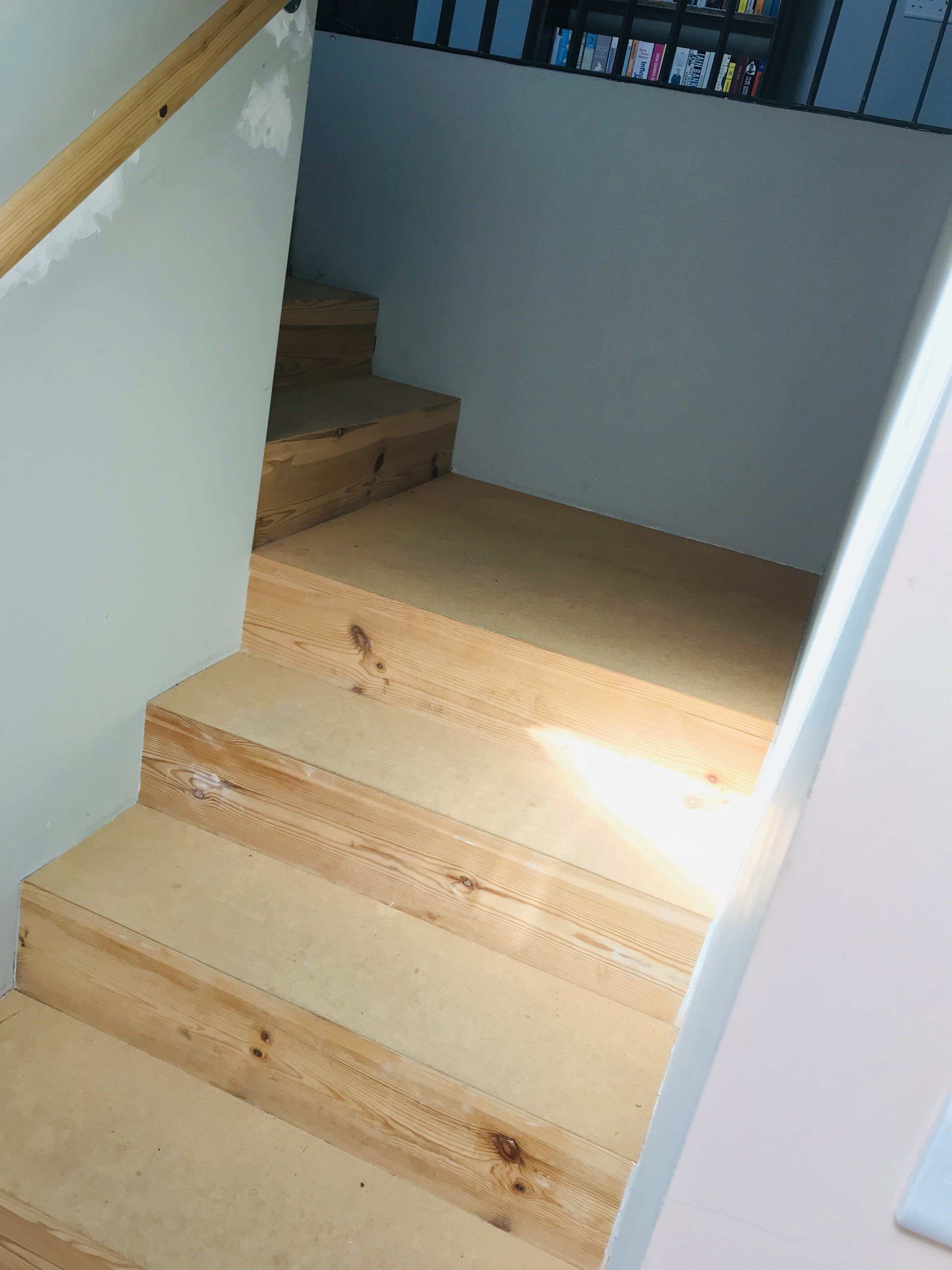

Nestor Posted July 8 Posted July 8 @Tom Home made cut stringer yet to be finished, temporary hand rail etc....yours looks fine. 1

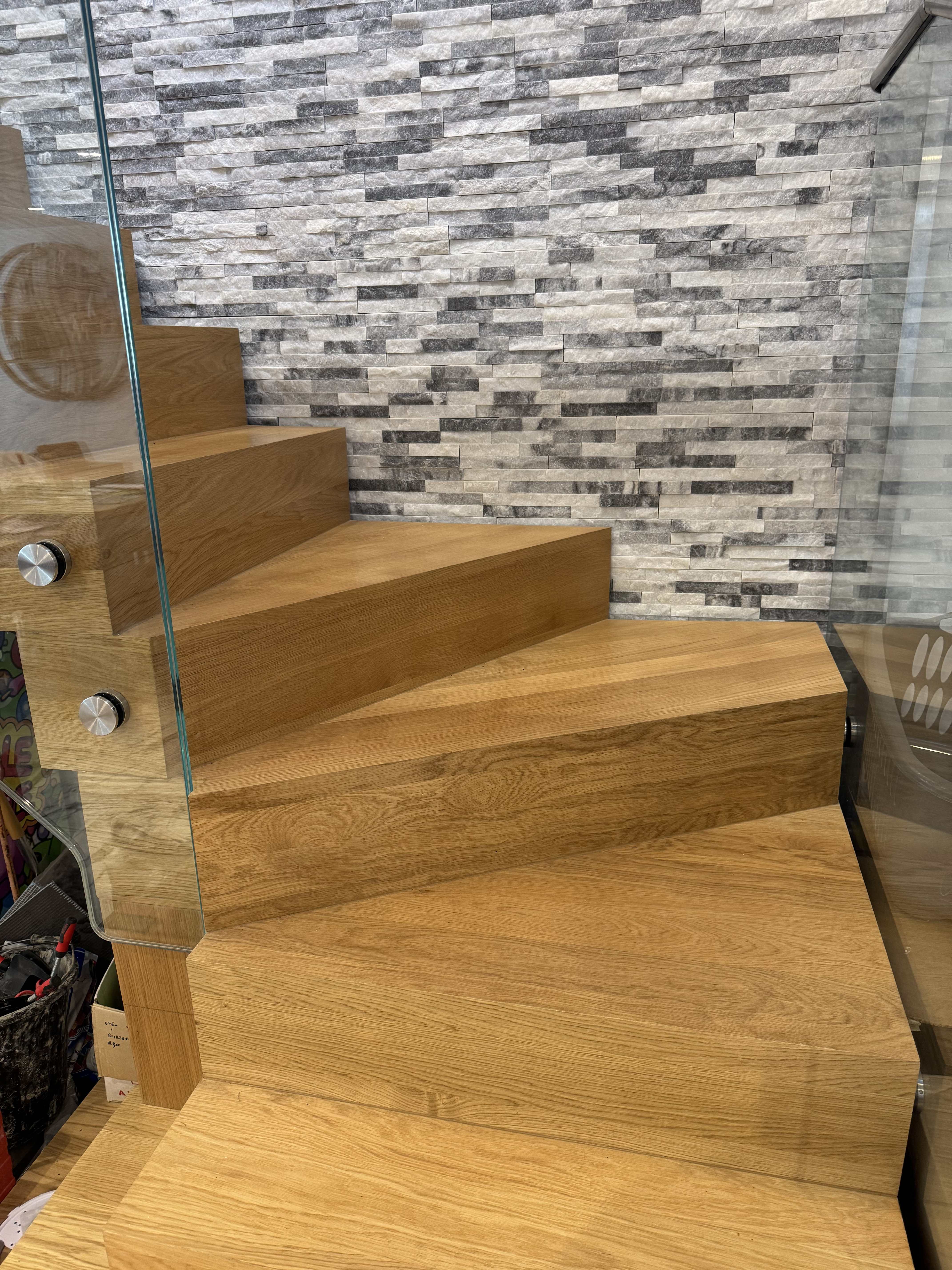

Beau Posted July 9 Posted July 9 On 08/07/2025 at 09:34, Tom said: Hi all, finally got started on my stairs and have cut the first stringer. I've supported the top of the first stringer on a ledger with a bird beak cut in the stringer. Does this look right? Worried it's taken too much meat out of the stringer. Thanks all. I'm no structural engineer but it looks fine to me. Taking that much out of the middle of the stringer would be a different matter As it's turned into share a picture of your home made stairs these are mine and are made of maple and cherry built around a central steel box 3
