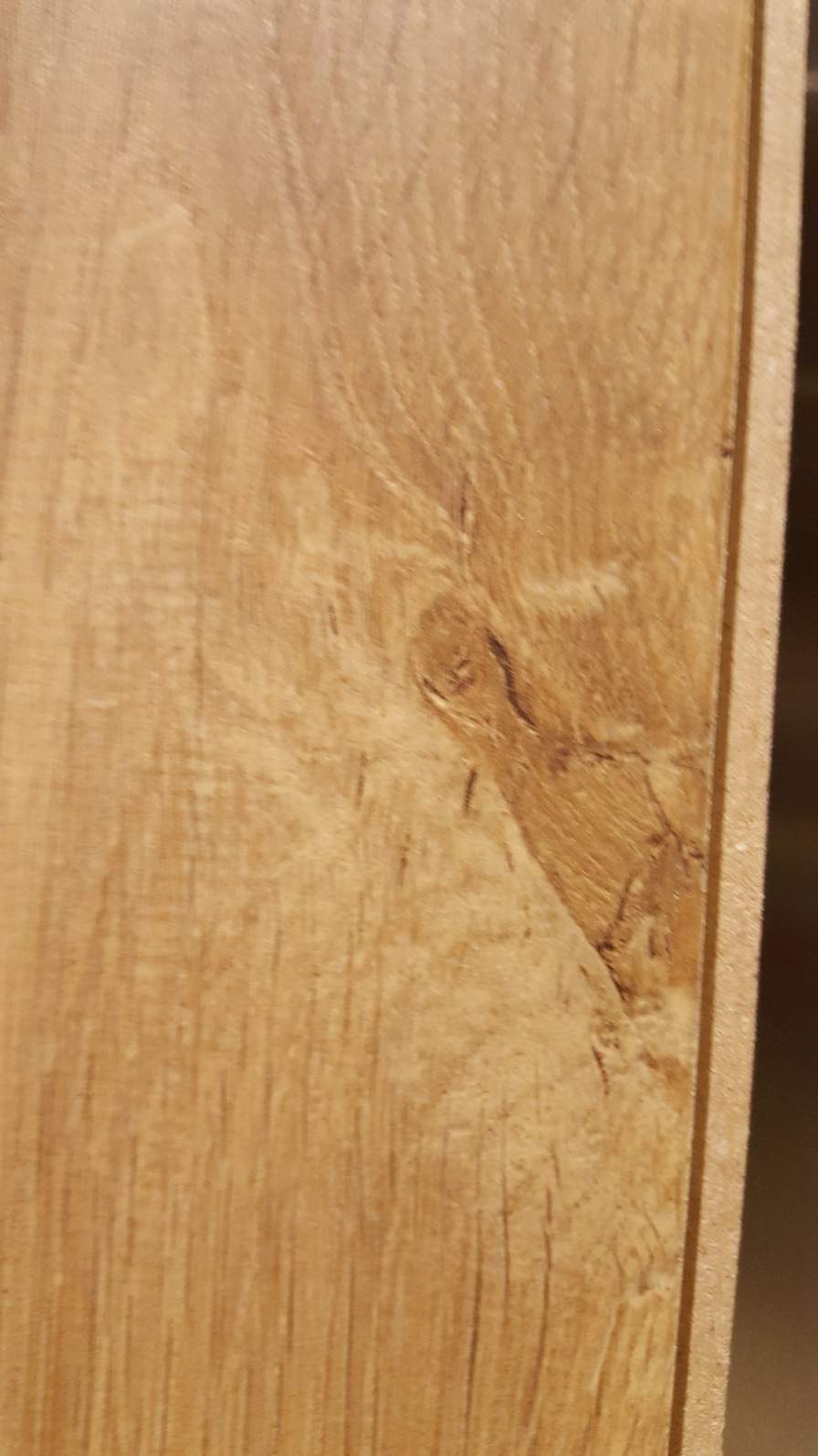

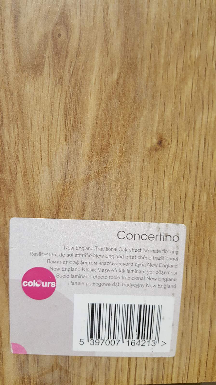

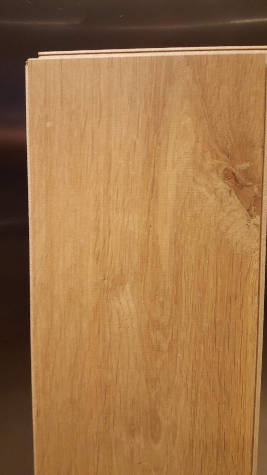

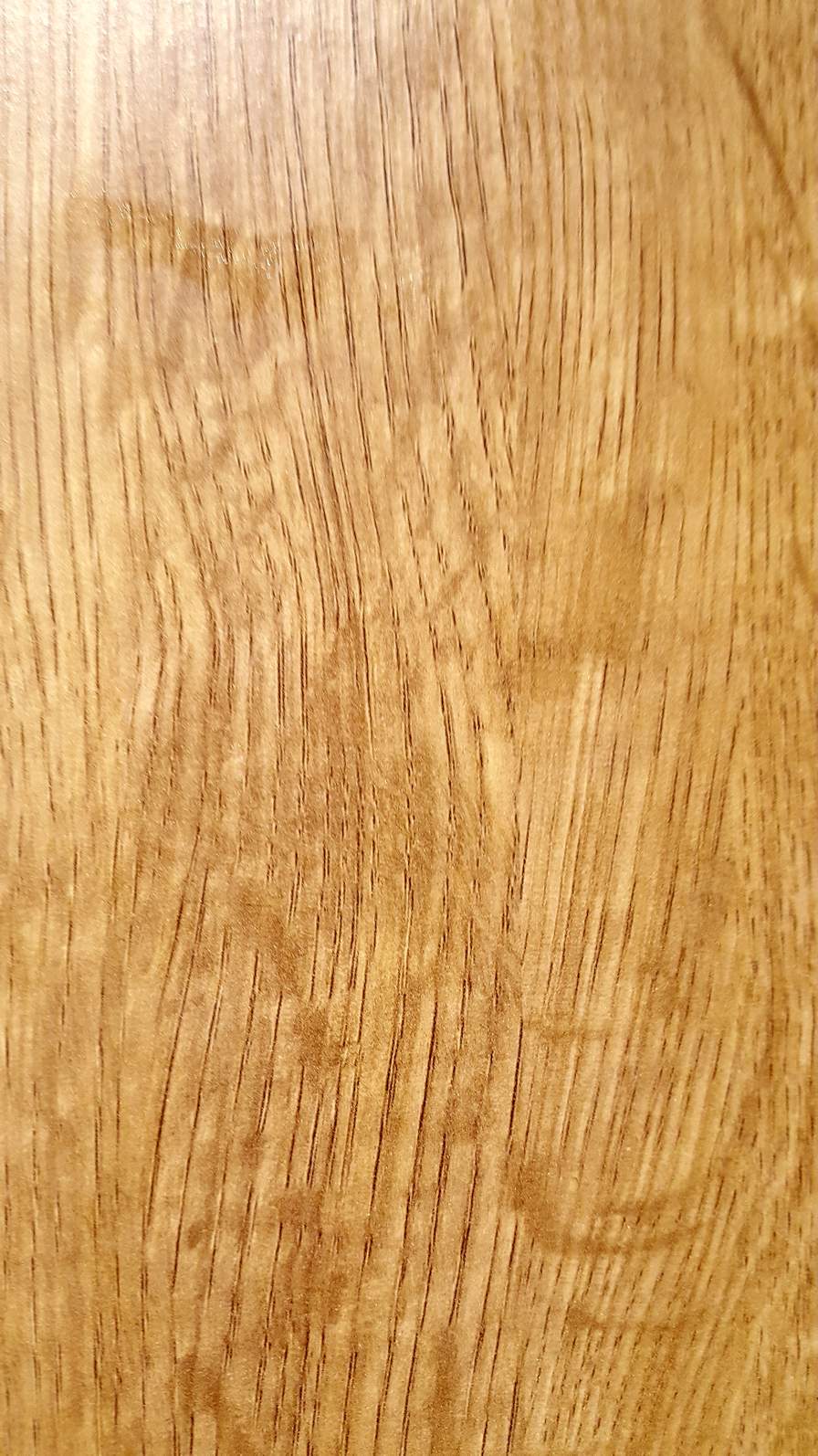

It is interesting to compare the Quick-Step with the equivalent top own brand product. Photos are on a phone, so not quite as clear as could be. QS are far more varied, and even have a cross-ribbed texture which simulates saw-cut feel.From my sample, B&Q still seem to be playing with variable graining.
Quick-Step
20171129_230104-small.thumb.jpg.4a35984cec49a41e5d5a44ab78b690c7.jpg20171129_230300-small.thumb.jpg.920fad9a45bfcc99fc153be9f58c6e8d.jpg
B&Q
20171129_230636-small.thumb.jpg.0381f9baf22f2186c47ffa40fa8fde75.jpg20171129_230654-small.thumb.jpg.de06e19be244914121337361ce1a67ec.jpg
