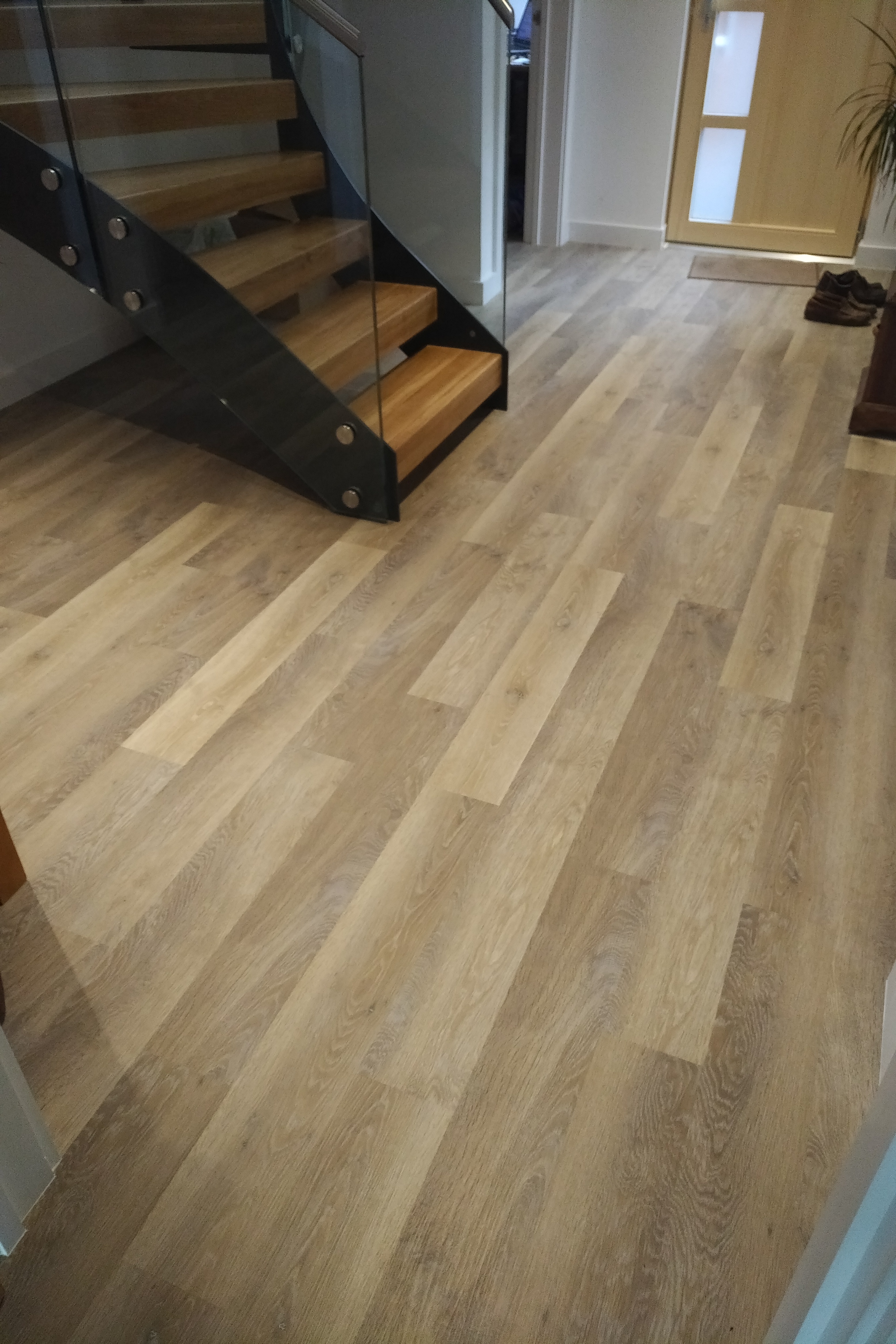

NSS Posted November 27, 2017 Posted November 27, 2017 Yep, very wood like, and as others ha ve said, easy to clean, warmer under foot (even without the UFH I on) and quieter than wood. Also worth mentioning that it's a more forgiving surface when dropping glasses/crockery (my wife is a bit of a 'butter fingers. Here's our hallway... 1

Pete Posted November 27, 2017 Posted November 27, 2017 1 hour ago, NSS said: Yep, very wood like, and as others ha ve said, easy to clean, warmer under foot (even without the UFH I on) and quieter than wood. Also worth mentioning that it's a more forgiving surface when dropping glasses/crockery (my wife is a bit of a 'butter fingers. Here's our hallway... I would agree with all of the above but avoid slightly intoxicated ladies in stiletto shoes putting all their weight through the heel as it left small indents that we had to look at for years.
Pete Posted November 27, 2017 Posted November 27, 2017 I think it is best laid on a solid surface as our floor make up was block/beam with insulation and then a chipboard floor floating but glued edges and in certain light you could make out the ripple effect over the entire floor.
NSS Posted November 27, 2017 Posted November 27, 2017 12 minutes ago, Pete said: I would agree with all of the above but avoid slightly intoxicated ladies in stiletto shoes putting all their weight through the heel as it left small indents that we had to look at for years. Yep, killer heels have to be removed at the door!
