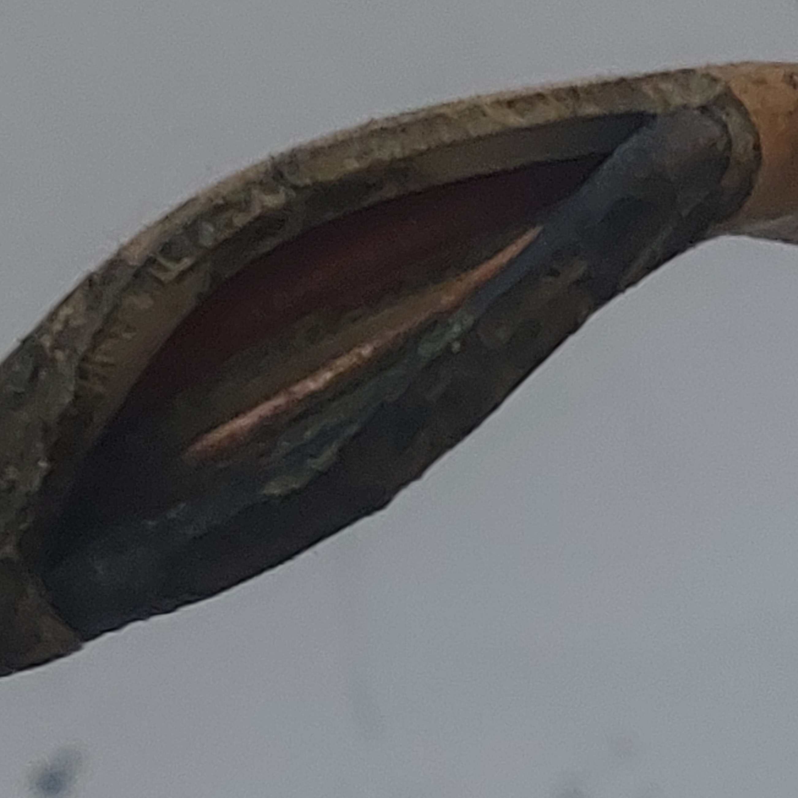

G and J Posted December 22, 2024 Posted December 22, 2024 On 22/12/2024 at 22:40, saveasteading said: Yes that's the plan. I was hoping for such an obvious bit of damage so it's good news. I need advice now on an acceptable way of patching in a repair, eg the boxes. They seem appropriate to me as I can fix them to the joist to avoid any trailing cable. I did, including after the visitors left, taking multiple chargers with them. Expand So it still trips even after your dangerous escapade! Which switch goes?
joe90 Posted December 22, 2024 Posted December 22, 2024 Why not cut out say 100mm of that damaged cable and temporarily connect using a junction box (you seem to have slack if you cut the corner) if the tripping still occurs you have proved this damage was not causing the problem.

G and J Posted December 22, 2024 Posted December 22, 2024 How I’d attack it would be set by whether it’s the RCD or MCB that’s tripping. Either way might be time for a kinetic type switch. 1
FuerteStu Posted December 22, 2024 Posted December 22, 2024 On 22/12/2024 at 23:32, G and J said: How I’d attack it would be set by whether it’s the RCD or MCB that’s tripping. Expand Yep. And if it's an rcbo, the way it trips.. A pop or bang. Is it live to earth, or neutral to earth
G and J Posted December 22, 2024 Posted December 22, 2024 I think @saveasteadingsaid it happens even when the bulb is removed, and I would assume the switch is in the live side, so it is highly likely to be the returning switched live to earth (I think it’s most likely to be within one cable rather than between cables). But assumptions are dangerous things when dealing with stuff put in years ago by unknown dudes.
FuerteStu Posted December 22, 2024 Posted December 22, 2024 On 22/12/2024 at 23:43, G and J said: I think @saveasteadingsaid it happens even when the bulb is removed, and I would assume the switch is in the live side, so it is highly likely to be the returning switched live to earth (I think it’s most likely to be within one cable rather than between cables). But assumptions are dangerous things when dealing with stuff put in years ago by unknown dudes. Expand Unless there is no other load on that circuit. It could be neutral to earth, but without load the rcd doesn't trip as there is nothing to imbalance

saveasteading Posted December 29, 2024 Author Posted December 29, 2024 Sorted. I replaced a section of that gnawed cable, being the least disruptive course of action. It works. Although I can't quite see it, I think the black cable is through to copper. The earth shows some corrosion, white spots not green for some reason. Thus we surmise that water got in there, and was shorting earth to neutral. The red looks to be intact. The only sign of water is the black staining, but a single well aimed drop would be enough. It might have dried out and worked for a while but it is done now. I'm going back up another day to look for a leak (it is tiles on sarking board). I will put some barrier over this area to shield the other blackened cable. Also I noticed that the last electrician up there to connect a toilet fan had not put the insulation back. Someone else's job I suppose would be his view....they are like that here. I'm putting a plumbing query on a new post. 2
