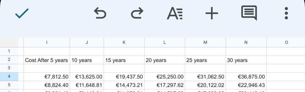

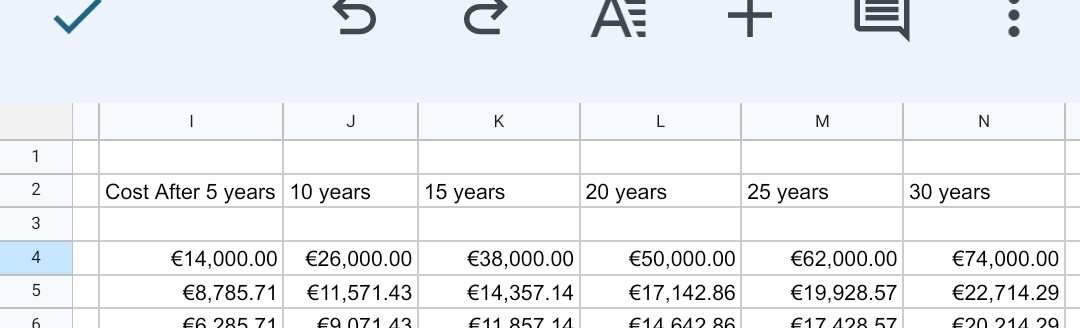

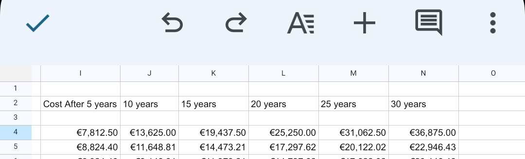

Iceverge Posted November 30, 2024 Posted November 30, 2024 (edited) Forgive my formatting. Spreadsheets on my phone isn't my forte. Here are two examples. The first is UFH electric mats and an immersion. The second is an ASHP and UFH with what I think are realistic install and running costs. This first sheet is for 1000kWh/year and 1800kWh of DHW. Say a 100m2 passive house with 2 occupants. Line #4 is direct electric UFH and an immersion.. Line #5 is ASHP. Break even looks about 12-13 years. This second sheet is with 6000kWH space heating and 3650kWh DHW. Maybe a good Bregs new build with 2 adults and 2 children. This breaks even much earlier, I guess about 2.5 years. ASHP might make sense eventually in the first example but I reckon it'd have cost more in maintenance or needed to be replaced before it ever got the chance to pay itself back. Edited November 30, 2024 by Iceverge
Iceverge Posted November 30, 2024 Posted November 30, 2024 Out of interest, I've done this with lots of combos. I think A2A and solar PV plus divert is probably the cheapest lifetime install for a building that is well enough insulated not to need central heating. 1
