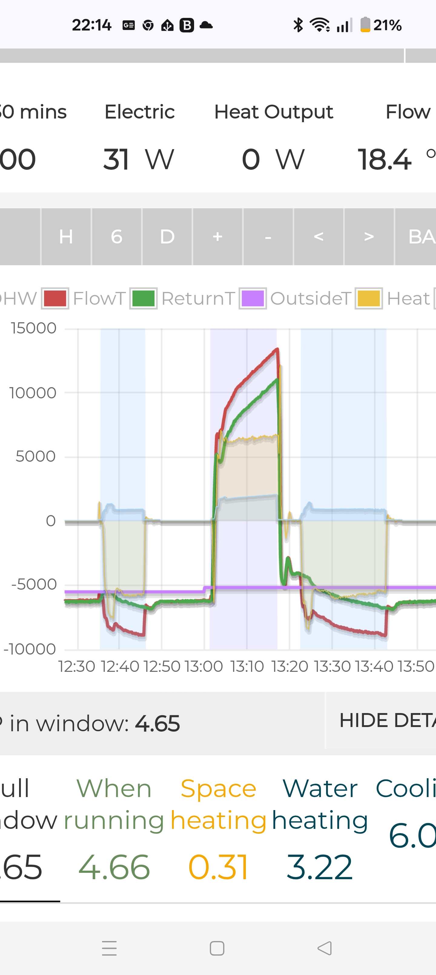

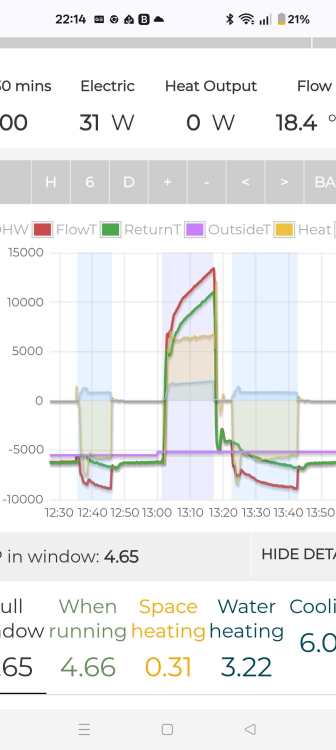

JohnMo Posted July 16, 2025 Posted July 16, 2025 22 minutes ago, SBMS said: So if you switch the pump into cool mode but then the DHW falls for heat it reverts back to heat mode (and then back again to cool mode when water is heated)? Yep, just like below, centre is DHW heating, the blue sections either side are cooling. As soon as there is a DHW call the heat pump swops duty from cool to heat, the diverter valve moves to direct hot water to the cylinder, once complete it all reverts to cooling again.

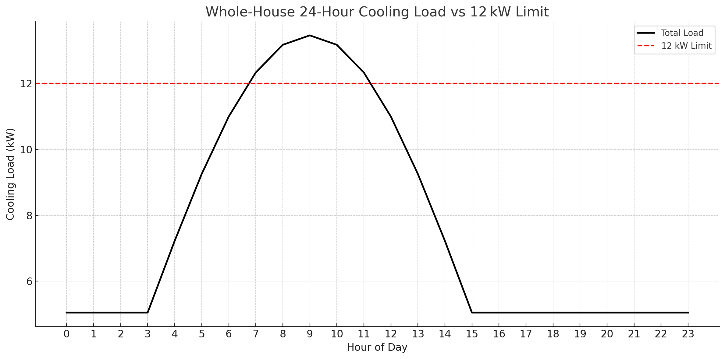

SBMS Posted July 16, 2025 Author Posted July 16, 2025 8 minutes ago, JohnMo said: Yep, just like below, centre is DHW heating, the blue sections either side are cooling. As soon as there is a DHW call the heat pump swops duty from cool to heat, the diverter valve moves to direct hot water to the cylinder, once complete it all reverts to cooling again. Thanks @JohnMo I didn’t realise it was that automated. That’s interesting. I got chat gpt to model my cooling requirements during summer and it spat out this graph taking in my heat loss and cooling data along with this description of how it generated it. It still has a peak of around 13.4kW. 🔍 The whole-house 24-hour cooling load profile I plotted is not based on full peak (worst-case) loads Instead, it is based on: A synthetic sinusoidal profile interpolated between average and peak cooling loads – using column W (Average Load) as the baseline – and column AD (Peak Load) as the afternoon high 📈 What does that mean? At 4:00 AM, each room is assumed to demand only its average load (e.g., from internal gains or mild solar). By 15:00, each room is assumed to hit its peak load (from full solar and ventilation gains). The curve is room-by-room, then summed.
JohnMo Posted July 16, 2025 Posted July 16, 2025 Has the above assumed you leave all your blinds up and just let your room flood with heat. If so that's a flaw in the maths. Also taking some basic things, if your windows are facing south and have no shading, the solar gain doesn't start until you get sun through the window, so late morning onwards. Your peak load is at 9am. So would say your windows are facing east, is that correct? At 9am even on a hot day, it's still cool outside, so open the windows and doors have a blow through, as day starts to get warmer than inside close everything up. Let your cooling, whatever you choose do what it does. AI is great but you need to add a dose of common sense, or you are down a rabbit hole, shite in, yshite out.
SBMS Posted July 17, 2025 Author Posted July 17, 2025 22 hours ago, JohnMo said: Has the above assumed you leave all your blinds up and just let your room flood with heat. If so that's a flaw in the maths. Also taking some basic things, if your windows are facing south and have no shading, the solar gain doesn't start until you get sun through the window, so late morning onwards. Your peak load is at 9am. So would say your windows are facing east, is that correct? At 9am even on a hot day, it's still cool outside, so open the windows and doors have a blow through, as day starts to get warmer than inside close everything up. Let your cooling, whatever you choose do what it does. AI is great but you need to add a dose of common sense, or you are down a rabbit hole, shite in, yshite out. Good point. It made a mistake and I’ve time shifted it now. But it does still make me think… it’s pretty hard to model correctly the cooling load.

JamesPa Posted July 18, 2025 Posted July 18, 2025 (edited) 14 hours ago, SBMS said: Good point. It made a mistake and I’ve time shifted it now. But it does still make me think… it’s pretty hard to model correctly the cooling load. Very true. But in reality, for many properties, there are only a few days in the year that cooling is needed, providing you are sensible with curtains and windows, and only a few rooms are likely to be affected. Most people are more tolerant of over temperature than under temperature, so the precise control we are used to for heating isn't always necessary for cooling and its unlikely to be necessary to cool to the 20C most heat to. For example my (200sq m, 7kW heating load, 1930s) house faces south and there is a large patio door in the room we spend most time in. I have one fancoil in that room (in an otherwise all radiator system) and it makes sufficient difference (with the heat pump run above dew point) to get from horribly hot to pleasantly warm. The only other room where there is a material problem is the master bedroom, which has an oversized type 33 static rad that I plan to add a bunch of computer fans to in order to hopefully get some cooling (Andre Kuhne on openenergy monitor did exactly that and got a 4C room temp reduction, which is a worthwhile difference). I do wish I'd put in a couple more fancoils (TBH I didn't realise how good they can be) but I can live without. For me at least it's simply not worth spending the money to get more sophisticated given the few days it's necessary. Obviously it's very house and person dependent and the frequency of hot days may well increase, but I for me at least it doesn't merit a whole separate system. If I were building from scratch I'd just do UFH and/or fancoils and keep above dewpoint. Perhaps I'm just mean? Edited July 18, 2025 by JamesPa
