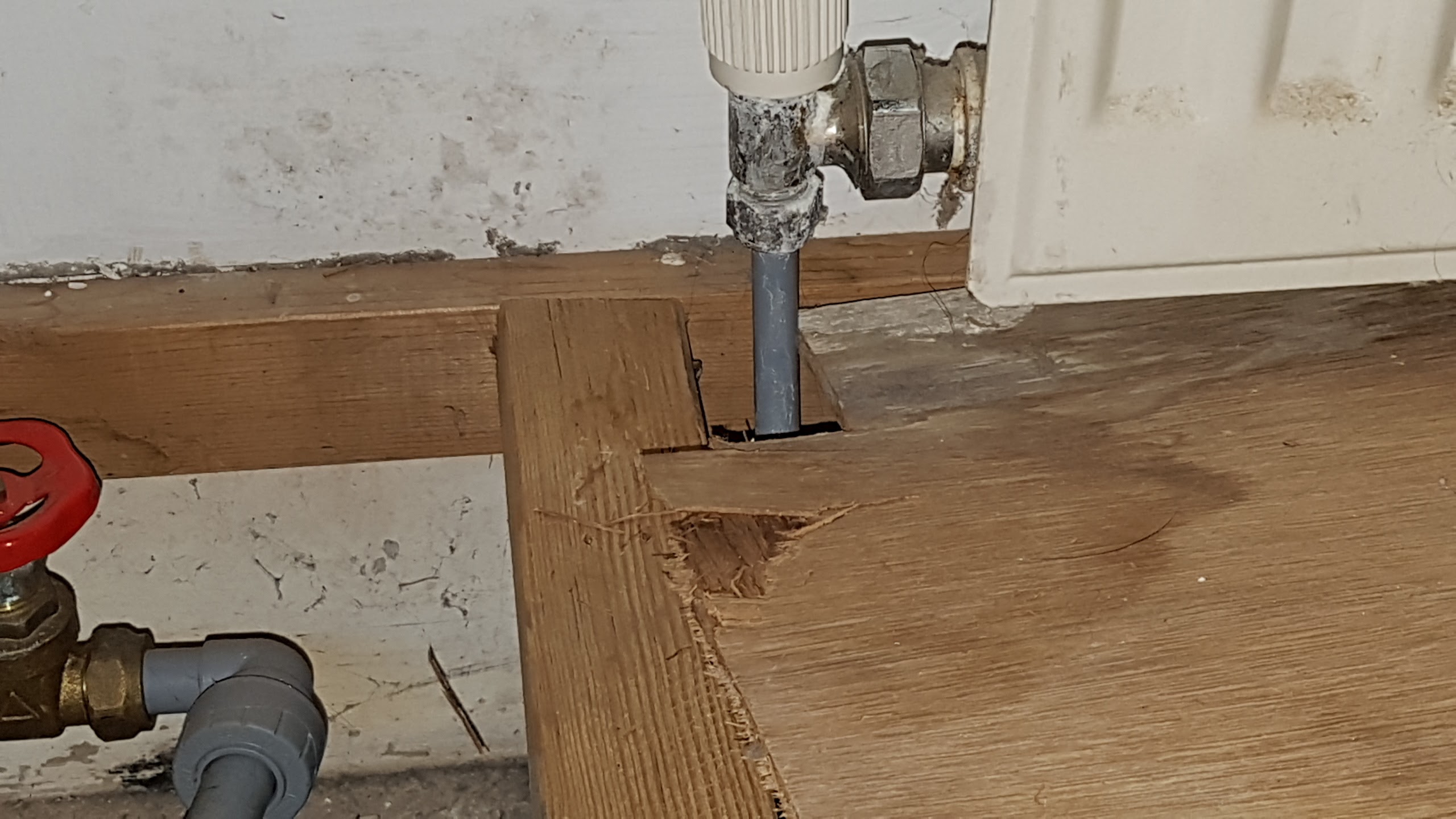

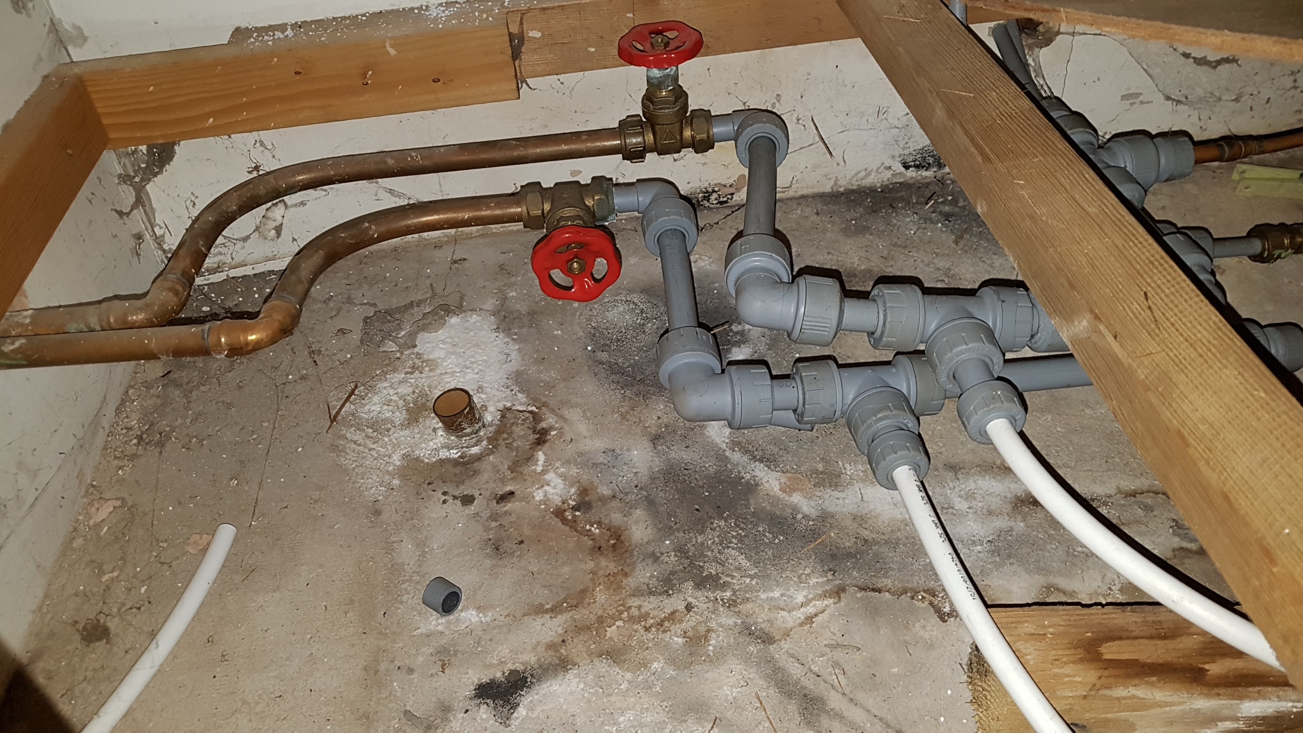

ToughButterCup Posted November 17, 2017 Posted November 17, 2017 Hoostun, we have a prablerm. I'll save you the sob story.I need to know what this stuff is. Our local BMW are experts at making me feel like an idiot when I go in and ask for stuff I've never used before. So could you please tell me what this stuff is, please..... It's a loop containing 3 radiators in our central heating system And I think this valve is leaking... What do you think? Any guidance would be most welcome. Ian
Tennentslager Posted November 17, 2017 Posted November 17, 2017 I did a search on Google images...looks like PolyPlumb fittings. Now that's an answer but only if it relates to the question you are asking!
PeterW Posted November 17, 2017 Posted November 17, 2017 Which “stuff” do you want identifying ..?? The grey fittings look like PlumbSure or similar - usually from the likes of B&Q. That rad valve looks to have a weep from the spindle but nothing serious unless there is a pool of water I can’t see..?
MikeSharp01 Posted November 17, 2017 Posted November 17, 2017 Whatever it is it can connect to or be replaced by any of the standard push fittings HEP20 or John Guest for instance. You just need the diameter of the pipe to get the right bits. Looks like the grey stuff and the copper is 22mm while the white stuff (looks remarkably like John Guest pipe) is 15mm and the ends of the white pipe go into reducers which provide 22mm male to 15mm female connections.
ToughButterCup Posted November 17, 2017 Author Posted November 17, 2017 What do I want to know? The trade names of the plastic piping: both the white stuff and grey stuff. If you look at the top right of the top right photo, the plastic stuff re-connects to copper piping - but if you look at the radiator that that loop serves, the piping is plastic where it goes into the valve. So for one or two of our radiators on the feed side, the water travels through copper, then plastic, then copper then plastic piping . On the way back it's just plastic. I think our system must have been built by a cobbler, not a plumber.
Gone West Posted November 17, 2017 Posted November 17, 2017 (edited) There are a couple of old Hep2O fittings along with old Plumbsure fittings and a mixture of Hep2O (grey) and Speedfit (white) piping. Edited November 17, 2017 by PeterStarck

Gone West Posted November 17, 2017 Posted November 17, 2017 Possibly the grey Hep2O piping may not have an oxygen barrier.

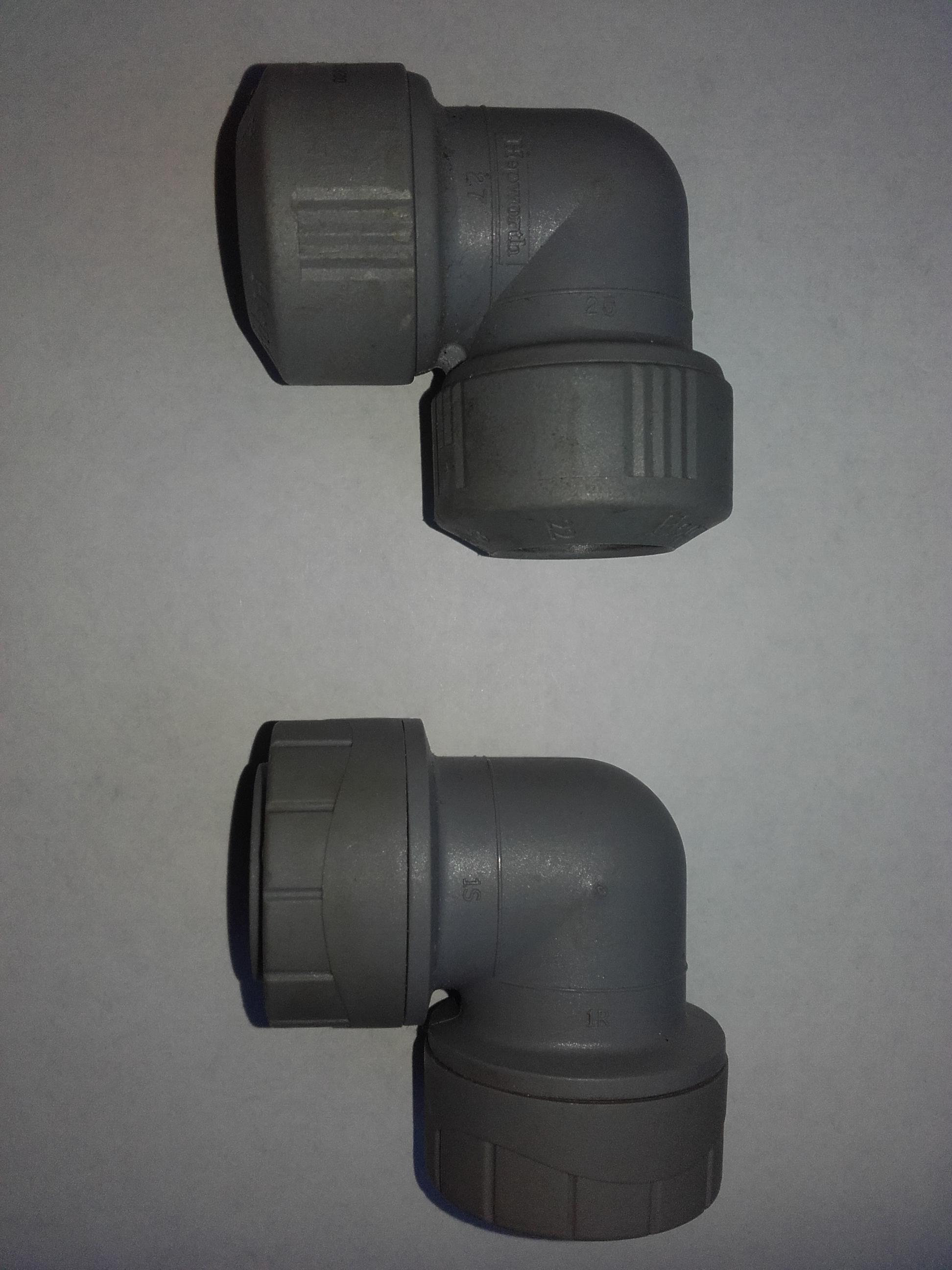

Onoff Posted November 17, 2017 Posted November 17, 2017 (edited) OK, my loft is full of the grey fittings but with copper pipe. There's a few loose fittings here and there that I've collected. The top photo is Hep2O - see the vertical marks on the "nut". Guessing 20 years old as that's when the boiler and upstairs rads were put in. The bottom one with the "wavy" line is from stuff I bought in the last few years. It's unmarked brand wise but I thought up until now it was Hep2O. The designs are very similar. Don't FFS make the mistake I did and try and interchange parts between the two brands. Only time I've had a leak! You seem to have the same mix of grey fittings that I do. Edited November 17, 2017 by Onoff

Gone West Posted November 17, 2017 Posted November 17, 2017 Back in the 90s the original Hep2O pipe didn't have an oxygen barrier which meant oxygen passed through the pipe walls and into the water. In a central heating system it resulted in corrosion on the radiators etc. even with inhibitor.
PeterW Posted November 17, 2017 Posted November 17, 2017 (edited) On 17/11/2017 at 08:28, recoveringacademic said: Que? Oxygen barrier?...... Plumber-speak for leak? No - plumber speak for cheap as £&!# pipe .... Not strictly needed but you can get some oxygenation of the water and corrosion but it takes decades ... leave those gate valves alone too - short length of 22mm copper in each valve, same with the rad tails and then replace the lot with Hep2O. Get some decent pipe shears too ... Edited November 18, 2017 by Nickfromwales Typo
ToughButterCup Posted November 17, 2017 Author Posted November 17, 2017 1 minute ago, PeterStarck said: Back in the 90s the original Hep2O pipe didn't have an oxygen barrier which meant oxygen passed through the pipe walls and into the water. In a central heating system it resulted in corrosion in the radiators etc. even with inhibitor. Got it in one. Exactly what we are suffering. It's all the rads which are in the old style HEP2O loop. Excellent tenente!

ProDave Posted November 17, 2017 Posted November 17, 2017 Isn''t your "problem" the leaking radiator lockshield valve? Isn't that what you are looking to replace?

ToughButterCup Posted November 17, 2017 Author Posted November 17, 2017 1 hour ago, ProDave said: Isn''t your "problem" the leaking radiator lockshield valve? Isn't that what you are looking to replace? Yes. But I'm also taking the plumbing bull by the horns (Bit like @jamiehamy) I've been scared of it the whole of my life, but not any more. '... Lockshield valve...' It's just a plain valve isn't it. What does it lock and what does it shield? 1 hour ago, Onoff said: Couldn't you just buy some time with a power flush? That looks like fun. (YT research) But I will want to sell our house this spring and its needs to be done pucca. By me Ha! 1 hour ago, PeterW said: [...] Open systems with F&E tanks caused a lot of issues, as did a mix of lower quality radiators [...] That's exactly what we have, an F&E system (Sound like I know what I'm on about dunnit? ) And the rads were probably 17th hand by the time they were fitted. Looks like an interesting weekend ahead. 1
