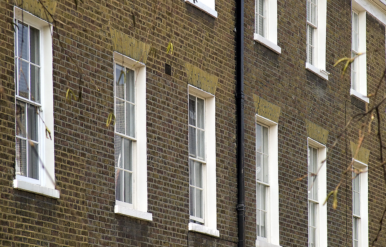

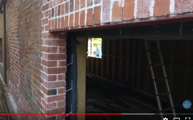

Construction Channel Posted November 15, 2017 Posted November 15, 2017 Howdy Everyone. I'm looking for ideas on how to "deal with" my external window reveals. this week i have been making the formwork to cast my cills which has brought back up an issue I was happily ignoring. To be sensible I need to have the external edge of my windows and doors flush (ish) with my timber frame else all my heat is going to flow into my ventilated cavity. this will leave roughly a 100mm cavity and then either 4 or 9 inches of brickwork. shown here badly now I have never seen how anyone else has got over this with brick. it would be obvious for render or cladding but brick??????? only thing i have thought of so far was to try and emulate this look initially, i thought to render it as they have but then I need to fix something to thin air over the cavity. then I considered using some kind of cement board as that would bridge the cavity well but it would involve painting so not going to happen, the current plan is to use a flush plastic fascia (windows will be white plastic) https://www.roofingsuperstore.co.uk/product/16mm-upvc-magnum-flat-fascia-board-cover-5m-x-150mm-white.html I would mitre bond (superglue) it to the window and ct1 it to the brickwork, the plan would be to still leave some of the brick showing (30-40mm) to hide some of the "discrepancies" of the back wall. anyone else got any good ideas? I would normally just try it but I can't find anywhere without a delivery charge on "flush fascia" so if i buy any i will buy enough to do the lot TIA Ed

Construction Channel Posted November 15, 2017 Author Posted November 15, 2017 1 minute ago, Ferdinand said: What is the look of your finished building? hmmm, I think the only true answer would be "not sh1t" essentially i need it to look like the old barn but that didn't have windows and all the surrounding building have just brick reveals, but they didn't have a cavity to hide 5 minutes ago, Ferdinand said: Can you use a resinous hardwood to make the reveals plus span the cavity, and leave them little treated or untreated? I like this, only thing would be the maintenance, I realise it would be minimal but i am trying to avoid any at all. I will have to have a good hard think on this one though, Iv got oak for days, and wood is technically "what i do" 7 minutes ago, Ferdinand said: Alternatively can can you use one of the no maintenance cladding products such as Cedral that was what i was thinking when i said "cement board" problem is on the rear wall i need it to go to about 250mm to cover my cavity trays, i suppose they do a soffit that would work.... no. It will need painting eventually and TBH i prefer either the wood or the plastic...... hmmm wood. Thanks for the help

Brickie Posted November 16, 2017 Posted November 16, 2017 So,just to clarify,you're positioning the frames flush with the inner leaf?
Construction Channel Posted November 16, 2017 Author Posted November 16, 2017 That’s the plan at the moment. Flush with the outside edge of the timber frame. And before you say it I know the easiest way would have been to return the bricks but it’s far too late for that.
ProDave Posted November 16, 2017 Posted November 16, 2017 How about get a couple of 100mm thick sheets of wood fibre board. Cut into strips say 200 to 300mm wide and insert into the cavity. In effect an insulated cavity closer. Then render over that and the brick reveal to give the look you want. Might need something to stick the wood fibre if it's not an interference fit into the cavity.

Declan52 Posted November 16, 2017 Posted November 16, 2017 1 hour ago, Construction Channel said: That’s the plan at the moment. Flush with the outside edge of the timber frame. And before you say it I know the easiest way would have been to return the bricks but it’s far too late for that. The half brick you cut out will do the course above so it's only a full brick that gets slipped in to where the half brick was. Not a big job and will look much better than a piece of wood or plastic..

Brickie Posted November 16, 2017 Posted November 16, 2017 Can you not insulate around the reveal & fix the frame in line with the cavity? If there's enough play in the size of the frame maybe insulated plasterboard up the reveals too?
Construction Channel Posted November 16, 2017 Author Posted November 16, 2017 thanks for all the responses guys. Ill start at the top 8 hours ago, ProDave said: How about get a couple of 100mm thick sheets of wood fibre board. Cut into strips say 200 to 300mm wide and insert into the cavity. In effect an insulated cavity closer. Then render over that and the brick reveal to give the look you want. If im going to insulate the cavity I will use Celotex as I am already using it and will be a lot easier for me to get hold of. the issue i was thinking about with the cavity tray is this. if i fill the red area with insulation moisture could potentially track along the blue line (realistically it would hit the plastic closure and probably be alright but it still worries me. other option would be to only put 100mm in but then it would have less insulation than the rest of the house and would be a "cold spot" 8 hours ago, PeterW said: I’ve got some magnum soffit board hanging about if you want some to try it ..? It’s 9mm rather than the 16mm of the fascia thats a very kind offer but iv got a bunch laying about too, my worry with soffit is the rounded edges wont look quite as crisp and it will be a lot harder to get the front edge nice and straight. 8 hours ago, Declan52 said: The half brick you cut out will do the course above so it's only a full brick that gets slipped in to where the half brick was. Not a big job and will look much better than a piece of wood or plastic.. its big enough for me to not want to do it also for some of the front windows i would have to corbel from a few courses down to get a header in the right place to cantilever, iv only just laid all those bricks 7 hours ago, TerryE said: The inner frame and the outer skin have different material and thermal characteristics so you will always get some form of shear movement between them, even if the odd mm. If you mount your windows in the brick then this will always end up compromising the airtightness of the build. If you mount the windows in the frame, immediately behind the brickwork then this shear line is at your outer weatherproofing mastic seal. even if i fit them in the brick skin (which is what i would ideally like to do) i would still not actually fix to the bricks, i would fit them with straps back to the timber frame which should get over this problem. 7 hours ago, TerryE said: I don't understand your point about the PUR being close to the cavity tray. You have to do this for two story buildings or higher to form a proper fire stop (remember Grendfell tower). hopefully my fantastic illustration will explain better. 8 hours ago, TerryE said: I realise that it might be a bit late yes it is i considered flaring my openings, especially my veluxes but unfortunately that is about as far as it went, 7 hours ago, Brickie said: Can you not insulate around the reveal & fix the frame in line with the cavity? If there's enough play in the size of the frame maybe insulated plasterboard up the reveals too? i could probably get away with a little, maybe the thinner thermal plasterboard. Thanks again for all the help, i really need to mess about with some fascia in the daylight and see how i feel about it, if it does look as hateful as i fear it might ill just have to bring the window forward, insulate the cavity and have a slightly colder spot. not the end of the world i suppose...
