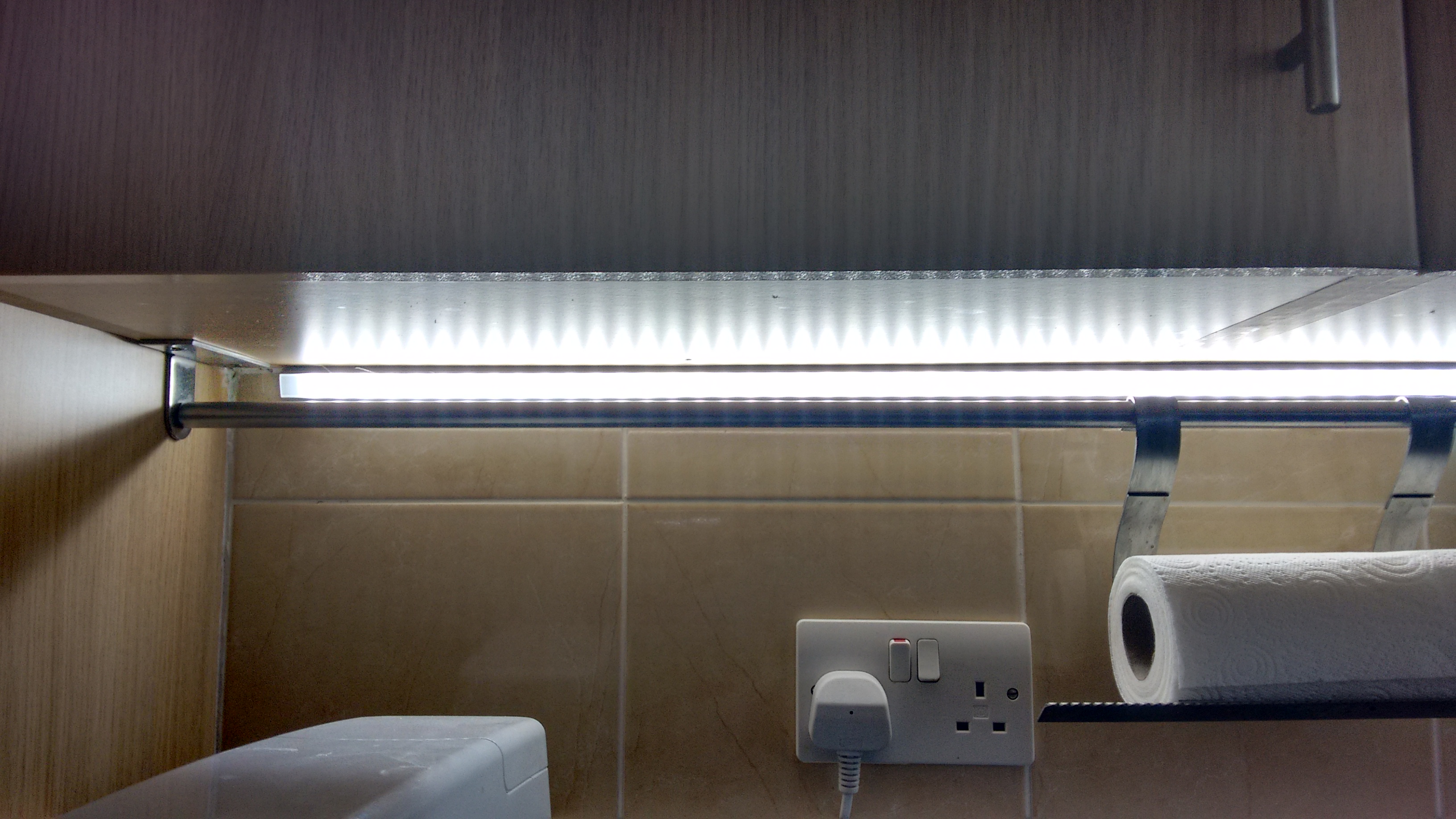

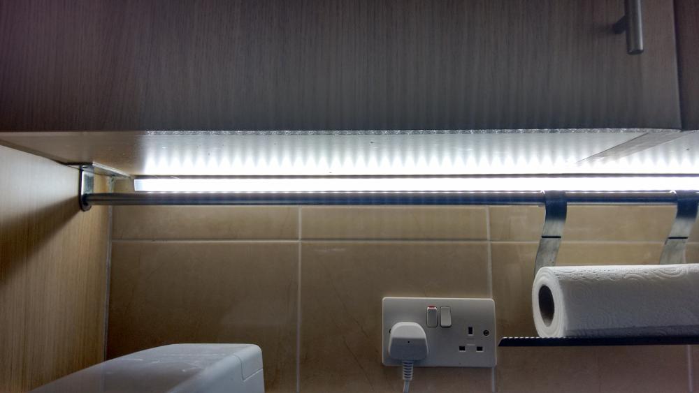

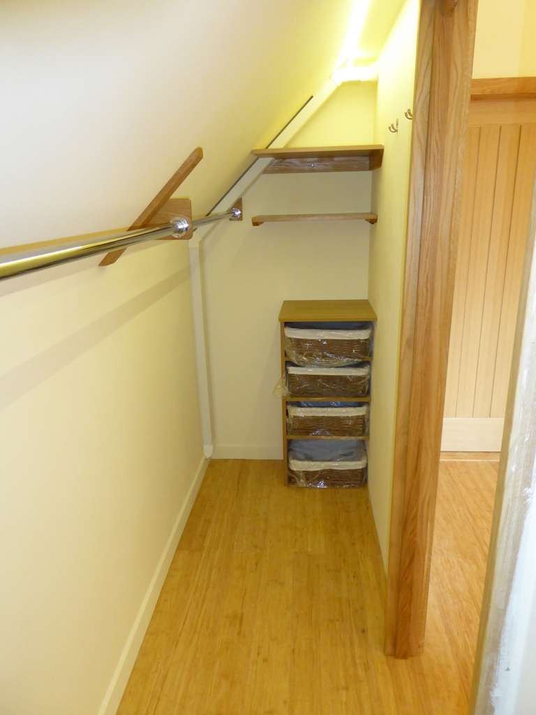

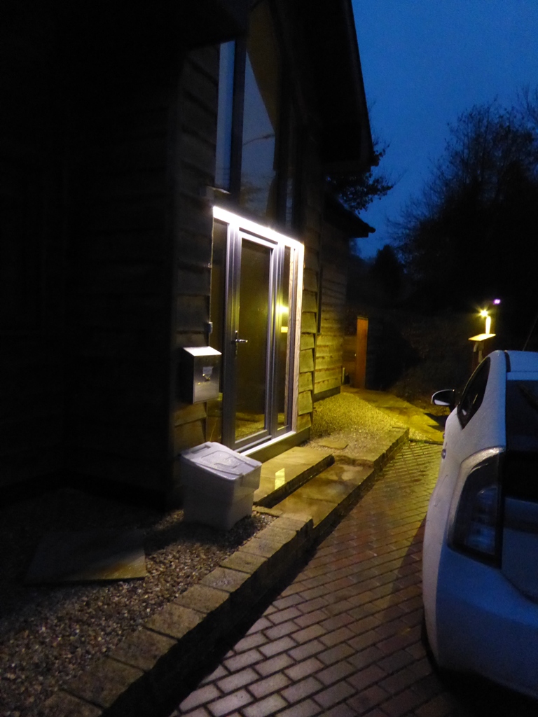

Jeremy Harris Posted November 12, 2017 Share Posted November 12, 2017 I've used lots of LED strip, ranging from these inset into the rain drip groove on the joining cill above our front door: to strips under our wall units in the kitchen, to locally light the work surfaces. I also used long lengths to light up our walk-in wardrobe, set right up in the apex of the ceiling: A couple of weeks ago I fitted long lengths in our eaves storage areas, just to make it easier to find stuff. I've also fitted strips under the shelf above my workbenches and in the cupboard under the stairs. Generally, the lower powered stuff doesn't really need a heat sink at all, and I have found no difference at all in terms of quality from LEDHut or a couple of Ebay sellers. I had one duff roll of 5630 warm white strip (the stuff that I used for the light over the front door), where the bonding between the main flexible PCB and the secondary flexible PCB underneath it (the one that's there to take the higher current of 5630 LEDs) was poor, but that was easily fixed by just gluing the separated parts back together again. Only the section outside, over the front door, is effectively mounted on a heat sink, as it was exactly the same width as the groove in the alloy cill (which was a bit of luck). What I have found is that the self-adhesive tape is fussy about what it sticks to, but the fix I've come up with for all the strips where you can't really see them directly is to stick a layer of aluminium tape down first, then burnish that with something very smooth so it bonds down well, and then stick the LED strip to that. Not only does that give a much better bond, but the aluminium tape adds a bit of back reflection (and a very tiny bit of heat sinking). The major difference between these strips is in the type of surface mount LED they use and the colour of the light. At the very low output end there are strips that use 3528 LEDs, which are not at all bright, but OK for places where you just want a very gentle light. I've used some low power 3528 strip as outside lighting, solar powered, like all out outside lights (including the strip over the front door) and they are good enough, but only really as light to mark the edge of the drive. Next up come the 5050 LEDs, and these are pretty good general purpose lighting - the wardrobe above has warm white 5050 strip. Top of the light output seems to be the 5630 LEDs, and these are what I used above the front door. They are very bright, but they also draw a lot of current, and for long lengths they either need to be fed with power at both ends or they need to be the type with the extra flexible PCB bonded under the main one. It's hard to tell without getting samples which is which. As a final not of caution, then choose the 12V power supply for these carefully. Some of the cheaper ones can emit a fair bit of RF interference, creating noise on radios and interfereing with wireless remote controls. Also, I made the mistake of using some dimmable electronic 12V DC halogen light power supplies, and these do not put out clean DC, but rather pulses of DC at a high frequency. There was no radio interference, but the high frequency flicker was noticeable when you made a sudden head movement, and sufficiently annoying that I ended up replacing them. 1 Link to comment Share on other sites More sharing options...
