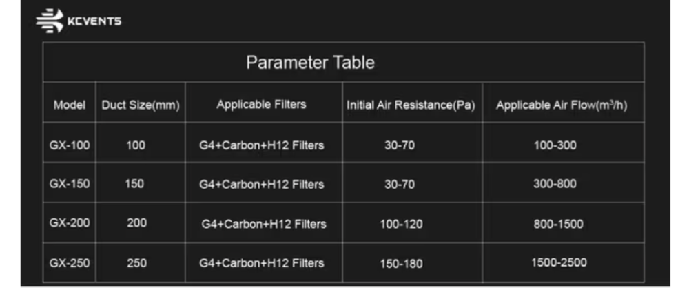

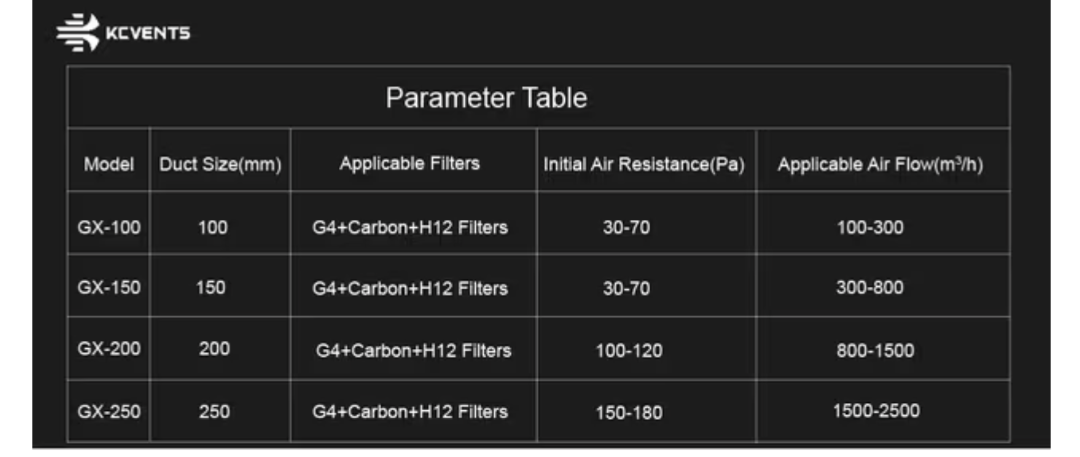

JohnMo Posted September 25, 2024 Share Posted September 25, 2024 Here is an alternative https://www.aliexpress.com/item/1005003455622982.html?src=google&src=google&albch=shopping&acnt=494-037-6276&isdl=y&slnk=&plac=&mtctp=&albbt=Google_7_shopping&aff_platform=google&aff_short_key=UneMJZVf&gclsrc=aw.ds&&albagn=888888&&ds_e_adid=&ds_e_matchtype=&ds_e_device=m&ds_e_network=x&ds_e_product_group_id=&ds_e_product_id=en1005003455622982&ds_e_product_merchant_id=527456140&ds_e_product_country=GB&ds_e_product_language=en&ds_e_product_channel=online&ds_e_product_store_id=&ds_url_v=2&albcp=17859500389&albag=&isSmbAutoCall=false&needSmbHouyi=false&gad_source=1&gclid=CjwKCAjw6c63BhAiEiwAF0EH1MrTImL6T5sg-4vdV9V4pJsXZrbU5HeTBo5qkiis0U3iu0Em4qvraxoC6isQAvD_BwE Link to comment Share on other sites More sharing options...
benben5555 Posted September 25, 2024 Author Share Posted September 25, 2024 I did see that one on AliExpress, but initially wrote it off thinking it may be suspect quality. It lists the pressure drops and airflow, but I don't understand if these would be an issue Link to comment Share on other sites More sharing options...

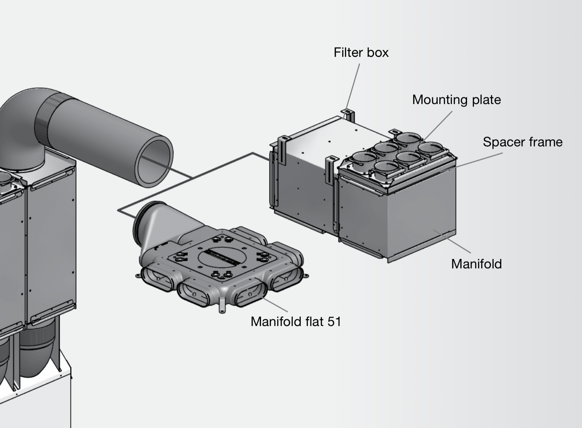

Nick Laslett Posted September 25, 2024 Share Posted September 25, 2024 My MVHR is still not commissioned. But I’m always amazed that this topic doesn’t generate more discussion. Of course circumstances differ, but I’m in the countryside with 2 neighbours that have log burners going all winter. I went with the Zehnder comfowell filter box because it will be easy to get hold of the filters over the long term. You will need to size the filter box to your system requirements. 1 Link to comment Share on other sites More sharing options...
JohnMo Posted September 25, 2024 Share Posted September 25, 2024 1 hour ago, benben5555 said: pressure drops and airflow, but I don't understand if these would be an issue Really depends on your system design and where you sit with regard pressure drops. More pressure drops require higher fan speed and more potential noise. You can always go big and use reducer to you duct - bigger the filter the lower the pressure drop. 1 Link to comment Share on other sites More sharing options...
benben5555 Posted September 25, 2024 Author Share Posted September 25, 2024 3 hours ago, Nick Laslett said: My MVHR is still not commissioned. But I’m always amazed that this topic doesn’t generate more discussion. Of course circumstances differ, but I’m in the countryside with 2 neighbours that have log burners going all winter. I went with the Zehnder comfowell filter box because it will be easy to get hold of the filters over the long term. You will need to size the filter box to your system requirements. Thank you! This I think is what I've been searching for! Which size did you use and where is it mounted? Between intake and MVHR unit? Or before the manifold? Link to comment Share on other sites More sharing options...
Nick Laslett Posted September 25, 2024 Share Posted September 25, 2024 3 minutes ago, benben5555 said: Thank you! This I think is what I've been searching for! Which size did you use and where is it mounted? Between intake and MVHR unit? Or before the manifold? I have a Zehnder ComfoAir Q600. Looking at the design spec for my install the supply air (240m³/hr =67l/s). I went with the Zehnder ComfoWell filter housing, CW-F 625. https://www.zehnder.co.uk/en/productsceletons/zehnder-comfowell-filter-box/zehnder-comfowell-filter-housing-cw-f-625 Due to space constraints in my install, I have the filter on the intake before the MVHR unit. The filter is designed to be fitted on the supply pipe after the attenuator and before the manifold. 1 Link to comment Share on other sites More sharing options...
