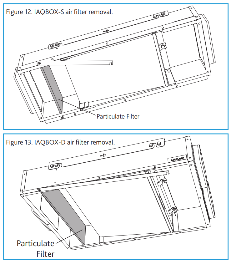

I also saw the Nuair IAQ-BOX, it's quite interesting, but it's quite expensive. According to the documentation, it seems that the particulate filter is before the carbon filter (https://www.nuaire.co.uk/documentstore/IandM/671811.pdf)
At the moment I am considering the Blauberg Clean Box (https://blaubergventilatoren.de/en/product/clean-box-200-g4-f8-carbon), or some other equivalent as the Vents FB K2 (https://ventilation-system.com/product/fb-k2-200-g4-c-h13/#downloads), or the TECNA ISOBOX FB-K2 (https://tecna.es/todos-los-productos/comercial-e-industrial/filtracion/isobox-fb-k2/), which is easier to find in Portugal. I still have doubts if a system like this will be able remove the smoke smell or not...

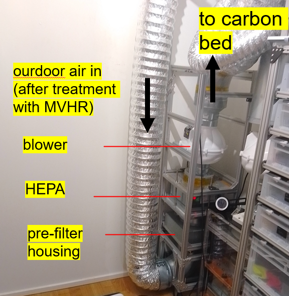

Here is a pic of my filter, it costed me way more than 400 EUR to build :), but I like it b.c. it uses generic parts, and I can upgrade/replace parts as needed. E.g. my initial Blauberg blower proved weak, so I replaced it with a 2x bigger unit. I used 3030 T-slot profiles to bolt it together. The filter is downstream from the MVHR. The MVHR is next to the window, then there is a 200mm duct that goes across the room to the filters (the wider the duct, the better). The carbon bed is not shown, it's further downstream from the blower. I used a 7-kilo horiculture in-line filter ("AIRCLEAN"), and an additional 2.5 kilo IQAir carbon filter downstream from that, and two 3M MERV13 30x30 cm filtretes downstream yet (to capture carbon dust).
The filters drop the rated "free" air flow of the blower by about 2-fold, and I have so far not had a blower fail after 2 years of 24-7.
This is the inline carbon filter:
https://www.visionofhemp.ch/shop/en/can-filters-inline/8966-can-filter-can-inline-425-125mm-8718819995234.html
This is the IQAir carbon filter downstream from it (the horiculture filter itself had a smell, but it does bulk of the work).
https://www.amazon.de/-/en/IQAir-V5-Cell-Filter-Gas-Odour/dp/B0007U46T4
These are filtretes to scrub the carbon dust, and also used as pre-filters:
https://www.filtrete.com/3M/en_US/p/d/b00040201/
HEPA was from here:
https://www.ozcon.co.uk/products/hepa-filter/
They are about 150EUR each, and I got a pack of 10. The manufacturer is MGT (Turkey), and the HEPAs are very solid (stainless steel with separators), verified with a particle counter. The part number can be obtained from this PDF; my HEPA was 305x305x150 and rated as H13
https://www.ozcon.co.uk/wp-content/uploads/2021/07/High-Temperature-Resistance-HEPA-Filters.pdf

I've yet to change my carbon filter in the blauberg, its been in there about 3 years now, with no noticeable smell ingress, when there is active smoke smell outside. My cleanbox sits pre-MVHR, since i wanted to take advantage of the H13 HEPA before it got to the MVHR, and is in a cold loft space.
There is a G4 type filter on the intake in the MVHR which i put in there, firstly to fill the space where it goes, and secondly to ensure the cleanbox did as it should, filter has remained clean and looks and smells as it did brand new out the box, so not convinced there is any carbon dust, nor should there be with the pelletised system.
Mike, the carbon dust I was measuring was in the micron range; I do not think that would settle and form a visible soot on a flat surface of the exchanger. I do see a black dusting on my downstream filtrete post-filters (meant to remove the carbon sust) from carbon. In all air purifiers I've dealt with there was an additional post-filter after the carbon, and it was consistent with my particle counter measurements. The amount of carbon dust was much higher if there was vibration in the bed (at least 10x higher).
With regards to the MVHR, I have decided that I can always wash the exchanger cube with tap water and wipe the insides of the unit, if needed. Observing how much condensation there was in the MVHR, I decided that I did not want to deal with it in my HEPAs.

skhell,
Indeed, horiculture filters release dust, this is why I put an "air purifier" grade carbon bed downstream from the horiculture carbon, plus two post-filters to contain the dust.
I found that the amount of dust never settles with time: vibration always brings more of it; this is the nature of the material, I guess.
One can get low-dust carbon pellets from manufacturers of respirator cartridges; that carbon is very costly -- I paid 400 EUR for a 20 kilo bag. I only use that for my DIY respirator and PAPR cartridges. This is prob the best carbon one can get, and still respirator makers use electrostatic fabric to capture dust from them (there is always some dust in carbon, no matter how good it is). There are "ball pan" hardness standards for carbon used in breating products, there are ASTM and EU standards for it.
Currently I am using this line of blowers. My local shop is in Basel, but they are available all over Europe.
https://www.visionofhemp.ch/shop/en/ventilator-125mm/11487-tube-fan-pk125-whsp-ectc-8594171433054.html
I use them b.c. they are quiet, and my wife hates the noise; the EBM Papst motors are proper. There are three speed levels. Blaubergs are about 1/2 the price, nothing wrong with them. You can get "dimmer" adjusters for regulator-free AC blowers, but dimmers emits annoying noise at low voltages (at least cheap ones I've tried :) ). So I just use the three-sppeed blower instead.
To balance, I measure the air volume per unit time for air in/out with an anemometer (calculated using the duct cross-section). Since the outgoing air in the MVHR has much less resistance (no filters), it ends up having much faster flow than air in, which is not good for me (I like the flat to be slightly pressurized, to prevent odors from getting in from the outside). To balance it, I attach a long narrow (100mm diam) flexible duct to the "out" on the MVHR (my MVHR has 100 mm connectors) and adjust the length of the dummy duct until the air volume per unit time at the "out" duct entry is slighly less than the fiow "in" downstream from the filters. The output duct ended up about 4m long to drop the air flow 1/2. Just make sure the entry is not blocked, the dummy duct likes to act as a vacuum cleaner :) and sucks itself to any surface.
I have never dealt with CO in the outdoor air -- unless the inlet for it is in an enclosed area, like a garage. I think smoke and particulate pollution from emitters (diesel etc) are more of a concern. And even if the MVHR gets some smoke in, washing the exchanger and wiping the insides of the unit should be easy. Or, the cube can be replaced.
Another concern for me is ozone in the summer (which can get to 200 ppb on hot days in my area, and inflammation in test subjects' lungs has been detected from exposure to 75 ppb --seen studies on that). Carbon deals with that pretty well. So my 7 kilo horiculture carbon catches ozone, ammonia and odors in the air (summer/winter pollutants that bother me) and the "air purifier" carbon then contains whatever dust is released from the horiculture carbon.
