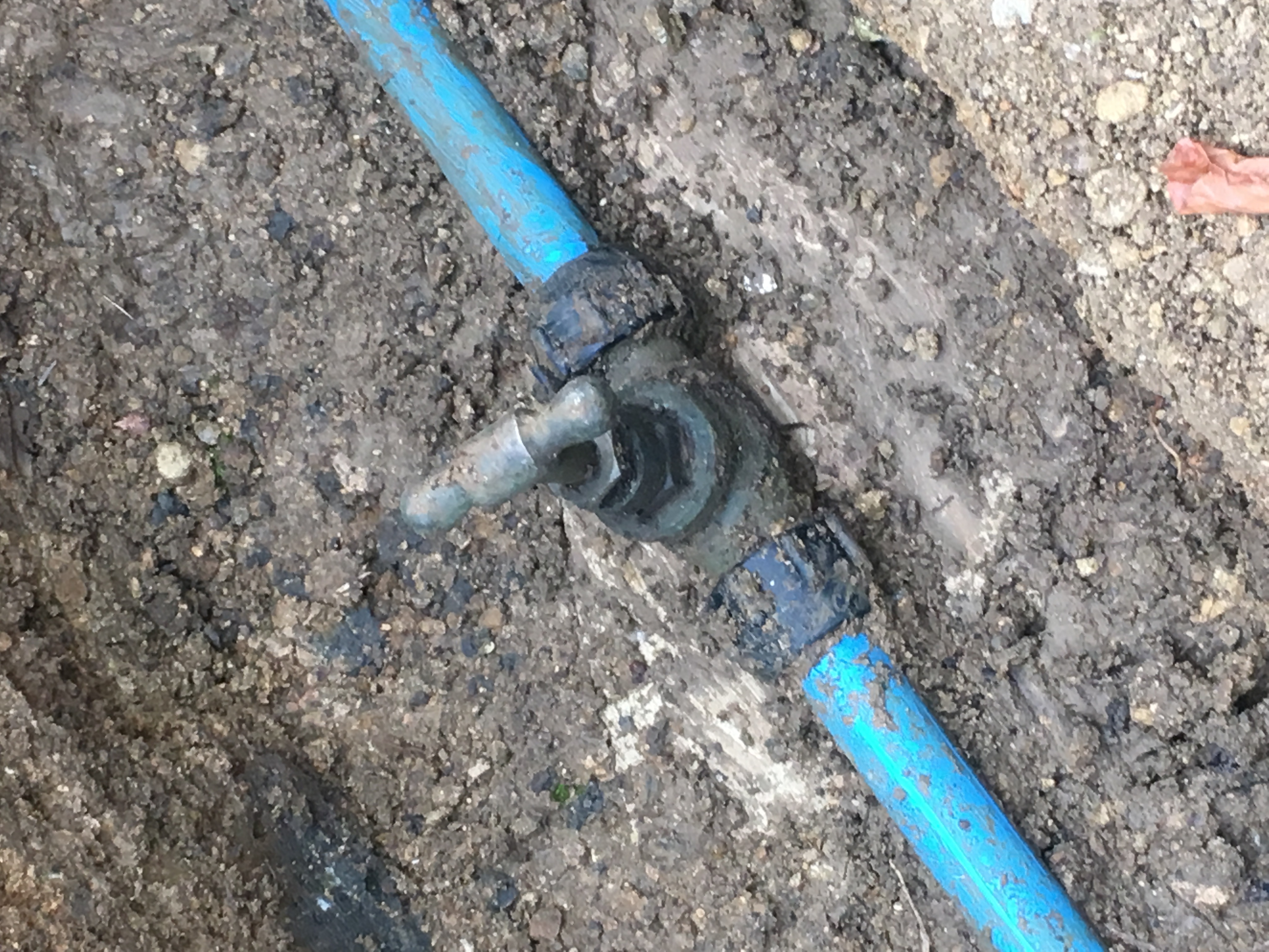

Russell griffiths Posted November 3, 2017 Share Posted November 3, 2017 I have a brass stopcock (see pic) its on a 32mm main any tips on freeing it. Or can I change the internal bits without disturbing the the connections to the actual pipe. Just thinking whilst it is not leaking it is a shame to disturb it. Ta very much. Link to comment Share on other sites More sharing options...
Nickfromwales Posted November 3, 2017 Share Posted November 3, 2017 Just now, Russell griffiths said: I have a brass stopcock (see pic) its on a 32mm main any tips on freeing it. Or can I change the internal bits without disturbing the the connections to the actual pipe. Just thinking whilst it is not leaking it is a shame to disturb it. Ta very much. Let's have the pic lol. 1 Link to comment Share on other sites More sharing options...

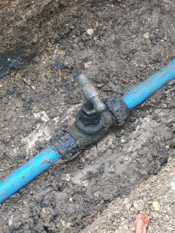

Russell griffiths Posted November 3, 2017 Author Share Posted November 3, 2017 There you go me ol China. Link to comment Share on other sites More sharing options...
jamiehamy Posted November 3, 2017 Share Posted November 3, 2017 Some heat and some Super Crack from eurocarparts, repeat a couple of times and have go with a long hollow bar?! 1 Link to comment Share on other sites More sharing options...
PeterW Posted November 3, 2017 Share Posted November 3, 2017 Clean it up and slack off the gland nut a quarter turn with a decent proper sized spanner. This should let it move slightly and using a couple of bits of copper pipe over the ends of the stopcock ends will give you some leverage. When you get it moving, big squirt of dry lithium grease and tighten the gland nut back up carefully. Link to comment Share on other sites More sharing options...

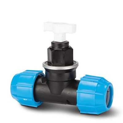

Onoff Posted November 3, 2017 Share Posted November 3, 2017 Or undo, sling and replace with something like this: 1 1 Link to comment Share on other sites More sharing options...
Nickfromwales Posted November 3, 2017 Share Posted November 3, 2017 What @Onoff said. These things are pennies so why even waste the time. If you can't turn the supply off just put some shorts and a T-shirt on and get in there. I changed an outside tap the other day with the mains stopcock nowhere to be found. I just reached around the corner of the building and started to loosen it out of the backplate. A few turns later the thing shoots across the back garden and it's like Niagra falls. I had the new tap PTFE'd ready to turn into the empty backplate but JESUS it was a battle. Have a swift pint and then get in there . A video of you changing it live would be priceless educational. 1 Link to comment Share on other sites More sharing options...

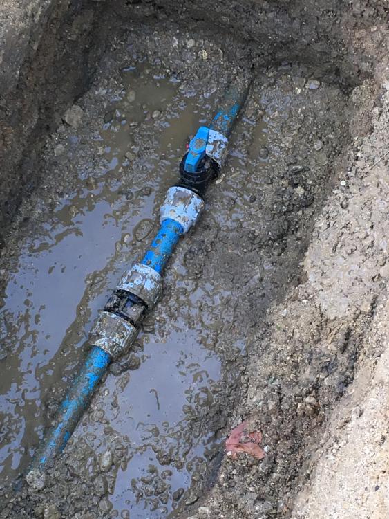

Russell griffiths Posted November 6, 2017 Author Share Posted November 6, 2017 So if I go and get the new plastic one, what are the chances that the fitting lengths will be different and I will need a fancy adapter or something, or are they clever enough that they made the plastic ones longer so a bit of trimming is all that's needed. What you reckon @Onoff @Nickfromwales @PeterW Link to comment Share on other sites More sharing options...
Onoff Posted November 6, 2017 Share Posted November 6, 2017 Dunno, maybe get a straight connector and piece of 32mm just in case? Don't forget the inserts btw! Seems silly to buy a length of pipe of you have none. Maybe someone on here could post a foot of it? Link to comment Share on other sites More sharing options...

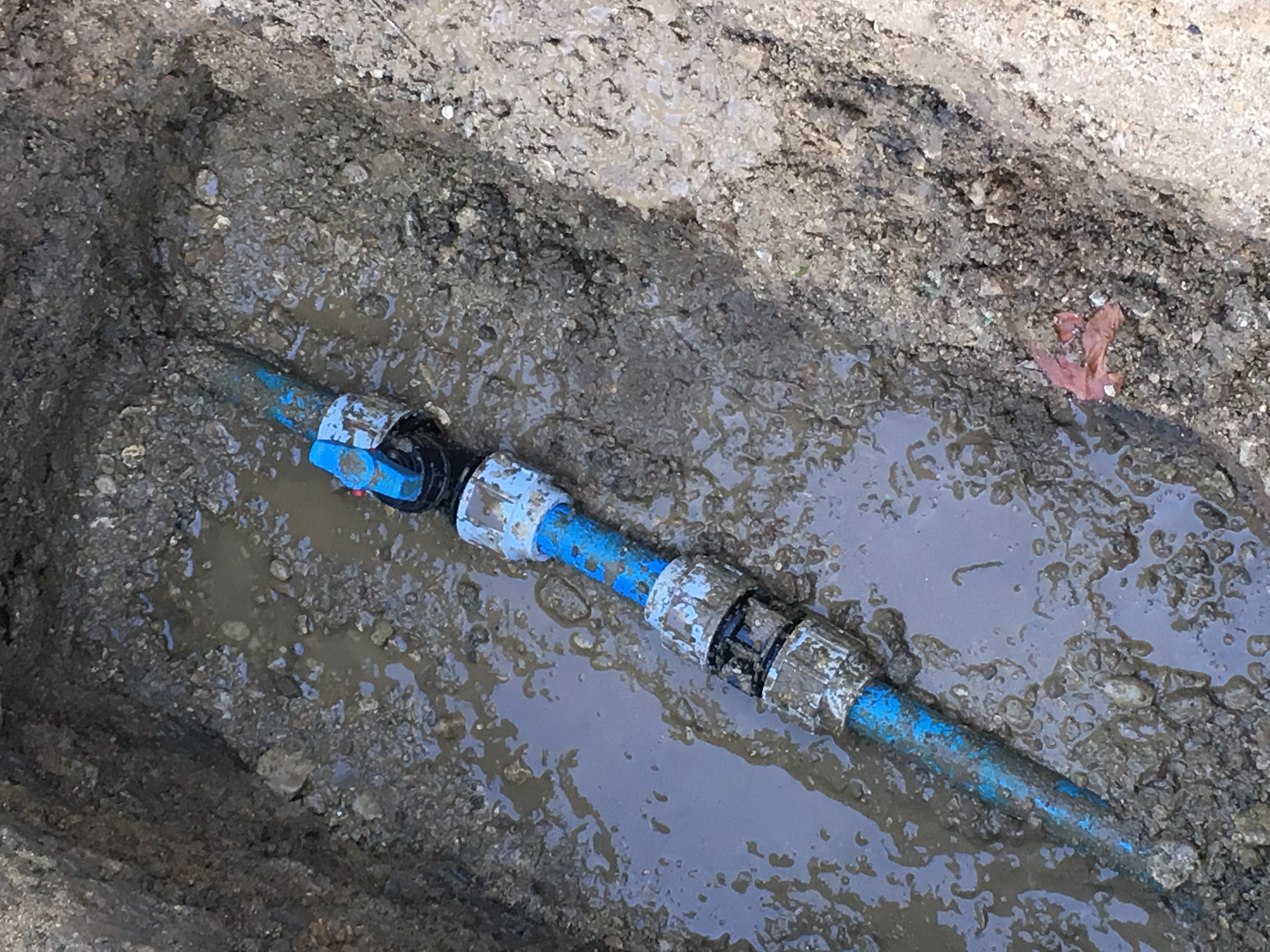

Russell griffiths Posted November 6, 2017 Author Share Posted November 6, 2017 12 hours ago, Onoff said: So it turns out the idiot designers aren't clever enough to work out old style brass stop cocks are 30mm longer than the new plastic ones, do they not make an adapter to lengthen the valve. Had to faff around adding a straight join just to add in a tiny bit of pipe. Oh how I hate unnecessary joins and potential leak points. ? Link to comment Share on other sites More sharing options...
