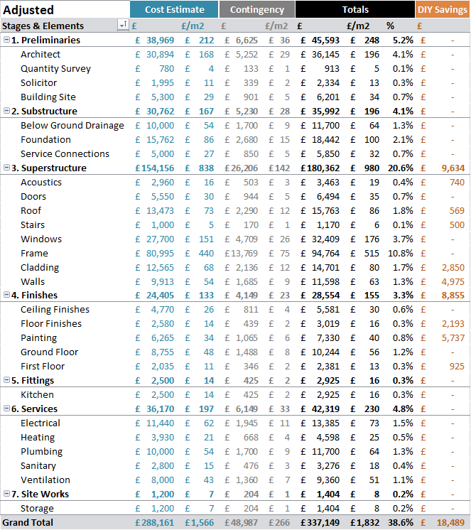

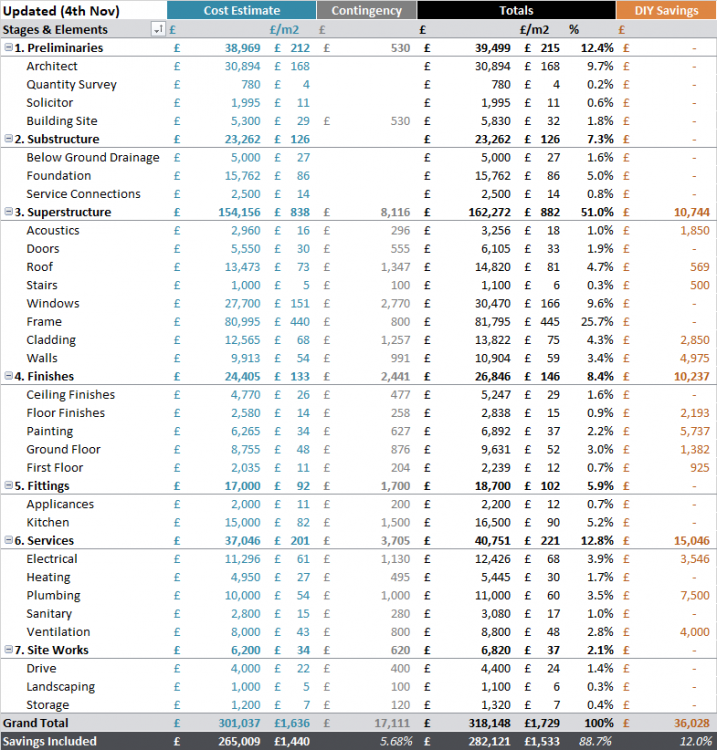

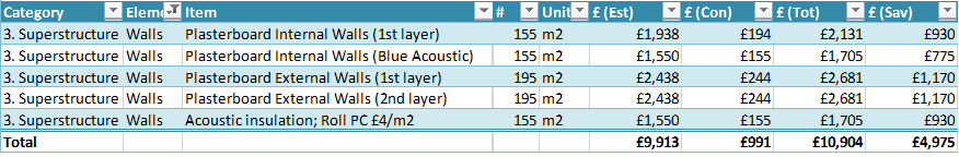

Visti Posted November 5, 2017 Author Share Posted November 5, 2017 10 hours ago, Mr Punter said: We have used 15mm Knauf Soundshield Plus in a recent development. You will only need one layer. It is a lot tougher than normal plasterboard - a good compromise between p/board and Fermacell. Good shout! We've investigated Fermacell but weren't convinced the outlay was worth it. Thanks for the alternative 10 hours ago, oldkettle said: As wall acoustics is included in "Walls" line why is there a separate "Acoustics" item worth quite a lot even including savings? The separate Acoustics line is going into the floor (37m2), not the internal walls. The category could be better named I suppose! 5mm IsoBase R50 PC @ £20/m2 = £1,110 VL-65 Acoustic membrane PC @ £40/m2 = £1,850 10 hours ago, PeterW said: So I take it you went the MCS route ..?? Nope, that one is new to us. More research for us I guess! Thanks for the heads up on the UFH issues, we've had the same from our architect and are including mixer units and pumps with weather compensated control to address the issue. We're not hugely concerned with heating other than not going overboard given the Cellulose! 8 hours ago, lizzie said: Sorry I cant work the quote bit here but did I read correctly Visti further back on this thread as saying MBC slab and frame were not accepted by warranty provider Prremier Guarantee? The frame is all good, it's just the use of a slab on clay that Premier wouldn't gaurentee! Link to comment Share on other sites More sharing options...
oldkettle Posted November 5, 2017 Share Posted November 5, 2017 (edited) 1 hour ago, Visti said: The separate Acoustics line is going into the floor (37m2), not the internal walls. The category could be better named I suppose! 5mm IsoBase R50 PC @ £20/m2 = £1,110 VL-65 Acoustic membrane PC @ £40/m2 = £1,850 Wow, this is specialised stuff with a matching price tag! Thanks for clarification. Edit: on a second look, is this the one? https://www.customaudiodirect.co.uk/acoustic-membrane-vl65-mass-loaded-vinyl Seems £40 per roll? And Isobase http://www.domesticsoundproofing.co.uk/sound_proofing_prices.htm - £138.75 per 27.75m2? Edited November 5, 2017 by oldkettle Link to comment Share on other sites More sharing options...
Visti Posted November 5, 2017 Author Share Posted November 5, 2017 MBC have offered to place UFH onto the foundation prior to pouring the screed even if they don't do the slab themselves, so we're likely take that option. As for combi's, we've been advised that they don't scale well with fluctuating numbers of people in the house and that their long tern reliability is questionable. We'll certainly be installing the MVHR following everyone's recommendations here. We've estimated $4k cost to be on the safe side (we're awaiting quotes from 6 suppliers), the other £4k you'll see listed in the DIY column so we'd expect to 'save' that. As for the slab on clay... we may need to take that up with the warranty provider again then. Keep getting told one thing by the 'experts' and then another thing in reality from everyone here. Just glad we're able to get that second opinion Link to comment Share on other sites More sharing options...
