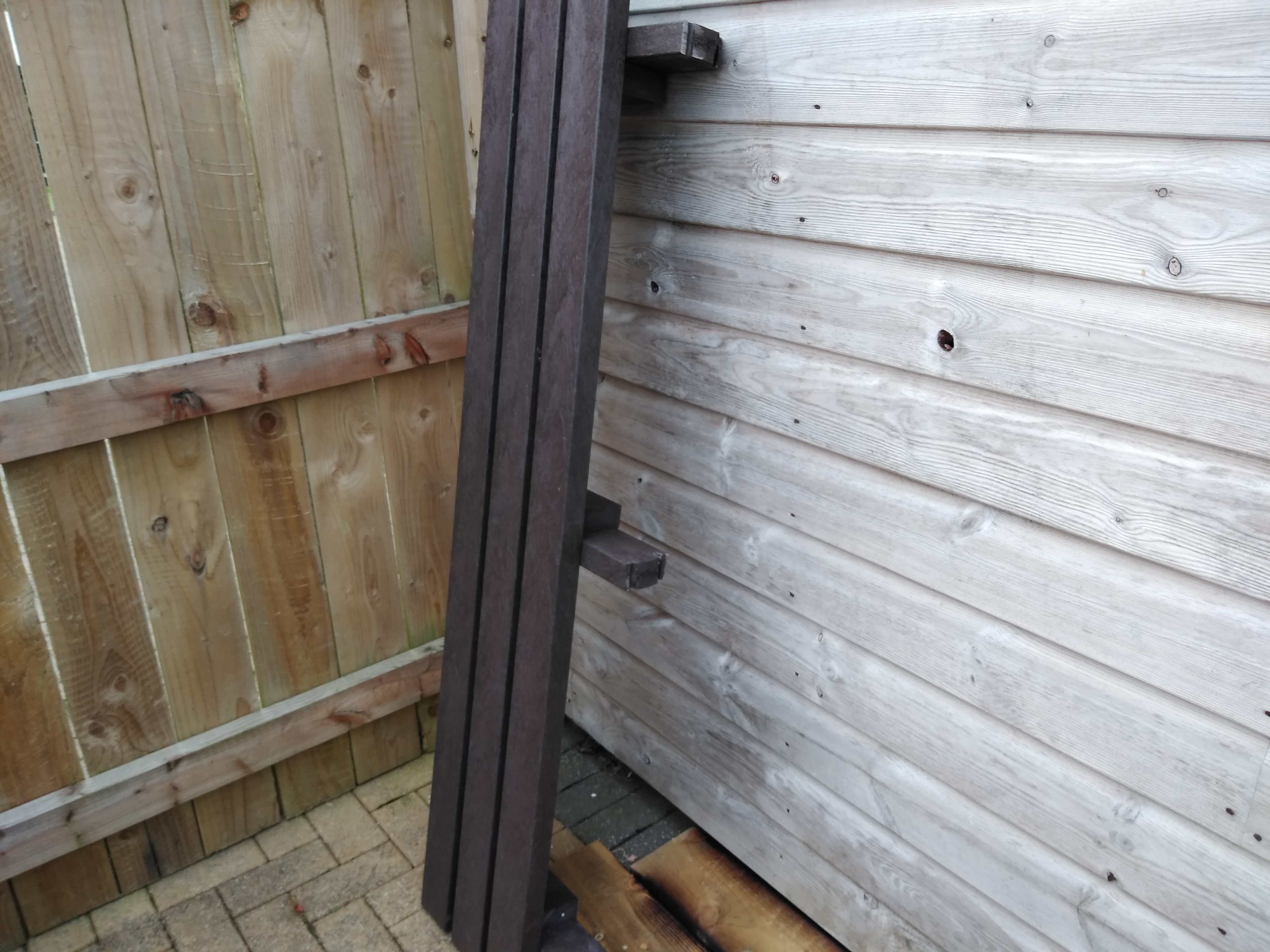

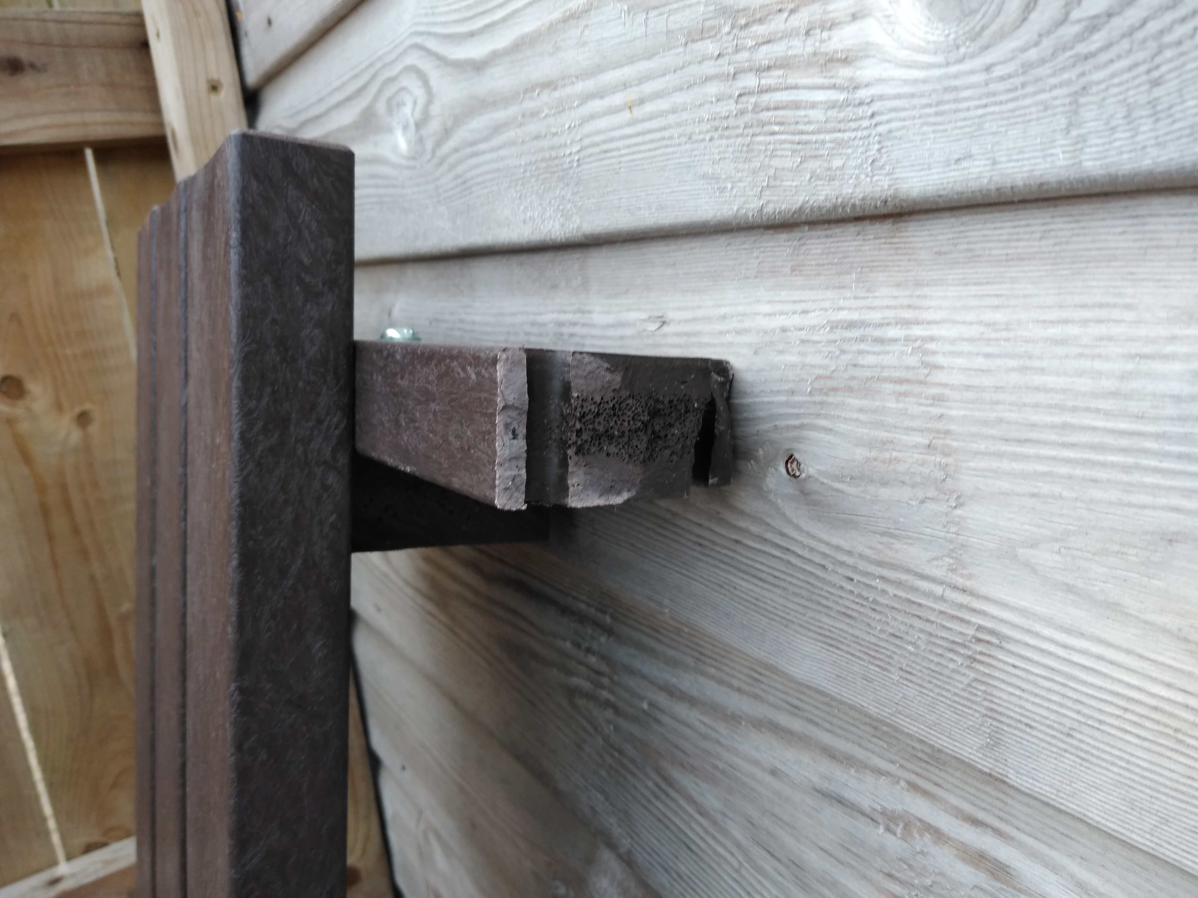

The broken arm/seat support, with no 'meat' at the top.IMG_20240813_072530669.thumb.jpg.9043a2ab3cf893de8cd452a78f3f6ab1.jpg
The detached seat.

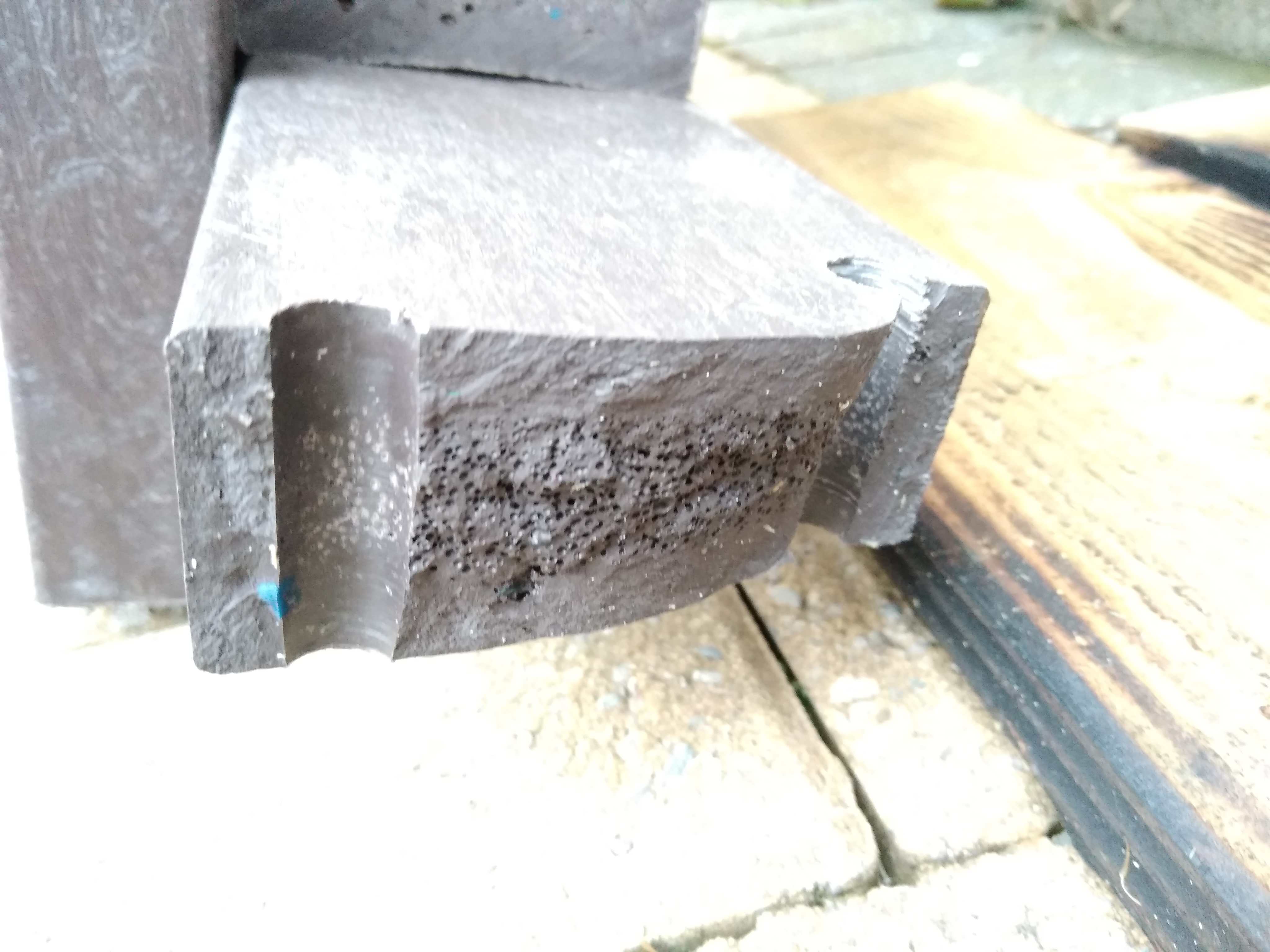

Close up of the failure, which shows a lot of aeration in the extrusion.

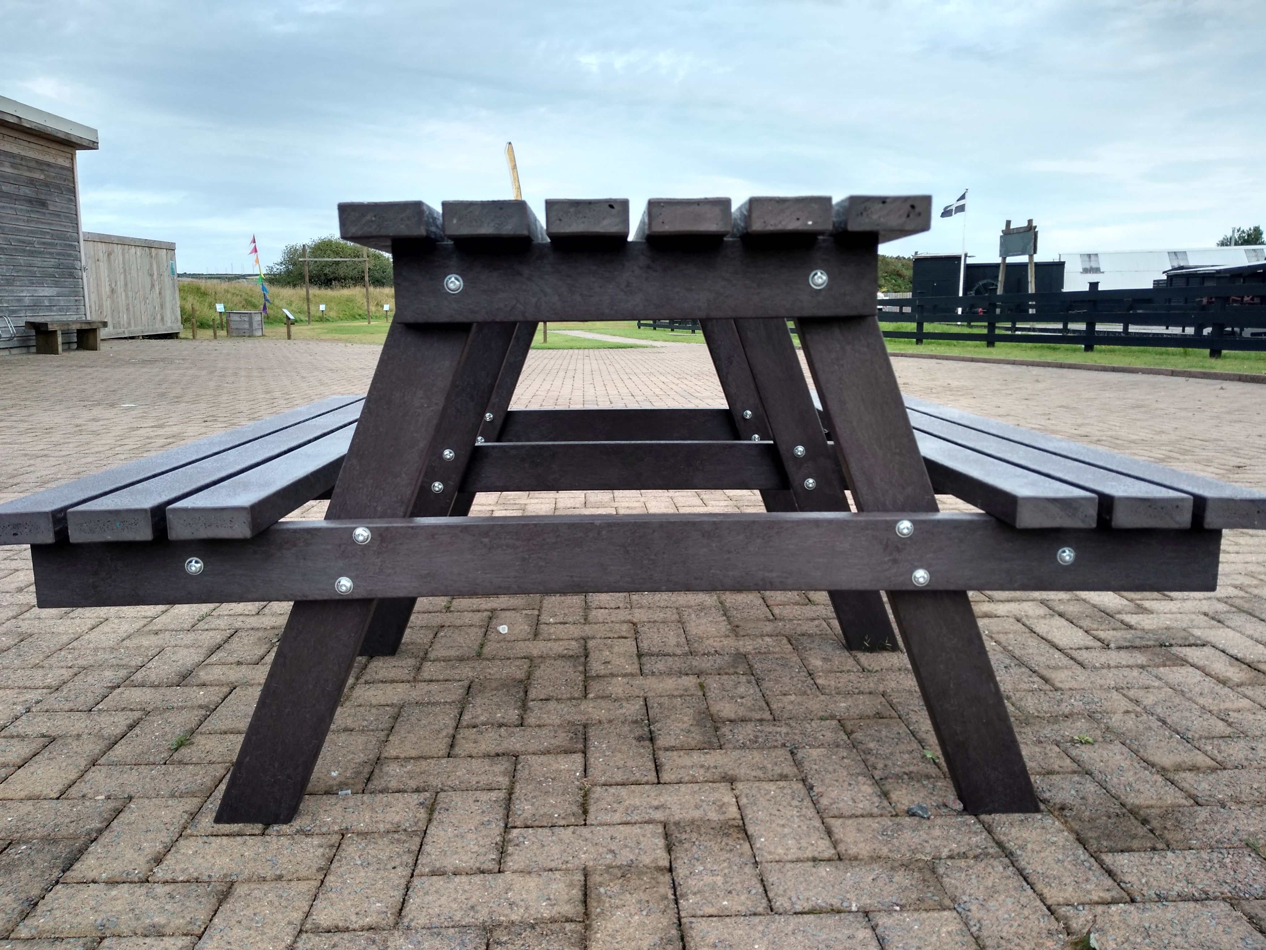

An old bench with the 3 bolts in a small triangle. This has lasted a few summers.

Aeration is a common problem when extruding 'fractional melt' plastics.
I think the main problems are that the top cord was too small and with only two bolts per arm, 'rocking' soon becomes excessive.

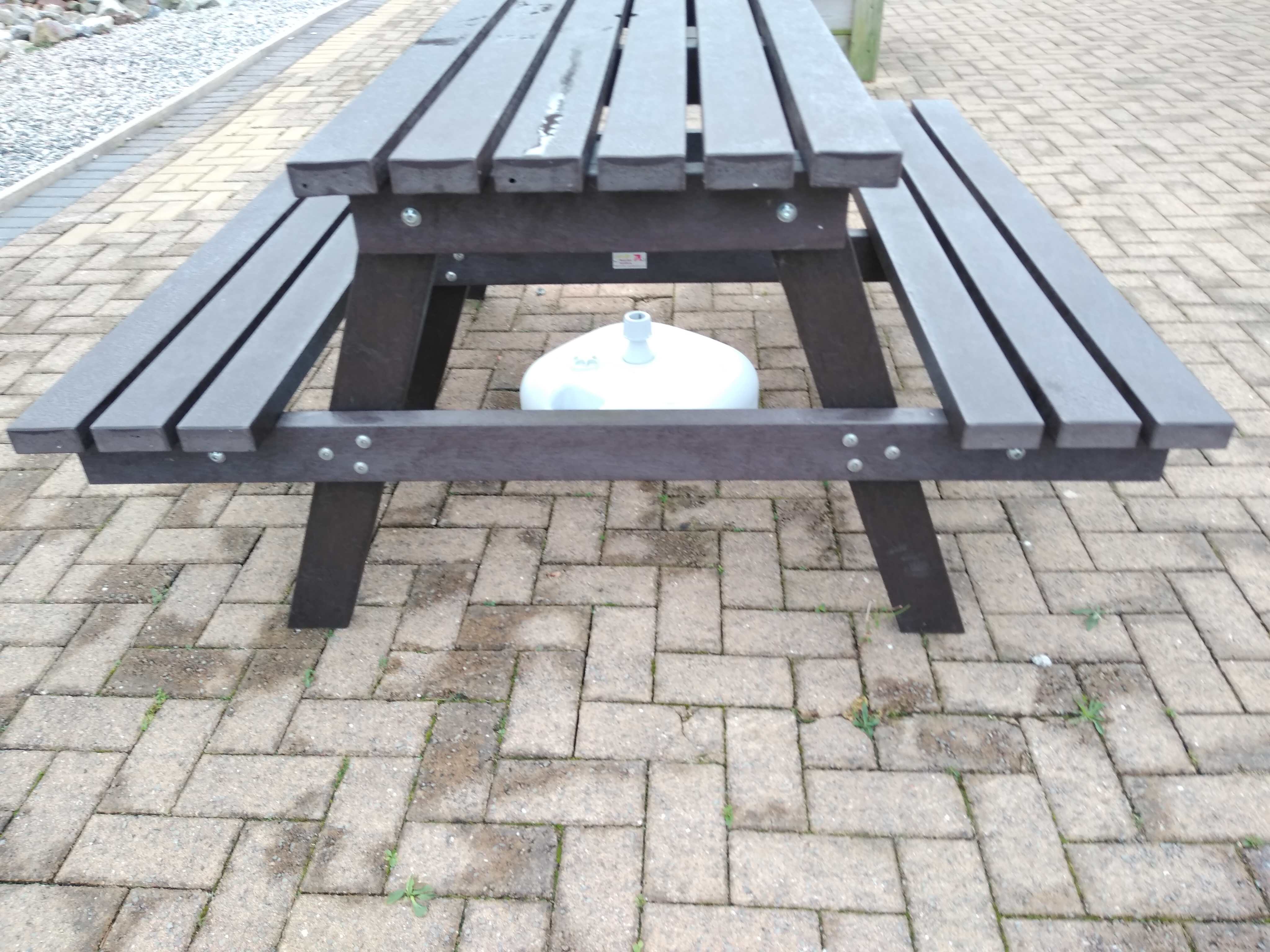

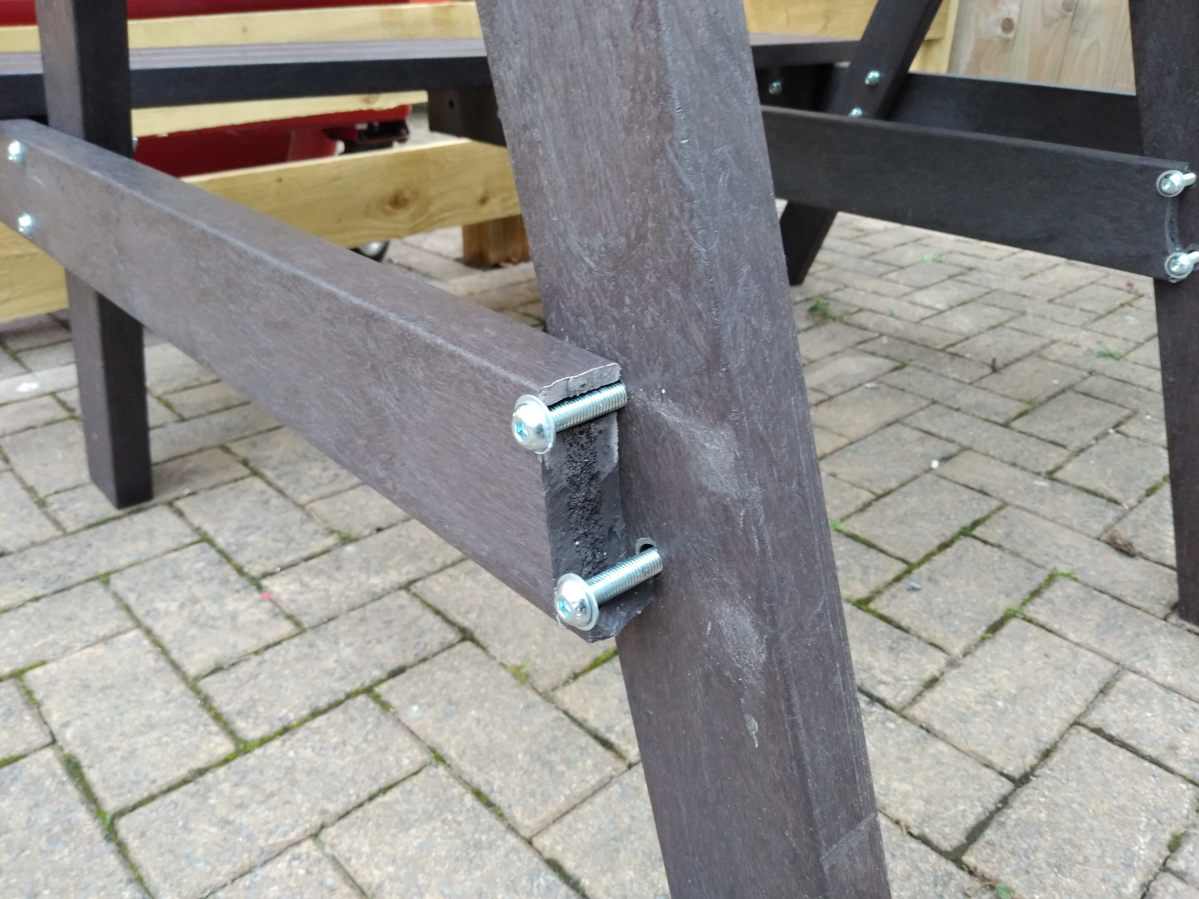

Below is a picture of one that is failing in my opinion.  The bean is already bowing and you can see how little distance there is between the bolts and the top edge of the beam.
Without cutting the old ones you won’t know if the aeration is the same or not. I bought similar stuff for the soul plate of my new wooden garage (to act as a DPC) and cutting that virtiualy no “bubbles” seen.
When machining plastics, woodworking machines are often used, these cause micro fusion at the cut edges, which makes them look as though they are solid.
So hard to tell from a machined part.
However I cut mine with a hand saw so no “melting” should have occurred..
The aerated core probably turns it into a box section.
The bolt holes on the new/failed units appear to be further apart vertically so the top bolt hole appears to be through part of the solid top skin rather than the core like the older units.
In the end the benches are not “fit for purpose” (unless max weight limit signs are visible 🤷‍♂️) so the suppliers are liable IMO.
Edge distance issue that imo.
The weight gets applied to the bench and all goes to the pair of bolts. The likelihood is that it all sits on one bolt until it nestles down to be shared by both.
but before that happens, the load acting downwards causes the spar to rotate with the bottom bolt as pivot point. You now have lots of load down on the top bolt and also pulling it apart at the top surface.
that tiny bit of plastic above the top bolt fails.
the spar is already much reduced by 2 holes in a line.
bending continues and so does the crack,  especially as this is now dynamic load. it is moving.
all in an instant.
If it was wood then there would be fibres longitudinally, holding it all together.
But the aero bar is all one material and therefore   . ....someone  who understands plastic can take over....
With three bolts, the rotation is about one bolt but resisted by the other 2.
one extra bolt, and at least double the strength.
They are all a bit close to the edge.  Bolts that bite into the plastic would be best to stop initial movement.
