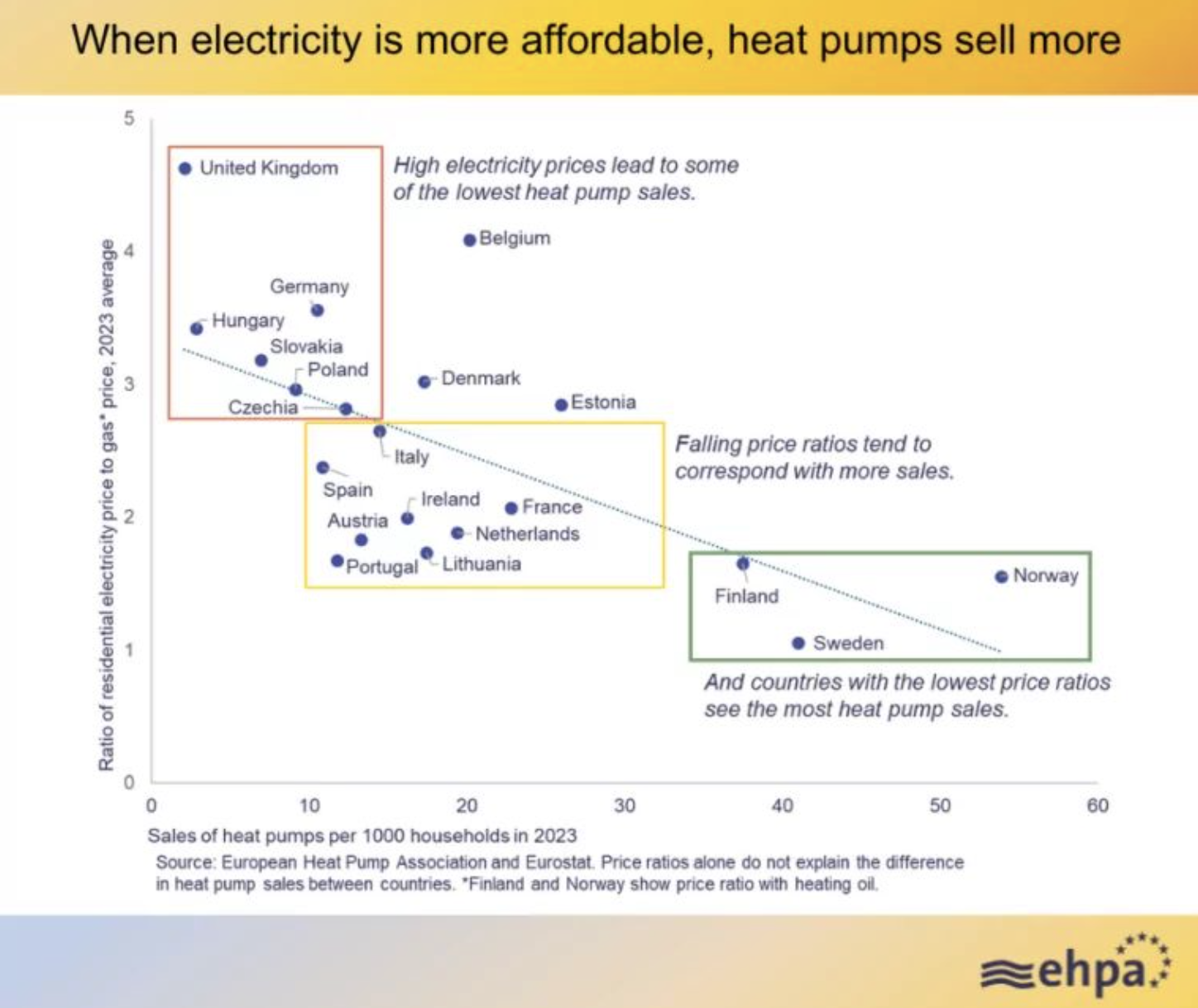

LnP Posted July 25, 2024 Share Posted July 25, 2024 (edited) It's been said on here before, but this graph from the European Heat Pump Association shows clearly the relationship. A higher ratio of electricity price to gas price ("spark gap") correlates with fewer heat pump installs. The UK has the highest spark gap amongst the countries included in the analysis. No surprise then that people in the UK are not choosing to install heat pumps so much as other countries .... when there is a choice. Btw, it's helpful that the UK are included in this analysis. Edited July 25, 2024 by LnP 3 Link to comment Share on other sites More sharing options...
ProDave Posted July 25, 2024 Share Posted July 25, 2024 Yes it is not rocket science. At the moment, at best, a well installed heat pump working well will just about match the running cost of a gas boiler. That is not much of a selling point is it? Most of us on here do it for other reasons, mine being no mains gas here, and I did not want an oil tank. 1 Link to comment Share on other sites More sharing options...

Ferdinand Posted July 25, 2024 Share Posted July 25, 2024 A pedant writes: Are these numbers sound? My gas to electricity simple price per unit ratio is 25.49p/kWh to 6.44p/kWh, which is 3.95 not 4.8. Is this some strange average calculation involving standing charge? And do these use A2AHPs or just ASHPs? My impression is that even though UK ASHP pumps are soaring from a low base, there are a lot of people buying A2AHPs as they cost a fraction of the amount. Link to comment Share on other sites More sharing options...
