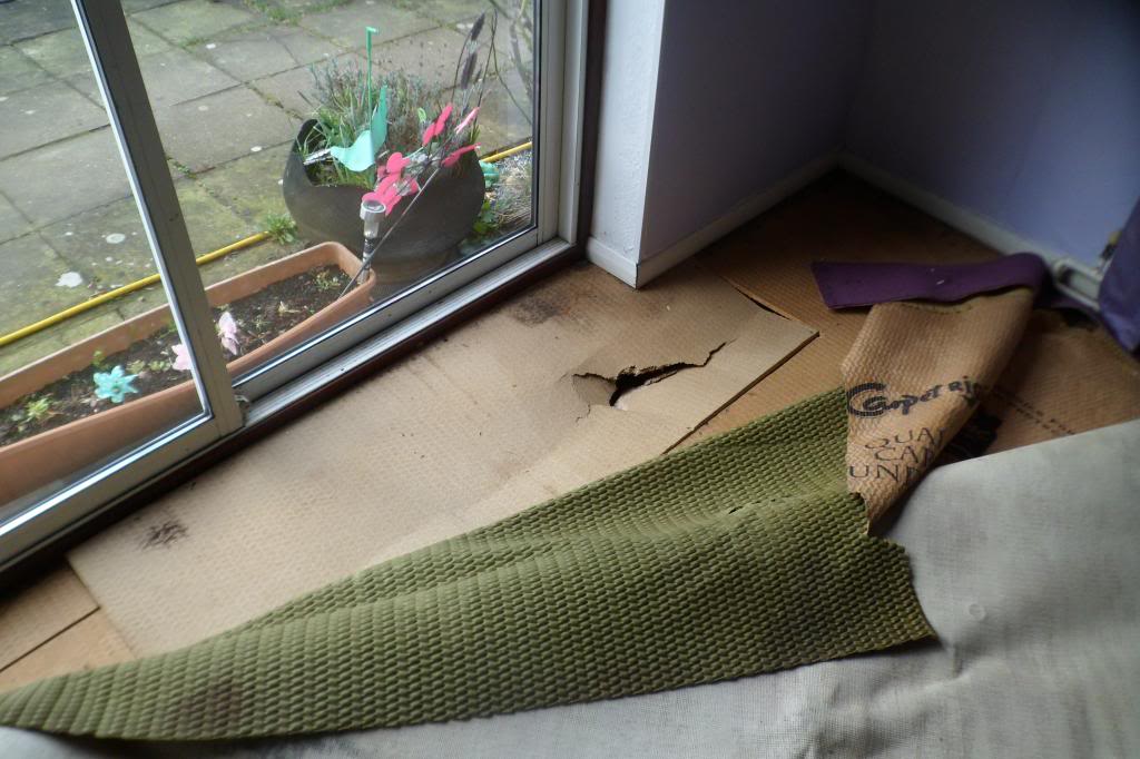

Onoff Posted December 8, 2017 Share Posted December 8, 2017 (edited) Sitting here in the lounge with my feet off the floor and tucked up under me on the sofa just feeling the draughts swirling around. When I look at the outside of the house; air bricks into the void under the suspended timber floor, chipboard flooring and a bit of thin underlay carpet it really reinforces there are better insulated SHEDS! And don't start me on the dormer! 4" stud walls with hit and miss fluffy insulation - 100mm max in floors and ceiling. The wifes going to soon start wearing her fake fur onesie to bed! Furries? Edited December 9, 2017 by Onoff 1 Link to comment Share on other sites More sharing options...
Gone West Posted December 9, 2017 Share Posted December 9, 2017 8 hours ago, Onoff said: When I look at the outside of the house; air bricks into the void under the suspended timber floor, chipboard flooring and a bit of thin underlay carpet it really reinforces there are better insulated SHEDS! I blocked up the air bricks under my bungalow 10 years ago when I moved in. I knew it was going to be demolished so I wasn't worried and thought it would be interesting to see the effect on the timbers. The main part of the bungalow is built of 4"x2" with a suspended timber floor. I should find out next year how the structure has been affected. Link to comment Share on other sites More sharing options...

Jeremy Harris Posted December 10, 2017 Share Posted December 10, 2017 (edited) It's worse with suspended floors, for sure, especially in really cold weather, just because the air under the floor will be close to the outside air temperature. At least with a solid floor the lowest temperature under the floor is unlikely to drop below about 6 deg C, and will most probably be around 7 or 8 deg C. That makes a substantial difference to the heat loss rate, no matter what level of floor insulation you have, just because the temperature differential is so much greater for a suspended floor. Although our old house has uninsulated solid floors, at least they don't get any colder in cold weather, they are always just slightly chilly. We had an outside air temperature of around -3 deg C the night before last, and had we had a suspended floor that would have been around the temperature underneath it, rather than the 8 deg C it normally is. An extra 11 deg of temperature differential will give a pretty substantial increase in heat loss. If you had a floor with a U value of, say, 0.5 W/m.K, then a solid floor would lose around 6.5 W/m2, whilst a suspended floor with air at -3 deg C flowing under it, would lose around 12 W/m2, a substantial difference. Edited December 10, 2017 by JSHarris Link to comment Share on other sites More sharing options...
