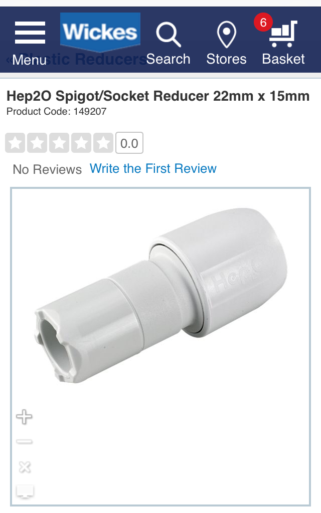

PeterW Posted October 18, 2017 Posted October 18, 2017 Just use a 3/4 x 22 bent connector and then a 22 x 15 push spigot reducer .... 1
Crofter Posted October 19, 2017 Author Posted October 19, 2017 Hepworth don't appear to do a 3/4x22 bent connector either, so I'm just going to use a straight 3/4x15 and an elbow. Will take up slightly more room. Funny how when you flick through the BES catalogue it seems like every possible combination is available, and then when you actually need one it doesn't exist

Nickfromwales Posted October 21, 2017 Posted October 21, 2017 2 hours ago, Crofter said: Here's the offending item: http://www.ebay.co.uk/itm/Modern-Concealed-Chrome-Round-Thermostatic-Shower-Mixer-Valve-Kit-SM615A/370901516038?ssPageName=STRK%3AMEBIDX%3AIT&_trksid=p2057872.m2749.l2649 Chosen because of the idiot proof labelled controls and obviously it was a good price, with 10yr guarantee. I've fitted the tap cons onto it already, I used Hep connectors and have ditched the flexis. Whilst I'm more than happy to switch out fittings or even the whole valve if necessary, there's a time issue as it's currently holding up the rest of the bathroom. Hepworth will have a 15mm x 3/4 tap connector that'll screw straight onto those I'm sure. Then a street / spigot bend and away to go. Or some bent ones too One and another Ignore the prices, they're just random grabs for you to see what's available ?
Crofter Posted October 21, 2017 Author Posted October 21, 2017 13 minutes ago, Nickfromwales said: Hepworth will have a 15mm x 3/4 tap connector that'll screw straight onto those I'm sure. Then a street / spigot bend and away to go. Or some bent ones too One and another Ignore the prices, they're just random grabs for you to see what's available ? Cool, I'm on the right track then. Have fitted a bent 15x1/2" Hepworth tap con on the outlet, and used straight 15x3/4" of the same on the inlets, because bent ones weren't available. Just had to use a couple of (Hepworth) elbows after. It'll all get pressure tested before it get boxed in... and the flexis are going in the bin
