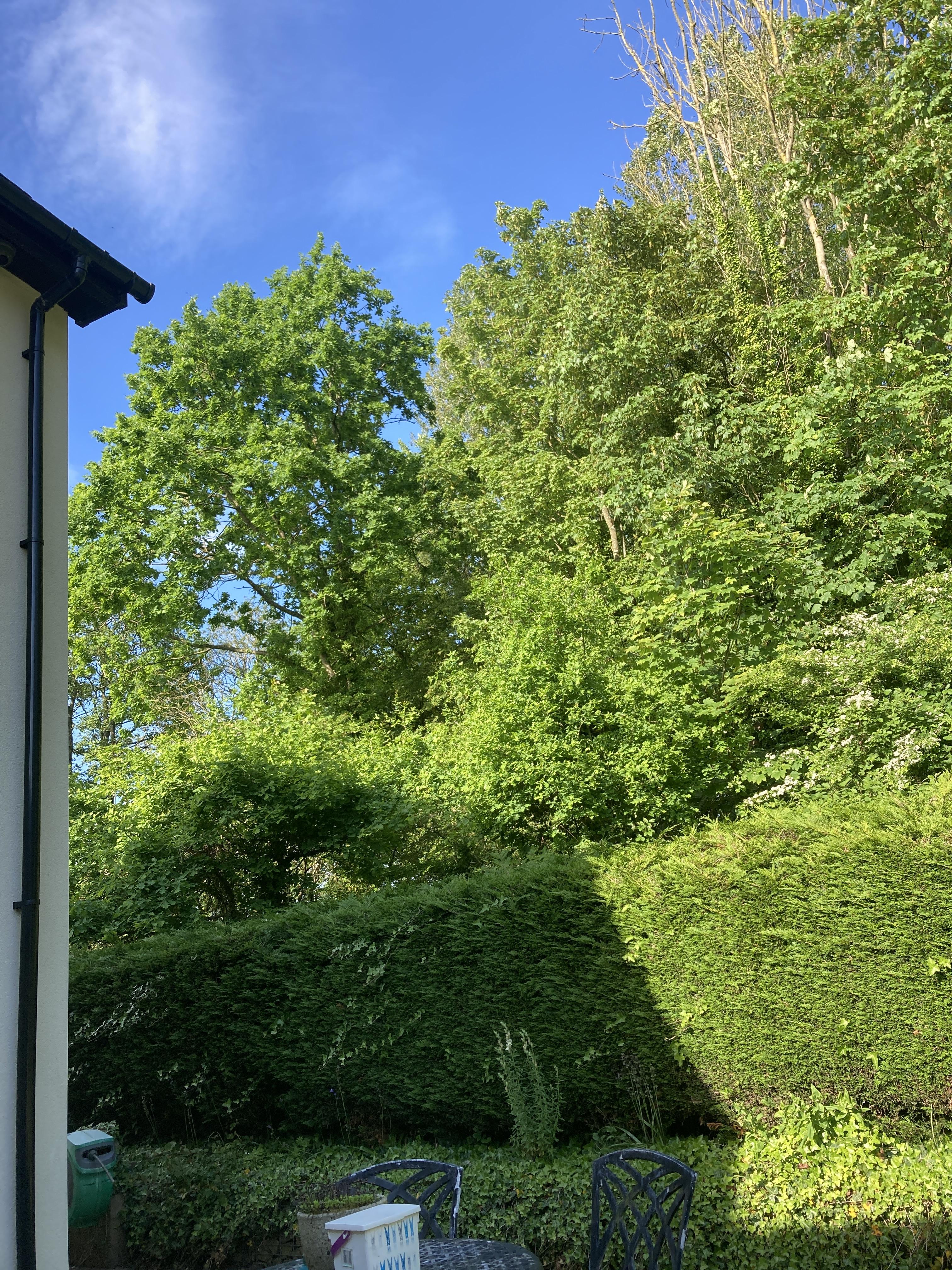

Bluebaron Posted May 19, 2024 Posted May 19, 2024 Taking into account that I will require a specialist foundation realistically how close can I build to a mature oak tree? im looking at 5-6m. can this be done?
DevilDamo Posted May 19, 2024 Posted May 19, 2024 For starters, not within its RPA. What ground conditions do you have?
Bluebaron Posted May 19, 2024 Author Posted May 19, 2024 Getting a soil survey done but could probably clay. Hence a heave risk hence looking for a workaround
Russell griffiths Posted May 19, 2024 Posted May 19, 2024 Post up some pics, this could get very expensive.
Bluebaron Posted May 19, 2024 Author Posted May 19, 2024 Ok probably best if I reword. has anyone built less than 6m from a large tree? Don’t care about cost etc just can it /has it been done . Everything on google talks about RPA and deep foundation, I know about all that. I just need to know if the planners will allow it with suitable workarounds etc. Thanks
Russell griffiths Posted May 19, 2024 Posted May 19, 2024 Yes can be done, flying ringbeam above ground, with piles on the outer edge of the RPZ. or steel beam spanning across, you say cost is not an issue, but it must come into play at some point £100,000 extra, £150,000 extra there’s always a price where it all becomes a bit stupid.
Mr Punter Posted May 19, 2024 Posted May 19, 2024 Yes, you can build within 6m of a large tree. You will need a solution that is engineered to accommodate soil heave / shrinkage and not cause damage to the tree or the foundation. May be easier to fell the tree.
Jilly Posted May 19, 2024 Posted May 19, 2024 (edited) Wouldn’t a pile foundation do it? I’ve got trees nearby (not that big, though) on clay. The piles went down an unbelievable 12m. It was affordable, but there was a big variation in quotes, so ask for several. Also, which way is the prevailing wind…? Best speak to a structural engineer, possibly more than one… Edited May 19, 2024 by Jilly 1
nod Posted May 19, 2024 Posted May 19, 2024 We are on clay on our previous build With hundreds of trees Tree line about 5 meters Mostly ash 1
Bluebaron Posted May 19, 2024 Author Posted May 19, 2024 Ok that’s sounds good then, I did wonder as nothing in any planning documents I’ve seen said it can’t be done without proper consideration to the new build and the tree itself.
saveasteading Posted May 19, 2024 Posted May 19, 2024 12 minutes ago, Bluebaron said: proper consideration to the new build and the tree itself. I feel you've had lots of good advice on this already. Are you hoping for a different answer this time? Engineering apart..bdcdusd yes if czn bd done.....have you drawn a cross section through the proposed finished building? With the trees to scale as they are now. Then draw on the trees as they will be in 50 years, 25m tall with 1m trunks, and hanging over the house. 1
Bluebaron Posted May 19, 2024 Author Posted May 19, 2024 (edited) Yes thanks for advice everyone. I was looking at ripping the trees out I’m now exploring ways to maybe keep one hence my question. The tree is already over 25m tall with a 1m+ diameter. Edited May 19, 2024 by Bluebaron
