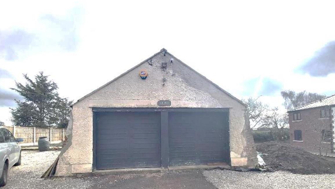

phykell Posted April 19 Share Posted April 19 My quote (prior to the demolition of a single storey, double garage) was £522 + VAT for the following: Quote Bat Emergence Survey Following the results of a Preliminary Roost Assessment the 1 x bat emergence survey is required to rule out/identify the presence of bat roosts associated with a single detached garage building. The survey can be conducted from May onward. The assessment will consist of a single dusk emergence surveys. This is in-line with current professional bat survey guidelines (Collins et al, 2016). The survey will be conducted to appropriate professional standards and led by a Natural England Licenced Ecologist (Class 2) and full member of CIEEM. 2 surveyors would be required to adequately observe bat activity associated with the building. A survey report will be produced containing the outcomes of the survey and any necessary recommendations that will be required to satisfy the LPA. Link to comment Share on other sites More sharing options...

phykell Posted April 20 Share Posted April 20 10 hours ago, LnP said: For our survey, before the ecologist arrived, I sealed up any nooks or crannies which might have looked appealing to sleepy bats. As hoped, he concluded an emergence survey wasn’t required. I tried that as well but the LPA insisted that the emergence survey was still required - I would have "fought" it but it had already been dragging on for ages. I asked the guy who did the preliminary assessment to indicate where he thought the bats would potentially roost - he supplied photographs with the areas marked and I subsequently sealed them all but this still wasn't enough for the LPA. And this was all despite the fact that, just over a year previously, I'd had a bat survey done which *didn't* require a emergence report! Of course, I couldn't rely on this previous report because, apparently, they "expire" after a year. To provide some context, all I wanted to do was demolish an old run-down garage (image attached) and they made me jump through all of the hoops possible, causing me unwarranted delay and expense when anyone with any sense would take one look at the building and just agree to its demolition (even for safety's sake as the buttresses were collapsing) - it's all a *massive* con. You don't need planning permission to demolish an outbuilding, even in a conservation area, if the volume is less than 115m3 but mine was arguably just under 120m3 - unfortunately, this made no difference so I learned not to expect any reasonable compromise from an LPA, ever. Link to comment Share on other sites More sharing options...

phykell Posted April 20 Share Posted April 20 1 minute ago, LnP said: If a qualified ecologist says an emergence study is not required, it's hard to see how the LPA could argue with that. Do you have a planning consultant to argue your case? The first report I had done said an emergence study wasn't required but that report expired and I was forced to have another one done. In that report, the ecologist said there was a very low risk of bats but that the building had places where bats *could* roost. I fixed the "holes" and slipped tiles and the LPA wasn't interested. I imagine I would have needed a repeat report because the LPA doesn't trust the householder but it the price difference wasn't worth the hassle. I might have been able to force the issue but I was more interested in saving time, hoping to get the thing demolished so that I could get on with the rebuild. I don't have a planning consultant - I just wanted to demolish an old, falling-down garage. All done now though. Link to comment Share on other sites More sharing options...
