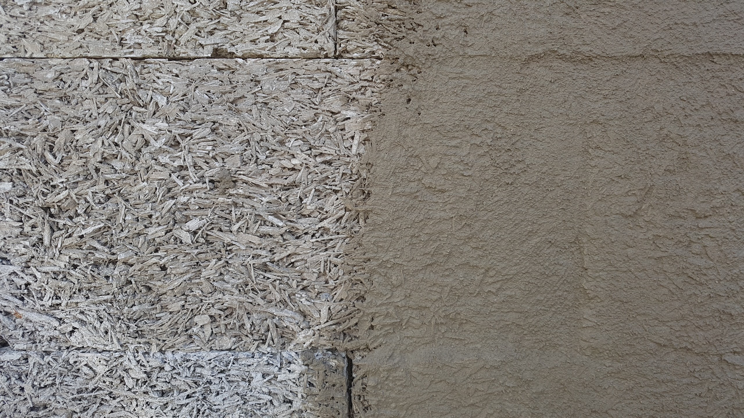

ToughButterCup Posted October 10, 2017 Posted October 10, 2017 10 hours ago, Pete said: I have boarded up some windows and the roof is a standing seam roof so I need the render doing first as I am not having any fascias/soffit. I'm getting on with our rendering. @nod came round and talked me through it (among many other things) : the only issue is heavy rain and frost . Some folk who come to see us say that what I'm doing isn't rendering. It's a very thin (5mm?) coat of sand and cement (4:1:1) like this It dries quickly. The purpose of this 'render' is simple airtightness: your job I take it is a lot more substantial.

nod Posted October 10, 2017 Posted October 10, 2017 10 hours ago, recoveringacademic said: I'm getting on with our rendering. @nod came round and talked me through it (among many other things) : the only issue is heavy rain and frost . Some folk who come to see us say that what I'm doing isn't rendering. It's a very thin (5mm?) coat of sand and cement (4:1:1) like this It dries quickly. The purpose of this 'render' is simple airtightness: your job I take it is a lot more substantial. 5 mil 25 mil still render Keep going Ian Its a cheap and effective way of sealing your blocks
