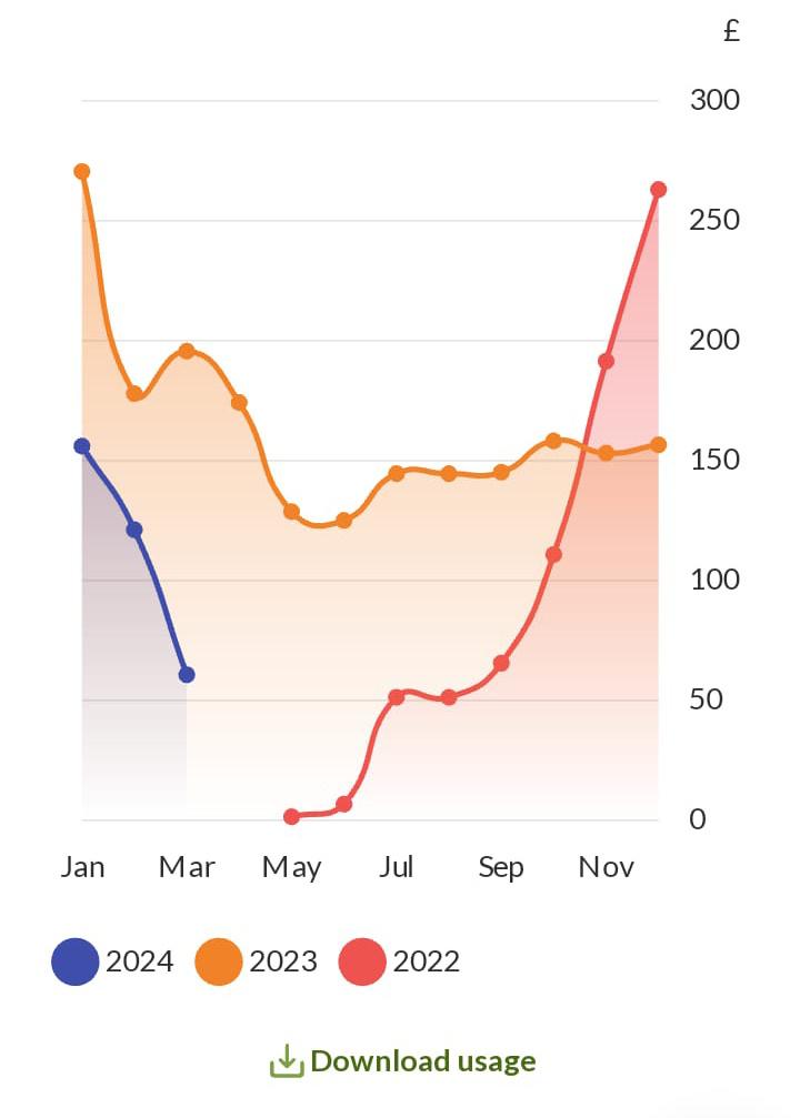

Jenki Posted April 1, 2024 Posted April 1, 2024 Facts. Red and Orange lines electric costs heating crappy static caravan and a couple.of cabins through the summer. Blue line, electric cost to heat ,DHW and run a 90 sqm well insulated airtight house, and a few days of cabin usage. The drop off is the house drying out and soaking up the heat. Yesterday we had some solar gain, and the ASHP never came on overnight as the house temp was stable. 23deg might be needed in a drafty house, a well insulated, no draft house is a delight and like comparing apples and oranges. Keep the faith, insulate, make it tight as a drum and worry about something else.
SteamyTea Posted April 1, 2024 Posted April 1, 2024 6 minutes ago, Jenki said: The drop off is the house drying out Really quite a marked difference isn't it. Makes me wonder why people want to add 'thermal mass' when it takes so much energy to heat up.
Jenki Posted April 1, 2024 Posted April 1, 2024 16 minutes ago, SteamyTea said: Really quite a marked difference isn't it. Makes me wonder why people want to add 'thermal mass' when it takes so much energy to heat up. It's my assumption. Nothing has changed we set the heat pump up set the thermostat and off it goes, it was cold and windy in January so it wasn't a change in outside temps, so my assumption was it must be the concrete core(ICF BUILD), and the drying out of skim plaster etc using more heat. Once it was stable then the heat demands dropped. I've changed to Octopus energy now so can't use the same chart for February and March. But the electric figures are holding now at around £70/m - £90/m depending on cabin usage and PV utilisation, which I'm delighted with. Makes battery storage a harder justification now. 1

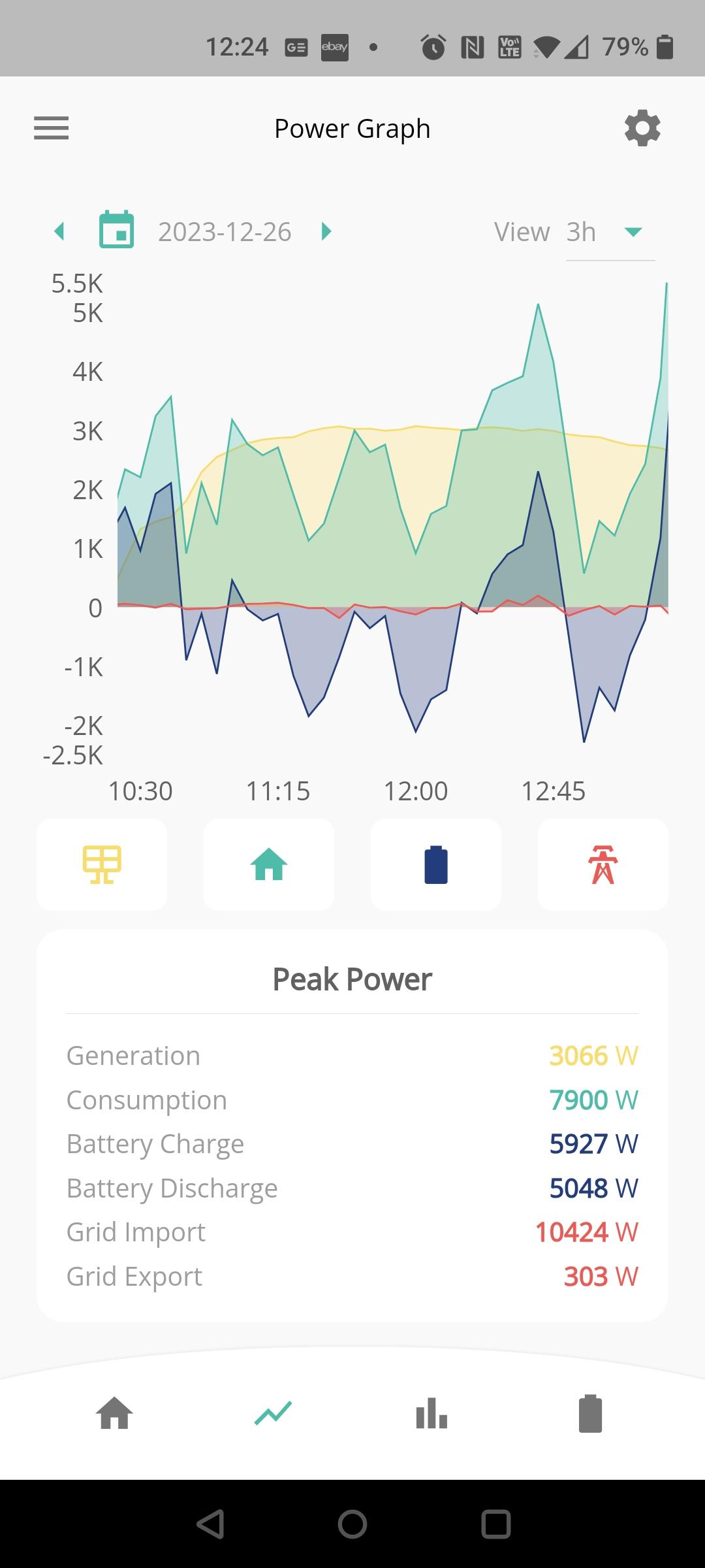

JohnMo Posted April 2, 2024 Posted April 2, 2024 1 hour ago, NailBiter said: Solar is only really crap from about the middle of December through to about the middle of January But you can get some good days, although quite short. This year we did Christmas day on boxing day and our lunch was all cooked via solar. The yellow is solar generation, green consumption, and blue below the zero line is battery being charged. The red is import electricity. 1 hour ago, NailBiter said: (we don't notice power cuts until the neighbours come round for tea) We get a texts - do you power? we answer yes, but the mains is down, similar the other days mains water was off, but we use a borehole. 2
