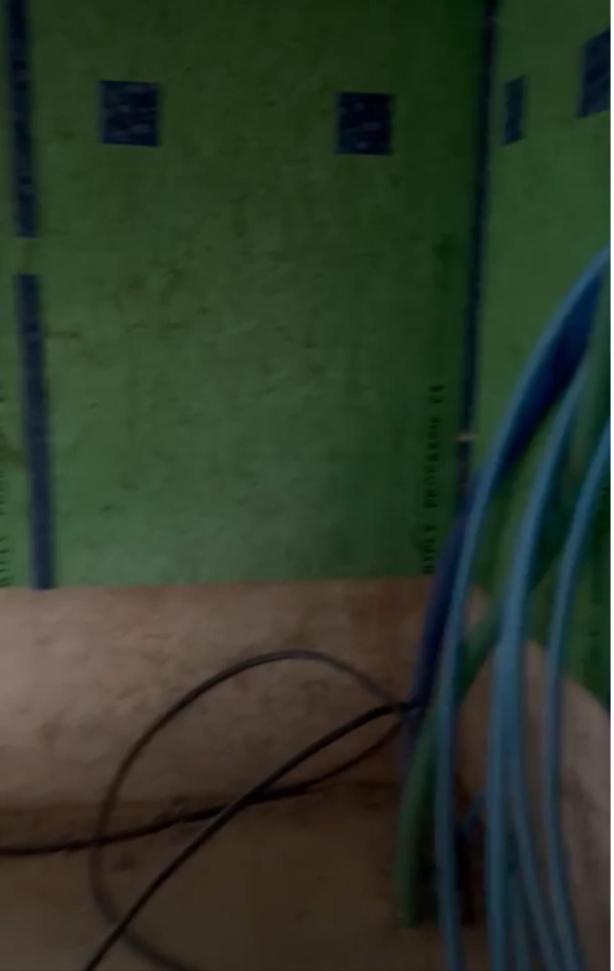

Omnibuswoman Posted March 19, 2024 Posted March 19, 2024 Our plant area for DHW tank and MVHR currently only has Pro-passiv OSB and airtightness tape on the walls. Before the plumber arrives next week to begin installing the hot water tank and pipe work, should we put up a wall lining to make it look a bit neater? The plant area will become a cupboard eventually. We’ve not yet battened out these walls, but can do so if necessary. Thanks!

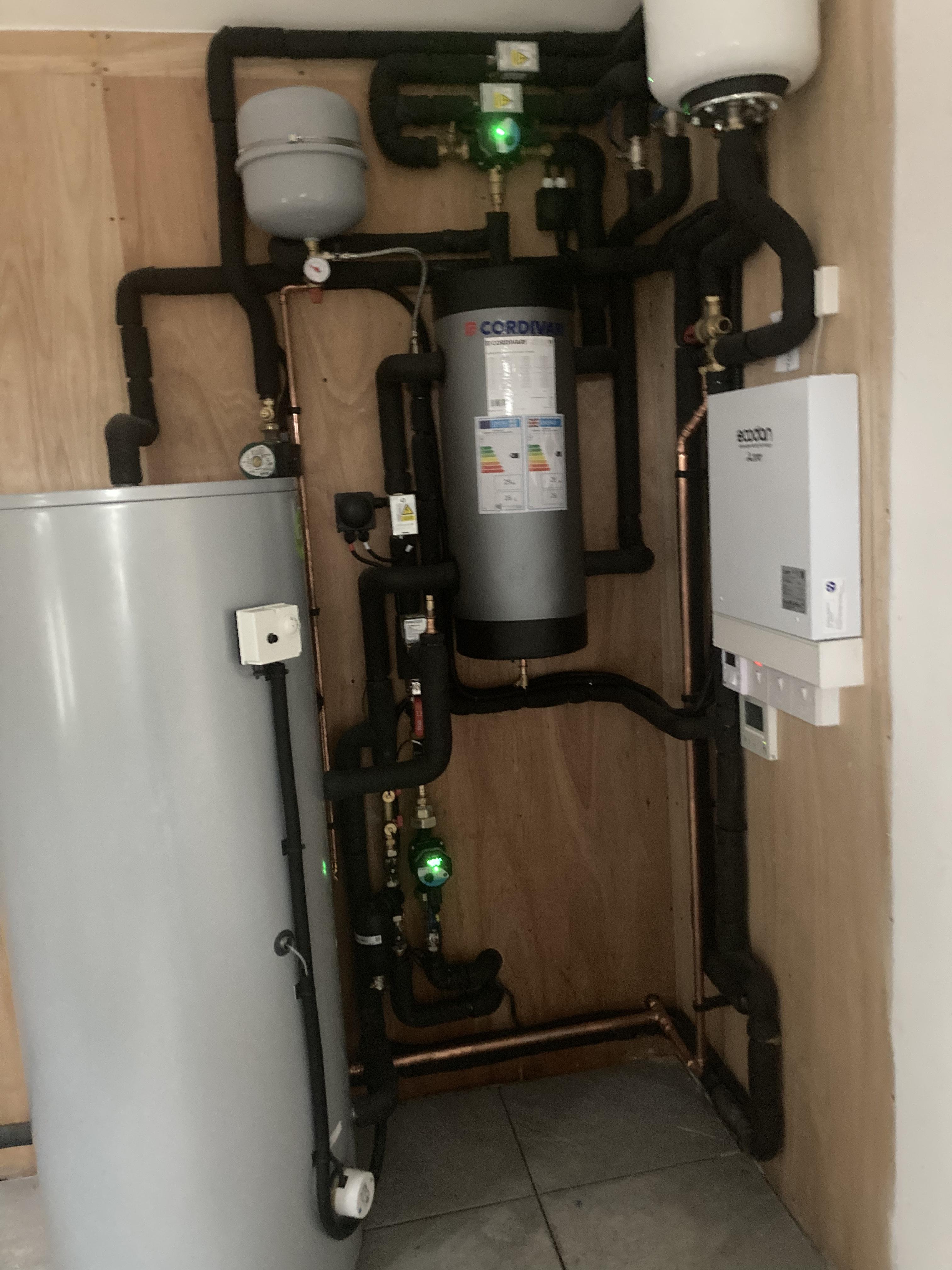

Kelvin Posted March 19, 2024 Posted March 19, 2024 Well it’s harder to do after. I boarded mine with 12mm plywood that I painted white. The mistake I made was not putting in a self-levelling floor screed to bring it up to the same eventual height as the floor tiles from the hallway so we now have a step. I will still put in a self-levelling screed but I’ve made things harder for myself now everything is in the plant room as always. 1
nod Posted March 19, 2024 Posted March 19, 2024 I buttoned and fixed a membrane Then used a 12 mill faced ply 2

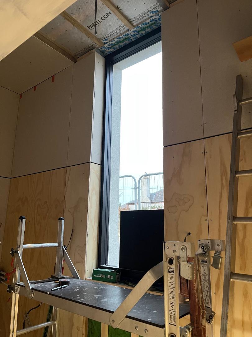

Russell griffiths Posted March 20, 2024 Posted March 20, 2024 I used 18mm osb, then sheets of fermacel then a couple of coats of eggshell paint so any dirty fingerprints wash off. as has been said, bring your floor level up either level or higher than ffl in the house, you don’t want a drop down in there when the main house is done. nice ply would work just as well, I just wanted something with a fire resistant rating in case bc becomes a plonker. 1
Dave Jones Posted March 20, 2024 Posted March 20, 2024 used 18mm mdf for ours. gives really solid fixing for all the kit. 1
markharro Posted March 20, 2024 Posted March 20, 2024 We've gone for "nice" ply (great BandQ find) and fermacell for ours..... 1

Conor Posted March 22, 2024 Posted March 22, 2024 I feel like a plant room is one of the most likely sources of a fire in a house (we have solar inverter, all networking gear, CCTV, MVHR, solar diverter etc) after kitchen and tumble dryer... We had all our walls ply lined, ceiling boarded with fire board and standard board on the walls. Fitted fire door as well and smoke detector. Only piece of exposed wood (consumer unit board) was painted in intumescent paint. 1
