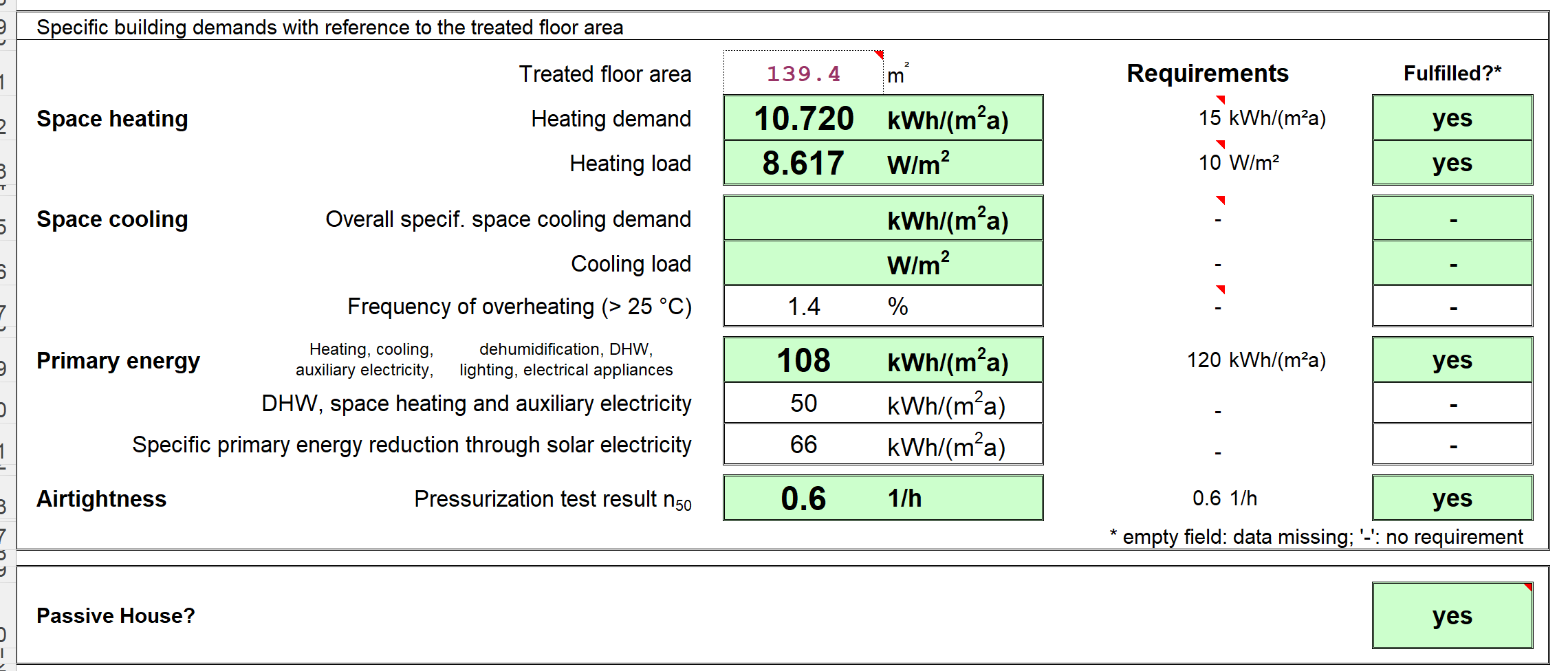

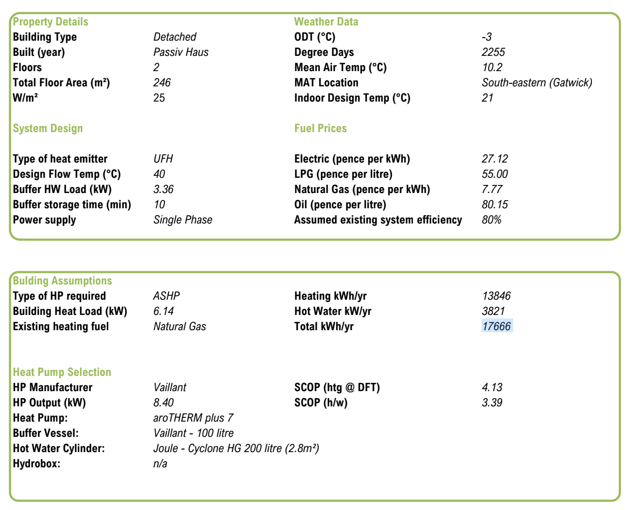

MikeSharp01 Posted March 8 Share Posted March 8 I know we, the forum in general have discussed this N times (where N is a very big number) but I thought I would start a new thread as a contemporary home for the same old chats we have had already but with a twist - see if you can spot it. We already had the discussion about having to be at least as well educated as your supplier if you want to get the system sized & designed properly for your house. I have also come across a good volume of people who have the most awful stories to tell about installations. There is also the buffer tank / no buffer tank debacle among many other things. We have been going round the houses, trying to get three quotes to do ours. Here is where we are: It's designed to be a passive house (PH) although we probably won't certify it. I did the design training and have built the whole thing around the PHPP with the architect. The Brief: We need someone to install and MCS certify, so we can take advantage of the grant, a very small list of things: 1. A UVC 2. A Heatpump 3. The plumbing for those two and our UFH which is already in the slab. 4. The controls for the above - no use of cloud systems and all systems OPEN. Background Information: (Given to all the suppliers) We already have the UFH pipes sticking out of the slab, 28mm Flow and return pipes from the utility room (UR) to the ASHP base, suitable cabling for almost any ASHP on the market from the ASHP back to the UR with room in the duct for more if needs be. The UVC will be 2.1m from the UFH header around the utility room wall. The PHPP says we need 10.288 kWh/(m2a) the TFA (Treated Floor Area) is 139.4m2 - the actual area is about 156m2 but TFA is the metric PHPP uses. Based on the above you can imagine we have good insulation - the air test is still to come but I will work at getting that well below 0.6 ACH (PH metric) SO I think I can stand by the PHPP outcome - it is roughly in line with other similar sized PH dwellings discussed on here. They all received the PHPP verification page, a full set of the Building Control (BC) drawings, the U values for the walls, the roof & slab along with the average Uw value for the window and roof-light packages (Triple and Quadruple glazed respectively) and a layout plan of the utility room showing where everything needs to go and the dimensions allowed for. To date we have had two indicative quotes (IQ) (Which are in themselves something of a conundrum because my understanding of a quote is that it is fixed - so not indicative.) The first company sent a chap to visit, he spent 10 minutes looking at the house and left - sending me a quote within 3 hours. No information about the units (brand / size / control ability / etc). The second firm we found via the famous site who seem, judging by their Youtube channel, to know their stuff and are certifying installers who take their training. They did not visit but worked off, or not, the information package discussed above. I won't share the quote but here are a couple of comparative sets of numbers to look at: First - the PHPP verification page - (True this is as designed but all the insulation is in as are the windows - just air tightness to confirm) Then the heat load response calculation by the second potential supplier on which the 2nd quote is based - How can these two be so far apart? From my perspective the laws of physics tell me that if you put 8.4kW into the house I told them about you will definitely cook it! Yet the IQ (Oxymoron perhaps) seems to want to tell me that the house is 1.5 times as big as the drawings they were sent and consumes about 2.5 times as much energy as the best estimating system on the planet for such things (other of course than the JSHarris Spreadsheet) thinks it will. They also want to fit a buffer tank and I have not allowed for this in the utility room - cos I could not see I would need one and still don't think I do! So what have I missed - like a huge heat sink / cold bridge or three that I forgot to put into the PHPP, perhaps a couple of rooms I have forgotten I have built or their assumption that with all this insulation we are still just going to let the air out via trickle vents (big ones) rather than use the MVHR which is clearly shown in the drawings and accounted for in the PHPP? It makes you wonder and so it looks to me like I need to kiss a few more frogs! Are we allowed to say such things here! I mean I don't mind if they turn into a princess or a prince I just want them to make me feel like they know what they are doing! Link to comment Share on other sites More sharing options...
JohnMo Posted March 8 Share Posted March 8 Couple of things jump out, floor area Degree days, is huge, they are treating the degrees like a 'normal house' If it's MCS, they will always ignore MVHR and apply Thier own room air change rates - the system doesn't account for any other than the normal. Link to comment Share on other sites More sharing options...

MikeSharp01 Posted March 8 Author Share Posted March 8 12 minutes ago, ProDave said: Have you actually costed forgetting the silly grants that force the use of MCS contractors. and just buy the kit and employ a trusted plumber and electrician, or just do it yourself? Yes and it's about £4k + The VAT which I will get back at the end, so as long as the quote is below around £11k then I will go with it - as long as I trust then and their technology otherwise not. Link to comment Share on other sites More sharing options...

Bramco Posted March 9 Share Posted March 9 9 hours ago, MikeSharp01 said: Yes and it's about £4k + The VAT which I will get back at the end, so as long as the quote is below around £11k then I will go with it - as long as I trust then and their technology otherwise not. Mike, you might be asking the wrong people the wrong question. Most heating system suppliers do run of the mill jobs and work to their 'rules of thumb', so if they always quote for a buffer tank for example, then you're going to get a buffer tak in your proposal - it's easier for them. They work to a formula - it's not worth their time doing some fancy (in their terms) special for a clued up client. On the wrong question front, we had our plumber install the UVC, UFH buffer tank both with double immersions. They installed the manifold and connected it to the buffer tank. So something any plumber could quote for. And nothing covered by MCS. We then got a quote for an ASHP, all MCS certified and with the grant application. So maybe you need to split the job into it's constituent parts and ask for 2 quotes. Although you will have to be quite persuasive to overcome the ASHP suppliers 'knowledge' which will have them telling you, you need a new UVC, a buffer tank and that your heating demand can't possibly be right.... A good example of this was someone on here, or maybe another forum bemoaning the fact that they had had great use out of a 2 immersion PV diverter for many years, but now Octopus were installing their ASHP, they were ripping the old UVC out and replacing it with a new tank with only one immersion, cos that's the way they do it. So only PV diversion to the top of the tank. We gave our ASHP supplier a full room by room heat loss analysis done by our M+E engineer, they simply duplicated this in the MCS pack. After some persuasion, they accepted that their real role was supply and fit of the ASHP and controller and connecting said ASHP to the buffer tank and UVC with a 3 port valve - so it is possible. Finally on point 4 above, you'll be lucky!! 10 hours ago, MikeSharp01 said: 4. The controls for the above - no use of cloud systems and all systems OPEN. You might have to take what you're given and then replace it if necessary - it almost certainly won't be open. Simon Link to comment Share on other sites More sharing options...

SimonD Posted March 9 Share Posted March 9 All seems pretty worrying really. I guess you've asked the 2nd quote whether they've actually sent you the right quote and not got it mixed up with something else? As a slight aside, if the company you refer to is the one I think it is, I always find myself watching the content with caution and won't rely on it without further due diligence. I tend to be even more cautious when such a private organisation that depends on hits/likes/views etc. starts promoting a de facto expert scheme. Link to comment Share on other sites More sharing options...
