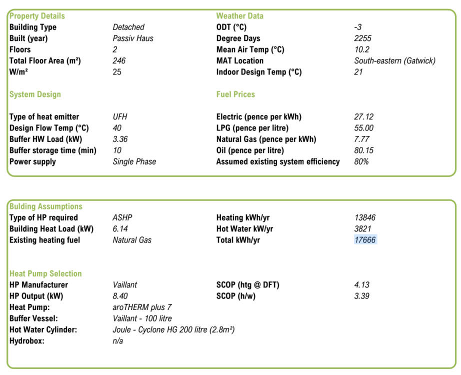

mk1_man Posted March 14, 2024 Posted March 14, 2024 I have had the quote back and I have to say really happy with proposal. Basically it is proposed as an 11.2kw Mitsubishi Ecodan along with all associated wifi adapter, fixing, valves etc also a new 250l stainless cylinder with 28mm 3m2 heat pump specific coils - spec looks really good. This is for either myself or a local (non mcs) plumber to do install and then company comes and commissions it. Cost all in is £9000 but with the £7500 back from grant I pay £1500 The Mitsubishi wasn't on my radar and had looked for the new Samsung R290 unit. What are peoples thoughts on the Ecodan, will I get decent figures if installed correctly. I am looking to have no buffer / LLH, no mixers or pumps on the underfloor manifolds (ground and 1st floors) single large zone with no actuators etc I understand this gives best efficiency? Appreciate peoples views, especially those with Mitsubishi units. I still think the 11.2kw is on the large side, curious as to know what it will modulate down to ?
JamesPa Posted March 14, 2024 Posted March 14, 2024 (edited) 7 minutes ago, mk1_man said: I have had the quote back and I have to say really happy with proposal. Basically it is proposed as an 11.2kw Mitsubishi Ecodan along with all associated wifi adapter, fixing, valves etc also a new 250l stainless cylinder with 28mm 3m2 heat pump specific coils - spec looks really good. This is for either myself or a local (non mcs) plumber to do install and then company comes and commissions it. Cost all in is £9000 but with the £7500 back from grant I pay £1500 The Mitsubishi wasn't on my radar and had looked for the new Samsung R290 unit. What are peoples thoughts on the Ecodan, will I get decent figures if installed correctly. I am looking to have no buffer / LLH, no mixers or pumps on the underfloor manifolds (ground and 1st floors) single large zone with no actuators etc I understand this gives best efficiency? Appreciate peoples views, especially those with Mitsubishi units. I still think the 11.2kw is on the large side, curious as to know what it will modulate down to ? Thats all very encouraging and the concept of separating commissioning/design from install is clearly potentially a sensible way forward. 11.2kW sounds a bit toppy from the info you have given, but... Mitsubishi publish comprehensive performance tables (probably the moist comprehensive and certainly the easiest to find/read) tables in their Ecodan_ATW_Databook. Suggest you search for the latest version (if you cant find it post again). The tables include min output as a function of OAT and FT (ie exactly what you need to do the design right!). From memory its about 4kW at 40C/12C, but you need to check for your design parameters Edited March 14, 2024 by JamesPa 1
SimonD Posted March 14, 2024 Posted March 14, 2024 26 minutes ago, mk1_man said: I have had the quote back and I have to say really happy with proposal. Basically it is proposed as an 11.2kw Mitsubishi Ecodan along with all associated wifi adapter, fixing, valves etc also a new 250l stainless cylinder with 28mm 3m2 heat pump specific coils - spec looks really good. This is for either myself or a local (non mcs) plumber to do install and then company comes and commissions it. Cost all in is £9000 but with the £7500 back from grant I pay £1500 So just to confirm, this is what you pay them? And if you employ a plumber to do the install, you would have to pay for that separately and in addition to this price?
mk1_man Posted March 14, 2024 Posted March 14, 2024 (edited) Correct, would have to pay plumber, however my plan is to plumb myself, not complicated and have already done majority of existing. Even if you were to pay plumber it is at around £200 - £250 per day for a couple of days, much cheaper than the the £4k - 5k other 'mcs' companies are ripping people off to the tune of. Alto Energy run their own free training, so as long as your installation plumber or you yourself as the self builder attends the installation still qualifies for the Mitsubishi 5 - 7 year warranty. Edited March 14, 2024 by mk1_man

mk1_man Posted March 20, 2024 Posted March 20, 2024 They also do the training remotely via Microsoft teams. I have been incredibly impressed with AltoEnergy and their feedback is excellent. After a bit of back and forth have decided on final spec, cost etc. What are peoples views on the R32 Mitsubishi Ecodan heat pumps, especially the 8.5kW unit ?
