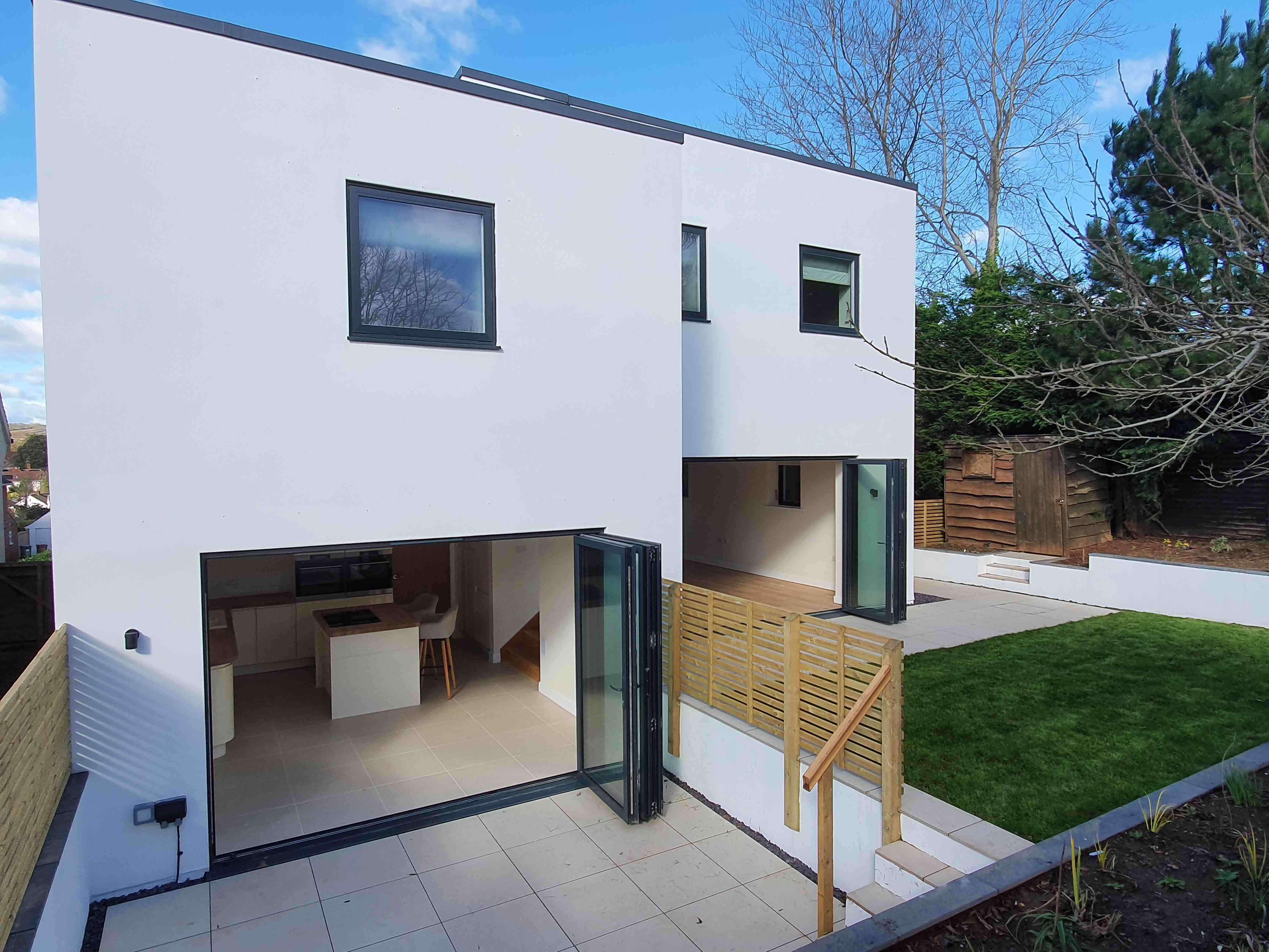

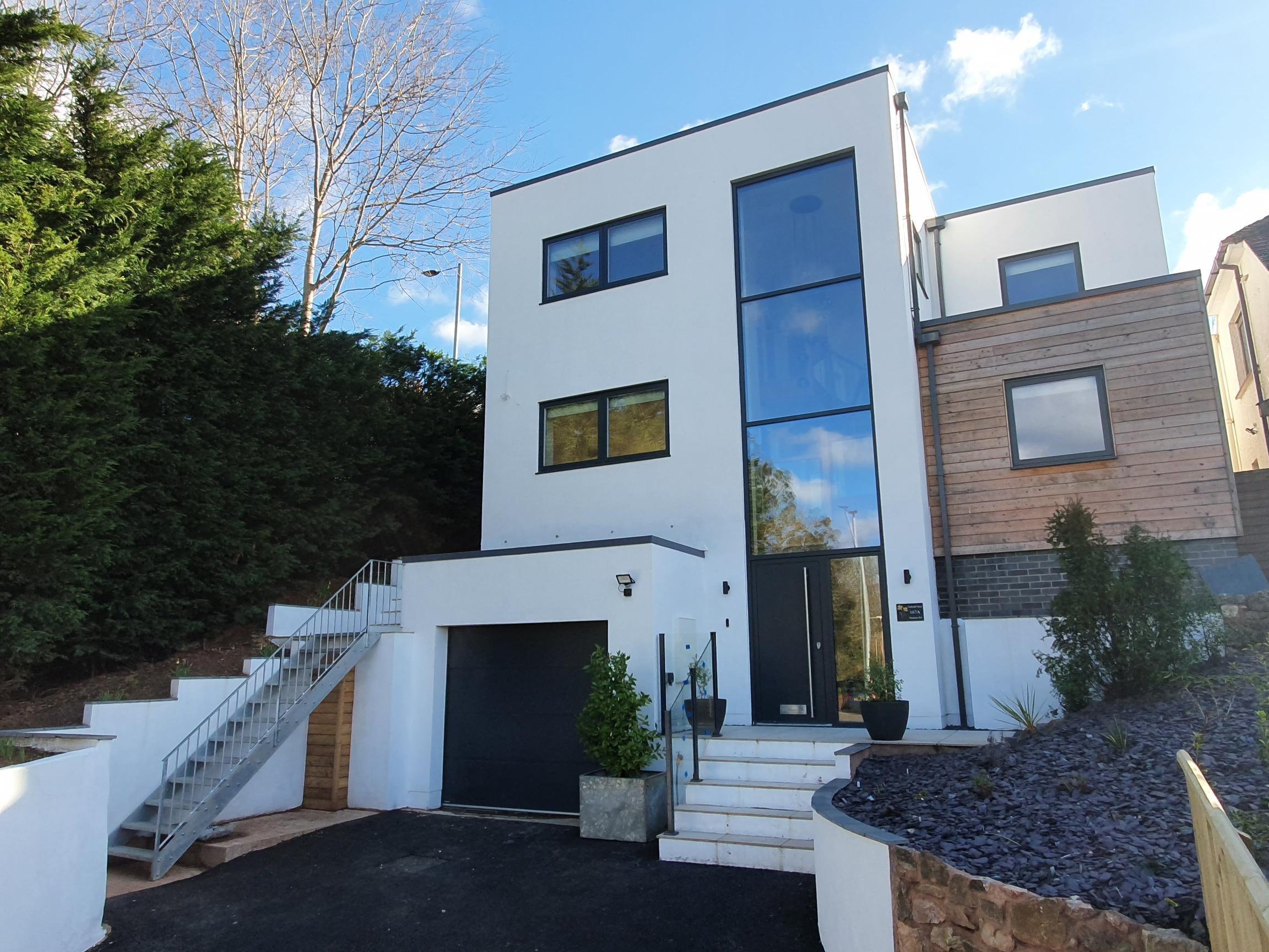

Moonshine Posted March 2, 2024 Share Posted March 2, 2024 (edited) We have smarts door, curtain walling, and bifolds. Matched with rational alu clad windows. All triple glazed. Nice doors Edited March 2, 2024 by Moonshine 1 Link to comment Share on other sites More sharing options...

flanagaj Posted March 2, 2024 Author Share Posted March 2, 2024 12 hours ago, Moonshine said: Looks very nice Link to comment Share on other sites More sharing options...

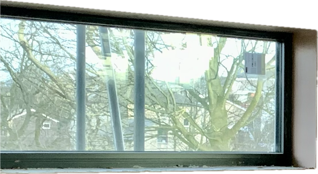

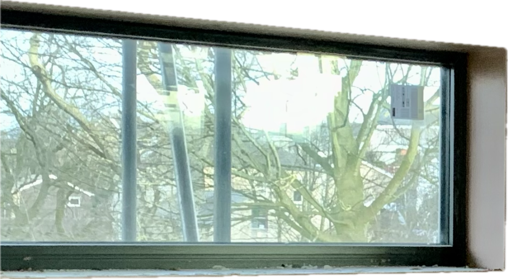

bgmill Posted March 2, 2024 Share Posted March 2, 2024 42 minutes ago, PNAmble said: We went Alu-clad uPVC (internorm) - I had to get over ‘they’ll look like plastic issue’. They don’t and are foil anthracite inside. Very good, thermal and u-value and airtightness (u-values is only part of the performance). We have previously gone aluminium sliders, windows and doors in a previous project 5 years ago and although documented performance was good, the real performance of the frames was shocking with condensation. Do you have any pics of the inside of the windows? Link to comment Share on other sites More sharing options...

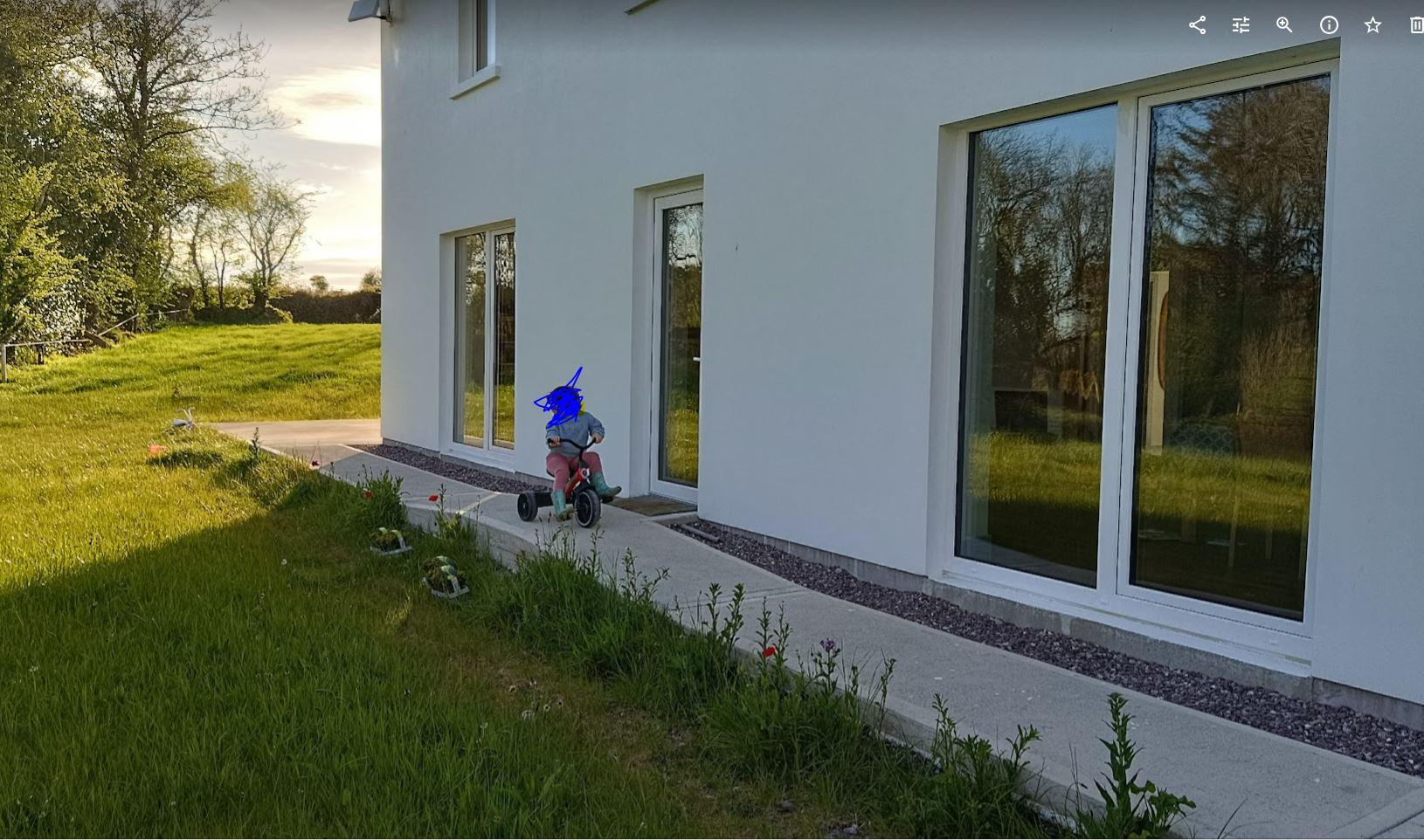

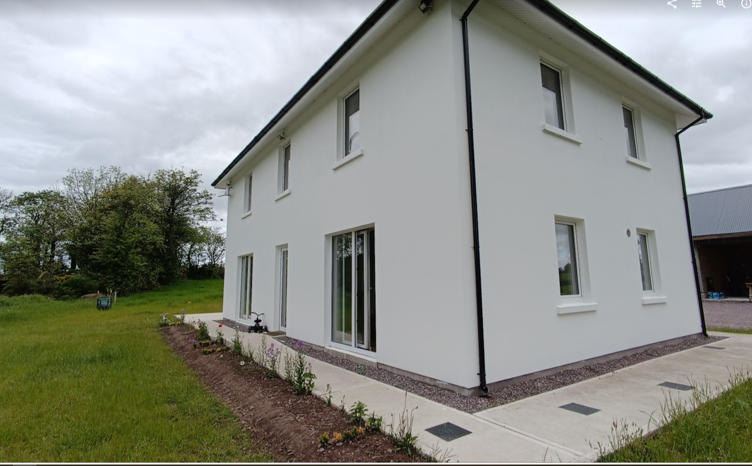

Iceverge Posted March 3, 2024 Share Posted March 3, 2024 There has been issues with some very high performance systems from the continent being built under licence that too. I think they were omitting thermal breaks and so forth completely destroying any thermal benefits they claimed to have. Plain uPVC windows are often absolute rubbish too. Poorly built with minimal reinforcement. Outward opening casements looked naff with very bulky profiles and trickle vent covers. However. Higher standard ones are available . Residence 9 do some very traditional looking ones if that's your thing as do Linear amongst others. However these wouldn't be my first consideration. If you could get proper uPVC Tilt and Turn windows with triple gasketed sashes, thermally broken frames and triple glazed panes with warm edge spacers I would go that direction. Like wise don't skimp on the hardware. Here's a shot from the distance of our VEKA 82 Softline profile windows. White uPVC T&T. €16k in 2020 inc VAT for 20 units including 2 x tilt and slide units.. Link to comment Share on other sites More sharing options...
PNAmble Posted March 3, 2024 Share Posted March 3, 2024 7 hours ago, bgmill said: Do you have any pics of the inside of the windows? I’ll get a picture of the slider today and a couple of the tilt and turns. They’ve mostly got the white protection tape on at the moment. Link to comment Share on other sites More sharing options...
