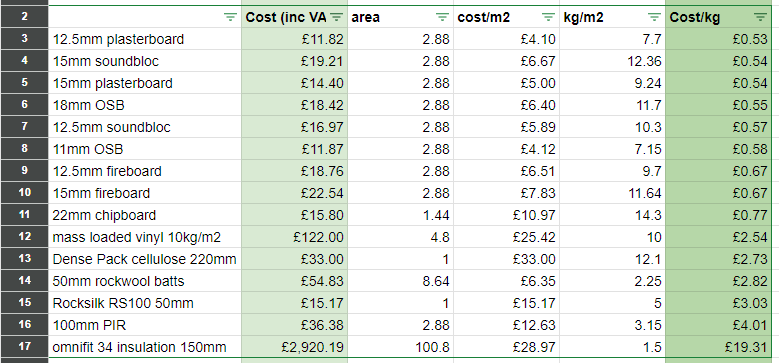

Spinny Posted February 28 Share Posted February 28 My warm roof with PVC membrane is quite noisy when it rains. Almost seems to leave me inside a drum as the noise comes through the 150mm PIR and plywood deck beneath. I am also having recessed downlights and speakers in the ceiling beneath. So my plan is to stick a layer of tecsound mass loaded vinyl to the underside of the ply between the joists. Then a layer of 50mm rock wool. This will leave me enough ceiling void for the recessed lights. Does this seem a reasonable approach (as I really don’t want to mess about with resilient bar/clip systems) ? Link to comment Share on other sites More sharing options...
Moonshine Posted February 28 Share Posted February 28 I don't think that the mass loaded vinyl will do a significant amount. 100mm acoustic insulation between the joists will be a better solution paired with resilient bars. However you need to be careful of the risk of interstitial condensation. This was our roof type I got a couple of insulation firms to do a interstitial condensation risk analysis based on my geographical location, which showed no condensation in the lower layers (below the vapour barrier) 2 Link to comment Share on other sites More sharing options...

Iceverge Posted February 28 Share Posted February 28 9 hours ago, Spinny said: My warm roof with PVC membrane is quite noisy when it rains. Almost seems to leave me inside a drum as the noise comes through the 150mm PIR and plywood deck beneath. I am also having recessed downlights and speakers in the ceiling beneath. So my plan is to stick a layer of tecsound mass loaded vinyl to the underside of the ply between the joists. Then a layer of 50mm rock wool. This will leave me enough ceiling void for the recessed lights. Does this seem a reasonable approach (as I really don’t want to mess about with resilient bar/clip systems) ? 1. Block air paths. Acoustic sealant around the edges. Block all gaps. Get rid of the downlights and speakers. 2. Add mass. Just adding more standard plasterboard is the cheapest way. Soundbloc or OSB is similar £/kg. Mass loaded vinyl is much dearer as is insulation. 3. Stop resonance. Add something fluffy in the void to stop sound bouncing around. Id be happy with up to 150mm of Rockwool there with 150mm of PIR on top. 4. Stop sound transferring through the structure by breaking the physical link. eg resilient bars. Link to comment Share on other sites More sharing options...

Spinny Posted March 1 Author Share Posted March 1 Thanks for all responses. It is a definite drumming or pattering noise. At present with no plasterboard up it can seem like standing inside a shed. Yes a lot of rain is only drizzle, but when you are building something you want to get it right for the decades to come. I don’t really get why interstitial condensation should be an issue and nor did my architect. It’s a warm roof with its own built in vapour barrier. The whole point is the temp underneath will essentially be room temp ? I am not going to get rid of the recessed downlights and speakers because I want that aesthetic. This does mean the plasterboard will have some 25 apertures which compromises its use as an acoustic barrier. I can put 100mm rock wool between joists where there are no downlights. Maybe some acoustic hoods but they seem expensive. Link to comment Share on other sites More sharing options...
Moonshine Posted March 1 Share Posted March 1 7 minutes ago, Spinny said: I don’t really get why interstitial condensation should be an issue and nor did my architect. It’s a warm roof with its own built in vapour barrier. The whole point is the temp underneath will essentially be room temp ? In a warm roof there is no issue, but by starting to put insulation under the vapour barrier between the joists your are creating a hybrid roof. Acoustic Insulation has thermal properties too. You can create a temperature differential in that cavity under the vapour barrier which can cause condensation if the upper surface gets cold enough. The key is to make sure that the thermal properties in the cavity aren't too high to limit that temp difference. Link to comment Share on other sites More sharing options...

Spinny Posted March 1 Author Share Posted March 1 11 minutes ago, Moonshine said: You can create a temperature differential in that cavity under the vapour barrier which can cause condensation if the upper surface gets cold enough. With 150mm PIR in the south of England shouldn’t be a problem ? Was thinking to hold the rock wool up against or near the underside of the roof using some kind of support like chicken wire mesh ? Link to comment Share on other sites More sharing options...
Spinny Posted March 1 Author Share Posted March 1 5 minutes ago, Moonshine said: 17 minutes ago, Spinny said: That's not what it's designed for, this stuff is to go on top of the joist, with a floating floor It does say… ‘This product, used upside down, can also provide the resilient layer required for customers to make up their own resilient battens.’ But I suppose scores of penetrating plasterboard screws may render it useless. Link to comment Share on other sites More sharing options...
Moonshine Posted March 1 Share Posted March 1 16 minutes ago, Spinny said: But I suppose scores of penetrating plasterboard screws may render it useless. Yep, pretty much that. Link to comment Share on other sites More sharing options...
Iceverge Posted March 1 Share Posted March 1 11 hours ago, Dave Jones said: delink the roof from the new plasterboard. https://www.ikoustic.co.uk/products/isolation-clips/muteclip/ The cost might be prohibitively Vs resilient bars. 1 Link to comment Share on other sites More sharing options...
Iceverge Posted March 1 Share Posted March 1 11 hours ago, Spinny said: am not going to get rid of the recessed downlights and speakers because I want that aesthetic. This does mean the plasterboard will have some 25 apertures which compromises its use as an acoustic barrier. I can put 100mm rock wool between joists where there are no downlights. All the adding mass in the world makes little difference if the ceiling is full of holes. Think of a 1m wide solid stone dividing wall between two rooms with a door opening. You would hear more through it than the most crappy partition wall. You could always put in a couple of layers of plasterboard above a service cavity but you're loosing ceiling height then. These are the trade offs of building. 1 Link to comment Share on other sites More sharing options...
