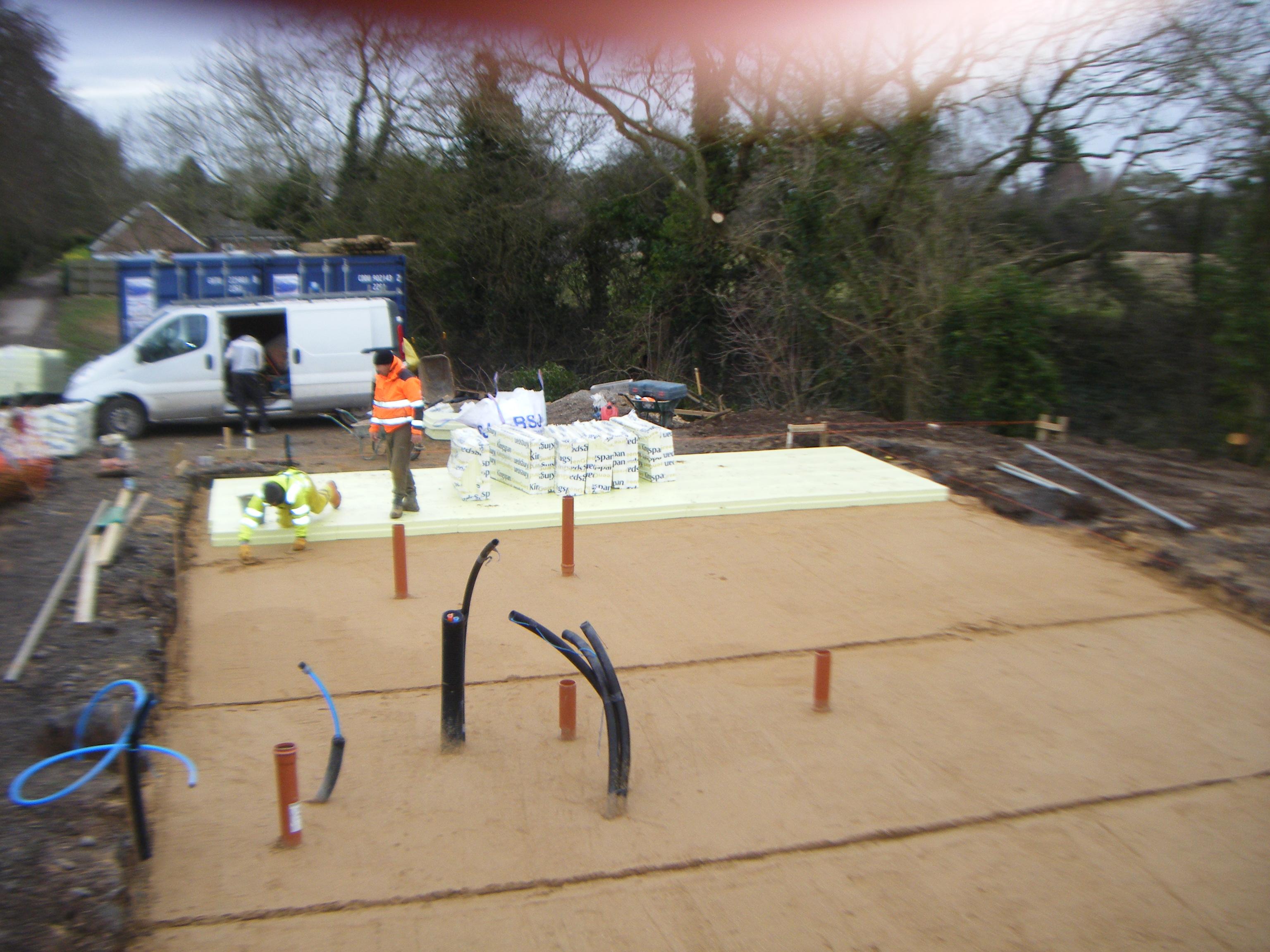

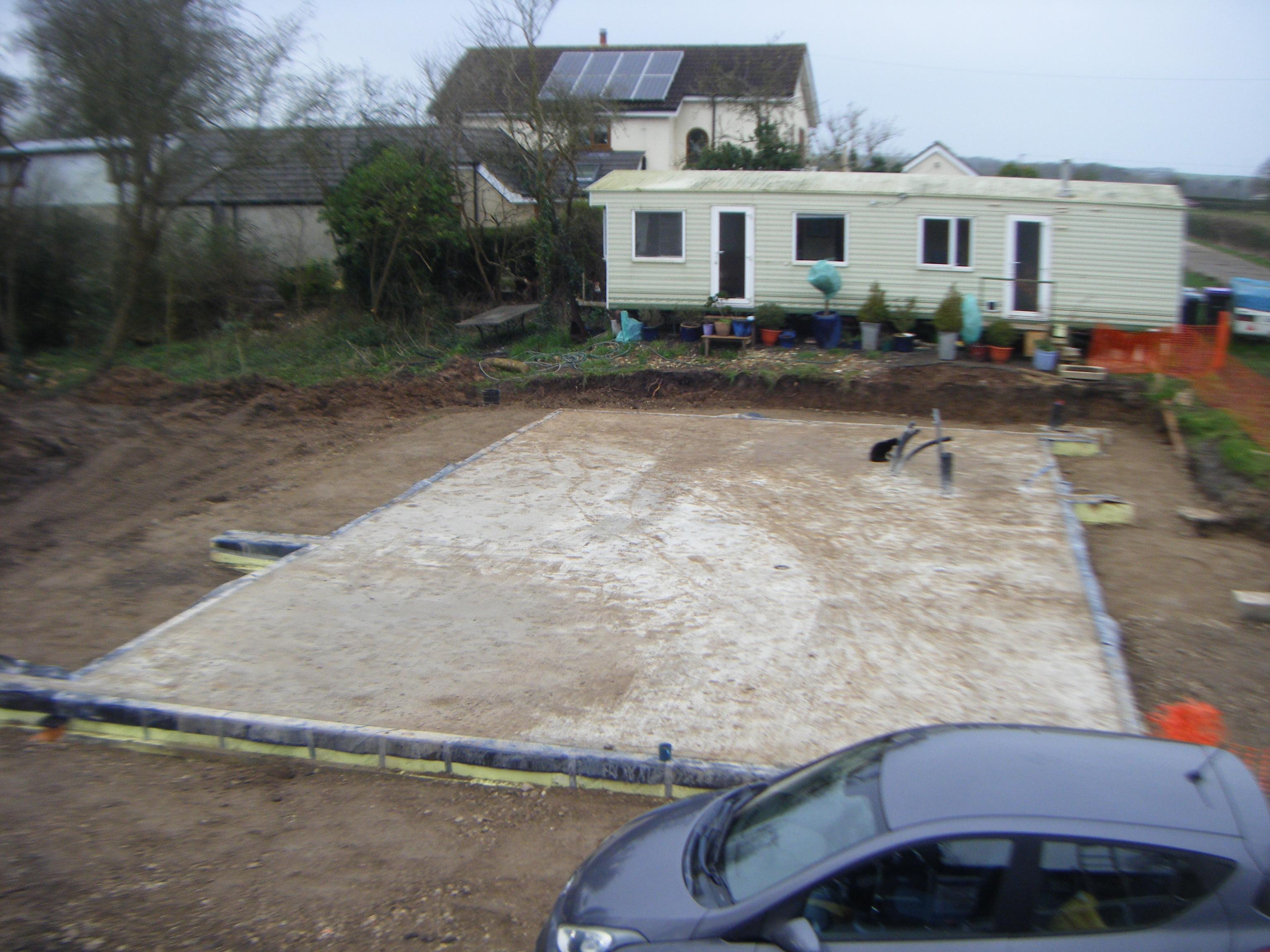

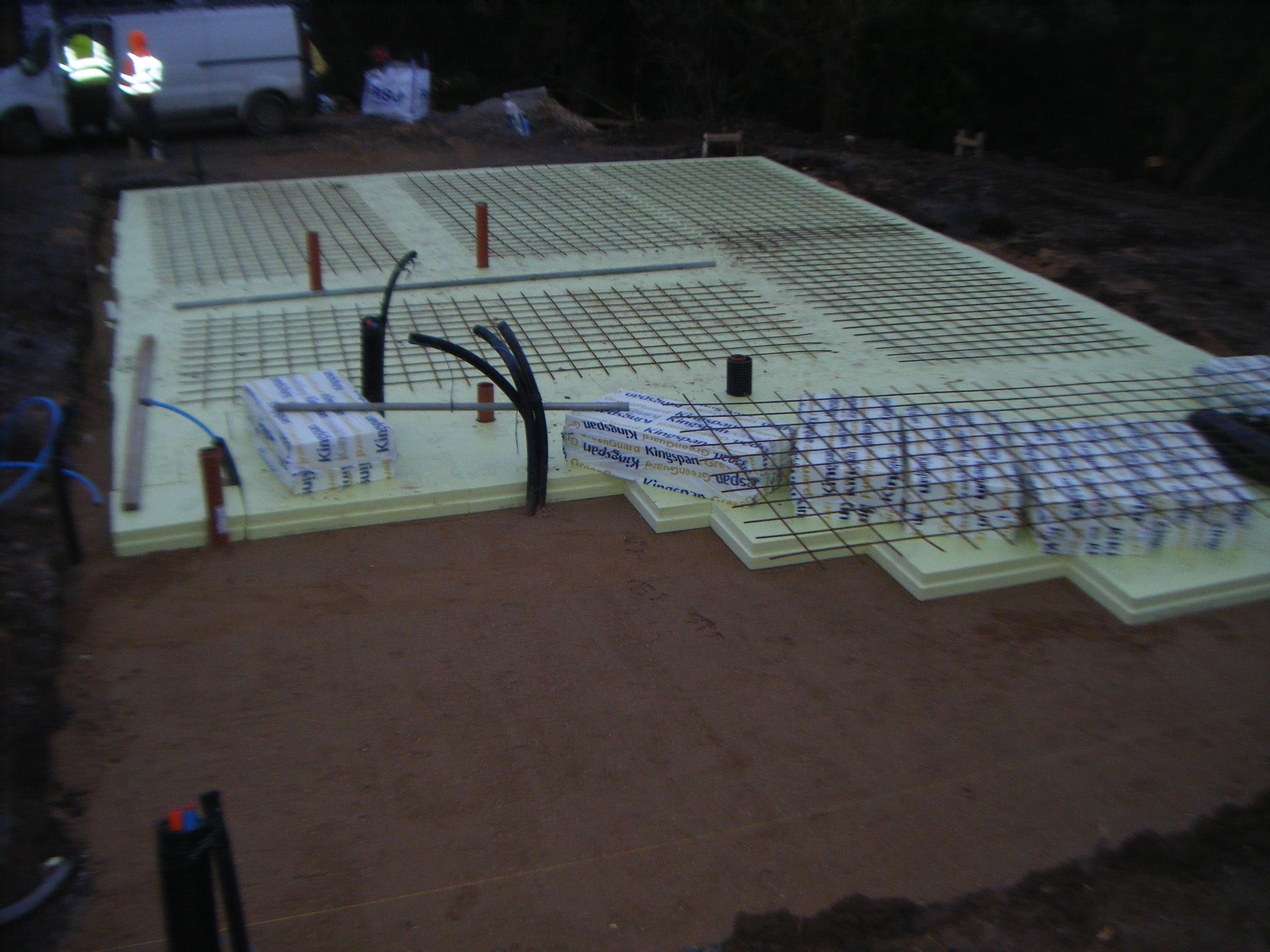

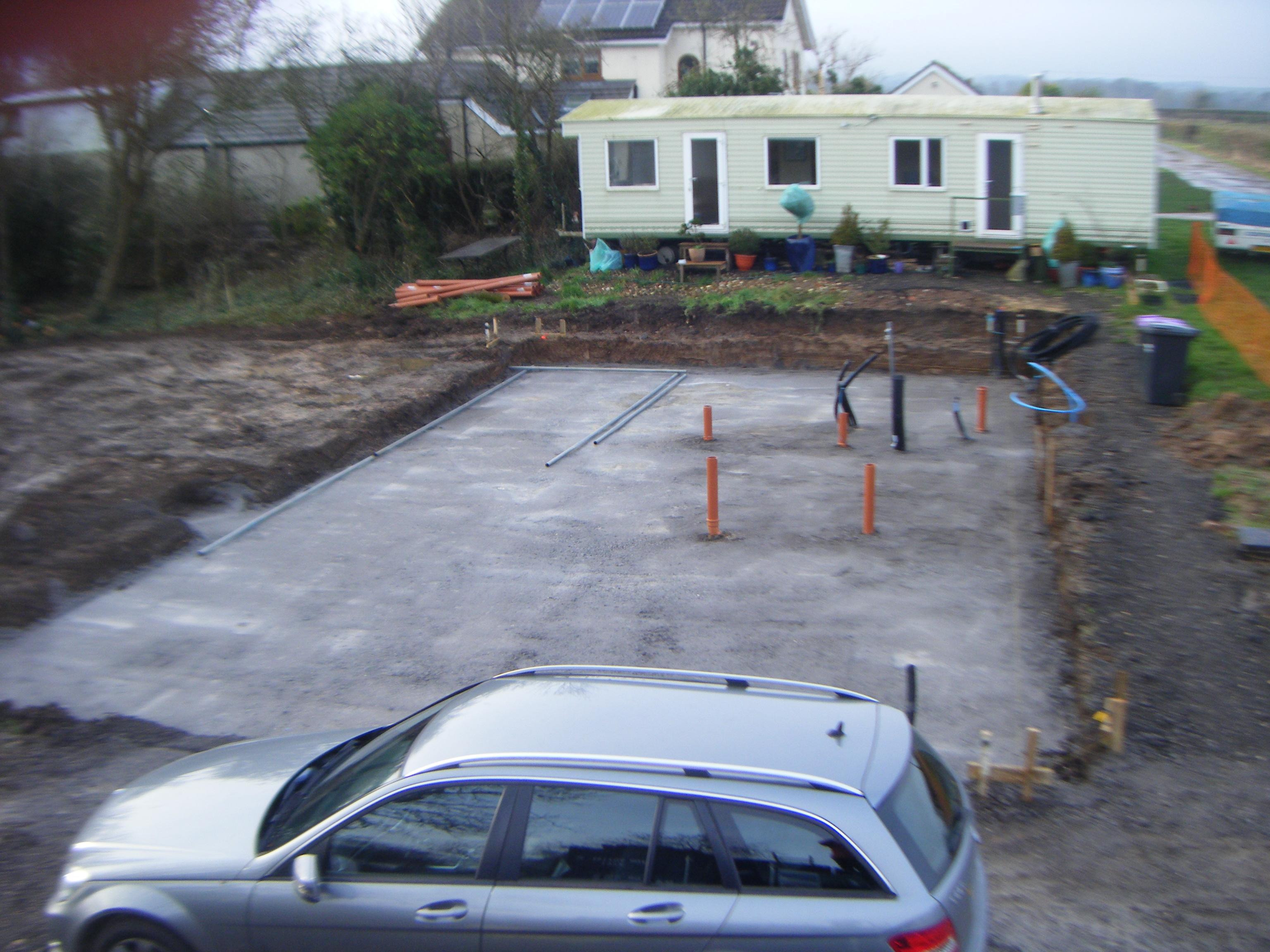

kandgmitchell Posted February 29, 2024 Author Posted February 29, 2024 As asked for here are some photo's. 8043 is the stone base done. 8046 the sand blinding, 8047 the sub raft insulation under way. 2

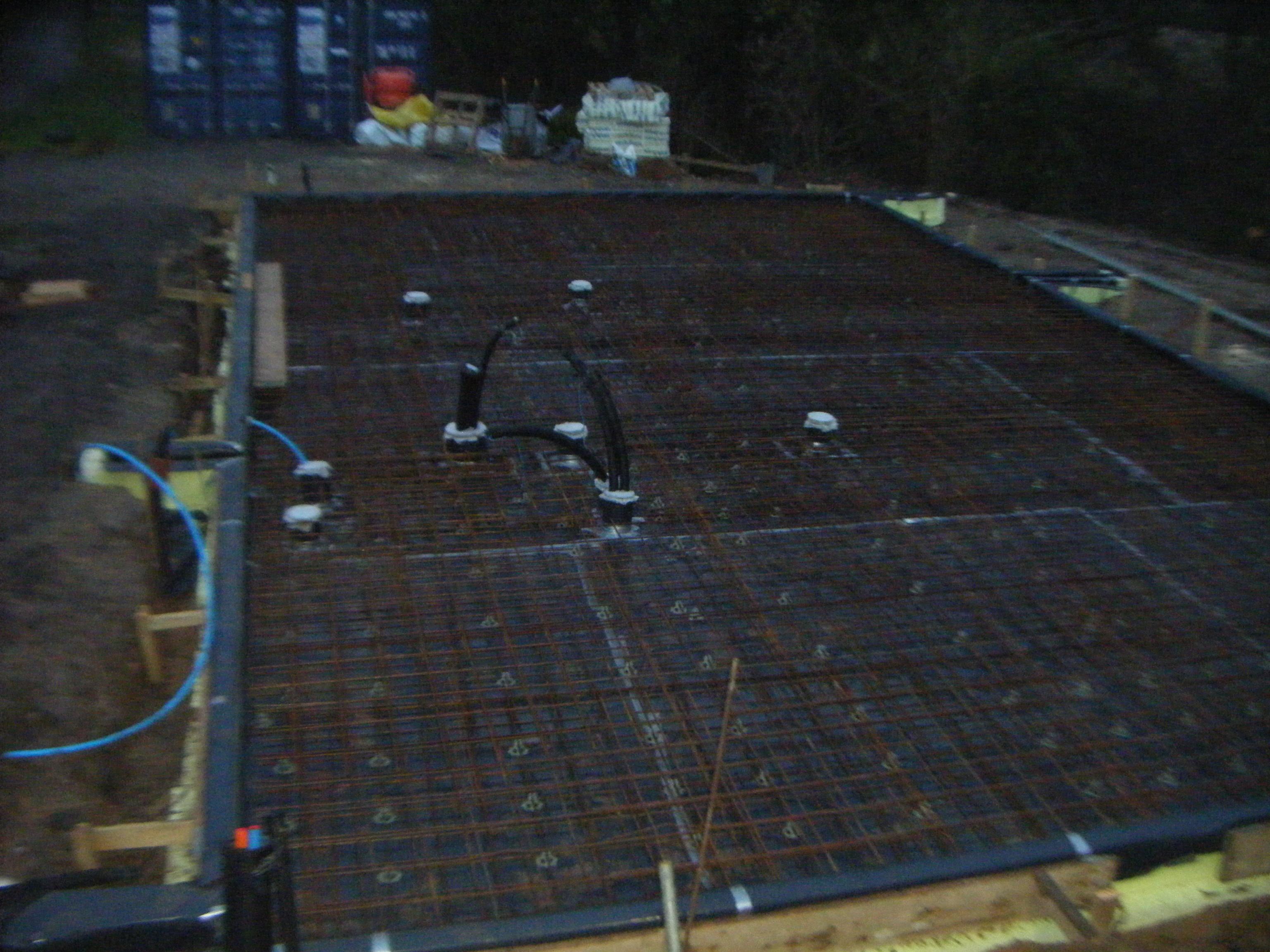

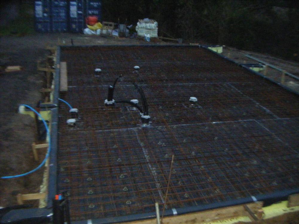

kandgmitchell Posted February 29, 2024 Author Posted February 29, 2024 Final two photo's 8053 is the steel, sorry it was getting dark when I rembered to take this. Layer of A393 mesh in bottom and top with a further layer of A393 min 1.0 m wide around the upper perimeter (we just used the 1.4m offcuts from the main mesh). A couple of embedded beams using 16mm bars where the main load bearing walls are. 8059 is the finished raft with a muddy surface due to the state of the ground whilst the rain water drainage was being done. I'll power wash it off before the frame arrives. 3 1
jack Posted February 29, 2024 Posted February 29, 2024 Thanks for the photos. Is your stone base MOT1 or similar? I've more commonly seen large no-fines stone specced - something like railway ballast.
tuftythesquirrel Posted February 29, 2024 Posted February 29, 2024 On 26/02/2024 at 16:15, kandgmitchell said: Just to add to the wealth of knowledge on here. We have just completed our insulated raft using xps with concrete 250mm thick at 100m2. Installed the foul drains and surface water out to a soakaway. All in, including labour it's come to £26K and a bit. Hope this might help with others budgeting. Could you tell me how thick was the XPS as it will affect the budget if I go thicker. Thanks.
kandgmitchell Posted February 29, 2024 Author Posted February 29, 2024 The stone was MOT1 type stuff which I think is max 30mm downwards. It packed tight with a 2T vibrating roller. I used 150mm xps for the insulation because the Dan Wood spec uses 90mm of insulation across the top of the raft. I could have added more but it was diminishing returns really. 1
