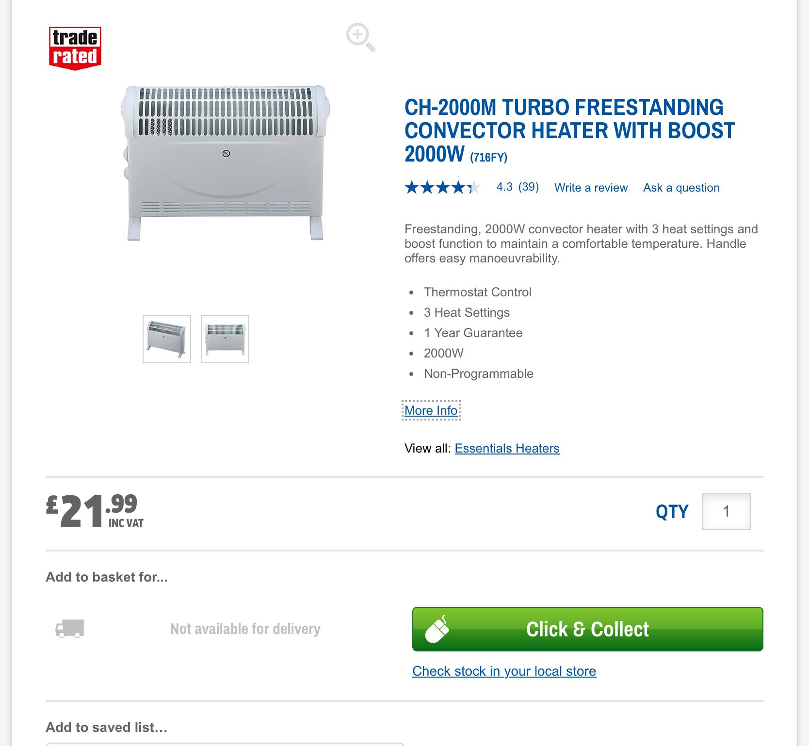

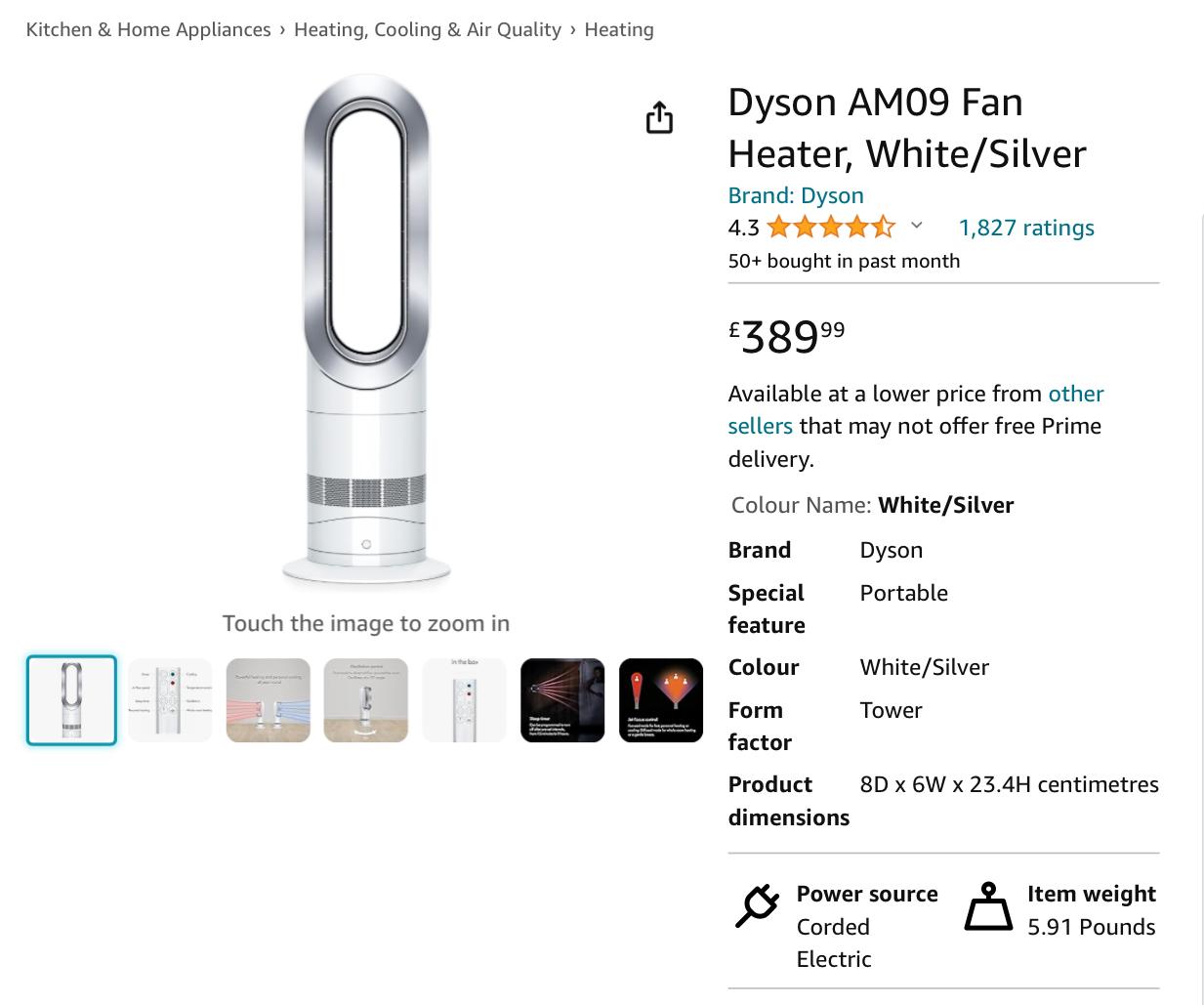

Iceverge Posted February 20, 2024 Share Posted February 20, 2024 9 minutes ago, M-Rod said: they will have a resale value, Very little I'm afraid. 10 minutes ago, M-Rod said: Could you give me some idea of heating costs per unit All electric resistance heaters will be identical if they use a thermostat to turn on when the room cools and off when the room heats up. Both of these will cost exactly the same to run and provide exactly the same amount of heat. Running one of these would be about 60p/hr so not the cheapest. Its impossible to say how much it'd cost to heat the house though. Do you have any old gas bills to look at for reference? Bear in mind electric heating will-be the most expensive form of heating. If you do want to buy something I'd get this. It'll do the same job as a fan heater but won't make a racket. Link to comment Share on other sites More sharing options...

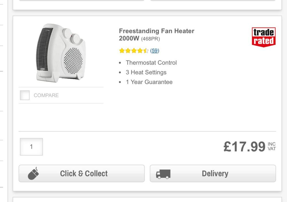

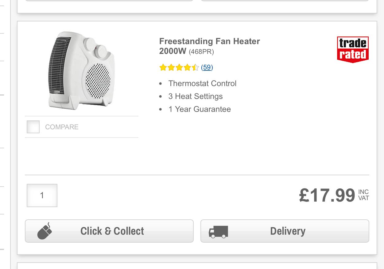

SteamyTea Posted February 20, 2024 Share Posted February 20, 2024 (edited) I am a fan of fan heaters, they can heat a room up very quickly, but I do dislike the noise they make. Any convection heater lets the hot air rise to ceiling level, then as it cools, starts to heat the room. Having a stone place will not help any, the mean air temperature inside the house will be set by the wall temperature to a certain extent. Stone conducts heat quickly. It is why we insulate houses. I am currently sitting in my kitchen (3:30 AM with an OAT of 8°C) which is at 20°C and I turned the storage heater off 2 days ago, my house is lightweight timber construction, but well insulated. If there are any damp problems, or the place has high humidity, it may be worth using a dehumidifier, they dry the air, recovering some of the latent heat and add heat to the tune of their power draw i.e. 1 kW. Storage heaters are a good option if you can get on a time of use tariff, but they are just convection heater. They supply heat exactly the same as any other heater, the term 'background' heat is a bit of a nonsense term for 'too small'. It would be better to say that if they are undersized you will need supplementary heaters, if they are over sized you will need to turn them down. They can often be picked up for nothing though, and with some digital timers that switch them on and off to coincide with the cheap period, no rewiring would be needed (except maybe change an outlet to a double pole switch, you can't run a large one from a 13A plug and socket). If you really are going to put in UFH in the future, remember that you do need a lot of insulation under it, ideally 200mm+. You don't want to he heating the ground up, unless you really want to believe that, like thick stone walls, it stores energy for a later date. Identify and fix any obvious air leaks and put in lots of loft insulation of you can. Running costs are easy to work out. Price of energy [£/kWH] x sum of power [kW] x sum of runtimes [h] My energy prices are currently £0.3672/kWh during the day and £0.1468/kWh during the night. The last two week I have used 21 kWh during the day, 130 kWh during the cheaper night period. So 14% is day rate and 86% is night rate, makes the mean rate £0.24/kWh including VAT and meter rental (£0.6246/day). If you can get a fixed tariff below that, then no need to change supply. That included hot water at night, what is your Mother doing for hot water? Hot water is the greatest part of my annual bill because it is needed every day, and I use way too much. Edited February 20, 2024 by SteamyTea Link to comment Share on other sites More sharing options...
ProDave Posted February 20, 2024 Share Posted February 20, 2024 I dislike fan heaters because of the noise and unreliability and potentially dangerous. I have seen the melted mess of plastic resulting from a fan heater fan failing and then the thermal oveload trip failing to trip. DO NOT EVER leave a fan heater unattended is my advice. That cheap convector heater linked a few posts above is probably best value for money, and similar things are available under loads of different makes. They are essentially free standing but usually come with brackets for wall mounting. The problem with most "wall mounting" panel heaters is LOT20. That's an EU directive to make things more efficient that imposes some electronic controls to control temperature, detect an "open window" etc. The result is a little control panel that almost every customer I have met just cannot understand and they hate the things. Quite why we are seemingly only selling LOT20 panel heaters in the UK after Brexit beats me. The ability to avoid all that nonsense should be a benefit but we are not taking the opportunity. Link to comment Share on other sites More sharing options...
