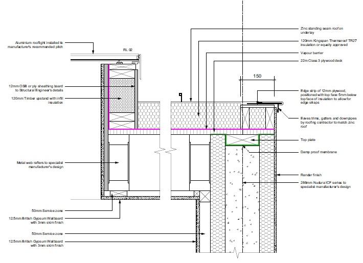

Mulberry View Posted February 20, 2024 Author Share Posted February 20, 2024 2 hours ago, Russell griffiths said: I believe the standard blocks are 0.22. the new blocks are 100mm insulation inside and outside. talking to nudura it seems the new blocks have been made for the European market, they are not sold in Canada where I believe it’s slightly colder than here. IMHO you do not need to do anything with your block walls, that item on your list is done, tick it off and forget it it’s finished. you do however have some details to sort out joining your roof to your walls, this is the area to spend your time. I would build some mock ups of your roof buildup, and see how it all connects. im unsure how your roof sheets fit down if you don’t have a second plywood layer. 120mm of pir is not enough, I would also say I believe your roof will be noisy, we have standing seam with 200mm of rockwool between the joists, then 75mm of pir under the joists, then a batten with 25mm of rock wool sound slab then 15mm blue plasterboard. the rain is definitely noisy, is it unpleasant ? Not really, is it silent ? Definitely not. @Russell griffiths, What is the build-up on top of the joists? Presumably you have a deck under the metal? Although I haven't looked at it in great detail at this stage, I have planned for a 6x2 wall-plate on top of the Nudura core, the concrete is 2" lower than the top of the EPS. The wall-plate will be bolted down and the top will be level with the top of the Posis. From there, the Plywood deck will sit on top of the Posi and extend out and onto the wall-plate. The Architect drew a timber upstand to the edge (4x2 timbers?). Though the mix of materials at the outer face does appear to be an issue (EPS, Plywood and Timber all reaching the outer edge under the render). I think this was not considered by the Architect. I am minded to pull that timber and the Plywood inboard by 50mm and add an EPS infill to the outside edge. Although there will be a join in the EPS, there won't be a mix of materials. The real-world implementation of that detail or a variation of it with the 5° roof angle translated to the timberwork is a little confusing. As is the fixing down of the timbers, these will evidently go through the vapour barrier. Am I overthinking this?! As an aside, I plan to amend the roof service void to 50mm as mentioned earlier and may/may not implement the service zone in the wall. That is to be decided on the basis of whether it adds to the u-value or might be better detailed with an additional internal layer of insulation? Link to comment Share on other sites More sharing options...

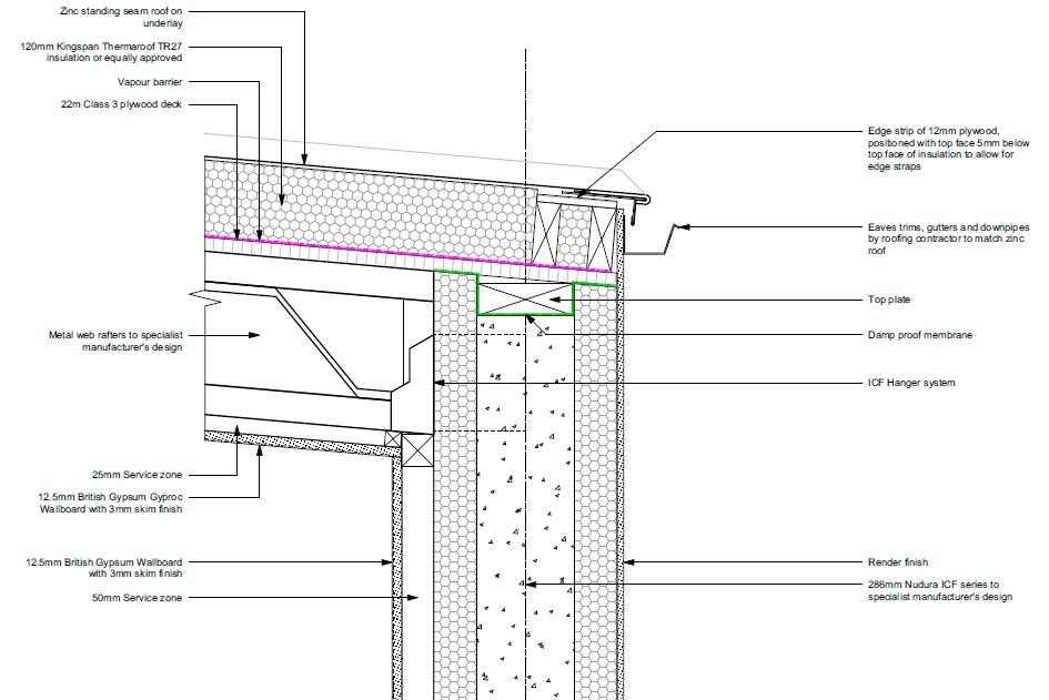

Russell griffiths Posted February 20, 2024 Share Posted February 20, 2024 What I’m not seeing in your drawing @Mulberry View is how the standing seam is fixed down. every time I’ve seen it it’s fitted with a clip or bracket screwed down to the wooden substrate. your drawing to me looks like you have the kingspan insulation and then a separation membrane then the zinc. how’s this zink fixed down. 1 Link to comment Share on other sites More sharing options...
