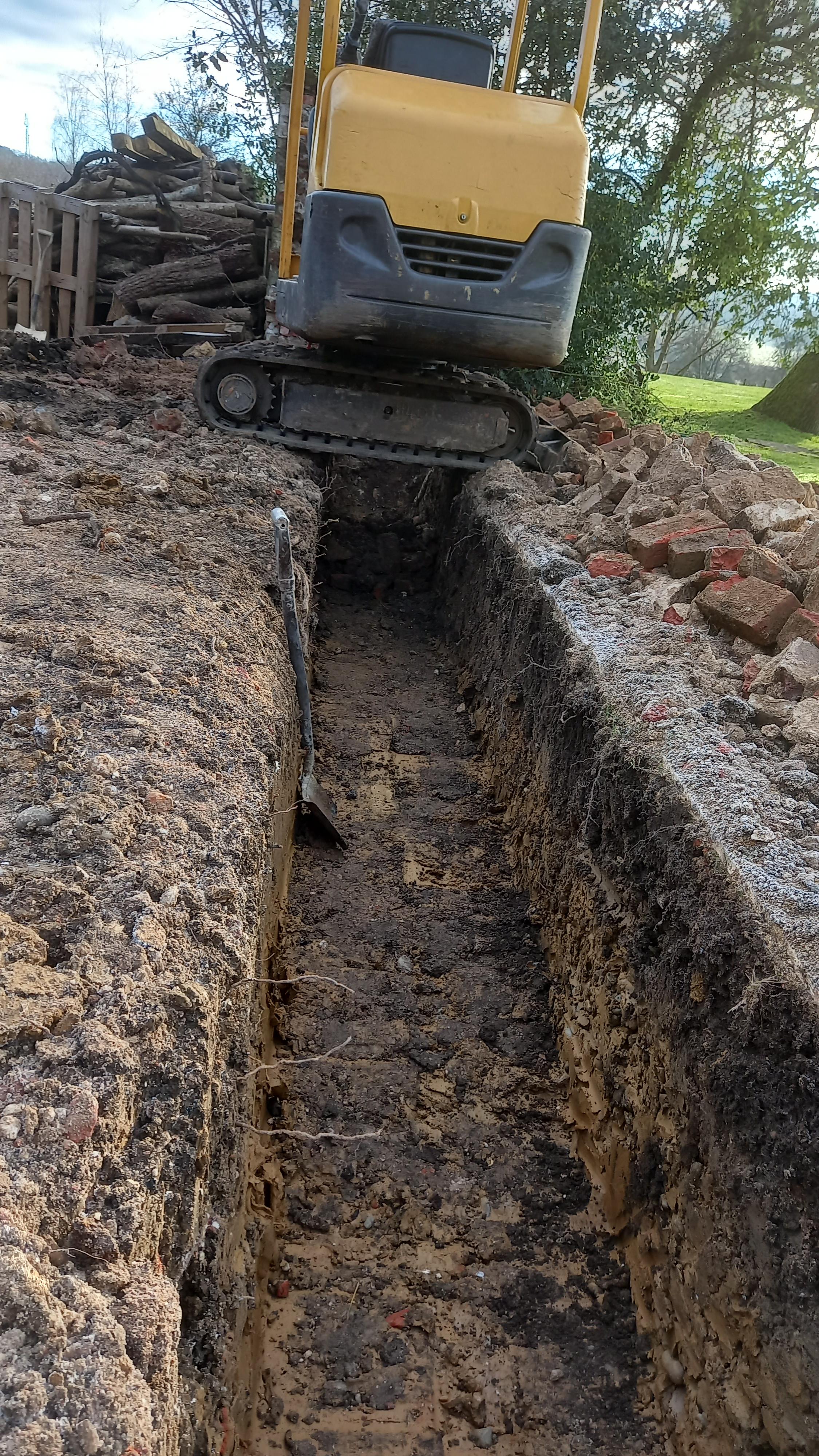

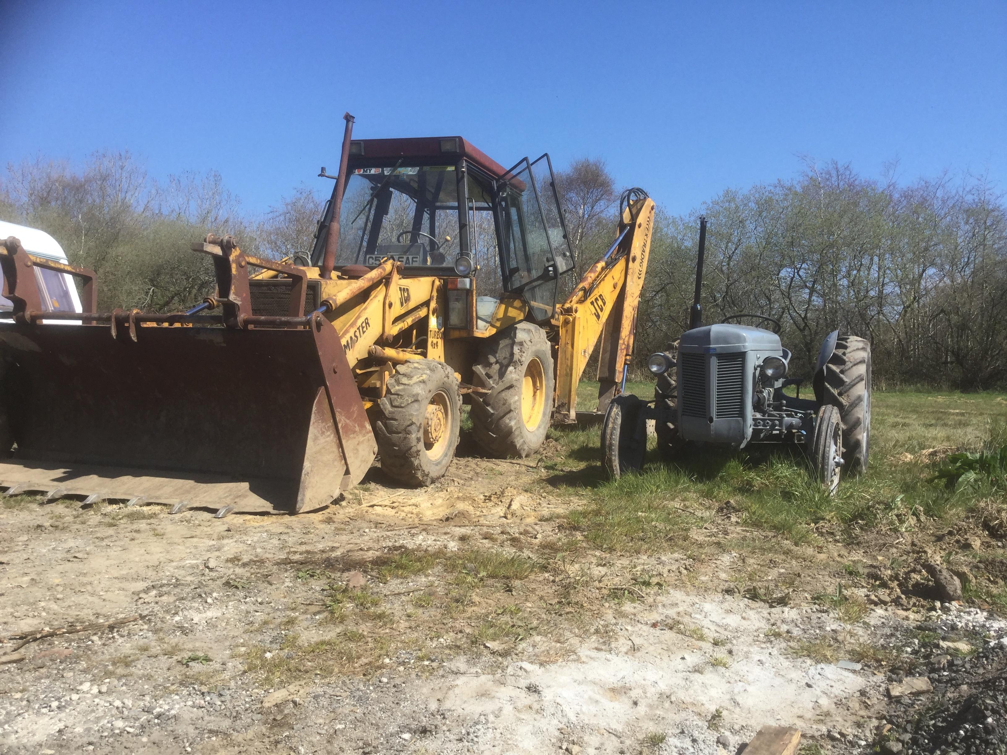

twice round the block Posted February 10, 2024 Posted February 10, 2024 (edited) Any size machine can cope if you know how to use it. This was my 1.5T Volvo 2 weeks ago. The bigger and more powerful the machine the more damage you can do unintentionally. If you have the space a JCB or Massey with a back actor and 4 into 1 front bucket maybe a better choice. Edited February 10, 2024 by twice round the block 2
SimonD Posted February 10, 2024 Posted February 10, 2024 15 minutes ago, twice round the block said: (Expletive deleted) you're brave! 1

Pocster Posted February 10, 2024 Posted February 10, 2024 1 minute ago, SimonD said: (Expletive deleted) you're brave! The man’s a gambler . We await a photo soon of digger in trench 1
SimonD Posted February 10, 2024 Posted February 10, 2024 Just now, Pocster said: The man’s a gambler . We await a photo soon of digger in trench Or maybe it's been lying in the ditch for two weeks since? 1
Pocster Posted February 10, 2024 Posted February 10, 2024 1 minute ago, SimonD said: Or maybe it's been lying in the ditch for two weeks since? Still want a photo
joe90 Posted February 10, 2024 Posted February 10, 2024 (edited) I had a jcb 3cx fir the duration of my build, heavy (can do ground damage if very wet) but very handy for all sorts of jobs with front bucket, forks etc (and great fun to drive) Edited February 10, 2024 by joe90
SimonD Posted February 10, 2024 Posted February 10, 2024 17 minutes ago, Pocster said: Still want a photo Totally!

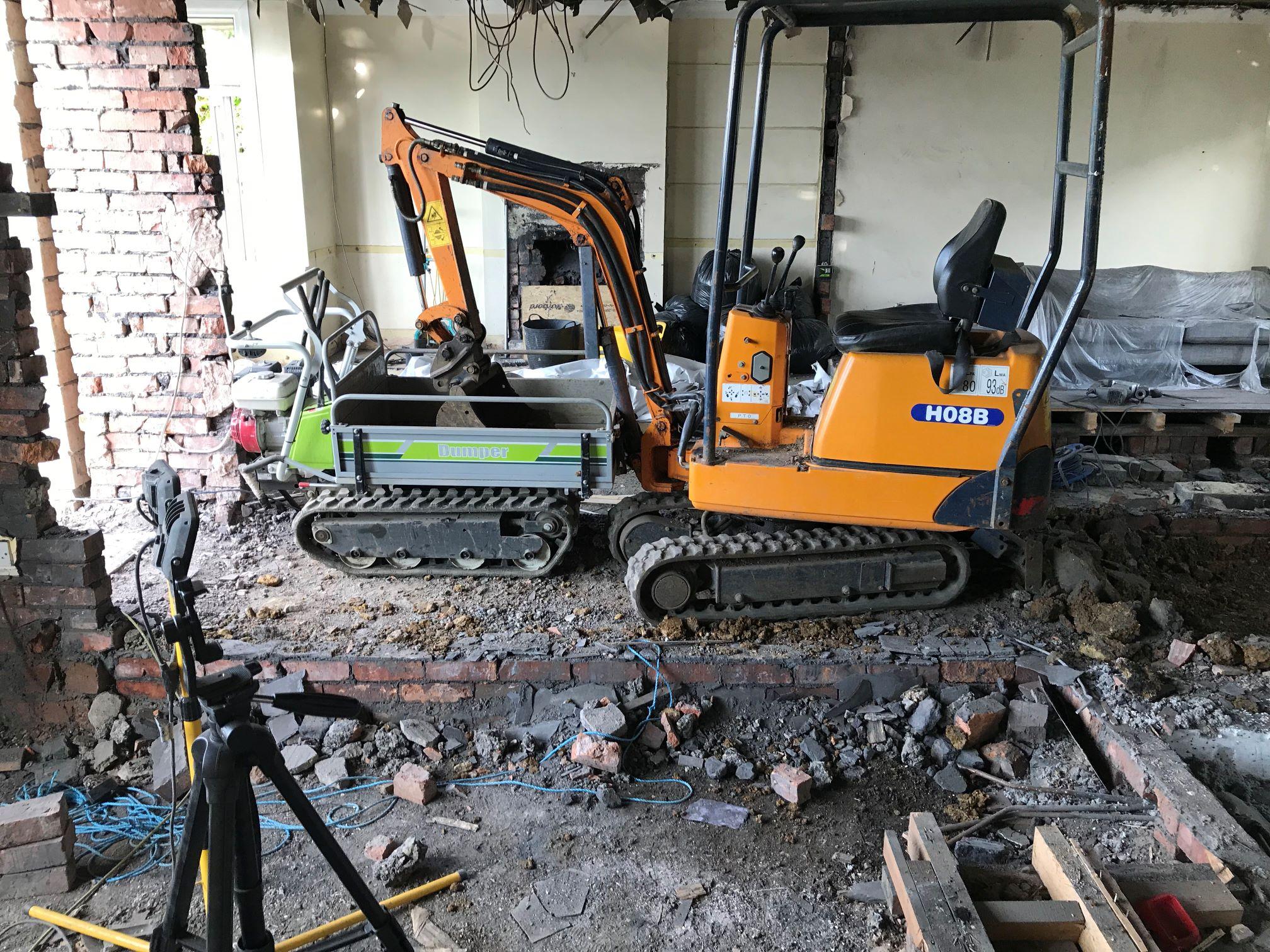

SimonD Posted February 10, 2024 Posted February 10, 2024 Well, I only have a little one 🙄 But of course it's how you use it that counts, isn't it? 2 1

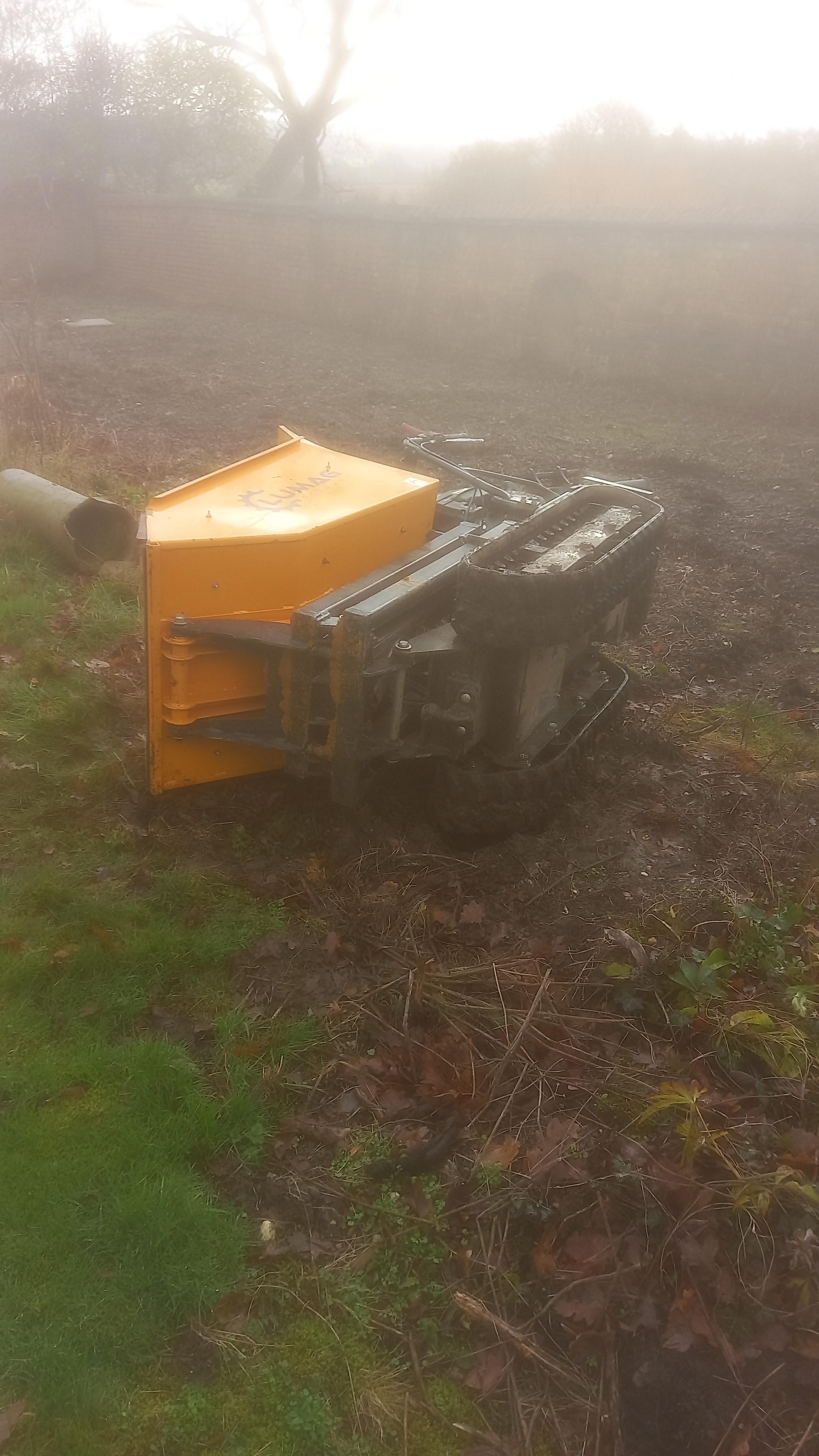

twice round the block Posted February 10, 2024 Posted February 10, 2024 11 minutes ago, SimonD said: Totally! Skip loader taking afternoon nap. Volvo still upright. Haven't got my knee down on a digger for 30 plus year's 2 2
ProDave Posted February 10, 2024 Posted February 10, 2024 45 minutes ago, SimonD said: (Expletive deleted) you're brave! The soil at our site is so soft the trench sides would have caved in with that. To do similar on our site I had to put down some old scaffold boards to spread the load futher.

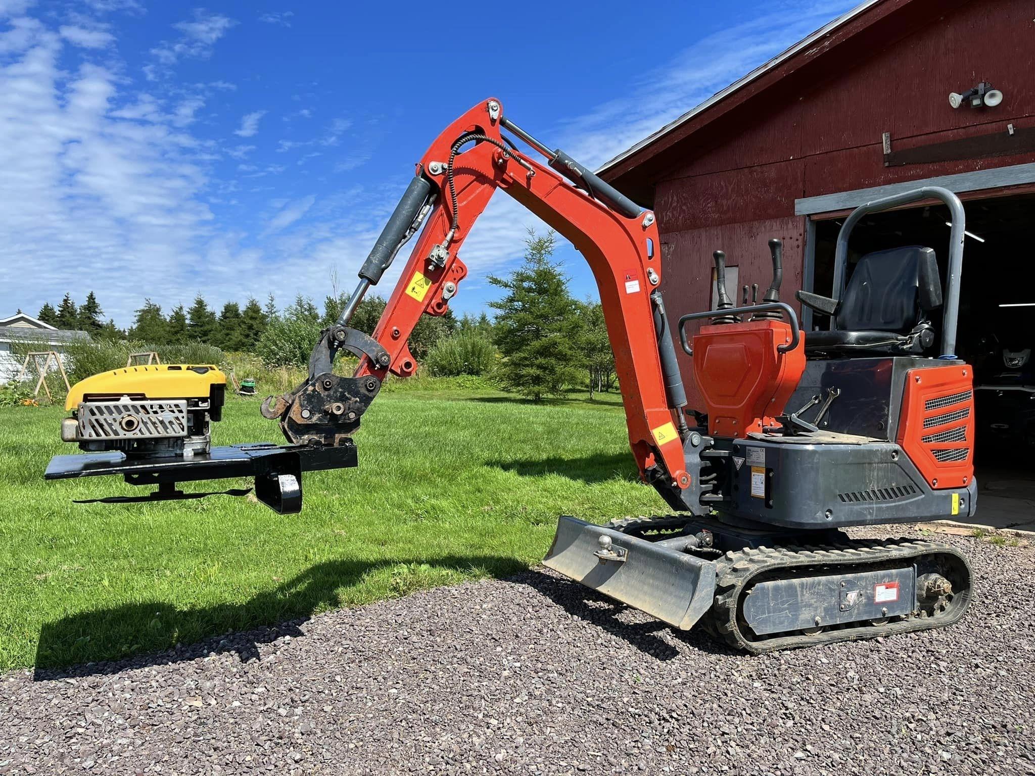

Koko90 Posted July 12, 2024 Posted July 12, 2024 I think a 3 Ton mini excavator might be better. I equipped my own small excavator with a "toy", and I have to say that my work efficiency has improved a lot. 1
