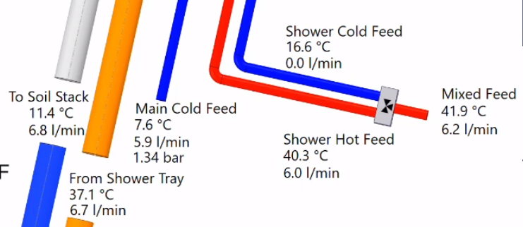

jack benson Posted February 1, 2024 Author Posted February 1, 2024 we recovery up to 10 kW of energy from the waste water so we can heat water from 7 C to 40 C at 6 litres per minute using between 2.5-3.6 kW of heat (variable output electric heating element to maintain the flow at the correct temperature) without the heat recovery you need a 14 kW heating element to provide the same amount of energy to heat water from 7C to 40 C at 6 litres per minute. the waste heat is recovered from the used shower water and used in real time - so the energy loss in minimal (used shower water is never put back into the shower) the system is specifically designed for showers. This video is from Triton. Their 7.5 kW shower will give 3 litres per minute in winter, and their 10.5 kW shower will give 4.5 litres per minute in winter. using no more than 3.6 kW we can give 6 litres a minute year round at 40 C

Mike Posted February 1, 2024 Posted February 1, 2024 Having looked it up, the innovation seems to be that the waste water is pumped from the tray to the shower, passing through a heat exchanger (with the incoming water) before discharging to the SVP. 6l / minute can give a decent enough shower (if not a luxurious one) and, according to that video, it seems that it can maintain that flow rate with a low incoming water temperature, which is a plus. I can see that there is potential for this among the eco-conscious, and also where the electrical supply is limited - as it often is in France, which doesn't normally have the UK's generous 80A/100A supplies. 3 hours ago, jack benson said: I am hoping to get directed to the type of resellers / forums / trade etc events that are interested in new products & ideas. Futurebuild and / or Grand Designs Live?

torre Posted February 1, 2024 Posted February 1, 2024 Congratulations if you're recovering anywhere close to 88%, that sounds above alternatives with much larger heat exchangers (but until your products are listed in the Products database used by SAP it's hard to know if it's a like for like comparison - are you saying you outperform PowerPipe for example). I still think 'easy retrofit' sounds a stretch though, and the pre-heat will be a barrier for some potential customers. Isn't your obvious route to market a licence or tie in with a major shower manufacturer? Have you approached them? 46 minutes ago, jack benson said: The renovation market is many times larger than the new build market I agree renovation is your main market but regardless of energy efficiency in markets like the UK I think you'll struggle to persuade customers to replace their shower with one that has a lower flow rate, and also risk unhappy customers when their new shower is weaker than the old, so I'd focus here on pitching at least the same flow rate, but for much lower cost. Good luck with your product, it would be great to see more energy efficient products reaching the mainstream.
jack benson Posted February 1, 2024 Author Posted February 1, 2024 11 minutes ago, torre said: Congratulations if you're recovering anywhere close to 88%, that sounds above alternatives with much larger heat exchangers (but until your products are listed in the Products database used by SAP it's hard to know if it's a like for like comparison - are you saying you outperform PowerPipe for example). I still think 'easy retrofit' sounds a stretch though, and the pre-heat will be a barrier for some potential customers. Isn't your obvious route to market a licence or tie in with a major shower manufacturer? Have you approached them? I agree renovation is your main market but regardless of energy efficiency in markets like the UK I think you'll struggle to persuade customers to replace their shower with one that has a lower flow rate, and also risk unhappy customers when their new shower is weaker than the old, so I'd focus here on pitching at least the same flow rate, but for much lower cost. Good luck with your product, it would be great to see more energy efficient products reaching the mainstream. the next production batch will have an even more efficient heat exchanger which should beat the 88% we achieved in the previous test Measuring the performance of a water heat recovery system - News - CSTB in terms of the pre-heating time - everything in life has friction. if you are used to it then you live with it, if you are not used to it, then the trade-offs needs to be explained. i think having an endless supply of hot water for a family is better than running out of hot water if there is a hot water tank, or if you are trying to get rid of a combi gas boiler and you need to put a large hot water tank for a heat pump, then our solution for showers might be a good option so you don't have to find space for the large water tank. if you are renovating the bathroom then our product should not be complicated to install. if you are not renovating the bathroom then you cannot install it. We are speaking to lots of people. Kohler / Mira recently bought Recoup for example. At the moment our focus is to bring some international sales. if for the UK, faster flow is more important, we can look at a roadmap with a 8 or 10 litre a minute model. and thank-you for your best wishes

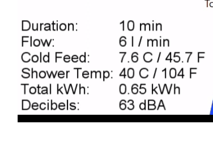

SteamyTea Posted February 1, 2024 Posted February 1, 2024 Take this at face value. The energy required to heat that much water is: 4.18 [kJ.kg-1.K-1] x 60 [litres or kg] x (40 - 7.6) [∆T] = 8125.92 kJ, or 2.26 kWh. Your claim is that it uses 0.65 kWh, 2.26 times less, a 71.2% reduction. Now this is where I am getting a bit confused. Taking just the water going down the soil stack, 6.8 lt/min and comparing that to the water in from the main cold feed, 5.9 lt/min plus shower cold feed 0 lt/min and the shower hot feed 6 lt/min. 6.8 [soil stack lt/min] = 5.9 [main cold feed lt/min] + 6 [shower hot feed lt/min] + 0 [shower cold feed lt/min] 6.8 = 11.9 What am I missing?
