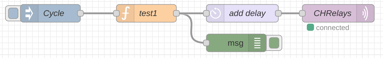

TerryE Posted February 10 Author Share Posted February 10 Better and better. What does Elon Musk say? "The best part is no part". I don't need to use Berry at all for what I want to do. Here is a Node-RED snippet that cycles around the relays turning each on for a defined duration with a 2 second gap between The test1 function posts a set of messages to my cmnd/CHrelays/BACKLOG0 topic. Backlog0 is just a way to do multiple Tasmota commands atomically; PulseTime1 and Power1 set the on-time and power state for relay 1 etc. const DUR=12, N=4; return [[...Array(N).keys()].map(i=>({ delay: i*(DUR+2)*1000, payload: `PulseTime${i+1} ${100+DUR}; Power${i+1} 1` }))]; Link to comment Share on other sites More sharing options...

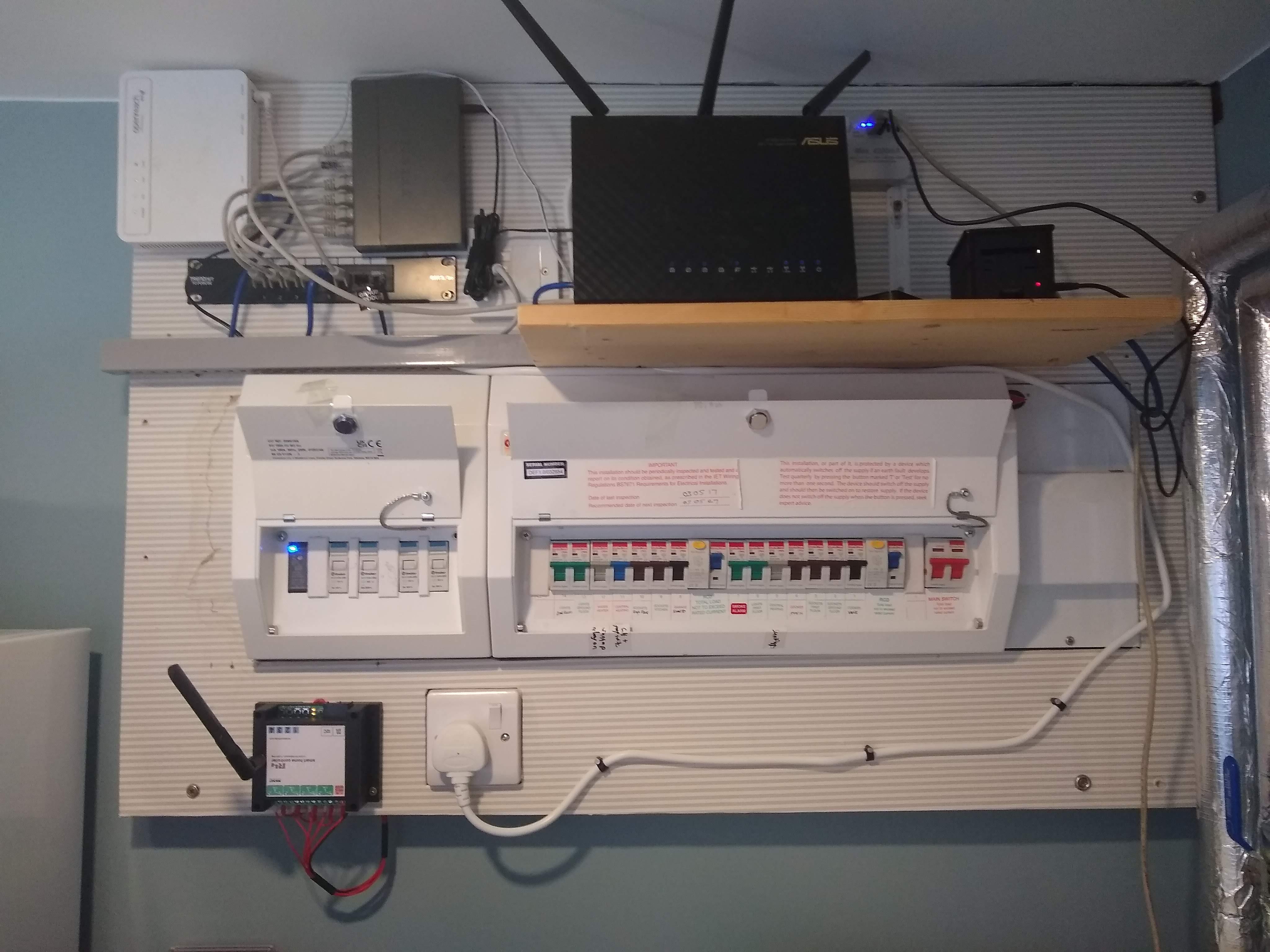

TerryE Posted April 2 Author Share Posted April 2 (edited) So here is what my CH / UVC Immersion control setup looks like finished: The RH Consumer Unit is as-installed by my electrician. I've repurposed some of the circuits: CH, SunAmp 1, SunAmp 2 → Immersion 1, CH, Immersion 2 (I swapped the CH to the 20A circuit, though this could be downrated to 16A.) These radials are routed through to the adjacent small CH on the left. This contains AC→24VDC and 4 Finder 240V / 20A relays(UFH Pump, Willis, Imm1, Imm2). These 4 run radials to fused DP wall plates, and on to the pump / heaters. The small box underneath the relays is a commercial off-the shelf unit discussed in a previous post the runs on 24 VDC and switches the 24VDC input used to control the power relays. This runs standard Tasmota Software (albeit configured with a local autoexec to add a local rule that forces the Willis to turn off (if on) whenever the pump is turned off). The Tasmota firmware is controllable via MQTT. Incidentally above the CU are my BT Infiniband modem, 100Mb Enet patch panel and Wifi hub (this meshes with 3 other Wifi APs to give strong 54Mb Wifi on the 1st and 2nd floors and garden. The CH+DHW upper control used to be hosted in the RPi3 to the right of my Wifi hub, but it is now run on a virtual container on my home Proxmox server (a repurposed Lenovo Laptop which sits on a shelf in the service cupboard that contain my DHW+CH manifolds and used to contain my SunAmps). A bit like a NUC, but with built-in battery backup. It just sits there always closed, as I manage everything over my LAN using SSH and the Proxmox Portal. This hosts a VM running Home Assistant, and currently 8 other containers (LXCs) including Pihole, VPN Portal, IoT stack (MySQL, NodeRED, Mosquitto MQTT server, Zigbee2MQTT), an FTP service for my external cameras, a couple of web-servers and 2 test containers. Above it, the small box is one of my DS18B20 IoT devices, but more of that on a separate post. Edited April 3 by TerryE Link to comment Share on other sites More sharing options...
