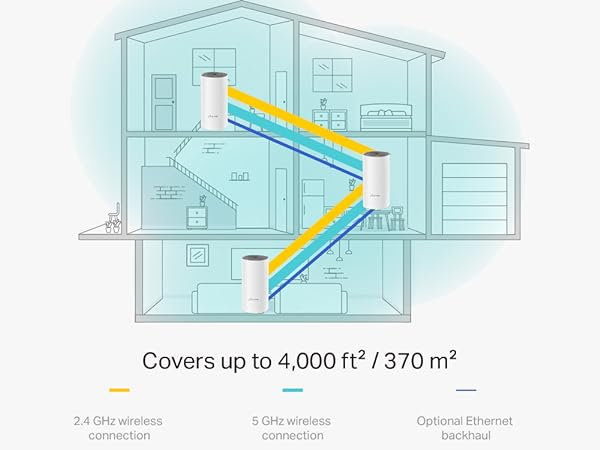

joth Posted January 11, 2024 Posted January 11, 2024 On 11/01/2024 at 13:31, Moonshine said: The what now? Please explain like I am a confused labrador Expand This diagram shows "Optional ethernet backhaul" Consider it mandatory, not optional 🙂 I.e. each Deco E4R is plugged into a cat6 ethernet socket back via the switch (you just ordered) and to the M9. 1

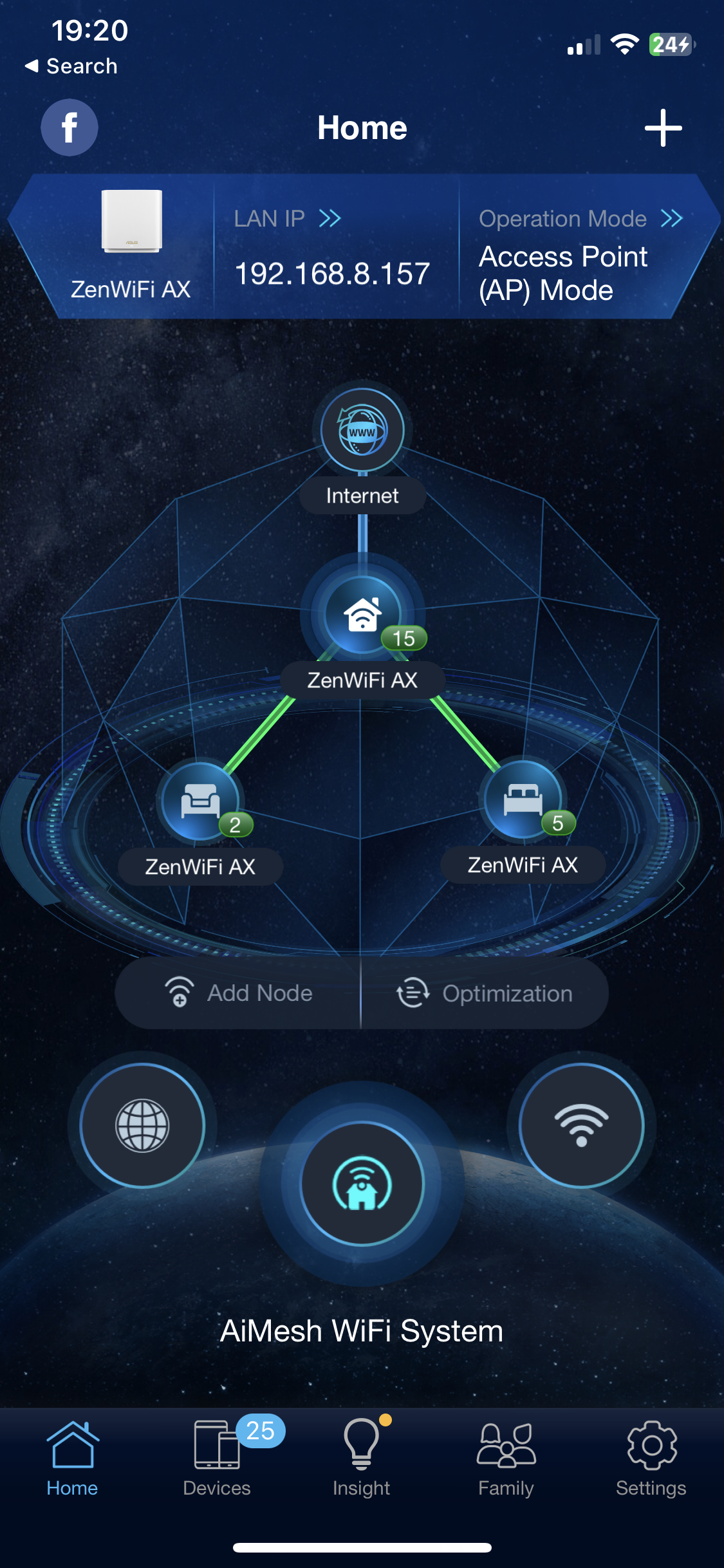

Pocster Posted January 11, 2024 Posted January 11, 2024 On 11/01/2024 at 14:14, joth said: This diagram shows "Optional ethernet backhaul" Consider it mandatory, not optional 🙂 I.e. each Deco E4R is plugged into a cat6 ethernet socket back via the switch (you just ordered) and to the M9. Expand My ASUs worked fine with no Ethernet backhaul . But ! - as you paid the money ; a few cat cables is going to drastically improve speed as you roam between nodes . So yeah ; do it !
