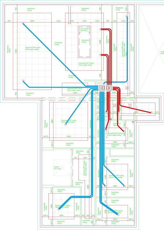

le-cerveau Posted September 18, 2017 Share Posted September 18, 2017 I am planning 2 extract points in my kitchen with 4 ducts (2 to each), but I have a 34m2 open plan kitchen in a 108m2 open plan area and a planned extract of 22l/s (80m3/h) due to house size. I will be having re-circulators over my hob also. I start the first stage install next month. Ground floor plan (showing ceiling plan suspended ceiling). Link to comment Share on other sites More sharing options...
