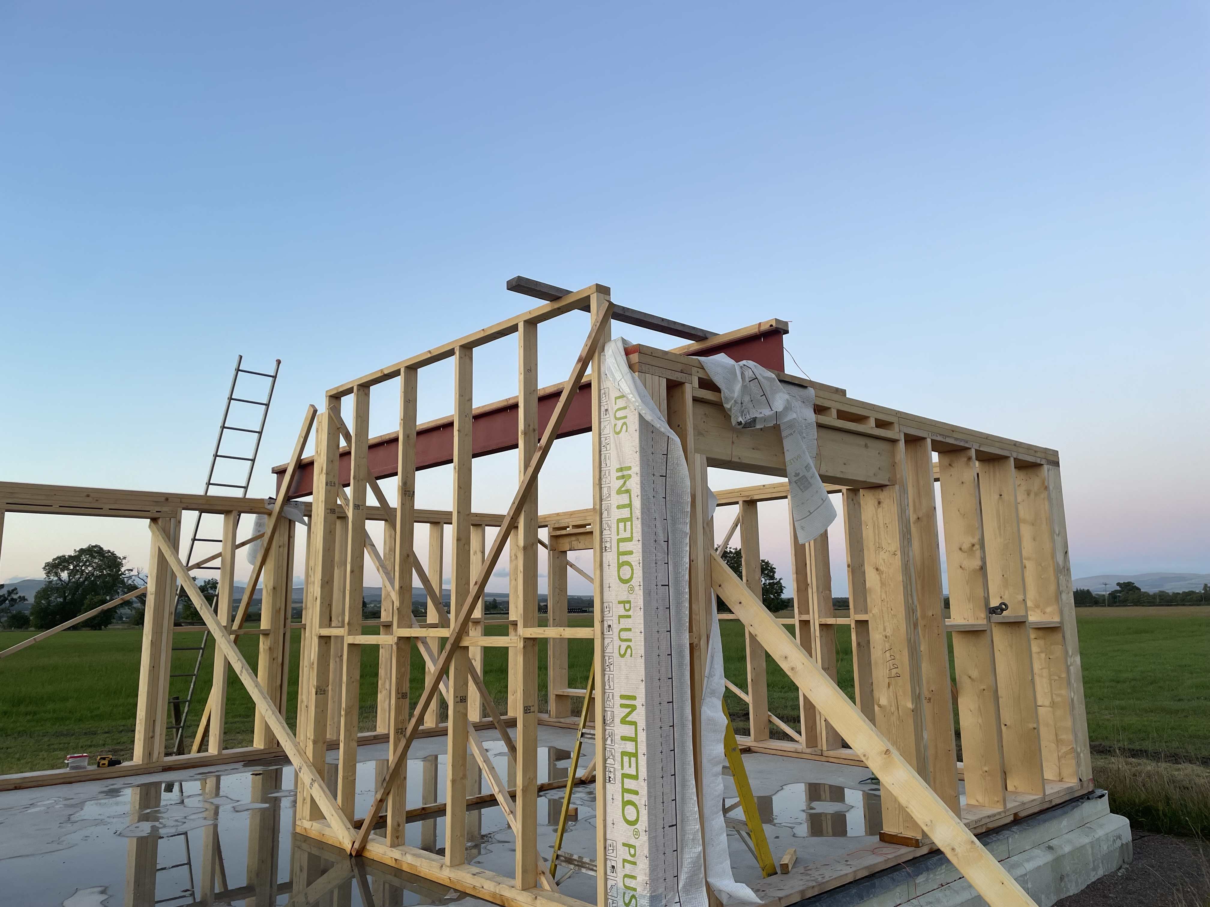

gavztheouch Posted August 26, 2024 Author Share Posted August 26, 2024 We decided to go ahead and fix the bolt issue later if needed. The contractor also removed and reinserted some concrete screws to place shims under the sole plate. Concrete screws don't work as well after remover and reinsertion. The latest frame saga is the window lintels not fitting under the head binder. This means the walls are not properly tied together. I haven't ordered the lintels yet as they have a long lead-time but until we redesign the walls and floor I don't know what to order. This is really frustrating as I brought this issue up when I made my model. Link to comment Share on other sites More sharing options...

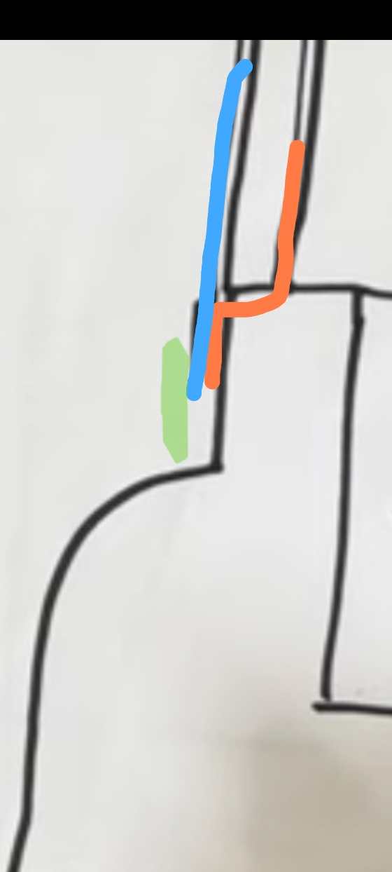

gavztheouch Posted September 1, 2024 Author Share Posted September 1, 2024 Im trying to think of ways to improve the wall to isoquick junction at the bottom of the wall. The wood fibre adds protection from water entering higher up the wall but when it reaches the Isoquick, if trapped behind the membrane there is a direct path into the sole plate. Thinking about adding a chamfer to the Isoquick to drop the external wood fibre down 10mm or so to create a ledge making it harder for the water to get in. Link to comment Share on other sites More sharing options...

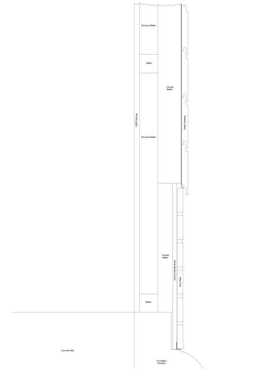

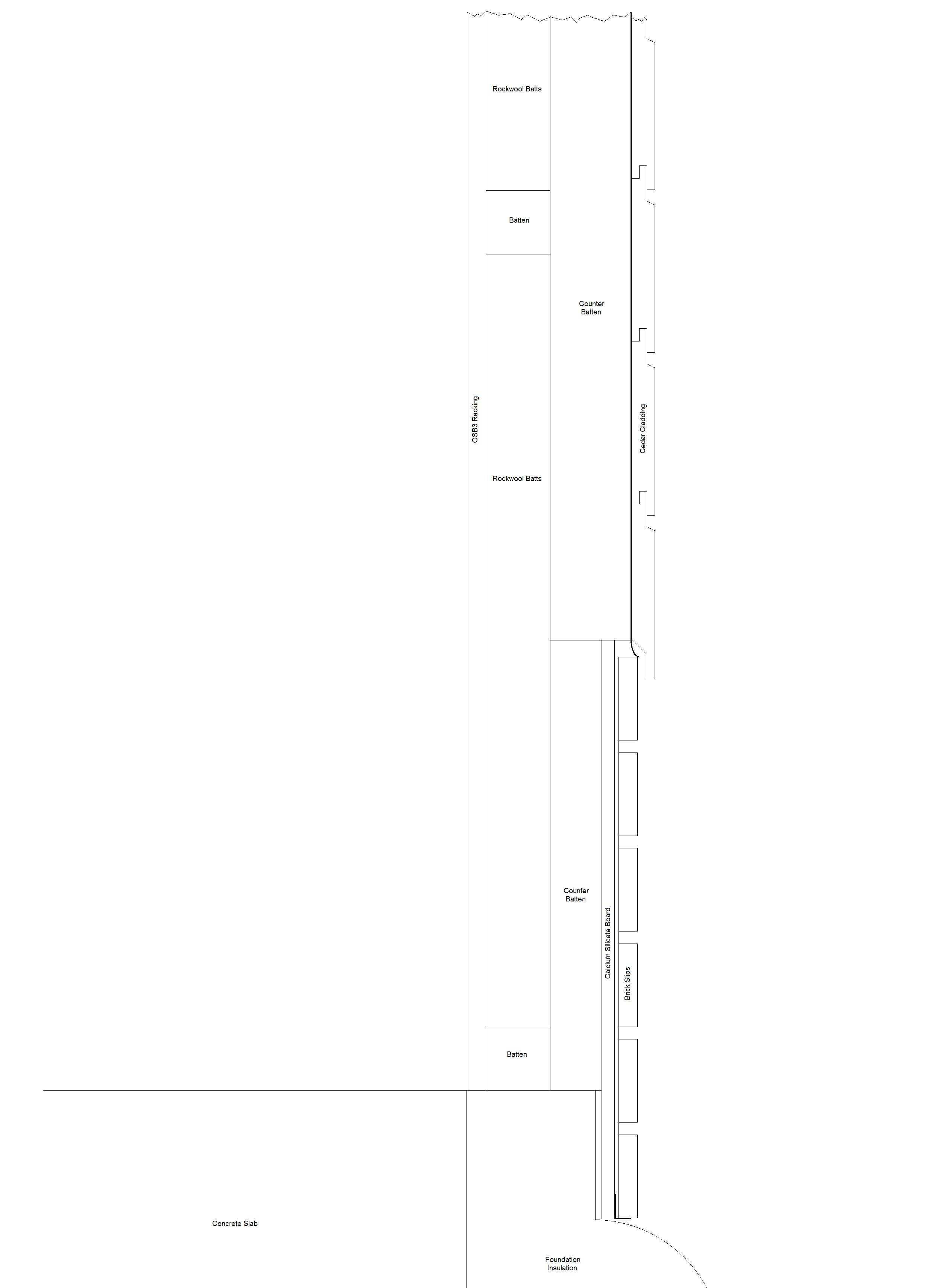

Gone West Posted September 1, 2024 Share Posted September 1, 2024 3 hours ago, gavztheouch said: Im trying to think of ways to improve the wall to isoquick junction at the bottom of the wall. We used a completely different way of cladding our timber frame on the Isoquick. We had to have a 50mm cavity between the rainscreen and external insulation. I think this drawing had a few minor tweaks before the work was done. The DPC was folded up and stapled to the 15mm OSB racking before the external insulation was fitted to ensure water couldn't reach the sole plate. Don't know if that's of any help. 1 Link to comment Share on other sites More sharing options...

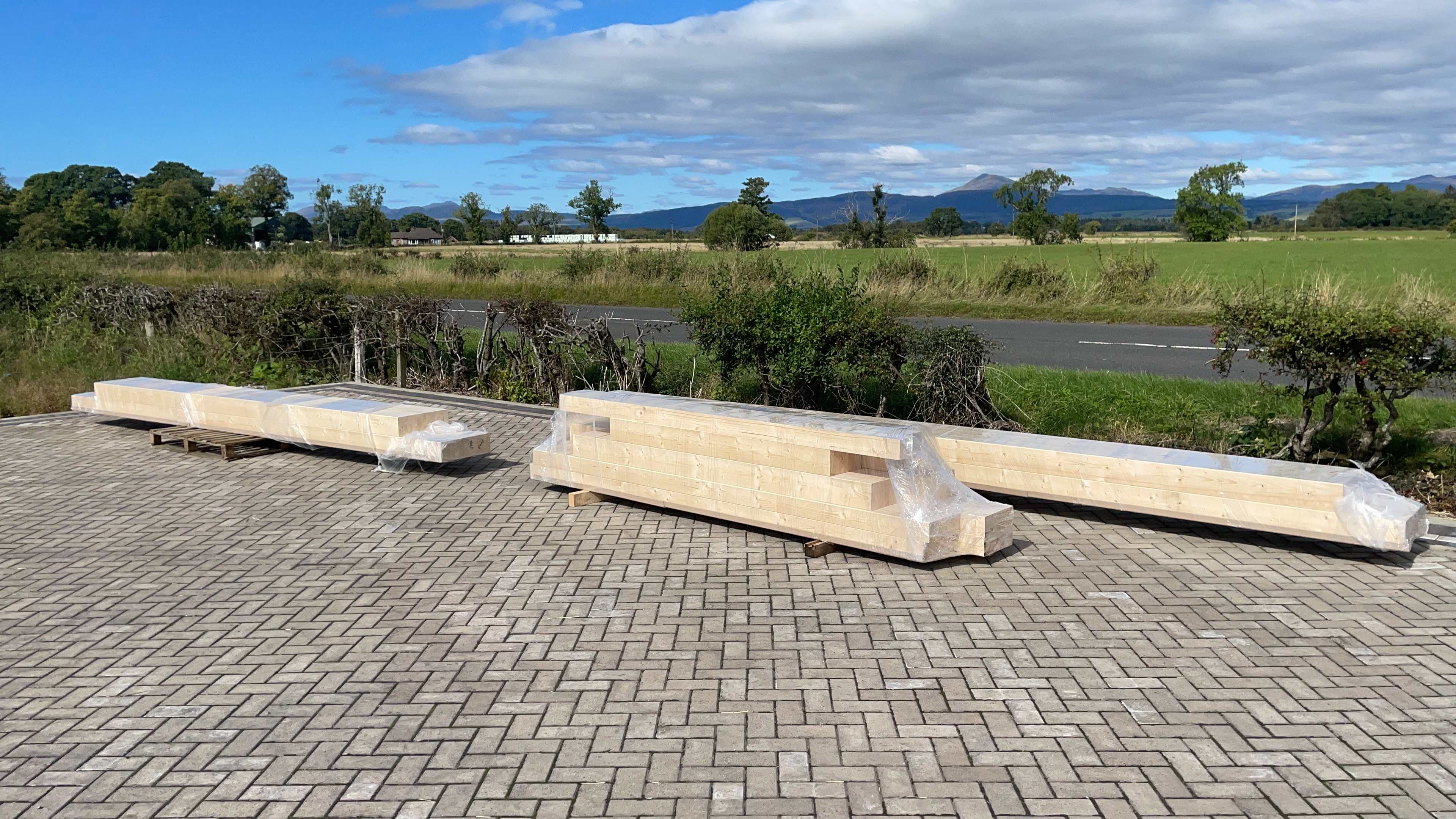

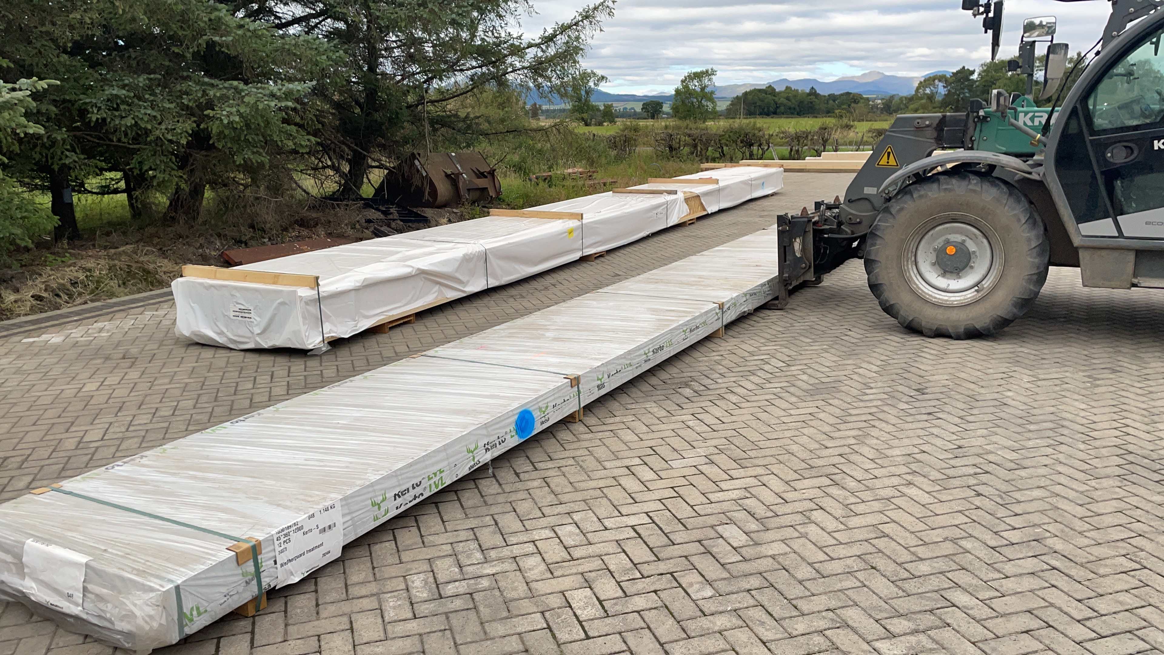

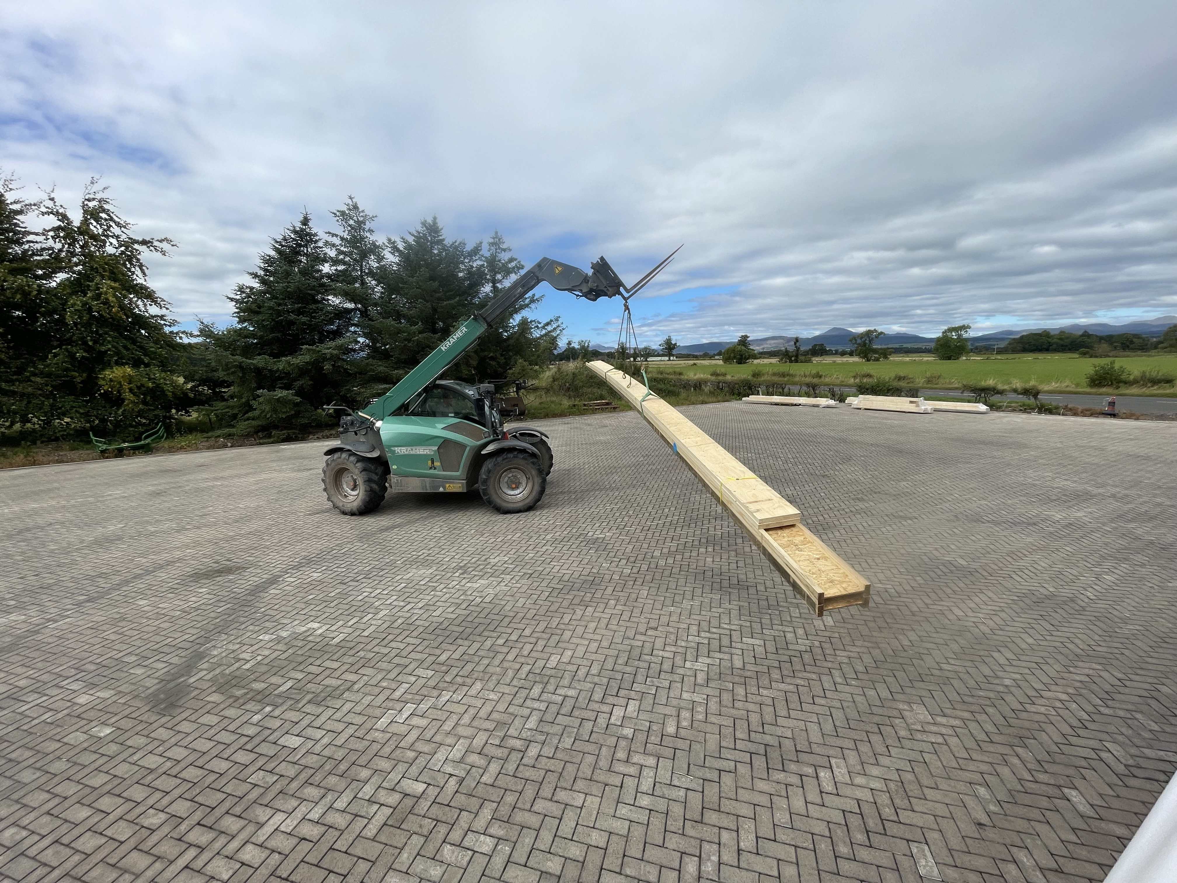

gavztheouch Posted September 5, 2024 Author Share Posted September 5, 2024 Rim beam, Joists and Glulam arrived today. Can't wait to start building the floor. Link to comment Share on other sites More sharing options...
gavztheouch Posted September 5, 2024 Author Share Posted September 5, 2024 1 Link to comment Share on other sites More sharing options...

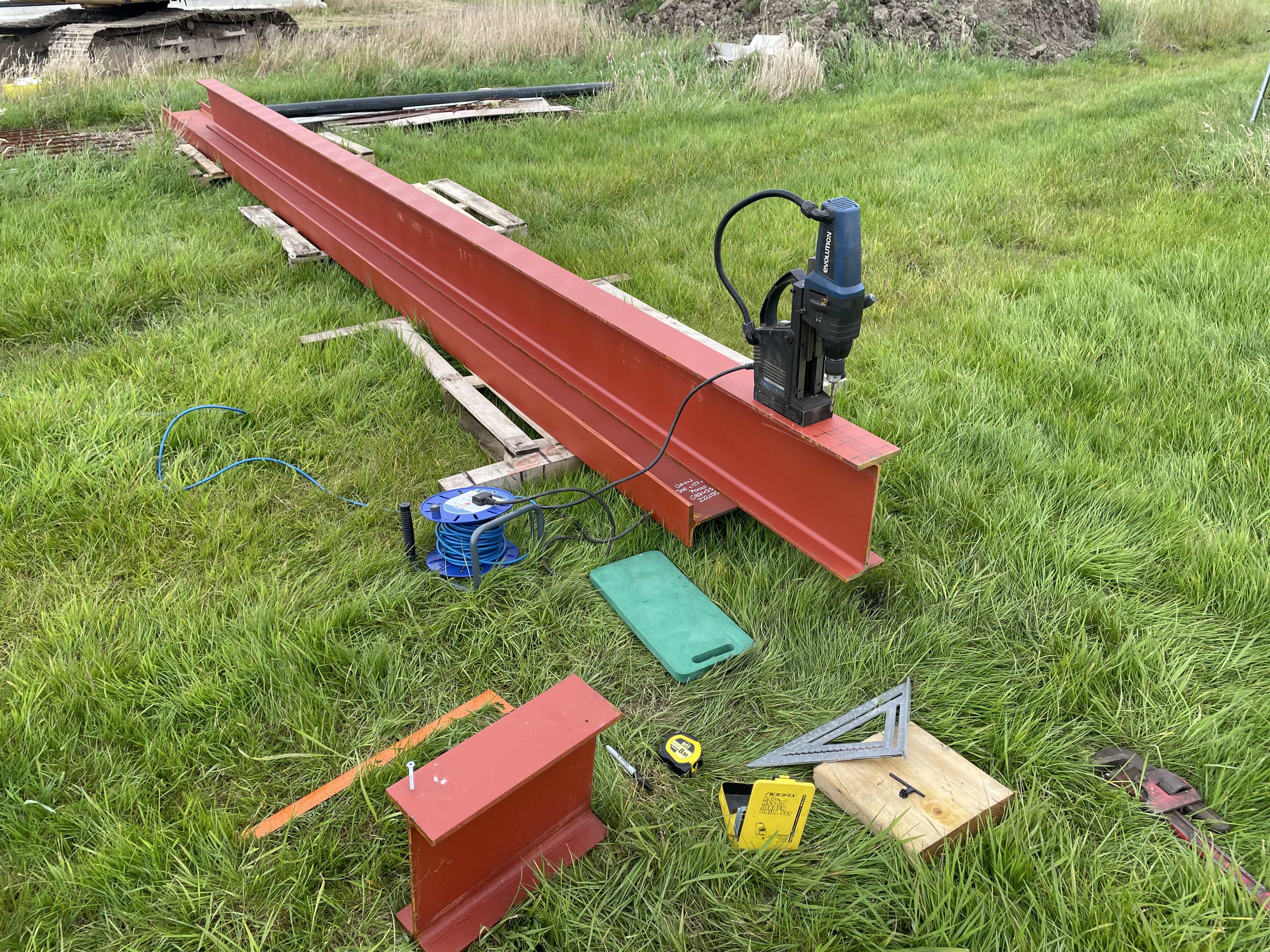

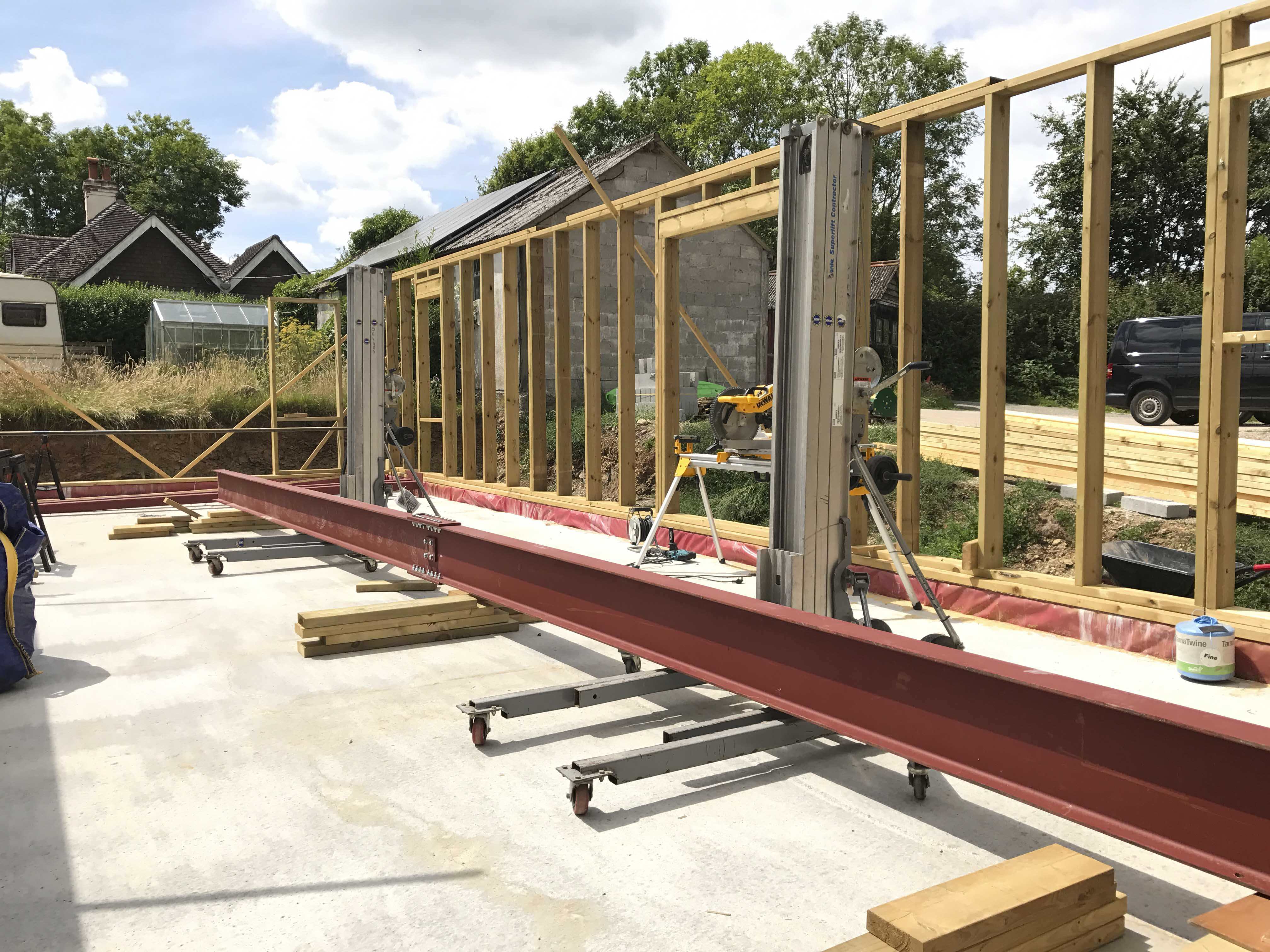

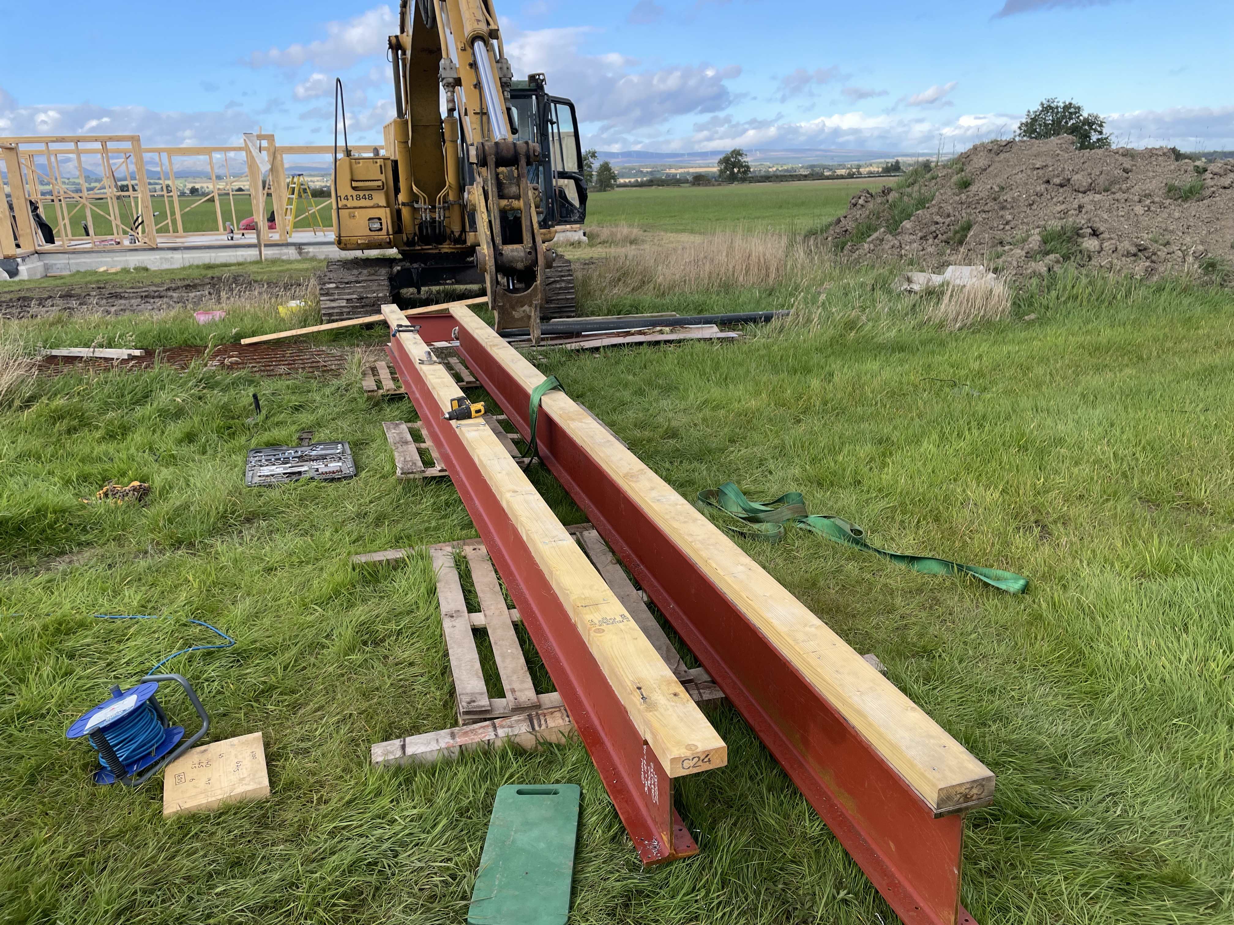

gavztheouch Posted September 21, 2024 Author Share Posted September 21, 2024 Preparing the steel that will sit inside the floor assembly. Needed to metal screw a 5x2 piece of wood with a plywood packer to the top, drill some mounting holes and also cut to length. Link to comment Share on other sites More sharing options...
gavztheouch Posted September 21, 2024 Author Share Posted September 21, 2024 1 Link to comment Share on other sites More sharing options...

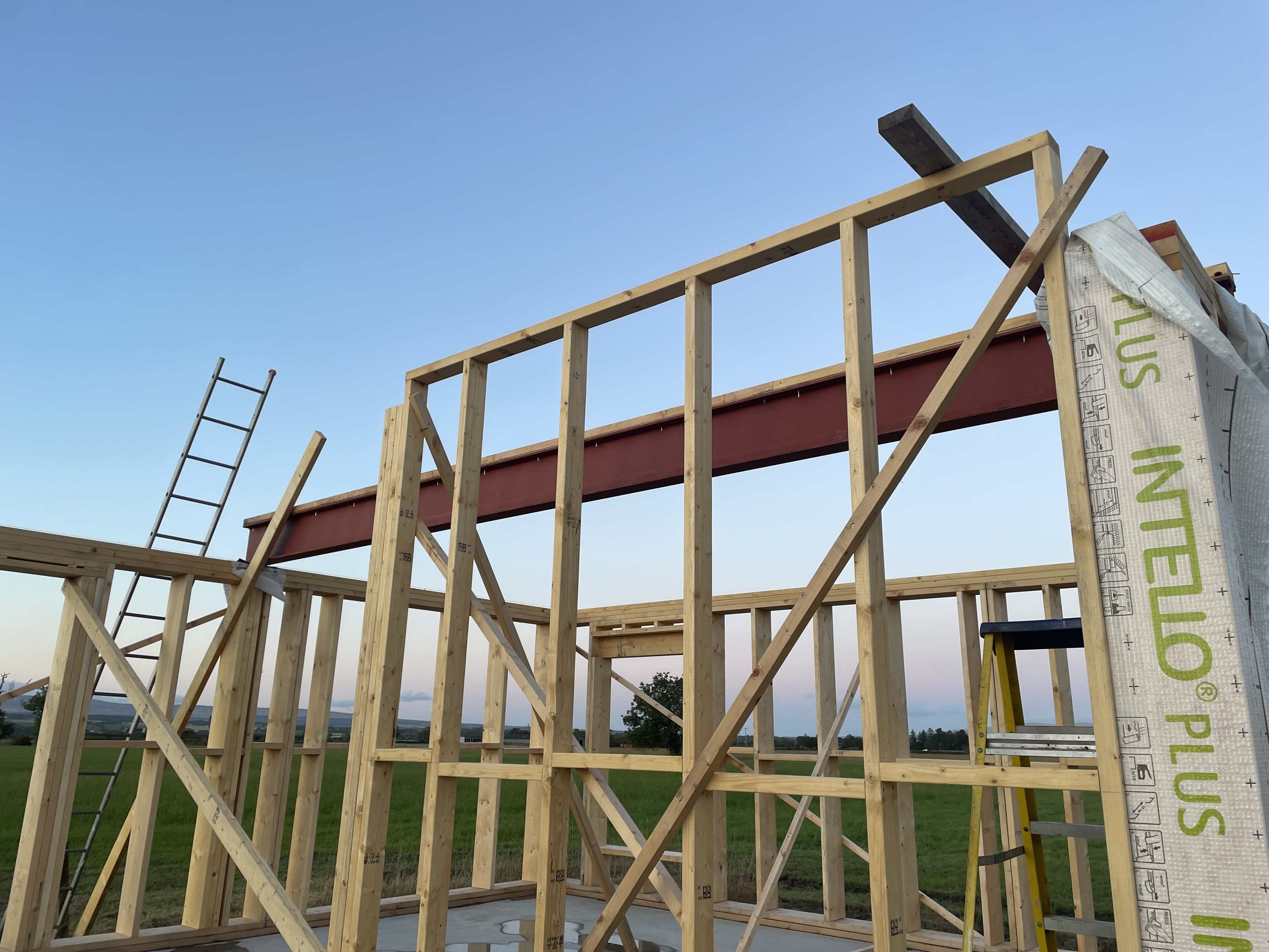

gavztheouch Posted September 21, 2024 Author Share Posted September 21, 2024 One of the steels in position. We used my dad’s digger to lift the beam in position. Reckon it weights around 300kg Link to comment Share on other sites More sharing options...

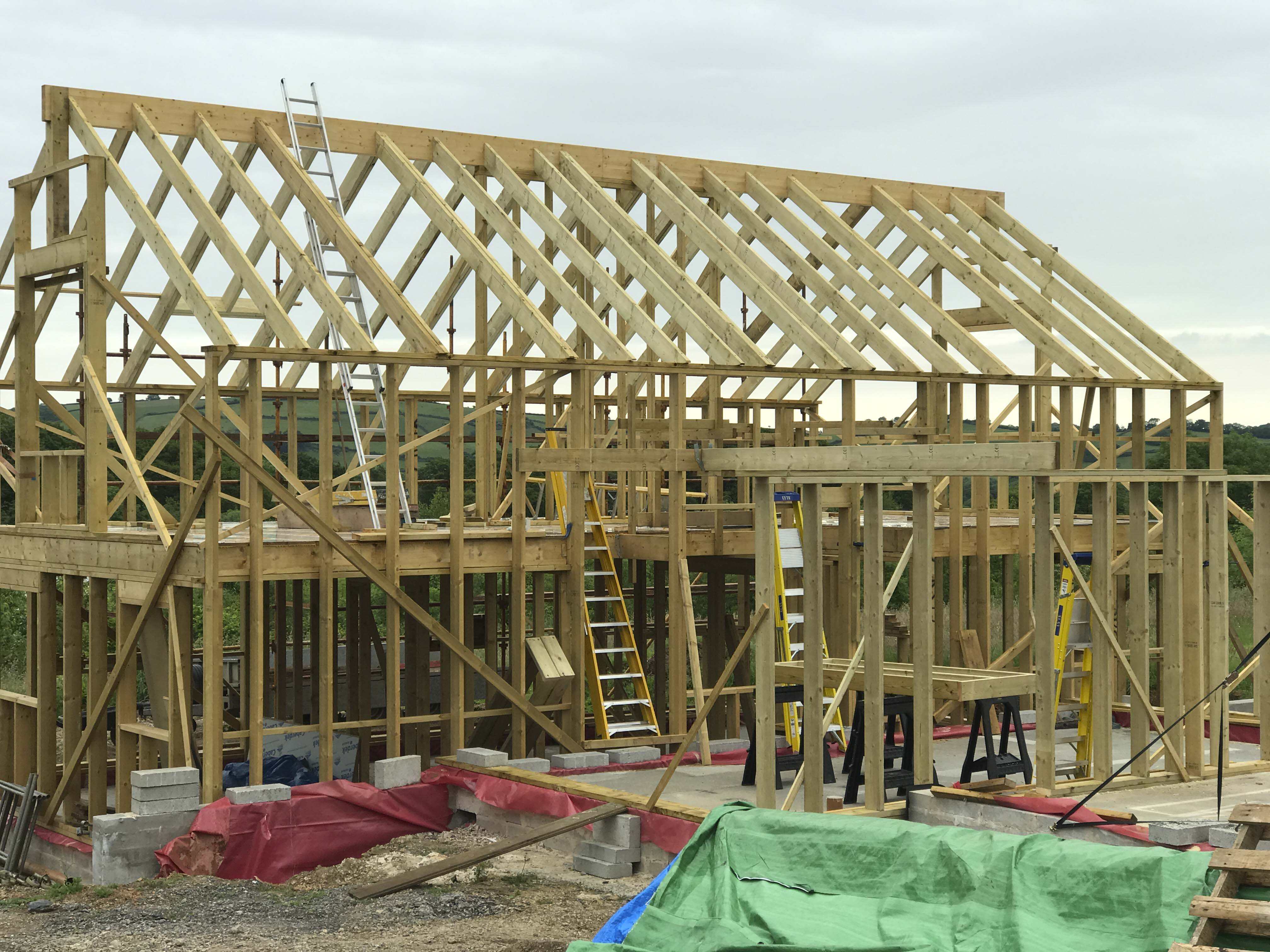

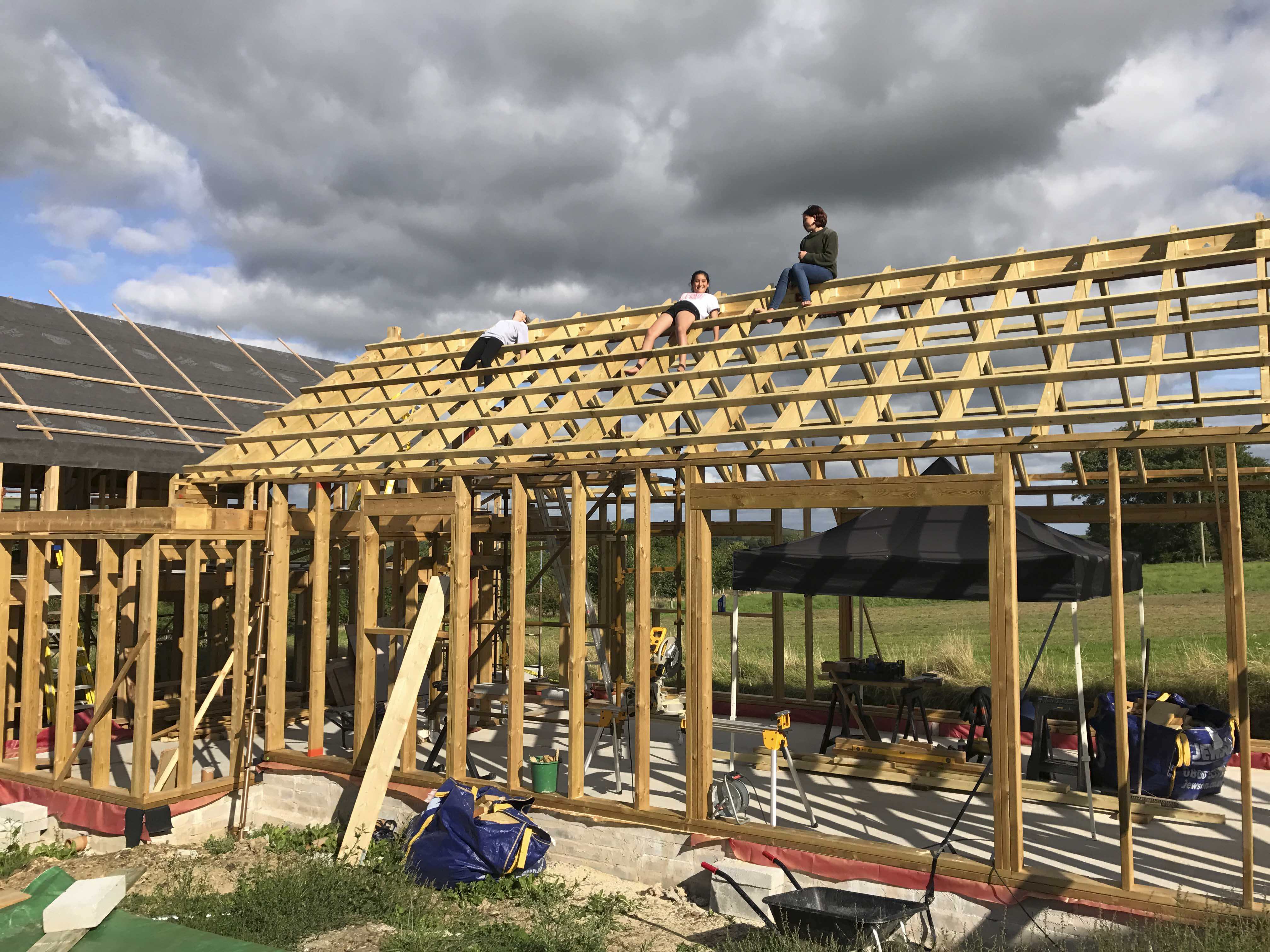

JamesP Posted September 21, 2024 Share Posted September 21, 2024 I like this approach, was a very enjoyable (long) part of my build. Last shot before Cedar cladding fixed. 5 Link to comment Share on other sites More sharing options...
Iceverge Posted September 24, 2024 Share Posted September 24, 2024 On 01/09/2024 at 13:38, gavztheouch said: Im trying to think of ways to improve the wall to isoquick junction at the bottom of the wall. The wood fibre adds protection from water entering higher up the wall but when it reaches the Isoquick, if trapped behind the membrane there is a direct path into the sole plate. Thinking about adding a chamfer to the Isoquick to drop the external wood fibre down 10mm or so to create a ledge making it harder for the water to get in. Very Interesting build. I would avoid multi tooling anything. It's too slow and getting a very consistent cut would require too much attention. This would be my solution. Cut say a 300 mm strip of proclima and staple it to the racking board as shown in orange. Then run the breather membrane over the top as shown in blue to below the level of the orange. Tape the blue to the isoquick with an appropriate tape and primer. This will be a safe design if the tape fails, or the external membrane. However getting the external membrane and tape right is your primary objective.. 1 Link to comment Share on other sites More sharing options...
gavztheouch Posted September 24, 2024 Author Share Posted September 24, 2024 6 hours ago, Iceverge said: Very Interesting build. I would avoid multi tooling anything. It's too slow and getting a very consistent cut would require too much attention. This would be my solution. Cut say a 300 mm strip of proclima and staple it to the racking board as shown in orange. Then run the breather membrane over the top as shown in blue to below the level of the orange. Tape the blue to the isoquick with an appropriate tape and primer. This will be a safe design if the tape fails, or the external membrane. However getting the external membrane and tape right is your primary objective.. This is why I love forums. This seems like a great idea to give extra protection incase of failure, I don't think I would have though about doing this. Some other ideas I might incorporate would be to 1. staple the concrete DPM to the racking board to give an extra back dam. 2. On the lowest/bottom wood fibre board tuck external membrane inside the tongue and groove of the board. This means if any water makes its way under the membrane at the top it will never get past the last 600mm of membrane and boards. It means wasting a some membrane to achieve this (cutting standard width down to 800mm or soo. The alternative is to lap the membranes in the usual way by this would rely on the membrane being taped to the wood fibre for 50 years or so without failing. Since in Scotland we normally have a brick cavity in front of our timber frames I think it worth thinking about ways we can engineer our walls to be more robust. Link to comment Share on other sites More sharing options...
Iceverge Posted September 24, 2024 Share Posted September 24, 2024 2 hours ago, gavztheouch said: staple the concrete DPM to the racking board to give an extra back dam I'd be cautious about this. If any moisture was to run down between the woodfiber and membrane it would be directed into the house. I'd cut the DPM back flush with the outsider of the sole plate. 2 hours ago, gavztheouch said: On the lowest/bottom wood fibre board tuck external membrane inside the tongue and groove of the board. This means if any water makes its way under the membrane at the top it will never get past the last 600mm of membrane and boards. It means wasting a some membrane to achieve this (cutting standard width down to 800mm or soo. The alternative is to lap the membranes in the usual way by this would rely on the membrane being taped to the wood fibre for 50 years or so without failing. Since in Scotland we normally have a brick cavity in front of our timber frames I think it worth thinking about ways we can engineer our walls to be more robust. It would be difficult to build if you did this. You'd need to be putting the membrane up as you did the woodfiber. In general think always about allowing water to down and out. This might potentially create a pocket that would trap water against the membrane. Something else to consider is that the membrane and cladding may need to be replaced, it might be 100 years but it may need to happen. Ideally for the sake of whoever has to do this it should be removable without damaging the woodfiber. Link to comment Share on other sites More sharing options...

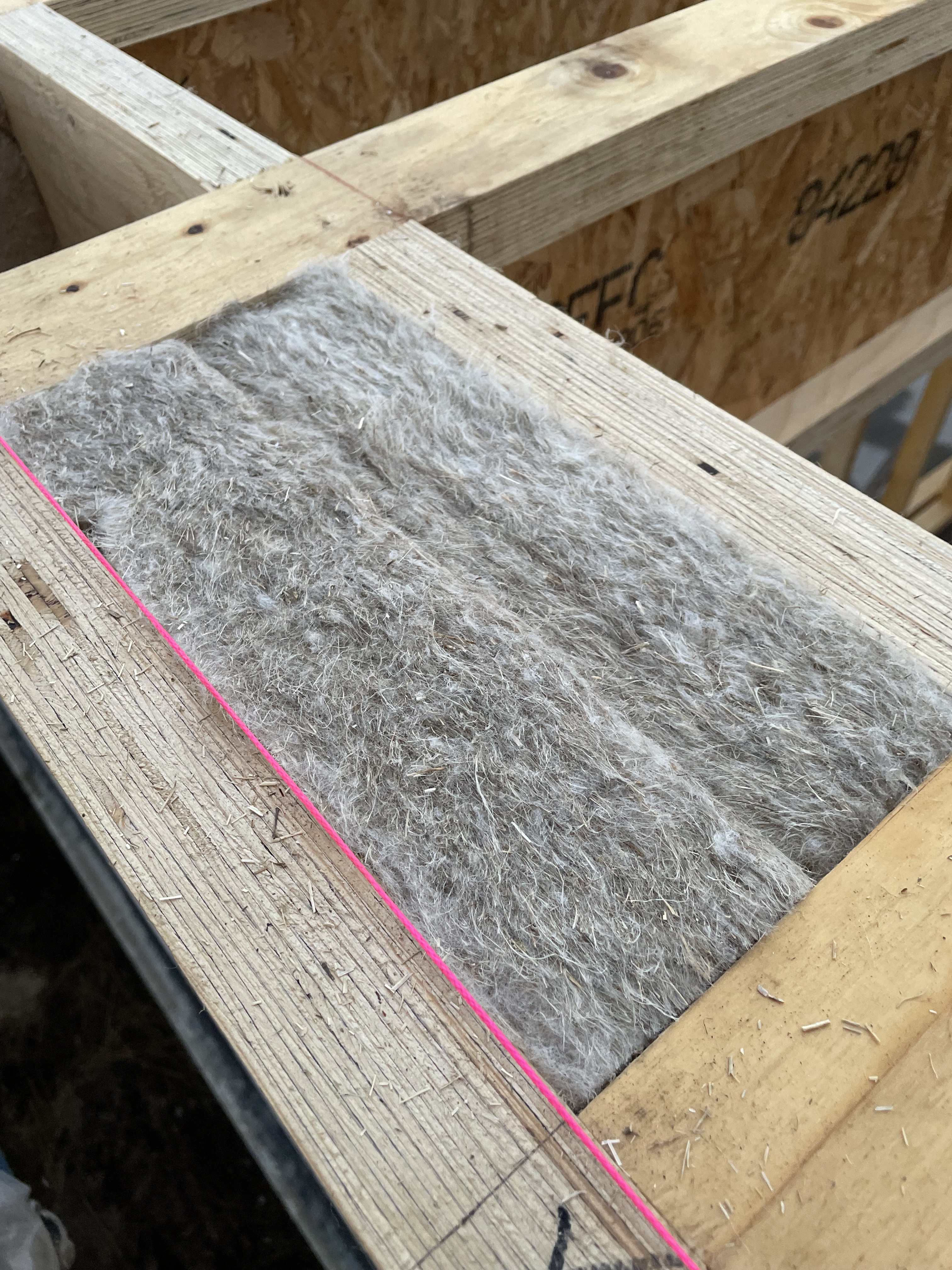

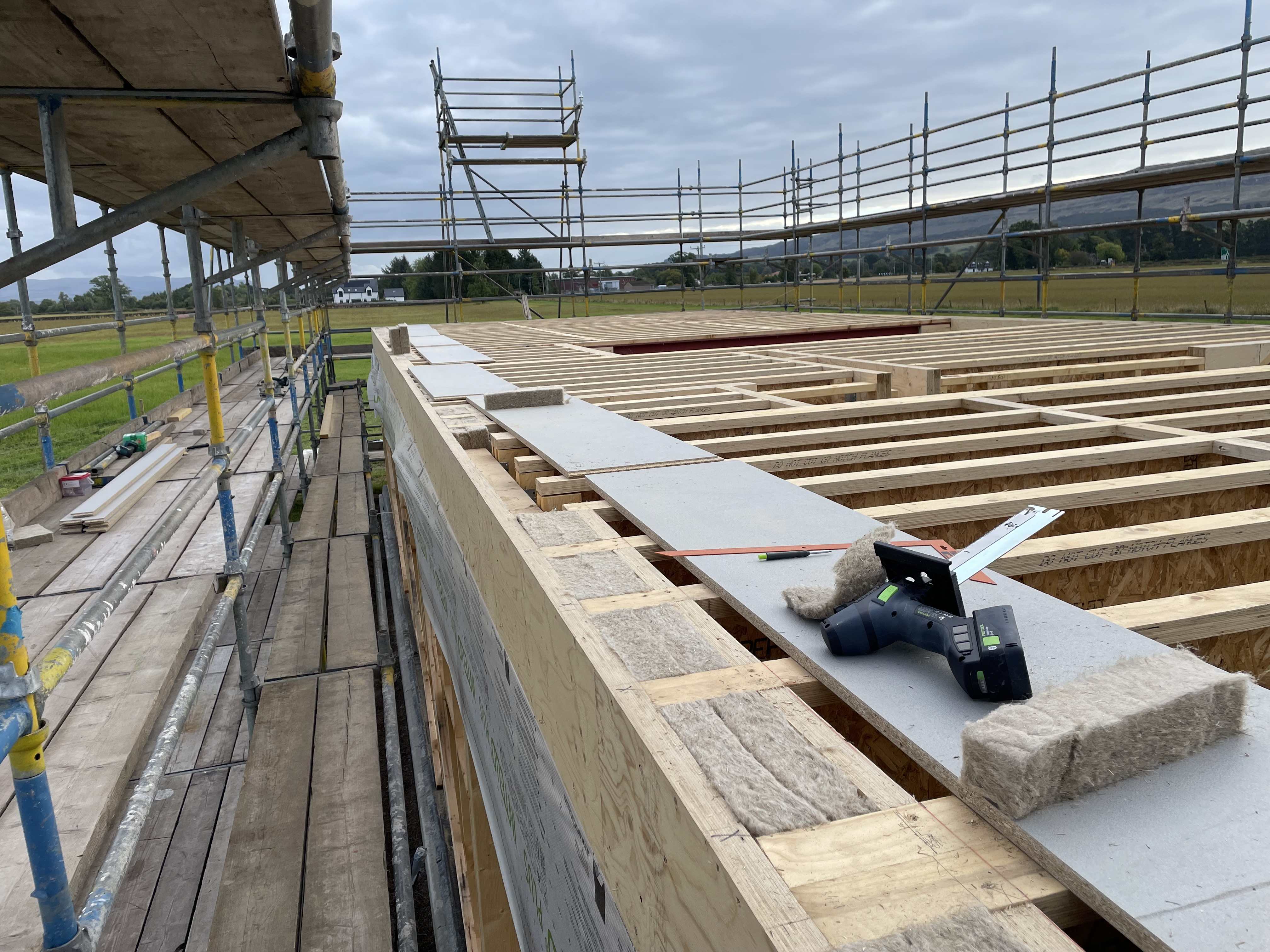

gavztheouch Posted October 1, 2024 Author Share Posted October 1, 2024 Flooring started to go on today. I had to pre-insulate the floor round the edges where the wall sits on top as this will not be accessible later on. I used hemp insulation here as it was the closest to wood fiber I could get at short notice in the sizes I need 1 1 Link to comment Share on other sites More sharing options...
gavztheouch Posted October 6, 2024 Author Share Posted October 6, 2024 (edited) Flooring is down. I used egger protect which has a coating on it to give 60 days protection. Unfortunately the joiners have used half the amount of foaming glue needed so the glue has not sealed the boards and already after a couple of days the edges have swollen. Pretty annoyed as the flooring is something you can’t really ever replace as it’s under the first floor wall and glued to the joists. Fingers crossed it emerges out the other side of 30 days getting the roof on in ok shape. The joiner said he knew how to fit it and he has done it many times. We discussed the importance of a seal on the boards so I felt comfortable I didn’t need to check the installation instructions to check how much glue we needed. In hindsight the only way I think to make sure it was done right would have been to check the installation instructions and then worked with them to make sure it was done right. Exhausting having to second guess everything. Edited October 6, 2024 by gavztheouch Link to comment Share on other sites More sharing options...
