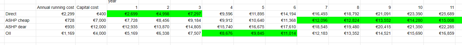

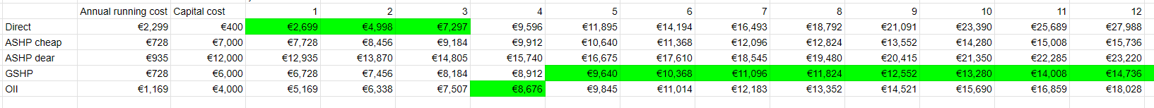

Nially Posted December 17, 2023 Author Share Posted December 17, 2023 18 hours ago, Iceverge said: Here's some running costs. ( Electricity prices from switcher.ie, standing charge and other elec usage excluded, 65% usage on night rate tariff, rural user) €2299/yr direct electric on a 80% usage night rate tariff. Capital cost €400 for Willis heater/immersion. €935/year on cheaper monoblock ASHP( COP for SH/DHW of 3/2). Capital cost of €7000 € 728/year on an expensive split ASHP(COP for SH/DHW of 4/2.5) . Capital cost for AHSP+ cylinder inc install is €12,000. €728/year for GSHP with same COP's. Cost of borehole and pipes €6000. €1169/yr on Oil. Capital cost say €4000 for new boiler/tank and external store Here's a quick table of total costs based on my above guesses. As you can see direct electricity wins for years 1-3. Then oil for year 4. Then a GSHP repair for years 5- onwards although the cheap ASHP is a not far off. The expensive ASHP never catches up. Although it's rough and ready you can probably discount oil, and an expensive ASHP and direct electric. You're back to 2 options. A cheap ASHP and fixing the GSHP. I would get some accurate quotes,revert and I can redo the sums. PS. What was the spec you were quoted for the ASHP for €12k? Thanks for your input and taking the time to put that together. It certainly make all the options a lot clearer. I was quoted for a 12kw Daikin mono block unit but I have asked for a requote for a smaller pump. They used standardised parameters to size the heat pump as the house was built in 2014 and I have no accurate heat loss data. Although a near 10 year old house it’s was built and insulated a lot better than the parameters they have used. I should have the new quote back on Monday. I also got a quote of 13,500 for 2 bore holes each 130 meters deep🙈. The payback certainly isn’t there to justify that. I am also meeting another driller during the week to get another quote so I’ll see how that goes. thanks again Link to comment Share on other sites More sharing options...
saveasteading Posted December 17, 2023 Share Posted December 17, 2023 2 hours ago, Nially said: Repair isn’t a solution/option here so it’ll be a replace ground loop or drill bore holed if I continue with the GSHP Simple then. Replace with ashp. They really aren't noisy although you wouldn't one on the patio. Positioning out of your way and perhaps with a louvred fence, and of course choosing a quiet model should suffice. Link to comment Share on other sites More sharing options...

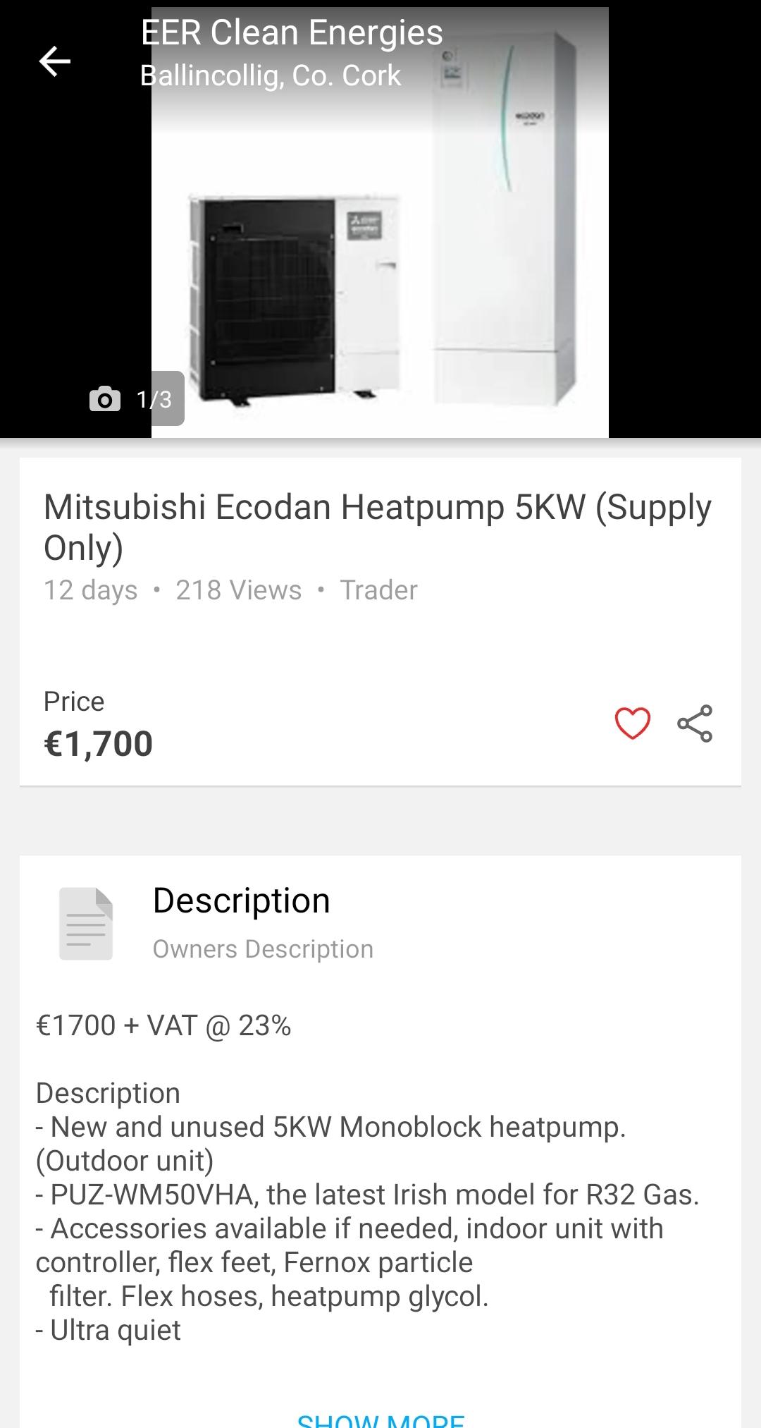

PhilT Posted December 21, 2023 Share Posted December 21, 2023 On 16/12/2023 at 15:21, Nially said: Yes thanks I am also thinking of a mono block unit and to mount it 9ft up on the outside wall as I can run pipes across the ceiling to my heating cupboard. I will need new dhw cylinder as you rightly suggested. If a 7kw unit will do the job it will look a lot neater on the wall outside I think this is an excellent idea and one I was also considering but couldn't find a suitable location. It has an advantage of enabling better efficiency at low ambient temps. "A thermometer on most weather stations is taken 2 meters (or about 6 feet) above ground level (AGL). Because cold air sinks relative to warm air, and because the ground radiates heat very efficiently during calm, clear nights, the temperature at or near ground level can often be several degrees cooler than the temperature at the 2 meter thermometer height". https://www.weather.gov/abr/frost_fall2012#:~:text=Because cold air sinks relative,the 2-meter thermometer height. Link to comment Share on other sites More sharing options...
