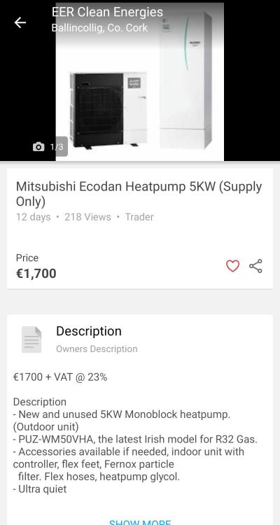

Having fitted a gshp partly because I previously thought it a good idea and partly because I wanted to...I would agree.
Quality air to water setups are achieving COP 4.5+ in a UK Climate. It's a no brainer.
Cheap option: take the heat pump gubbins out of your all-in-one then recycle the brine loop pipe entry to the property to connect to an air to water monobloc (6kW - assume you can't go to big on hot water production unless you KNOW that the chilli in the cylinder is good)
Plenty of space inside the all in one to house the three port diverter and the air to water controls.
Better option: swap all in one for a plain cylinder of respectable coil size and volume; fit air to water unit.
It wants to go by the back door. Learn to love it.
