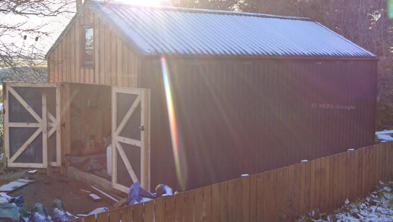

Bozza Posted November 30, 2023 Share Posted November 30, 2023 1 hour ago, optimystery said: Yes, I am thinking this may be more realistic. 6x5m sq outbuilding plus a garage or double garage would probably work. Adding extraction might be tricky, but would only be needed in one of the spaces. Is your shed 5x3m? 8m long x 3.6m wide x 3.9m high. To squeeze it under the permitted development rules. Hand built by moi. 1 Link to comment Share on other sites More sharing options...
