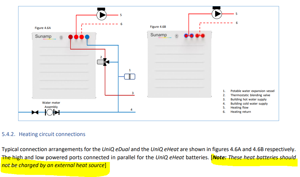

oranjeboom Posted November 23, 2023 Author Share Posted November 23, 2023 2 hours ago, JohnMo said: Or let them install a cylinder, which gets sold on later? Or let the heat pump try to heat the Sunamps, if it doesn't work well i.e. rubbish CoP, don't let it call for heat ever again. Tell installer what he wants to here, nothing more or less. I really don't have the room for a cylinder unfortunately! Unless I place that in one the unfinished rooms upstairs and have a 20m pipe run from the DHW manifold. Could be done...but a PIA... Would they even install a cylinder (presume size-wise it would be based on bedrooms in house rather than actual occupants (1.5)?) plus an ASHP circa £7.5k grant? On 21/11/2023 at 10:17, joth said: This makes you ineligible for BUS https://www.ofgem.gov.uk/sites/default/files/2023-09/BUS PO guidance V2.3.pdf (my emphsis) "4.25. The heat pump or biomass boiler must provide both space and hot water heating and be capable of meeting the full space heating and hot water heating demands of the property." Annoyingly I have just checked my Sunamp units and they are eDuals (both 12) and I have checked the manual that does state "These heat batteries should not be charged by an external heat source". That contradicts what I have in writing from Sunamp a few years ago prior to shipment! Annoyingly someone at Sunamp confirmed that the Uniq HWi and eDual units "are the same product" when I questioned them on this. So now I am left with 2 units that cannot be charged via ASHP which had been the intention at some point. Not happy! Link to comment Share on other sites More sharing options...

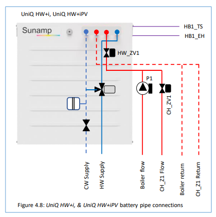

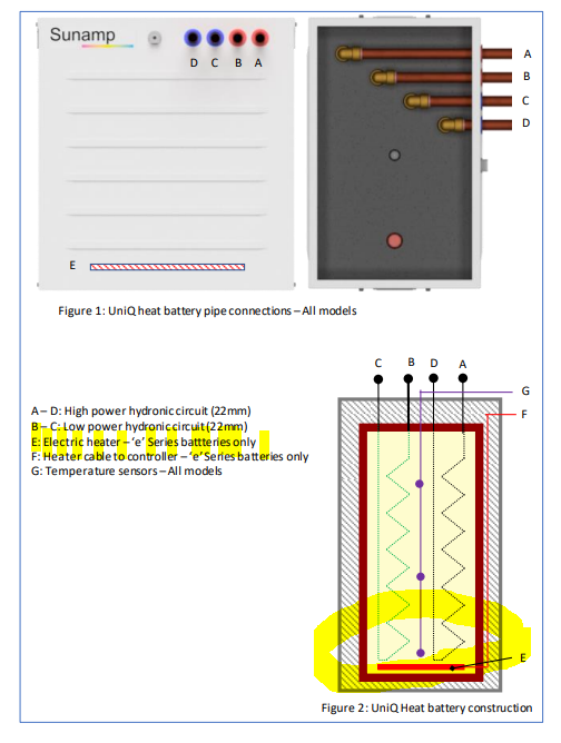

joth Posted November 23, 2023 Share Posted November 23, 2023 1 hour ago, oranjeboom said: Annoyingly I have just checked my Sunamp units and they are eDuals (both 12) and I have checked the manual that does state "These heat batteries should not be charged by an external heat source". Do they physically have pipework to connect an external source into? If they do, what is the point?? If not, then it was never going to work. Are you reading an online manual, that they've modified since you purchased, to disadvise something that was previously advertised as supported? Link to comment Share on other sites More sharing options...
oranjeboom Posted November 23, 2023 Author Share Posted November 23, 2023 1 hour ago, joth said: Do they physically have pipework to connect an external source into? If they do, what is the point?? If not, then it was never going to work. Are you reading an online manual, that they've modified since you purchased, to disadvise something that was previously advertised as supported? So the UniQ systems all have 4 ports that would allow 2 flows and 2 returns. See fig 4.6a below in the UniQ manual v2.3. Not seen the latest Thermino manual so can't comment on how things have developed. s 5.4.1: Presume the highlighted section refers to eHeat batteries and eDual (the ones I have). The HW+i also has the 4 ports s5.5.1: The HW+i model ("heated by an external heat source (e.g. Gas boiler, Heat pump)...are fitted with a standby electric heater") has the capability of electrical heating too and yet this is contradictory again in this diagram where it states the electrical heater element only refers to the 'e' models: I imagine the inside construction of that whole range is pretty much the same (with some having the electrical heater built in some not) and that the Sunamp Qontroller is where the systems really differ, but I am sure @Nickfromwales would know more. Clearly I'm no expert on these units and that's why I relied at the time on Sunamp to confirm/advise things before the things were shipped! If they then confirm that the HW+i and the eDual systems are the same, you have to settle for that as they are the product experts. I can see why they have moved away from dealing with customers direct as I'm another one who's severely disappointed with this outcome now! Link to comment Share on other sites More sharing options...

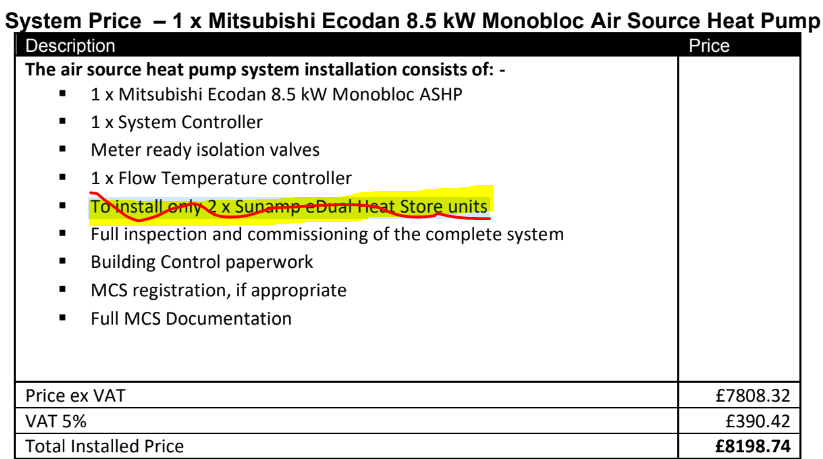

oranjeboom Posted December 19, 2023 Author Share Posted December 19, 2023 So from I gathered from my dealings with Sunamp and installer is that the controller on eDuals would need to be replaced as these have " a switching circuit which won’t be compatible with most heat pump controls as they utilise a resistance reading to generate a demand or satisfied call" Has anyone had an external controller replaced and what was the cost? I know they are now fitted internally on the Thermino models so can't imagine it's a very complex issue to provide me with an updated external controller? Obviously I have enquired with customer service, but service is a hit and miss affair and often one is quicker to go via the BH way! Link to comment Share on other sites More sharing options...
JohnMo Posted December 19, 2023 Share Posted December 19, 2023 3 minutes ago, oranjeboom said: controller on eDuals would need to be replaced as these have " a switching circuit which won’t be compatible with most heat pump controls as they utilise a resistance reading to generate a demand or satisfied call" Have a read at the bottom of the this thread two resisters and a relay is all you need to to convert on/off control to resistance Link to comment Share on other sites More sharing options...
