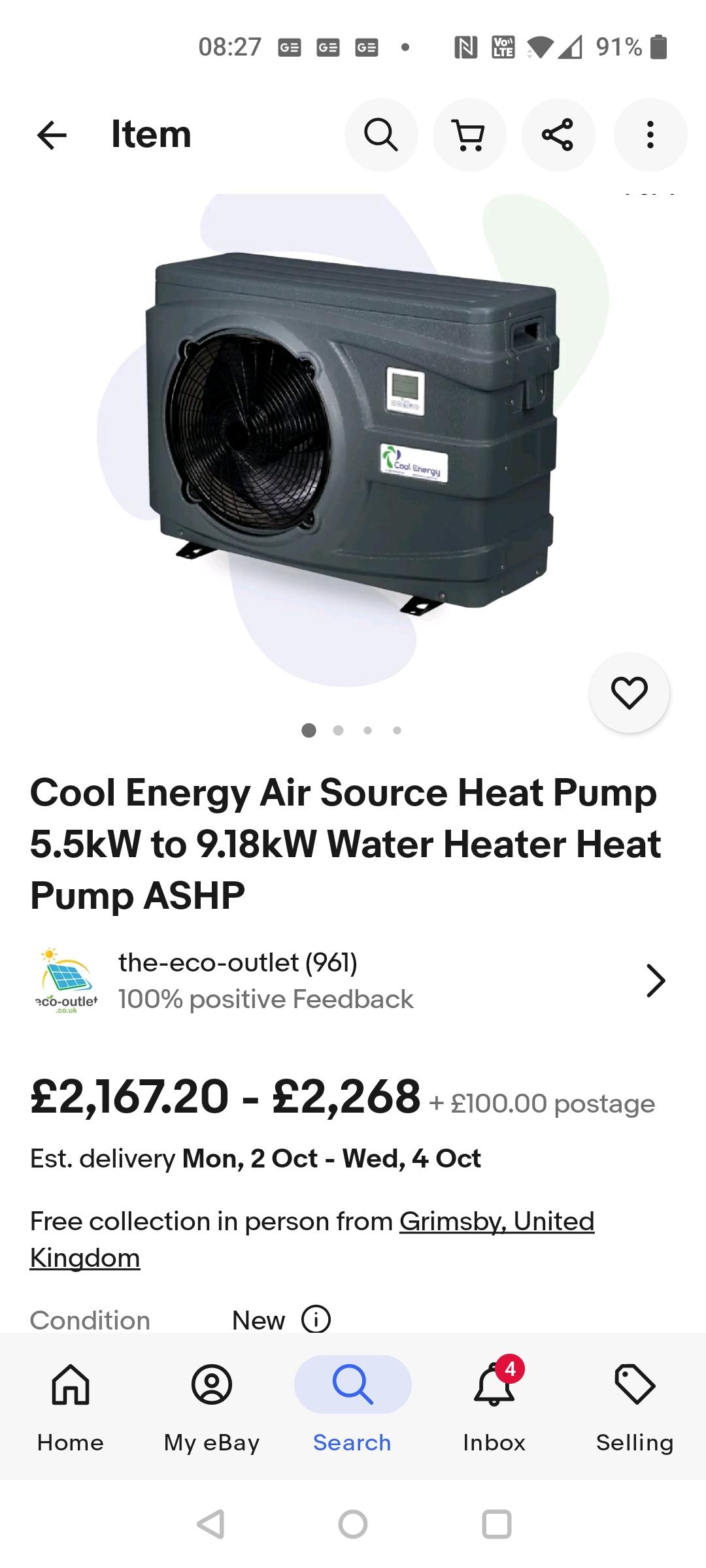

A two minute search on eBay, brand new cool energy unit, for around £2kScreenshot_20230928-082717.thumb.jpg.75493c368eb657055d4dab1431665f86.jpg
https://www.theheatpumpwarehouse.co.uk/shop/heat-pumps/air-source-heat-pumps/7-kw-panasonic-aquarea-high-performance-mono‑bloc-j-generation-1-phase-r32-wh-mdc07j3e5/
Panasonic 7kW for £2.5k + the Vodka And Tonic. Reverses for cooling without much thought / input, but if this is a let property you’d need to decide the merits of cooling (or just not announce it until you perhaps adopt the property later down the road?).
