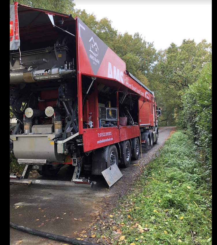

crispy_wafer Posted November 23, 2023 Share Posted November 23, 2023 Presuming it was a flow screed pour? If so the screed supplier would have records as to how much was poured.  1 Link to comment Share on other sites More sharing options...

saveasteading Posted November 23, 2023 Share Posted November 23, 2023 4 hours ago, Kelvin said: those wee spider level things Great description. So they set the arachnids, dipped the levels and ordered the exact amount of screed? Clever. No waste? There is always some, or they're scraping out the mixer for some more. 1 Link to comment Share on other sites More sharing options...
crispy_wafer Posted November 23, 2023 Share Posted November 23, 2023 13 minutes ago, saveasteading said: So they set the arachnids, dipped the levels and ordered the exact amount of screed? Clever. almost...  straight out of the volumetric mixer truck  1 Link to comment Share on other sites More sharing options...
joe90 Posted November 23, 2023 Share Posted November 23, 2023 4 hours ago, Kelvin said: Yes the guys that did mine had those wee spider level things and marked on a sheet the screed depth at each one. Same with me (but a towable mixing/pumping trailer) 1 Link to comment Share on other sites More sharing options...
Kelvin Posted November 23, 2023 Share Posted November 23, 2023 22 minutes ago, saveasteading said: Great description. So they set the arachnids, dipped the levels and ordered the exact amount of screed? Clever. No waste? There is always some, or they're scraping out the mixer for some more. Yes very little waste. 1 Link to comment Share on other sites More sharing options...
Kelvin Posted November 23, 2023 Share Posted November 23, 2023 Just now, joe90 said: Same with me (but a towable mixing/pumping trailer) Yes they dropped off the twoable pump the day before. All very slick. Team of three guys,  lorry driver and another guy came to check it and sign off. In and out before my other half managed to drive from the rental to watch the pour. 😂 1 Link to comment Share on other sites More sharing options...
Kelvin Posted November 23, 2023 Share Posted November 23, 2023 11 minutes ago, crispy_wafer said: almost...  straight out of the volumetric mixer truck  That would never have got in my drive! 1 Link to comment Share on other sites More sharing options...
saveasteading Posted November 23, 2023 Share Posted November 23, 2023 Volumetric is great for supplying the exact quantity. I didn't know that any would do a pump mix. 1 Link to comment Share on other sites More sharing options...
