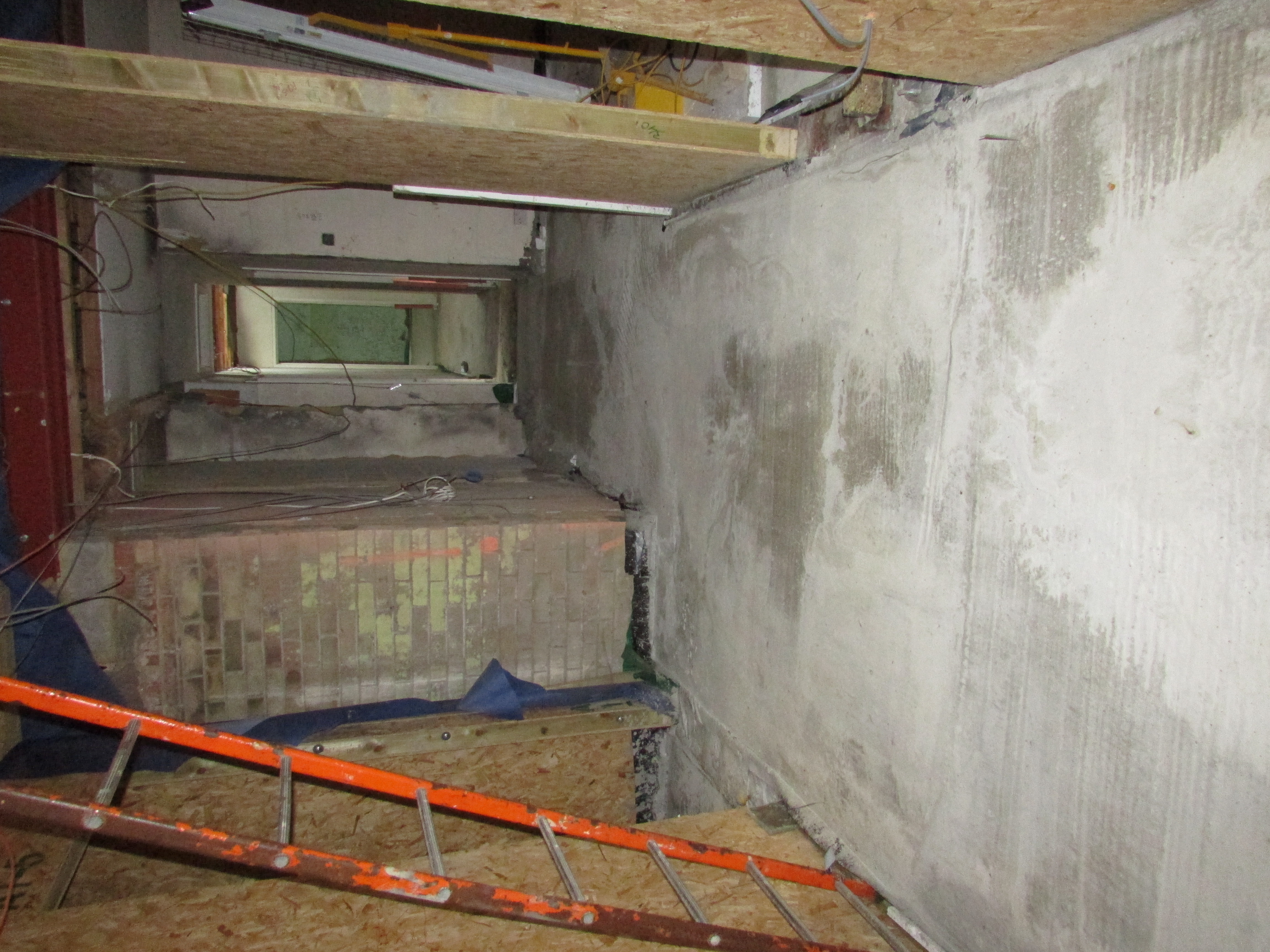

After 3hours of sleep this weekend, i may actually go to bed now! I'll post some pics soon. Actually better seal the front door b4 bloody wabbit or cat make it in there...:/
Only had about 7hrs sleep in an 84hr period prior to the slab pour so felt pretty drowsy on the day of the pour. I was still alert enough to spot/rectify certain issues including:
- a bit of ufh pipe popping out of the concrete where bit of mesh had lifted. The guy's intention was to just try and cover it up with a few mm of concrete! In then end I placed a bit of quarry tile on top of pipe and then placed a concrete block on top that to push/keep the tile depressed into concrete. I can probably lift the tile later on and 'fill in' with a bit of conceret/latex
- builder had been using top of perimeter upstand as datum instead of datum on block wall behind the datum! Potential 20mm difference! Had to scrape quite a bit off and re-level.
However, it's all ended up pretty poor and I haven't even needed a level to spot high/low spots - some areas are quite noticeable when just walking across areas. There are a couple of areas that will need to be ground down as they are simply too high. Better that, than have the whole area needing to be latexed later on.
Looks like @Barney12 you're not the only one with  an uneven slab!
Not going to get too stressed about this right now as I need to get on with other items. The positive thing is that the ufh pipes seemed to have survived the pour. Manifold pressure dropped down to 1bar since the pour (but stayed stable during the pour itself at around 3.2bar).

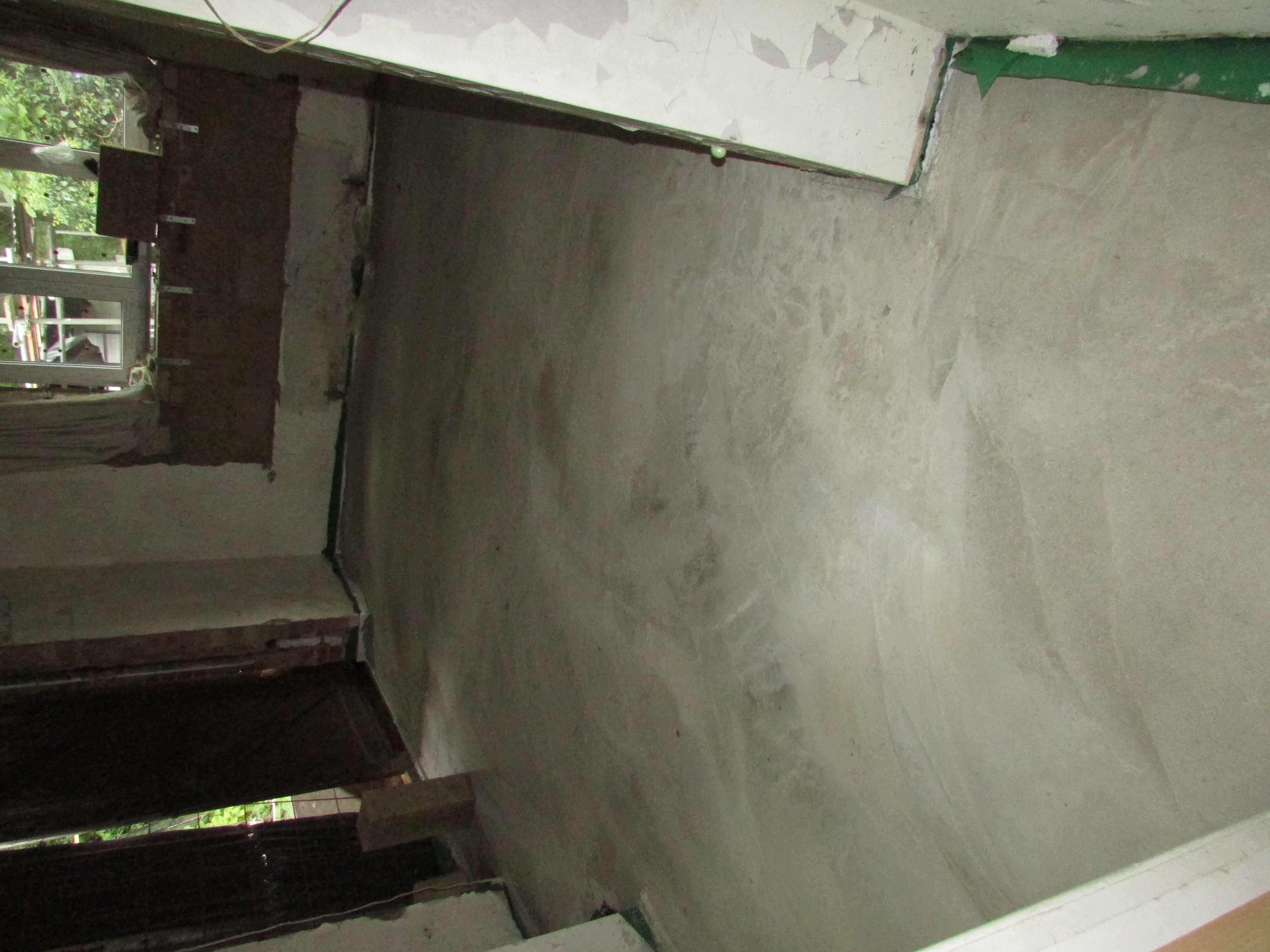

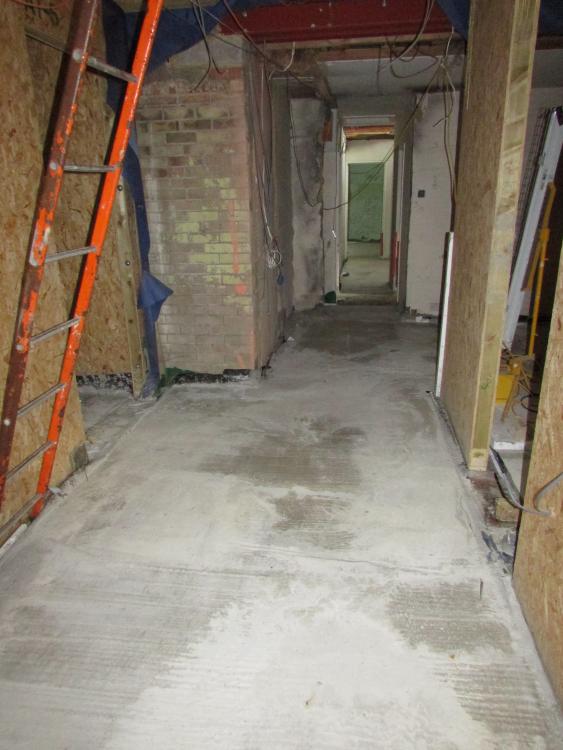

One of the hallways:IMG_1174.thumb.JPG.e9e47a651cd88ed409cac21f769aae3d.JPG
kitchen:
Tile with UFH pipe below:

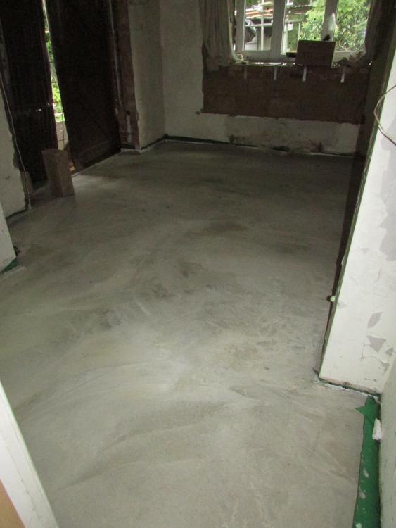

Lounge room. Various levels! Plenty of latex needed.
Builder must have known on the day that things weren't great as he was already coming back about latexing etc (at his expense).
1) Should I get him back sooner than later to rectify things? His idea was to do any latexing just prior to my bamboo floor going in to stop plasters crud ending up on his 'perfectly latexed floors'. I can understand that to some extent, but at the same time don't want him to be uncontactable in 4-5months time.
2) How easy is it to shave off say 20mm of concrete? 20mm is a guestimate at this stage, hoping it is less. Presume the sooner this is done whilst the concrete is still a bit green, the better. What tools are we looking at?
Any other considerations?
Thanks, OB
What concrete mix did they use,  do you know? I raised a question about slab levels in another thread - keen to find out what mixes the rolling floors used. There's got to be a better solution to this - too many people with uneven slabs! What's the common denominator?
Definitely sooner if you're confident he can do a good job with the latex. Unless you're lucky they have a habit of forgetting they said it or not answering their phone. You can always put down floor protectors until you lay the bamboo.
+1. Prime the concrete first with 50/50 PVA and water and absolutely saturate it. Do NOT let the builder just pour it straight on.
The slab will suck it dry before it's levelled out properly, and make 1m% sure they use 2-part leveller NOT the water mix one.

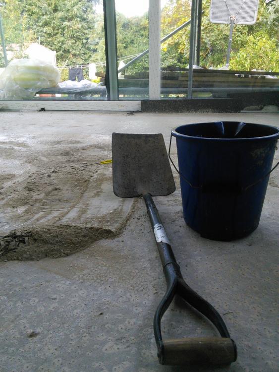

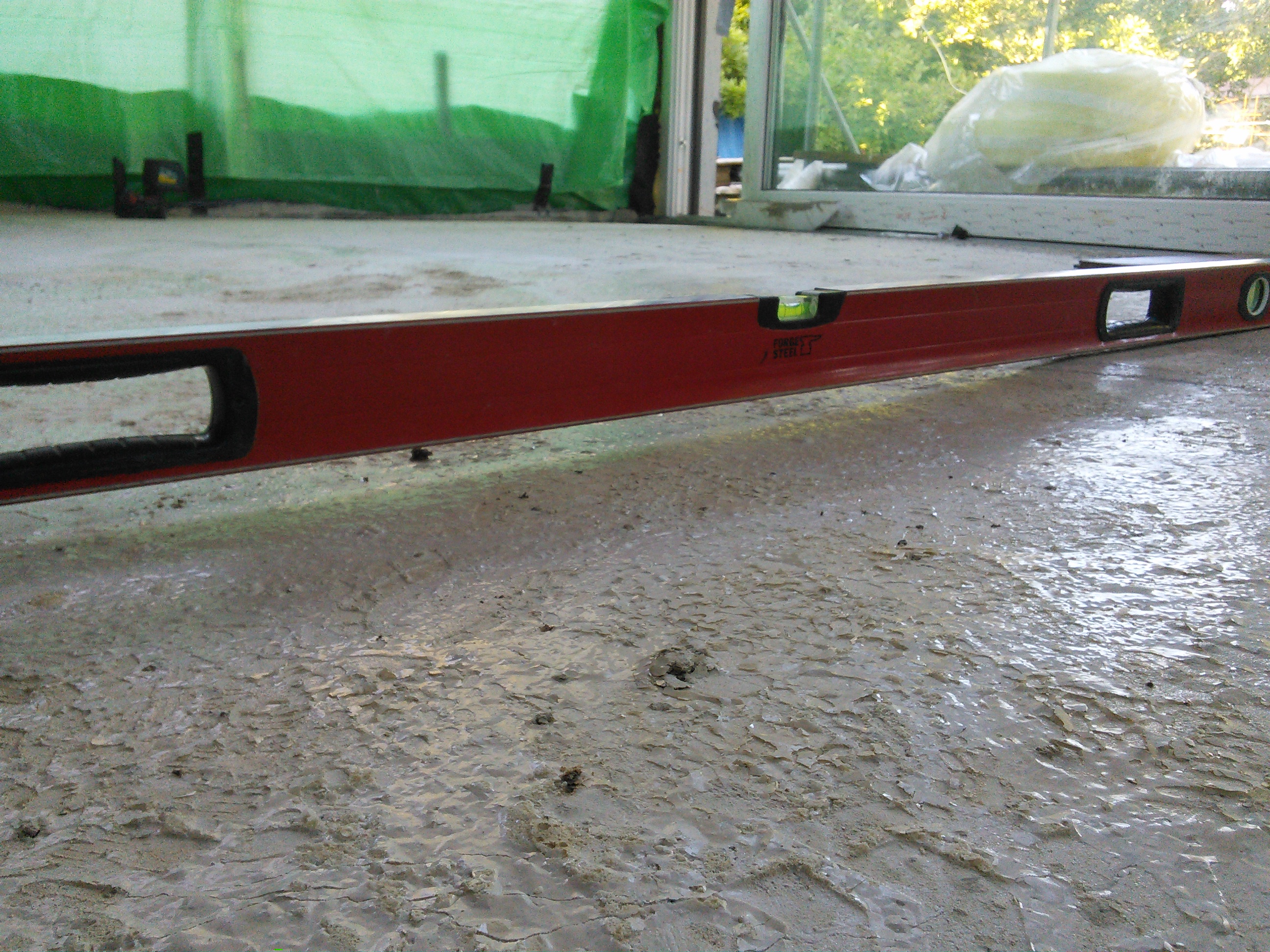

However, I took the courage and got out the level and laser today:/. The valleys remind me of South Wales!

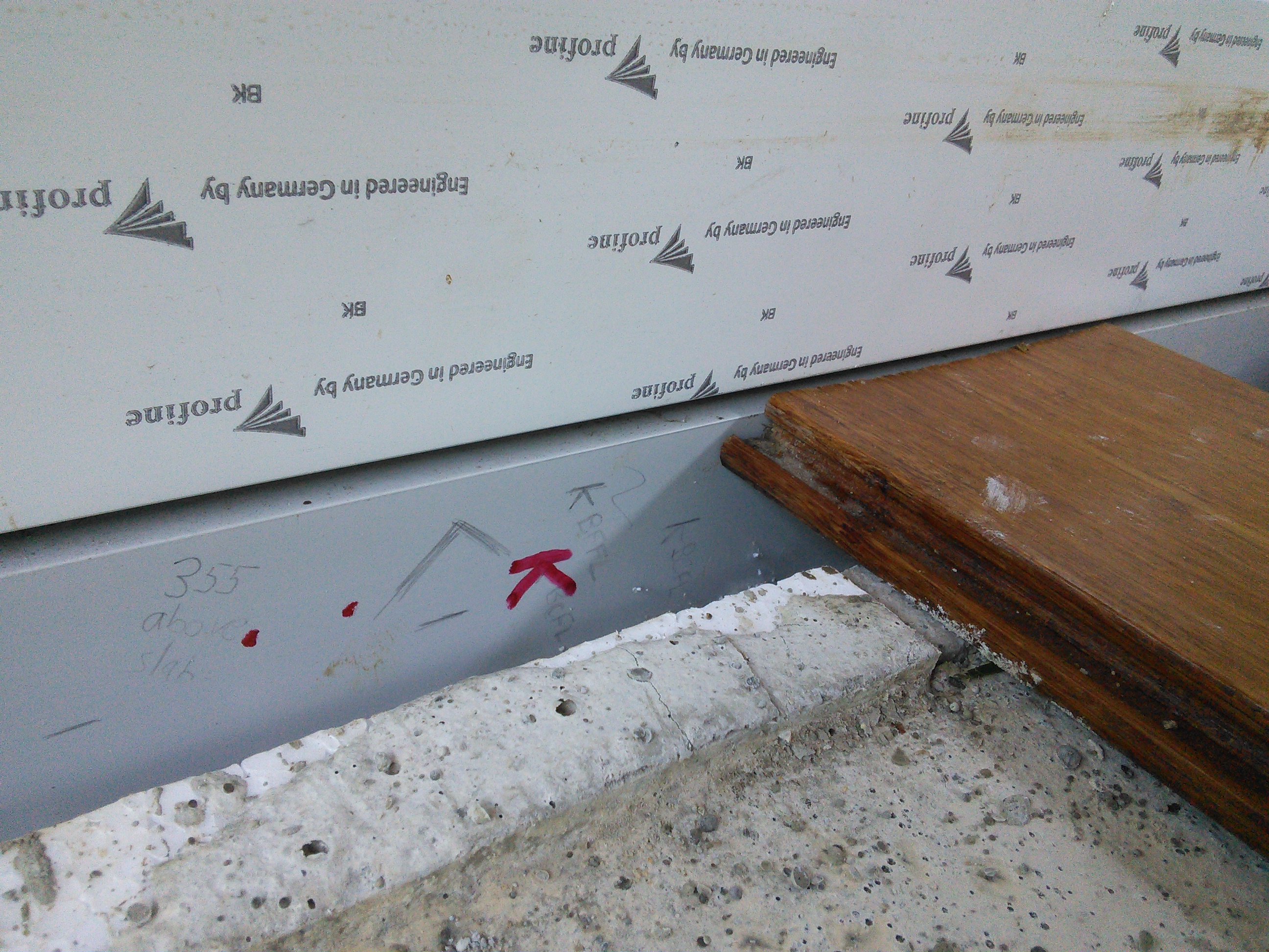

Main concern is where the 4.5m slider is. I'd clearly marked for him where the max level of concrete should be and it's ended up well above that. IMG_20170919_163732.thumb.jpg.21deec6ce9e4704e97377ba20abe43d1.jpg

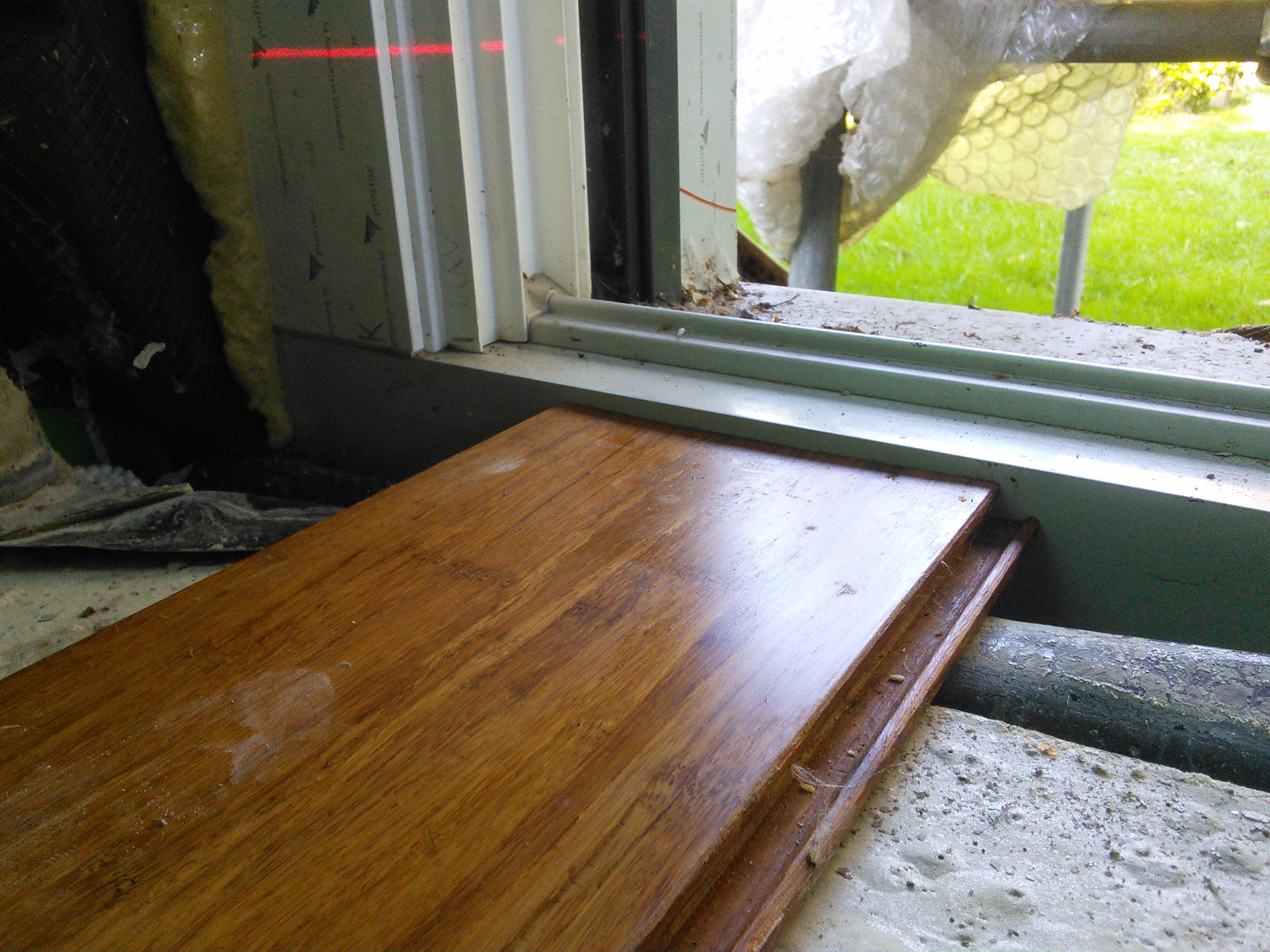

My bamboo floor was supposed to end up just under the door threshold (as below), but in most places it'll be just above that if it's not ground down.IMG_20170919_163649.thumb.jpg.e910442c830f10e22dd6290c1b2e53ff.jpg
And valleys where I can get my fingers under the level. IMG_20170919_164536.thumb.jpg.1b74fc5f4d33f04c61dfd693679e8d5b.jpg
Then there's an area of concrete where I can really gouge at it with the end of my measuring tape - will that harden. Hopefully not concrete laitance as that could be disastrous.
I guess the concrete is still failrly green (poured a week ago) and patches above, may still harden. Apparently this was C35, but I intend to call the suppliers tomorrow to confirm if that really was the case.
And the high spots are probably best to have ground down now before it 'hardens'/cures/sets more and more (excuse the language). I know the process takes years, but the sooner I have him back to sort out his peaks at least (the valleys can wait with latexing a bit later on).

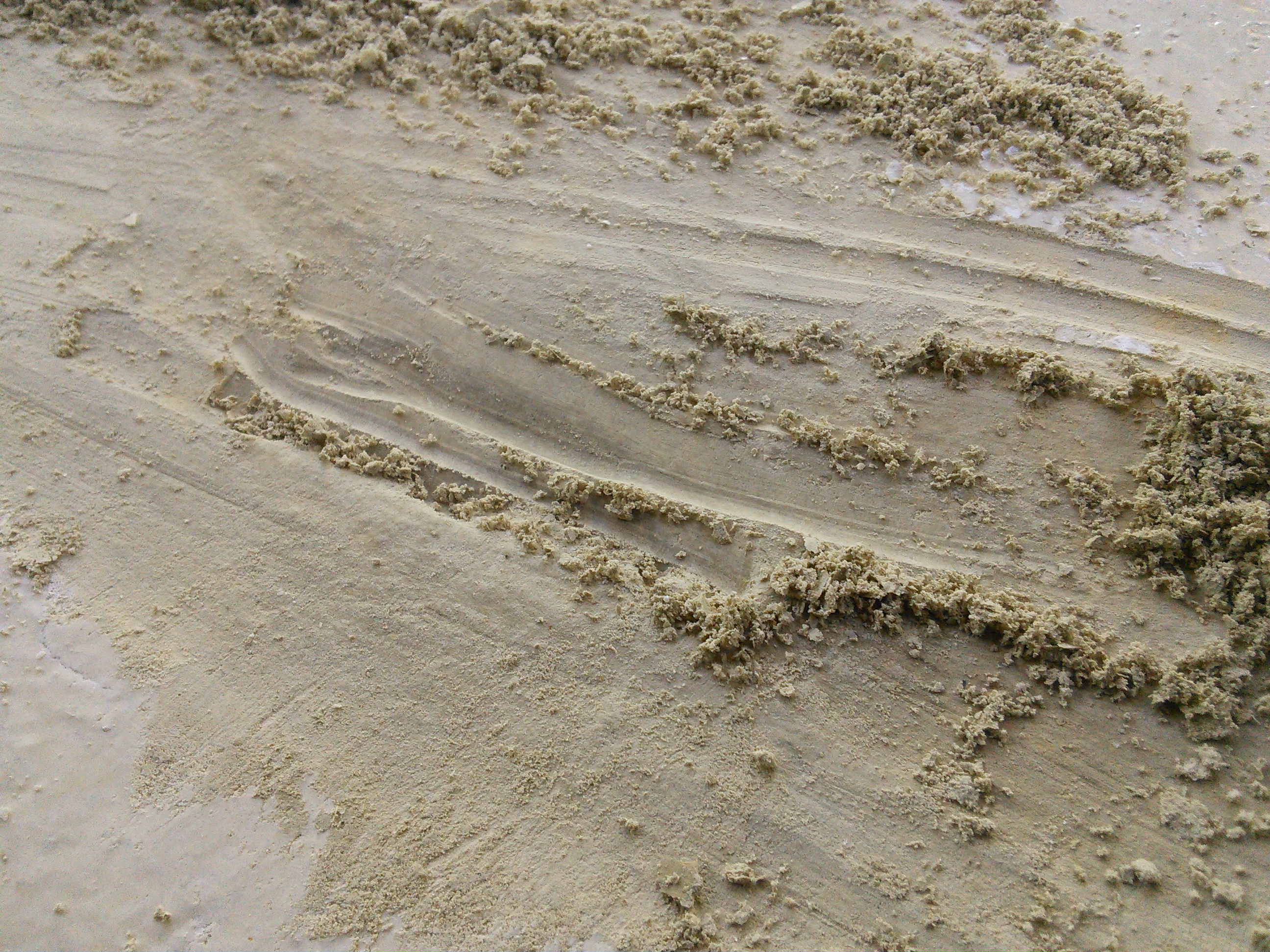

That's looks odd to me. I've never had concrete I can gouge with a tape measure after a week of hardening. Get him back asap and see what he thinks.
