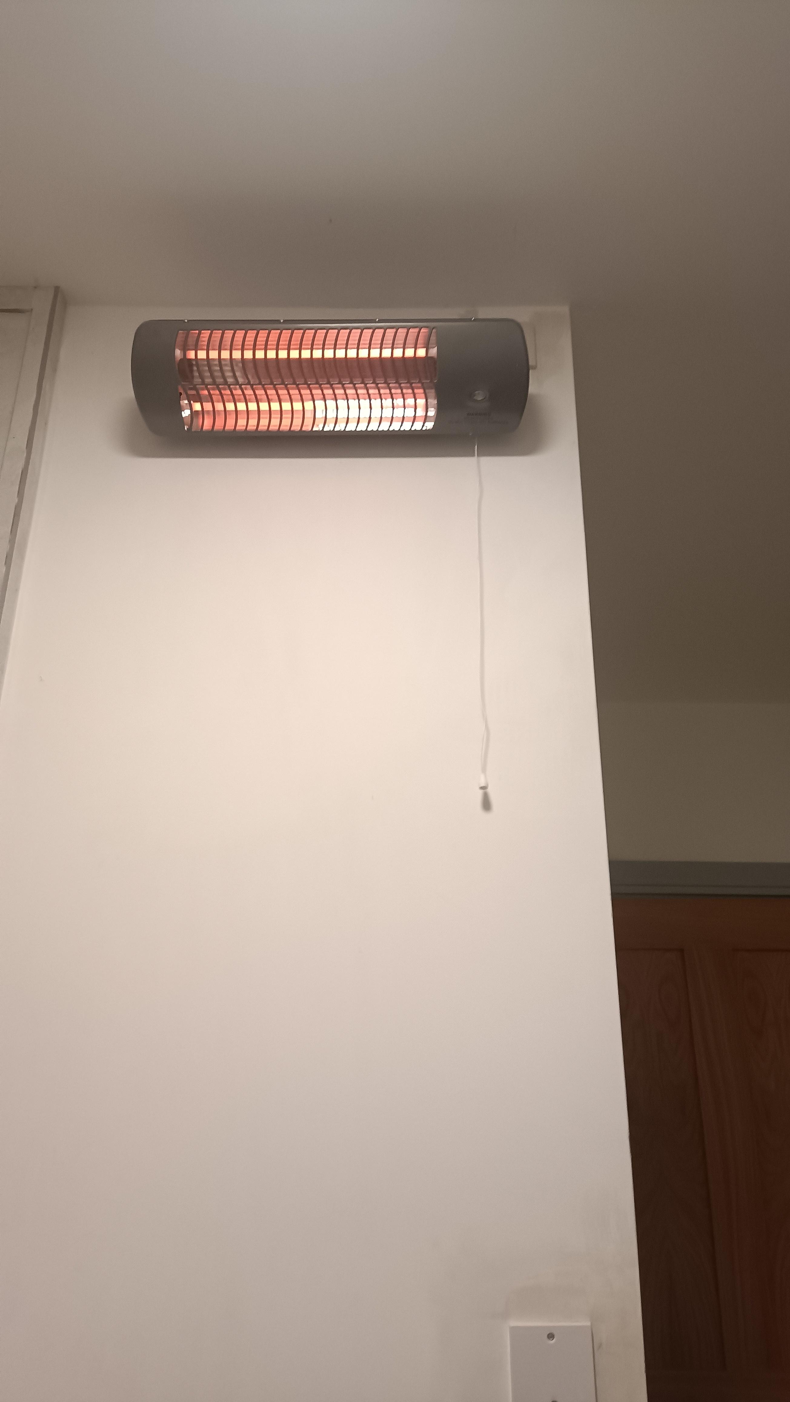

Iceverge Posted December 22, 2023 Author Share Posted December 22, 2023 (edited) There it is in all its shiny 1.2kW glory. A cheap as "gone off chips" wall hung quartz heater. I'm going to test it's dechilling powers out on my small children later. Let them be blasted by all radiative goodness and judge the response. Edited December 22, 2023 by Iceverge Link to comment Share on other sites More sharing options...

Iceverge Posted January 16, 2024 Author Share Posted January 16, 2024 (edited) Right the results are in. Success (I think!) Following on from @Gone Wests thread on comfort. I think I'm onto a winner. PROs: Super cheap. €31 from screwfix. They are simple to operate, pull string operated. Settings "1" "2" and "OFF". I hate pointlessly complicated stuff. They pretty instantly heat your skin, pull chord, squeeze pimple in mirror, admire reflection of naked body (it's as good as it gets, tomorrow you will be fatter and wrinklier) and "Kablam" there's the lovely heat. I can run the shower slightly colder trading off the energy used. Baths are comfortable for longer. Dry install, no chance of leaks. 20deg bathroom feels comfortable even in the nip. No need to spend too much on space heating or preheat the bathroom. CONs: Cheap construction ( surprise surprise!) Pointless as a space heater, they just heat a layer of air by the roof if left on. 1.2kW of direct electric is expensive if someone forgets to turn it off. It looks crap. Not as radiative as a proper patio heater, more heat is lost to convection (I think) than a halogen one. Not completely sure of this but I'm suspicious. It smells a bit iffy initially, maybe a factory coating burning off or something. If you were concerned maybe something like this would be more stylish and could parabolically beam the heat at you better. Then add a 12 minute push timer. Overall I would endorse this. Simple cheap and effective. Edited January 16, 2024 by Iceverge Link to comment Share on other sites More sharing options...
Wil Posted January 16, 2024 Share Posted January 16, 2024 But what is your winner? Or is it just me that can’t see it? Link to comment Share on other sites More sharing options...
Iceverge Posted January 16, 2024 Author Share Posted January 16, 2024 5 hours ago, Wil said: But what is your winner? Or is it just me that can’t see it? Ah, I see the confusion. The cheap quartz heater I installed is the victor. 2 Link to comment Share on other sites More sharing options...
