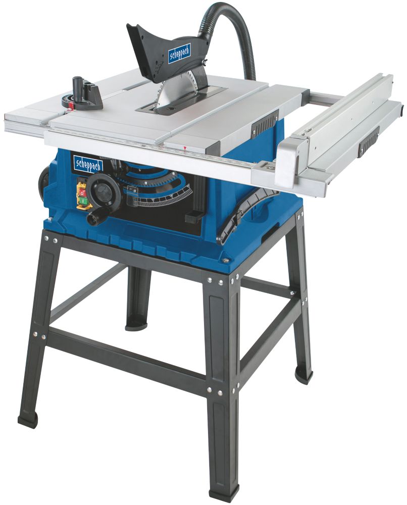

ProDave Posted September 8, 2017 Posted September 8, 2017 Can you make a guard that comes down over the blade from above? Not infallible but some protection against stray things contacting the blade you just need something behind the blade (and thinner than the blade) for it to pivot on. Here's a random picture of a proper table saw showing what I mean

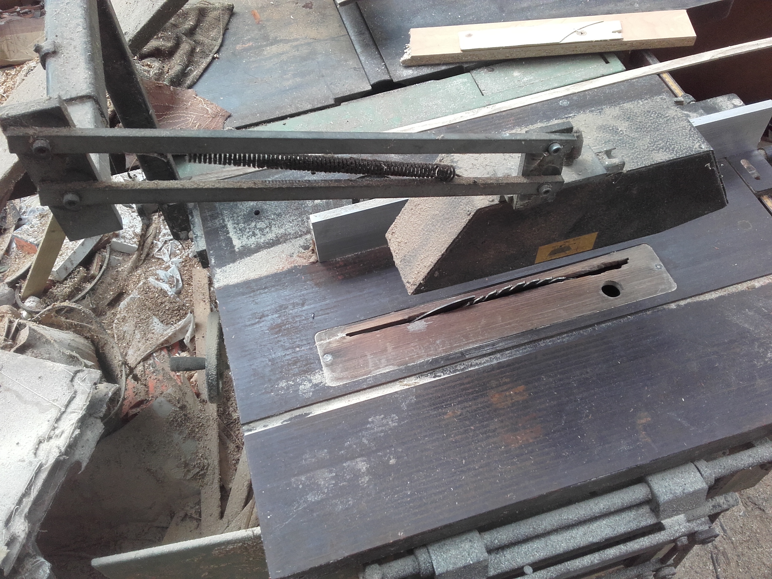

Onoff Posted September 8, 2017 Posted September 8, 2017 1 minute ago, ProDave said: Can you make a guard that comes down over the blade from above? Not infallible but some protection against stray things contacting the blade you just need something behind the blade (and thinner than the blade) for it to pivot on. Here's a random picture of a proper table saw showing what I mean Just what I was about to say. Like this: 1

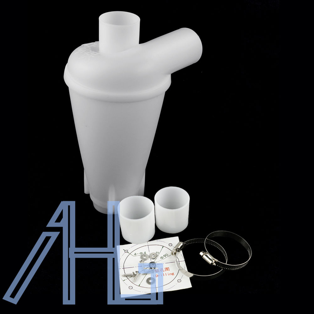

Jeremy Harris Posted September 8, 2017 Author Posted September 8, 2017 55 minutes ago, Onoff said: Just what I was about to say. Like this: That I like, as it does away with the need for the riving knife, which although of some use, apart from providing an attachment for a guard, would need to be fixed to the pivot somehow, to allow cuts to be made at an angle. Although I agree with @TerryE, it doesn't makes much sense from a financial viewpoint, I hate waste, and I have this pretty much unused, 2 kW, 235mm circular saw just sat doing nothing. I'm also part way through building a cyclone dust extractor box for the new workshop, so the current plan is to make a box with a flat top that will do three things. It will be the dust collector for the workshop (using an old 1800W vacuum cleaner motor that I've been saving for a useful job, with one of these cyclone separators: http://www.ebay.co.uk/itm/Plastic-Cyclone-Powder-Dust-Separation-Collector-Filter-For-Vacuums-Cleaners-/272836140016?hash=item3f864d1bf0:g:DSgAAOSw32lYx4uM and an old plastic bucket with a lid), it will be a small saw table, with two bits of alloy T track set into the top to act as guides for the rip fence, and also as a mount for my mitre saw, which will just bolt down to the same T tracks that are used for the rip fence (with the table saw blade retracted below the table surface).

Guest Alphonsox Posted September 8, 2017 Posted September 8, 2017 1 hour ago, JSHarris said: I'm also part way through building a cyclone dust extractor box for the new workshop, so the current plan is to make a box with a flat top that will do three things. It will be the dust collector for the workshop (using an old 1800W vacuum cleaner motor that I've been saving for a useful job, with one of these cyclone separators: http://www.ebay.co.uk/itm/Plastic-Cyclone-Powder-Dust-Separation-Collector-Filter-For-Vacuums-Cleaners-/272836140016?hash=item3f864d1bf0:g:DSgAAOSw32lYx4uM and an old plastic bucket with a lid) I'm using an old Dyson upright with the hepa filters removed feeding via a bucket, remarkably efficient at clearing the air.
Onoff Posted September 8, 2017 Posted September 8, 2017 (edited) 1 hour ago, JSHarris said: That I like, as it does away with the need for the riving knife, which although of some use, apart from providing an attachment for a guard, would need to be fixed to the pivot somehow, to allow cuts to be made at an angle. I'll measure the guard in my photo up if you want. It's on a 300mm blade saw btw. It DOES have the riving knife that you can just see that rises and falls with the blade. Edited September 8, 2017 by Onoff
