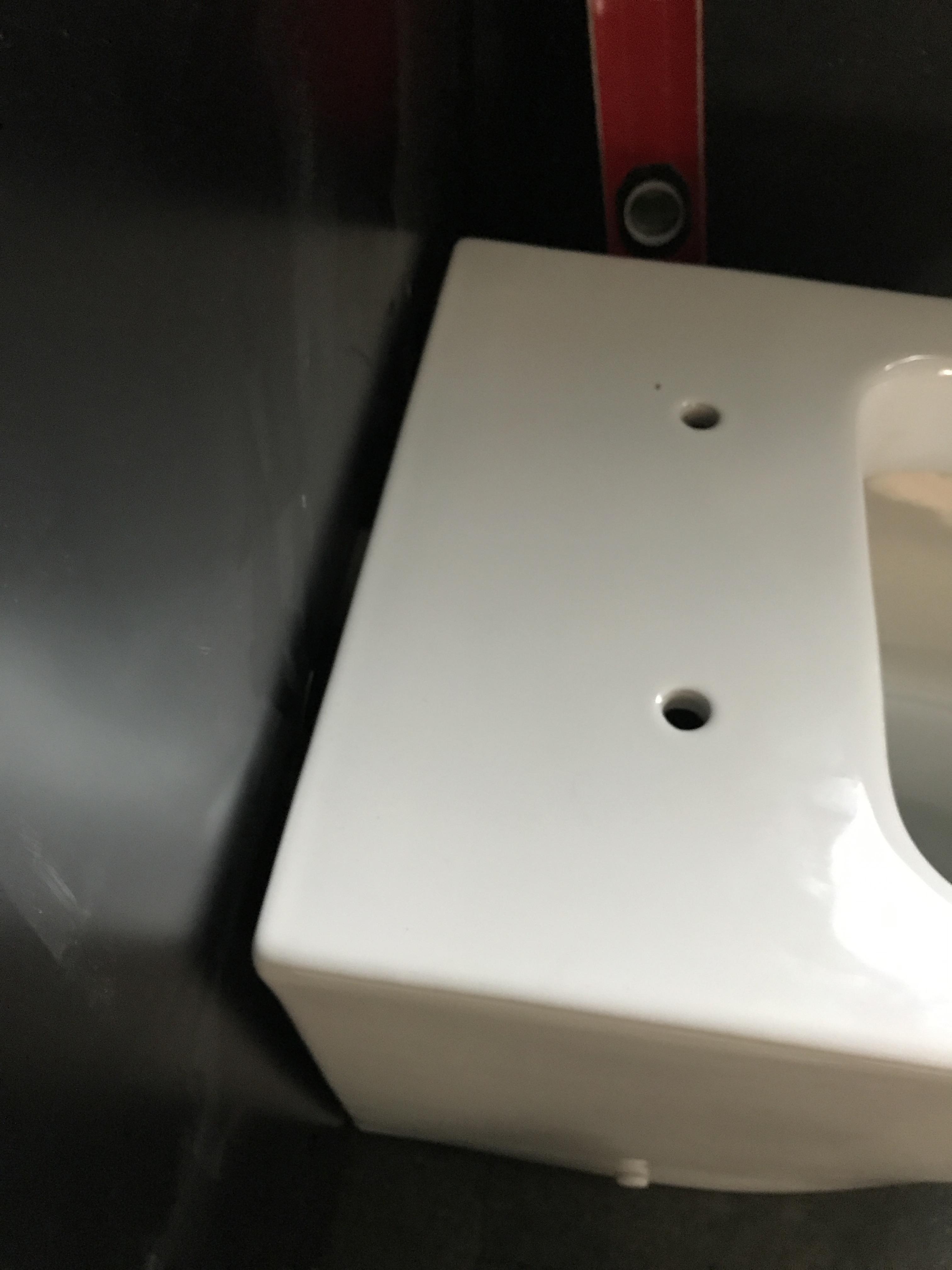

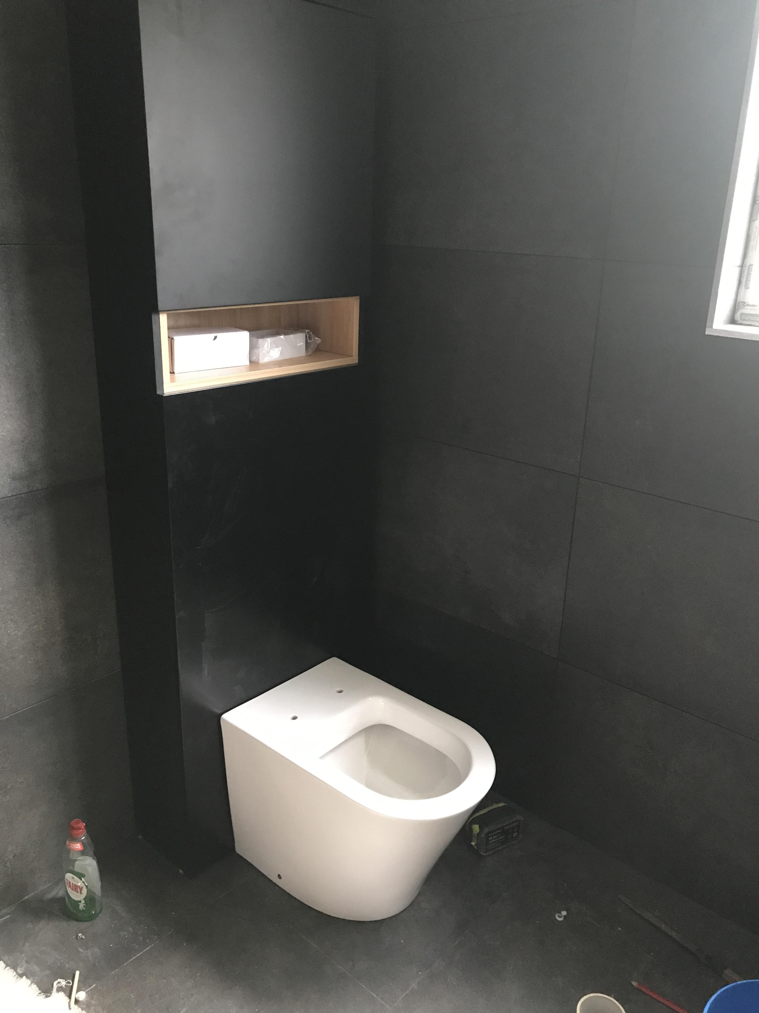

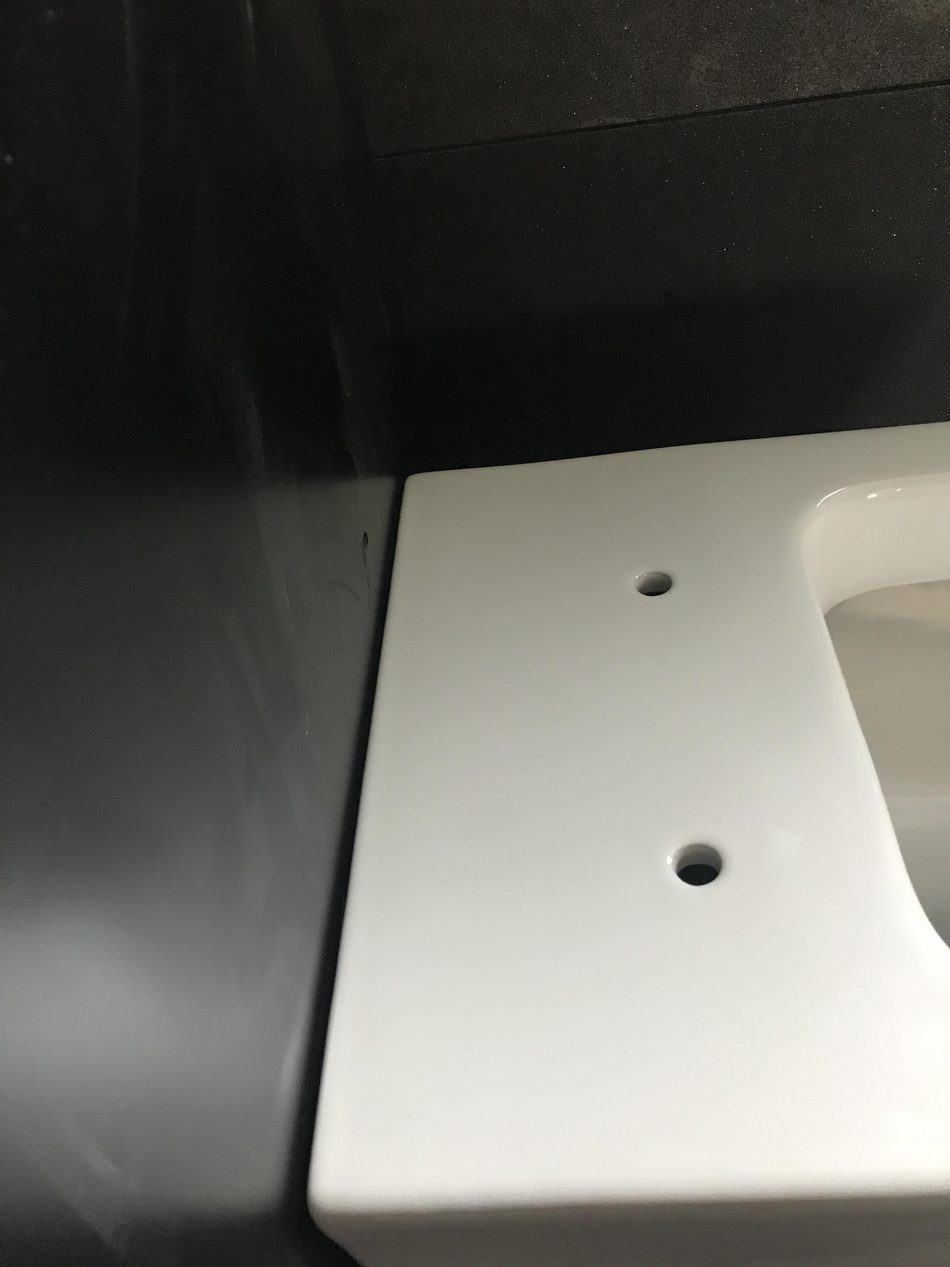

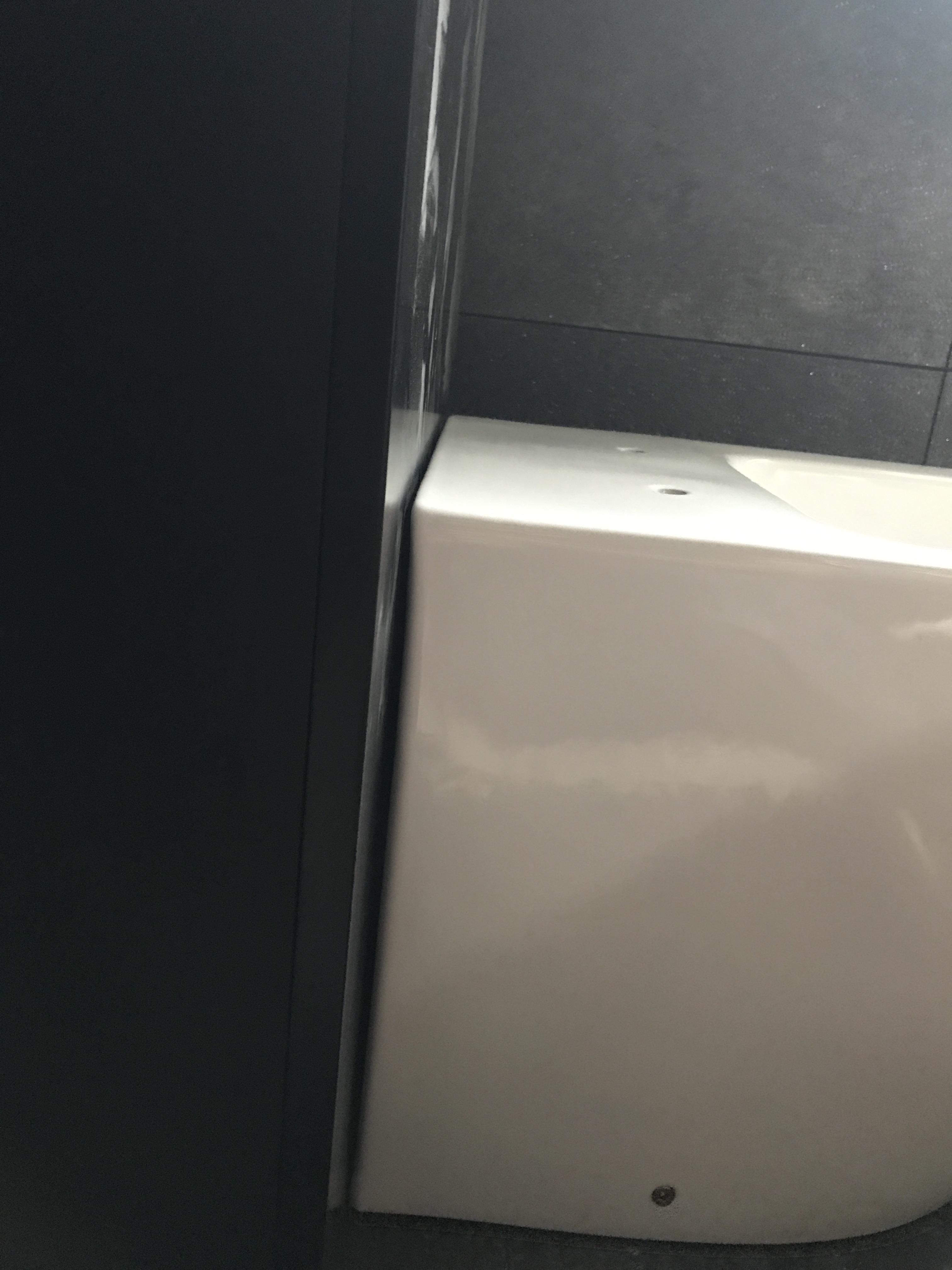

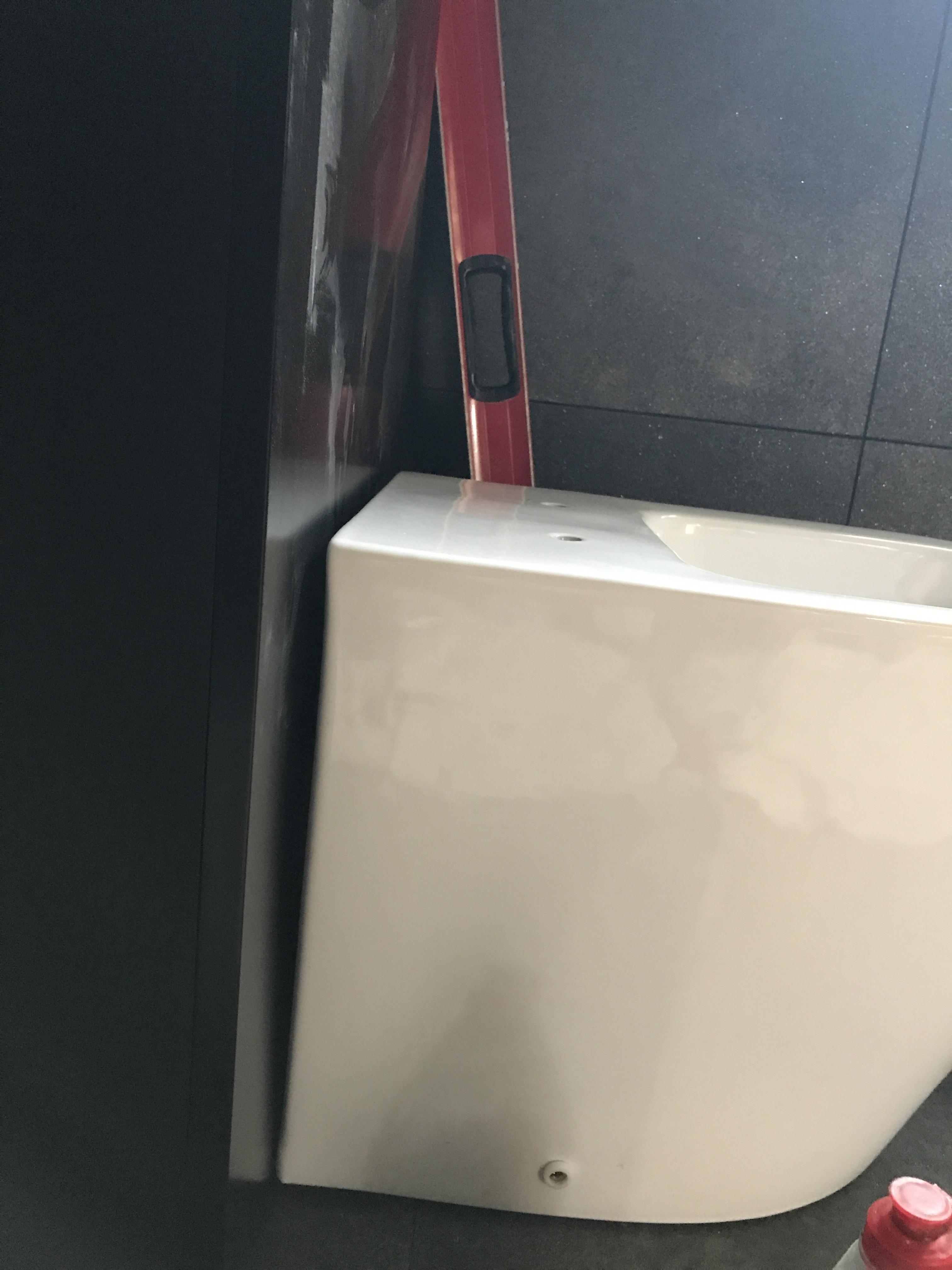

Grosey Posted September 8, 2017 Posted September 8, 2017 I've ended up with this situation, wall not quite upright I believe, anyway it is what it is and now needs to be snagged. CT1 or any better ideas? also what colour would look tidiest here? White to match pan or black to match the unit? And no the level is not upright before anyone says
Onoff Posted September 8, 2017 Posted September 8, 2017 Just amazed you've not got Roger squatting on it! So why's it like that then? You're going to need some of that push in foam stuff before you silicon that. I can send you a length if you want?
Nickfromwales Posted September 8, 2017 Posted September 8, 2017 Hold fire sealing that. It CANNOT be left like that, it's simply not safe. Who fitted it, and who says that's caused by the wall ?
Triassic Posted September 8, 2017 Posted September 8, 2017 Is the pan floor or wall mounted, it's not clear from your photo.
Onoff Posted September 8, 2017 Posted September 8, 2017 Sorry, just read wall not upright. I was sipping Green King IPA at the the time...
RichS Posted September 8, 2017 Posted September 8, 2017 Looks like it floor mounted to me but the wall isn't plumb or the floors not level. Either option it's not a 90 deg junction and that's causing the problem.
bassanclan Posted September 8, 2017 Posted September 8, 2017 It looks like its out by 20mm out over about 500mm? Is it the floor or wall that is out. (Have you double checked for a manufacturing defect in the pan)
Nickfromwales Posted September 8, 2017 Posted September 8, 2017 Oh yes, thought it was wall hung for a moment there. Just saw the fixing screw covers at the bottom . 2 minutes ago, bassanclan said: It looks like its out by 20mm out over about 500mm? Is it the floor or wall that is out. (Have you double checked for a manufacturing defect in the pan) Took the words right out of my mouth
Russell griffiths Posted September 8, 2017 Posted September 8, 2017 We brought a ceramic double sink, it had a dish in the surface that mounted on the wall, out by15mm give it a good check, and then check the wall floor junction something is way out.
Grosey Posted September 8, 2017 Author Posted September 8, 2017 (edited) I fixed it, in the past few hours I have removed the tiles, taken down the stud partition, levelled up the wall, Re-boarded, retiled, regrouted, refitted the toilet to now only have a 2-3mm gap to seal... (Either that or I realised it was me being daft) ? P.S - side fixing toilet brackets are a weird bastard of a thing, hopefully I'll have the hang of it by the 7th toilet in this house! P.P.S - thanks buildhub, sometimes just posting your ridiculous problem is enough to help make you think about it enough to solve it! Edited September 8, 2017 by Grosey 2
