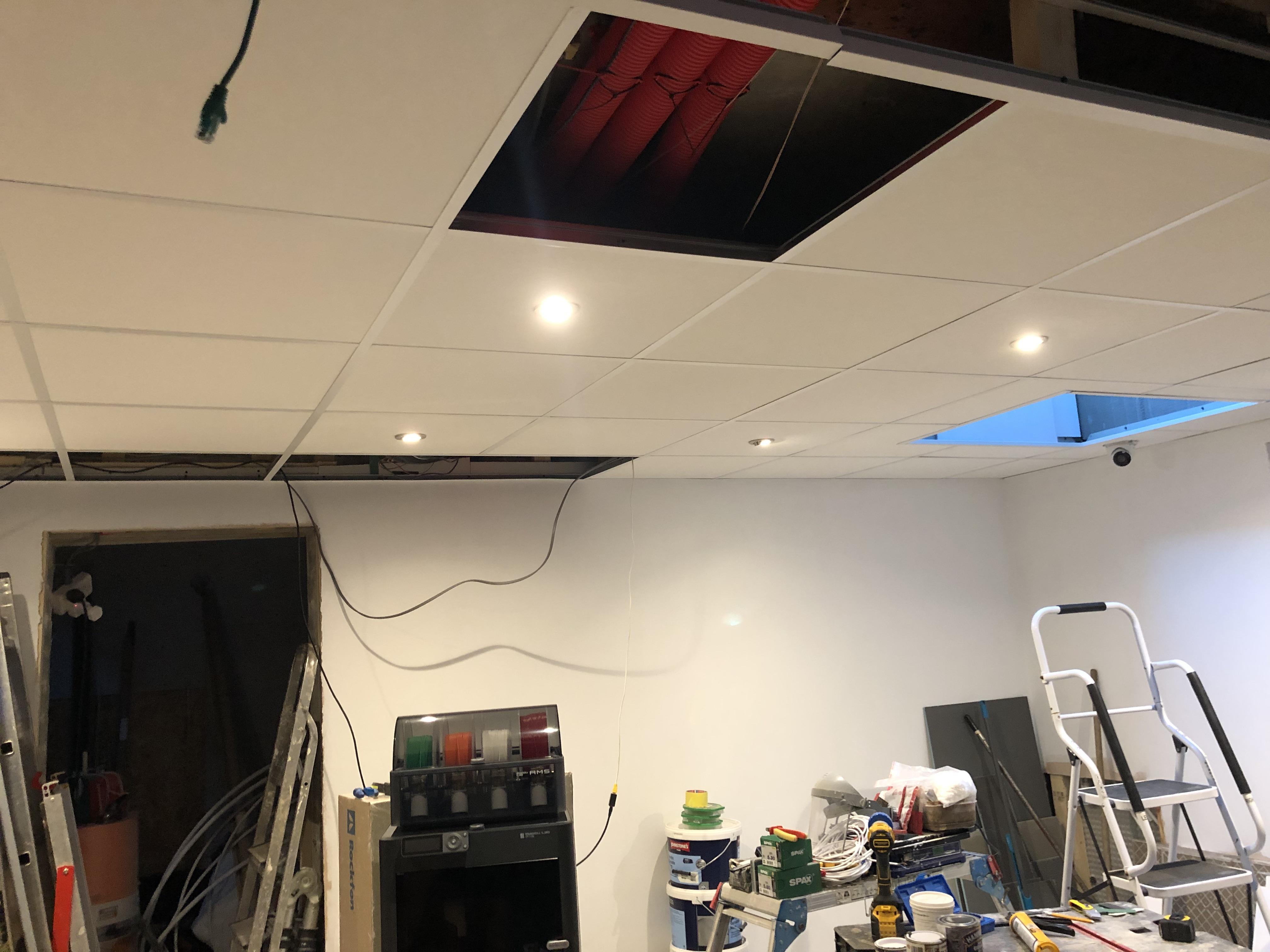

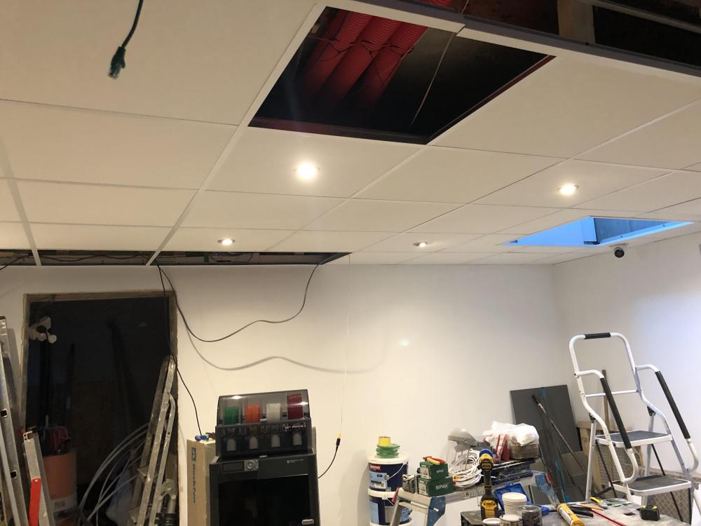

Pocster Posted October 26, 2023 Share Posted October 26, 2023 (edited) I know I had my doubters . ( @Thorfun 😂 ) I really had limited choices . Been a right pita - especially around sky lights - but looks pretty good I think ! Edited October 26, 2023 by Pocster 2 Link to comment Share on other sites More sharing options...

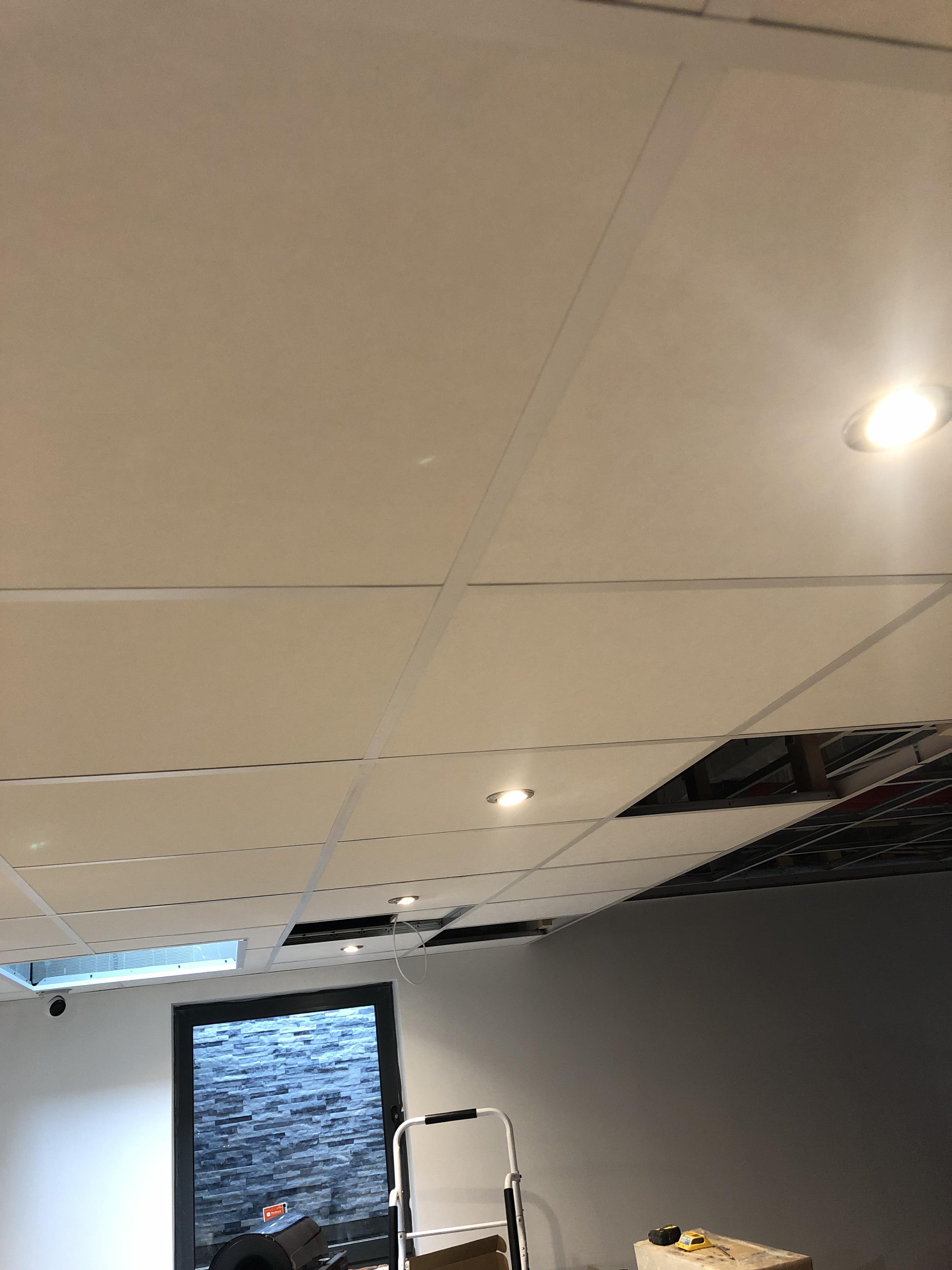

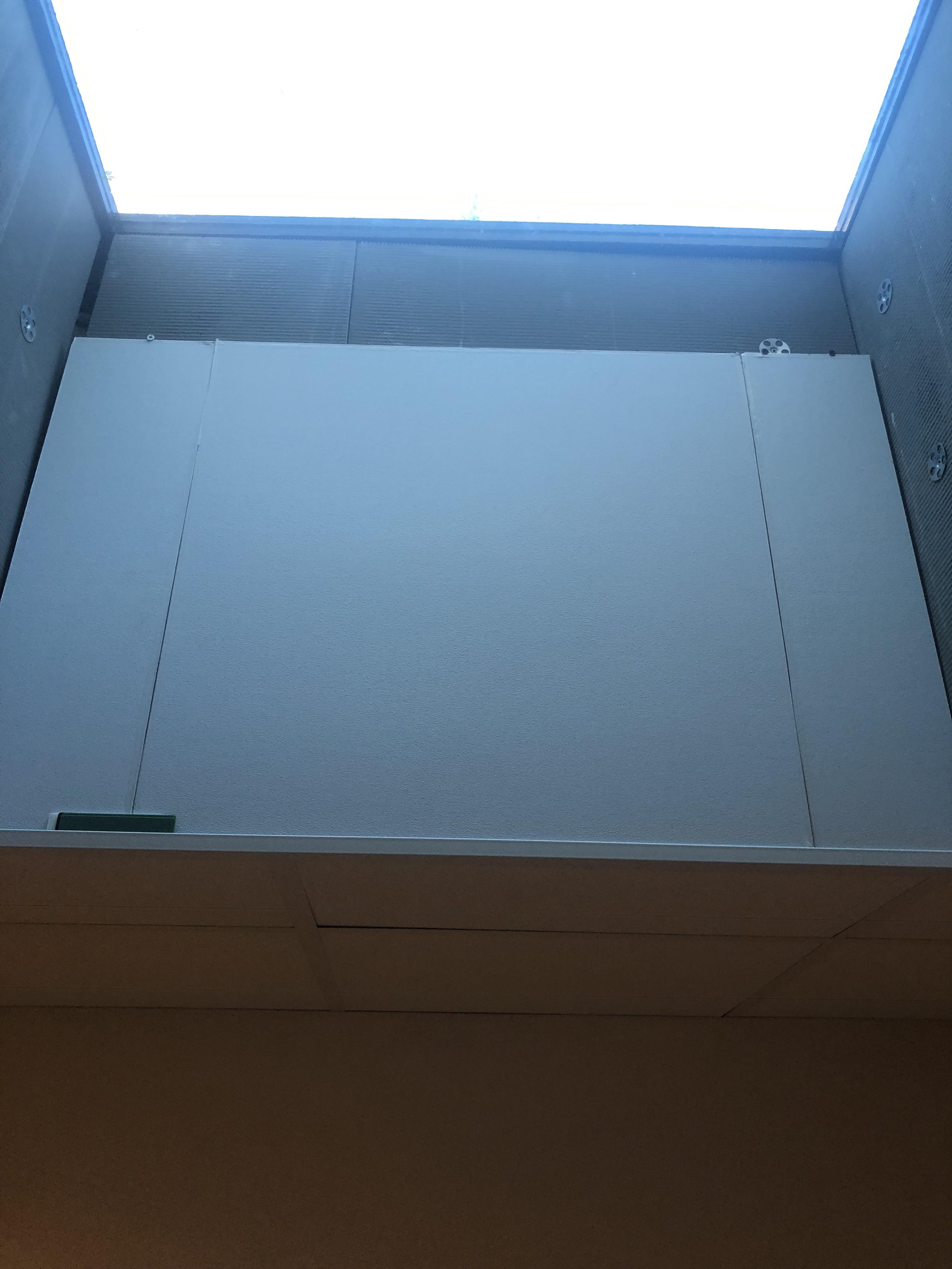

Pocster Posted October 27, 2023 Author Share Posted October 27, 2023 Have some unique problems with sky lights . Hole not square . Used lite weight backer board to give something to bond to but also provide lip for ceiling ( apparently there is no ‘proper’ solution to sky lights in a suspended ceiling like this so the manufacturer tells me ) . Then ct1 plasterboard type tiles in . The seams show the plastic tape which in a normal ceiling you’d never see . That’s going to bug me - so some trim over them later . Link to comment Share on other sites More sharing options...

saveasteading Posted October 27, 2023 Share Posted October 27, 2023 54 minutes ago, Pocster said: there is no ‘proper’ solution to sky lights in a suspended ceiling like this so the manufacturer tells me There are ready-made translucent, dimpled panels that simply slot into the space. If you want to form a white or shiny box up to coincide with a skylight then it is doable. A surprising amount of light tends to find its way even if you don't. But it will be more about day and night recognition than illumination. It gets hot in the void you have created, 1 Link to comment Share on other sites More sharing options...
